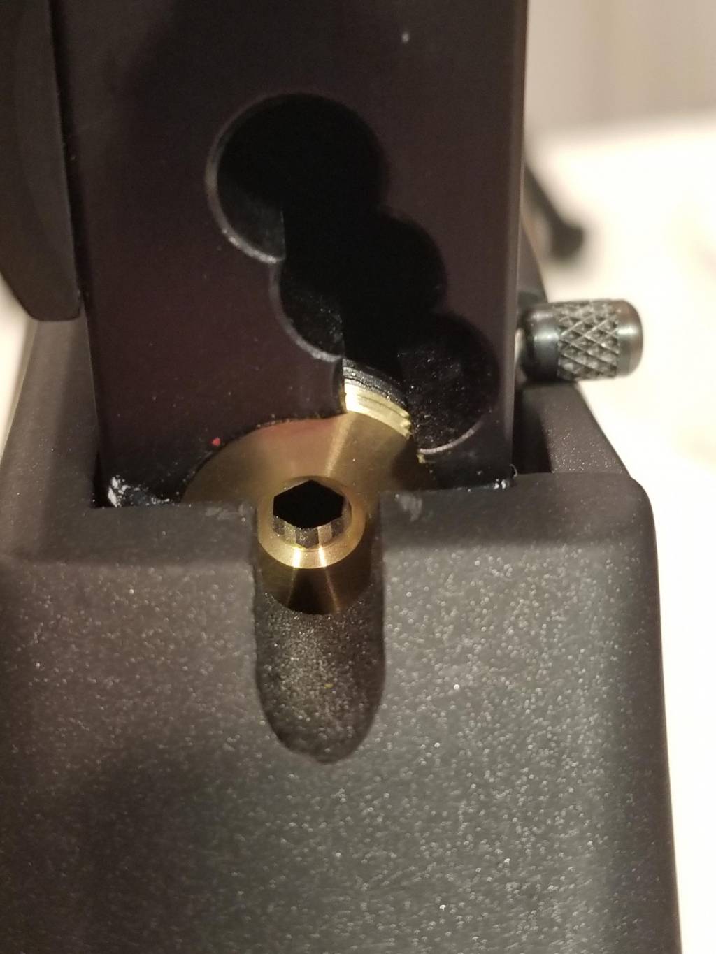

If it is not a newer model with the external hammer spring dial you can also add a second hammer spring jam nut to keep it from walking. My Wildcat MK1:
