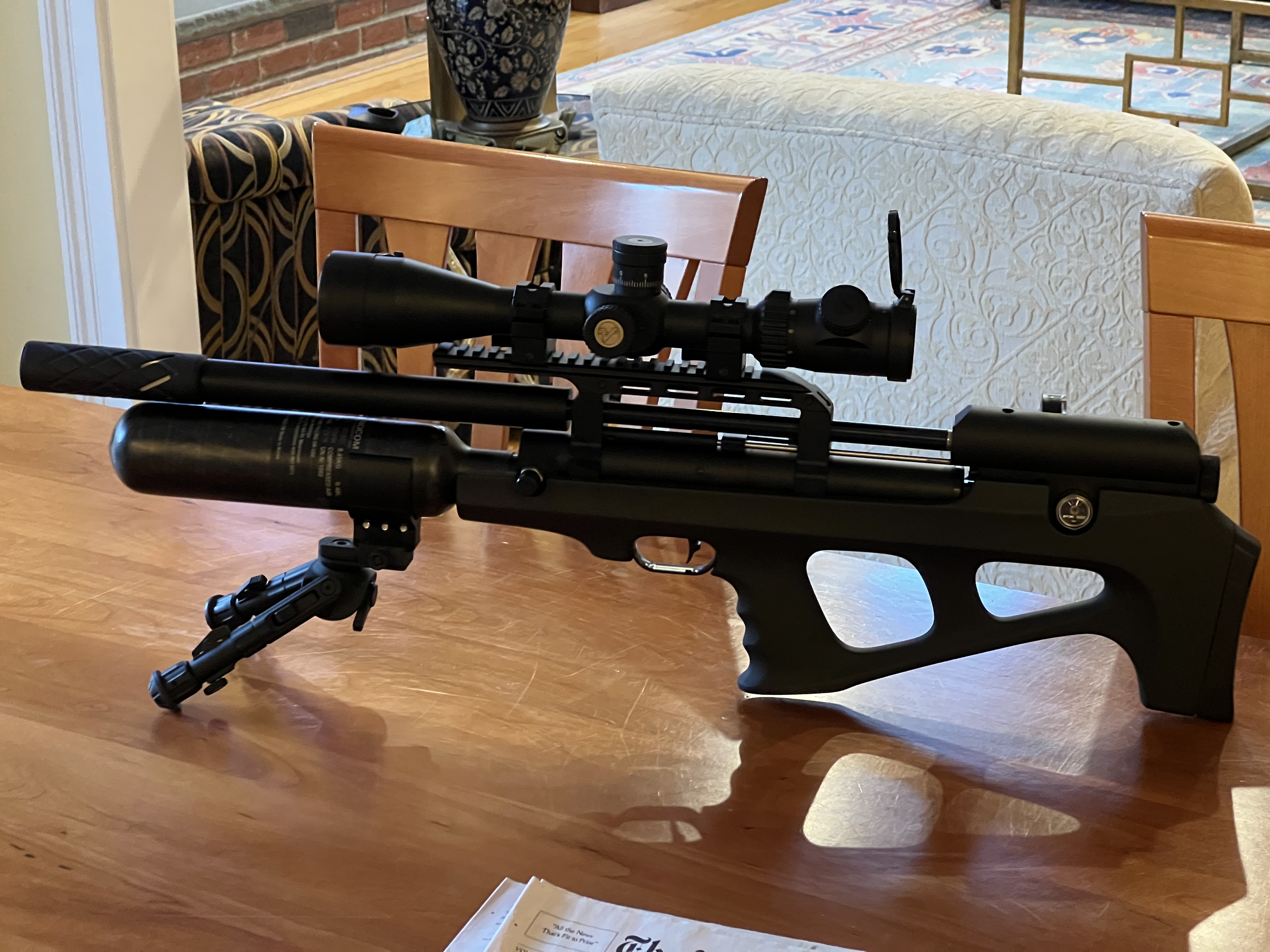

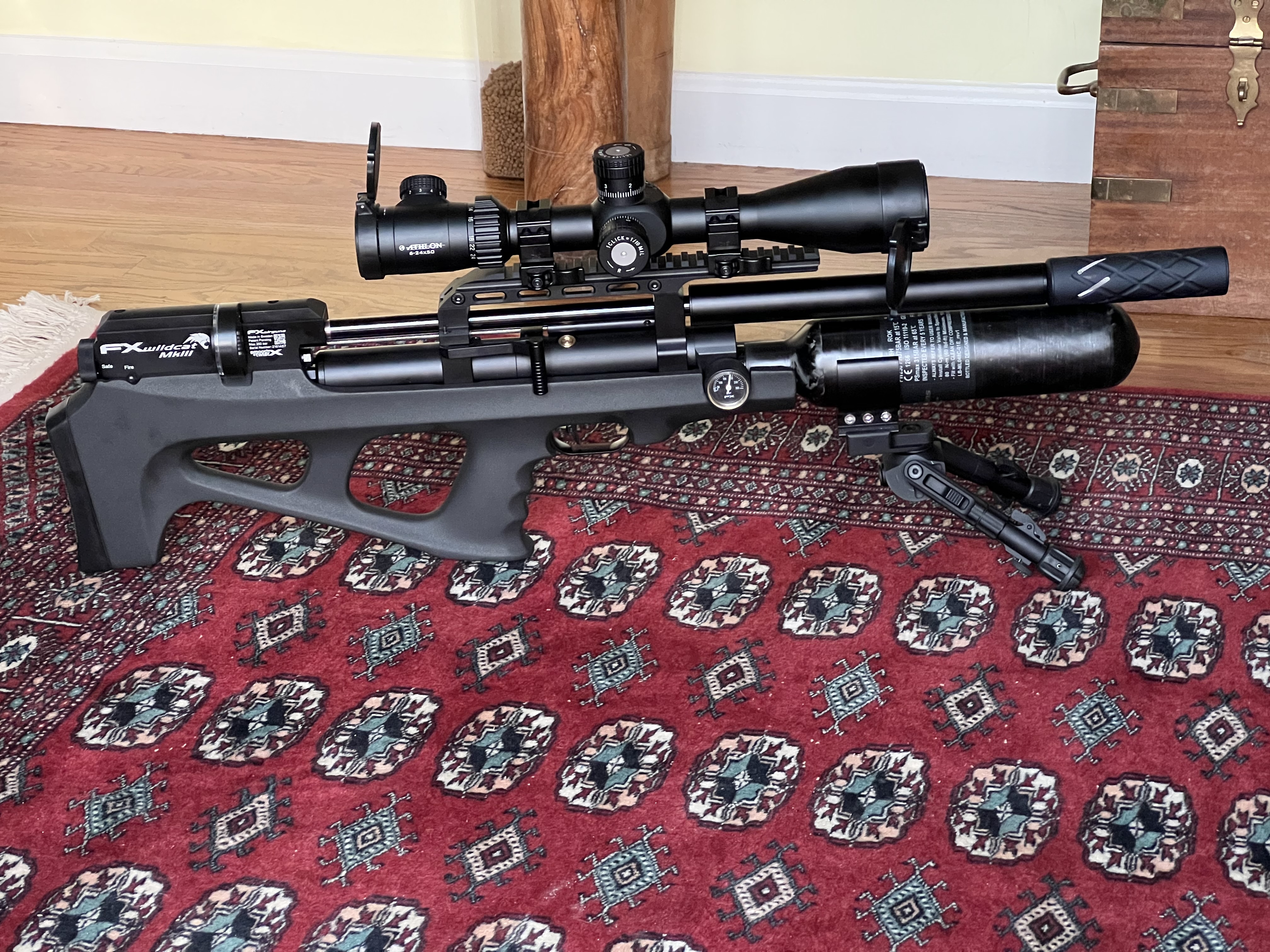

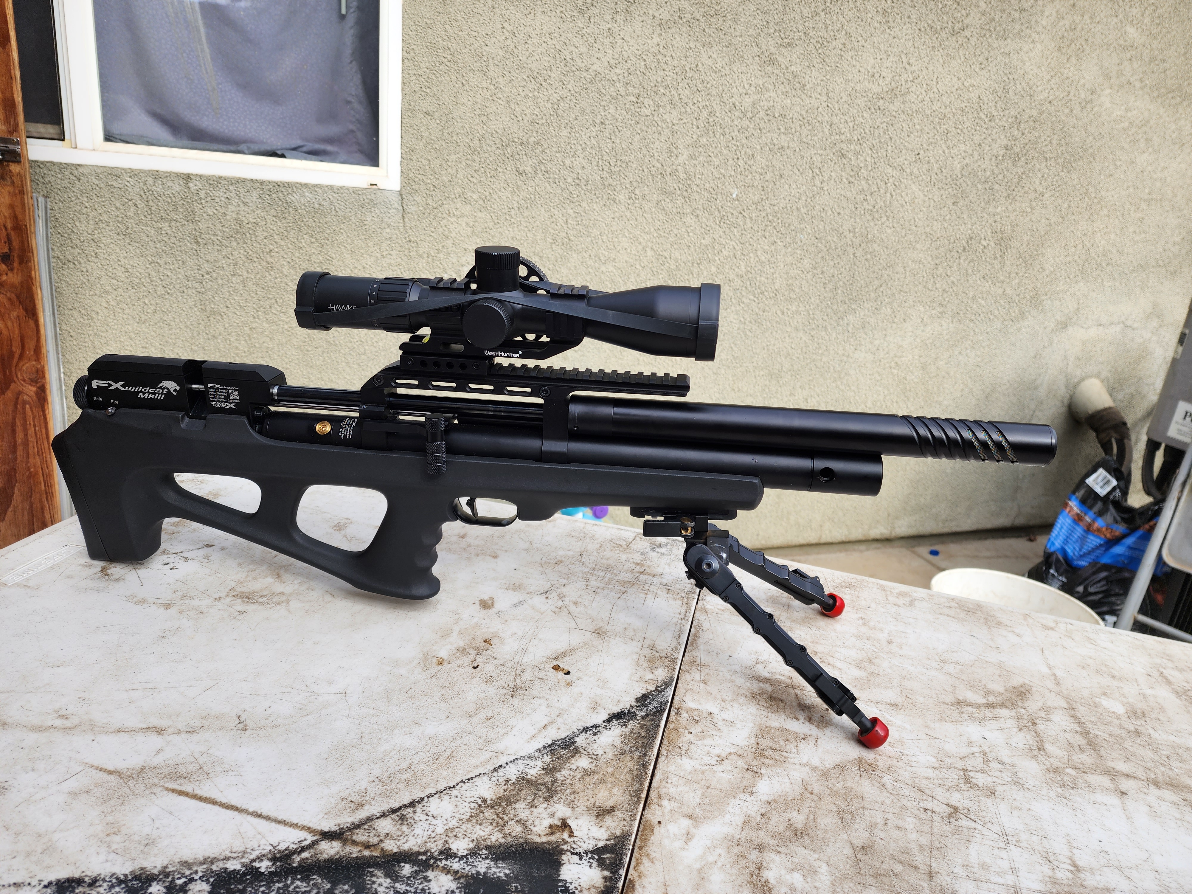

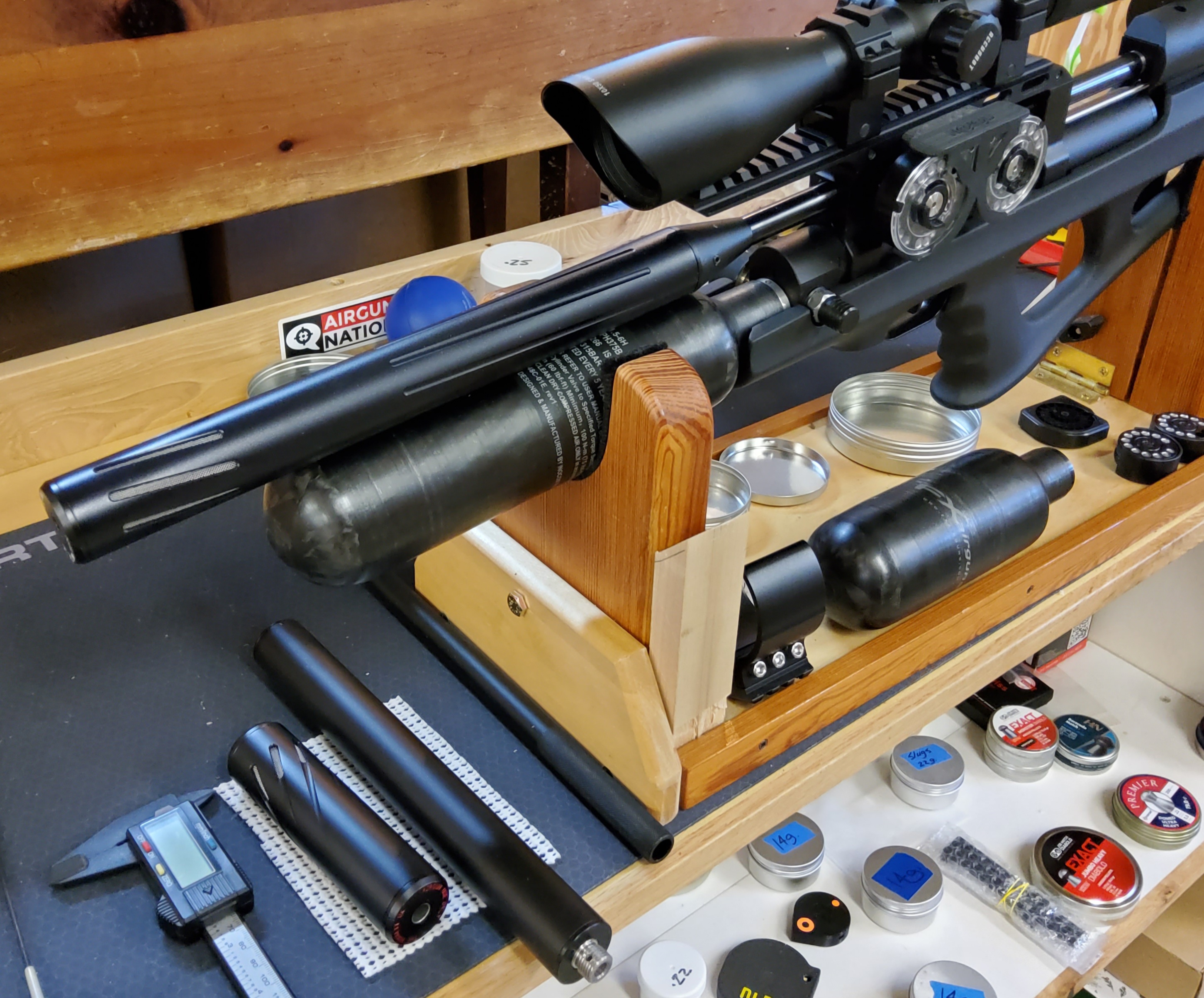

All 1.22 inch diameter or 30mm mod's will work with the 480cc carbon fiber tank.
I can vouch for that. Here’s my Wildcat MK III BT with a 480cc bottle and a 500mm barrel using a 0dB compact mod. It also works with the DonnyFL Koi and Tanto.
