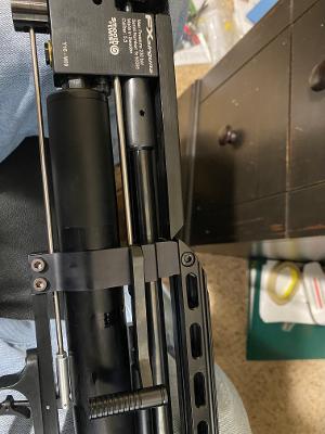

I got a plenum for my MK1 Wildcat. Watched the install videos. Did the install. I was surprised how easy it was. Problem now is it won't air up. And has some sort of fluid coming out the hole in the pic below. Anybody have any suggestions.
Preload ALL of your magazines and just try airing it up and quickly as possible shooting the hell out of it (with pellets pointed in a safe direction of course)
So you are saying my bicycle pump will work. I saw an air compressor at Lowe’s I thought about getting. Would triple loading be better. Might as well go all out.
The 2 pellet intentional double load trick does work when trying to hand pump (using a proper PCP airgun pump of course!) when cocking the gun alone doesn't prevent the gun from pissing all its air out if the barrel.
Always put it on SAFE and point it in a SAFE direction with good backstop while hand pumping from zero pressure since there's still a chance it may fire just from the built up Hand pump air pressure if the valve doesn't seat quick enough. Loading only one pellet to do this trick is very dangerous and may likely fire since there's less resistance with one pellet instead of 2 that's why I say load 2 pellets to do this trick. Remove the LDC to shoot them out when done to avoid damage to the KDC.
2 pellets blocks the transfer port which forces the valve seat (poppet) to shut if you don't have a 3000 or 4500psi tank to fill the gun from the much dreaded zero starting pressure. The Hand pumpers nightmare.
With Most guns you may only need to cock it to be able to hand pump from zero pressure. FX with free flight hammer system such as Wildcat for exanple has it and needing a tank to fill or the 2 pellet double load hand pump trick.
