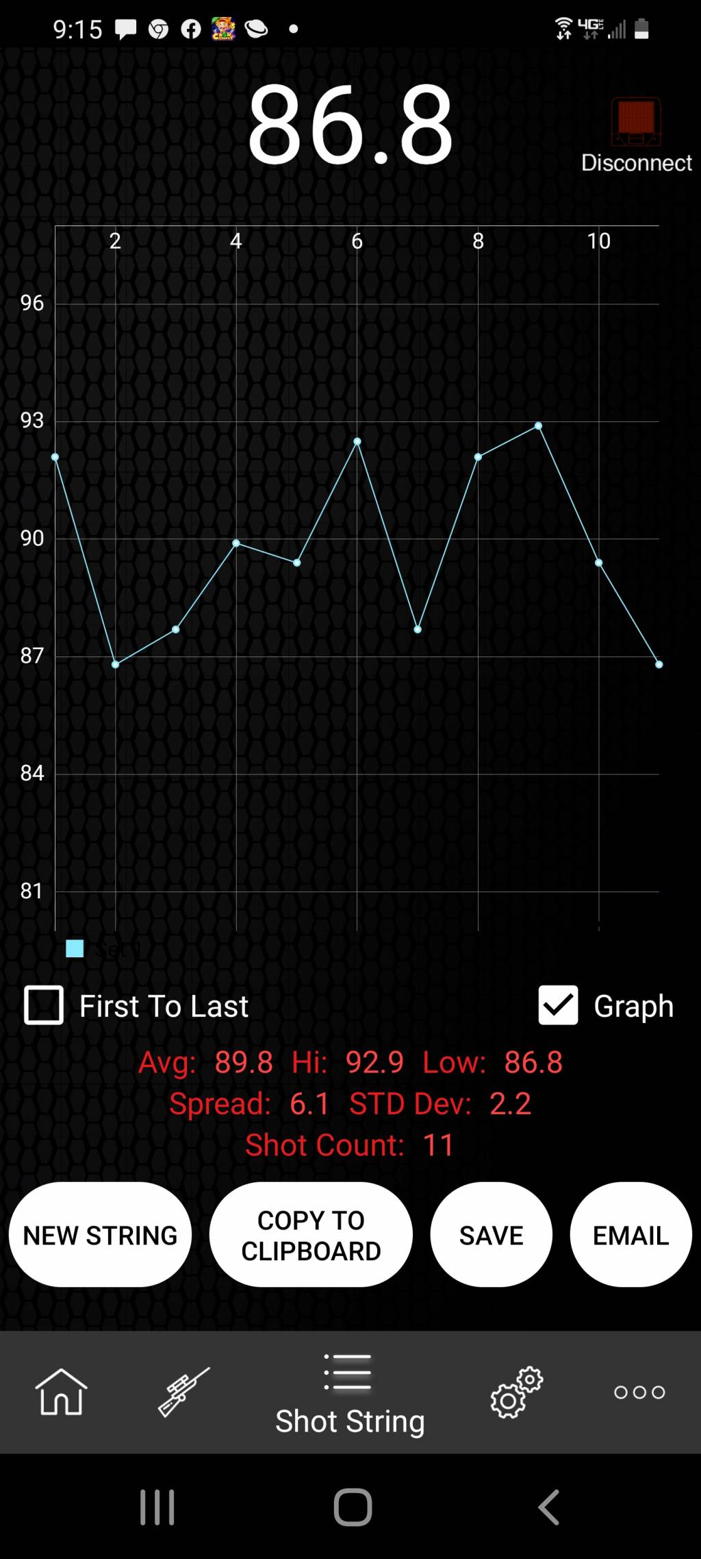

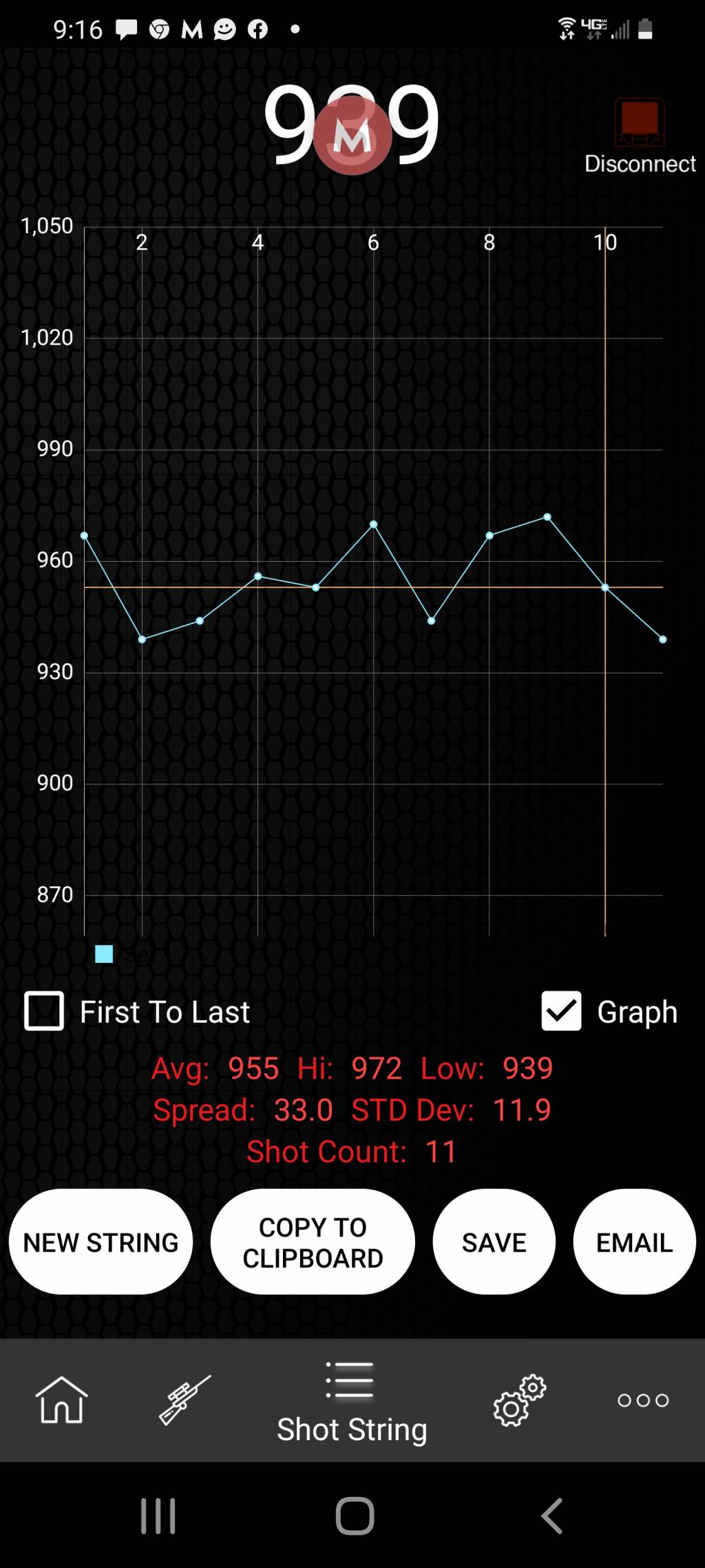

I'm super excited I just added a huma air power plenum and reg. Set at 155 and here are the results...........just after install no fine tuning

I just played with mine a little more today and settled with 898 FPS avg with a 48.6 pellet for about 88 ftlbs then shot a hand full of light weight nsa the 43gs I thing and got about 930fps but what got me was the accuracy better than the pellets.
is there a way to tell what twist I have with the serial number. It’s so light but barks a lot. I’m wanting it for hunting in the KS wind shot count was full mag from 190bar to 150 bar so I expect 2 mags easy from 230
