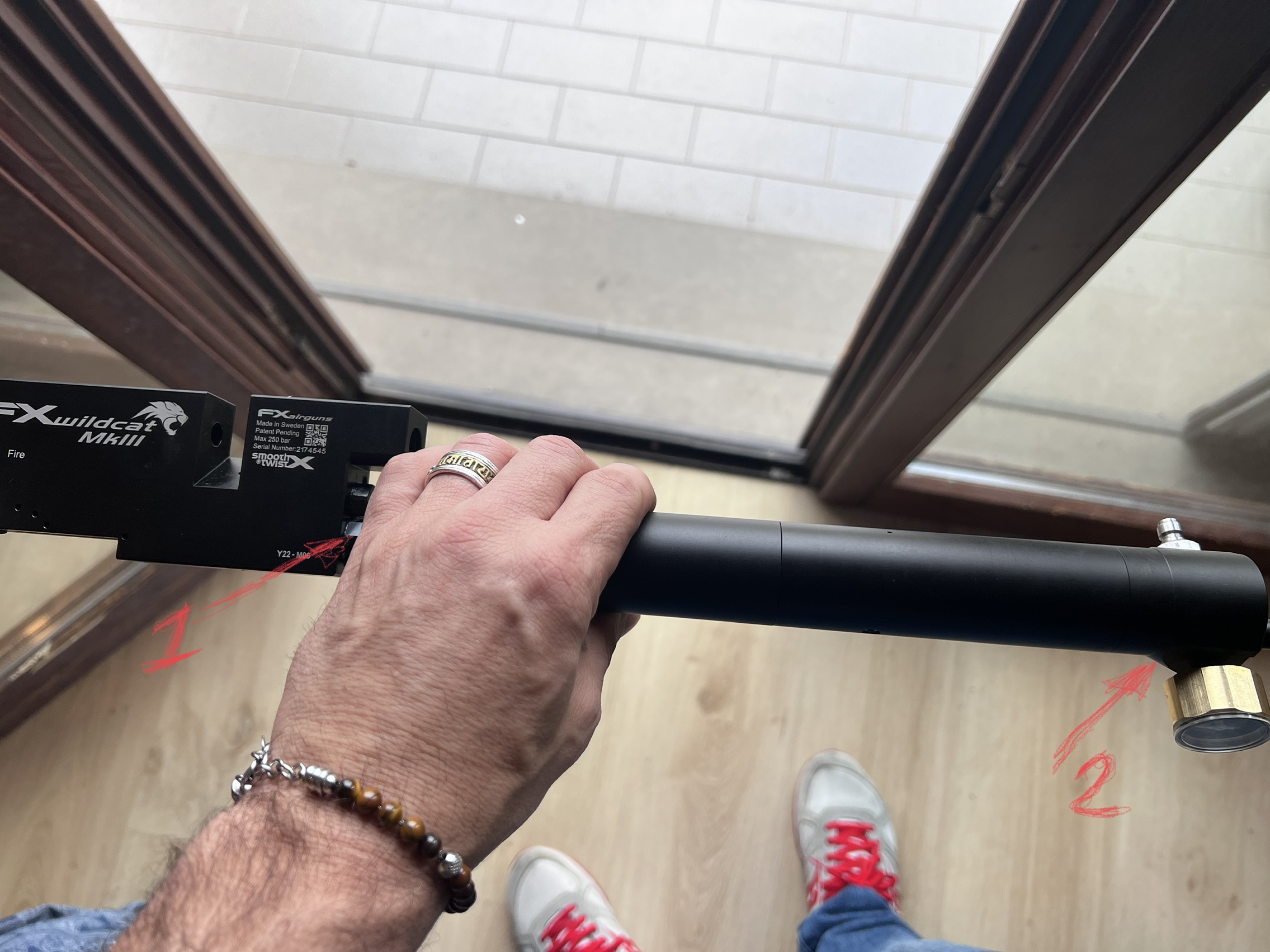

Just to be clear, this is my own fault.
I was looking for leaks and looks like I found the leak but also another issue…
The rifle looks like is leacking from 1 ( see the attached) but also due to attach/detaching the bottle dozen of times by hand and not being hold by It’s own stock appears thatthe bottle adapter became too loose, and iF really want to re

"looks like he has a leak (1), and he has turned his bottle adapter (2). The bottle adapter does not bottom out, just needs to be lined up according to the rifle. Could also be suggesting he stripped the threads for the bottle to the connector, in which he needs a new bottle connector."

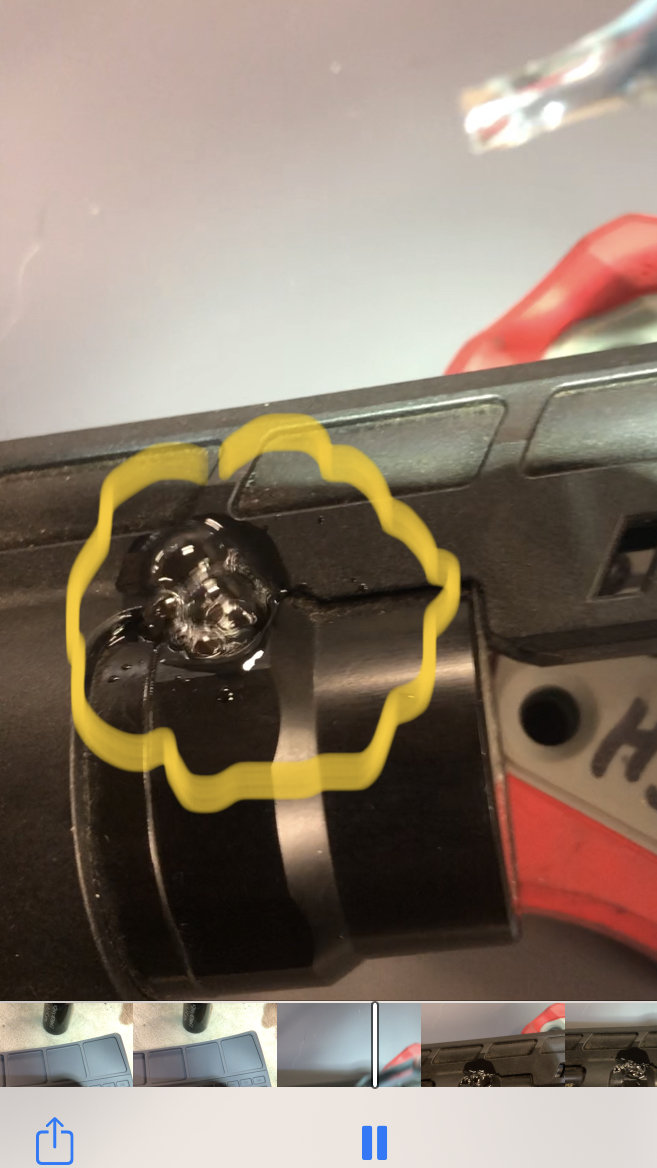

The dowty seal is typically M12, that leak number two is either coming from your gage seal, the o ring seal under the end cap, or the o ring seal behind the fill valve that closes off air from escaping after a fill.
It’s hard to tell by your arrow just going to that general area.

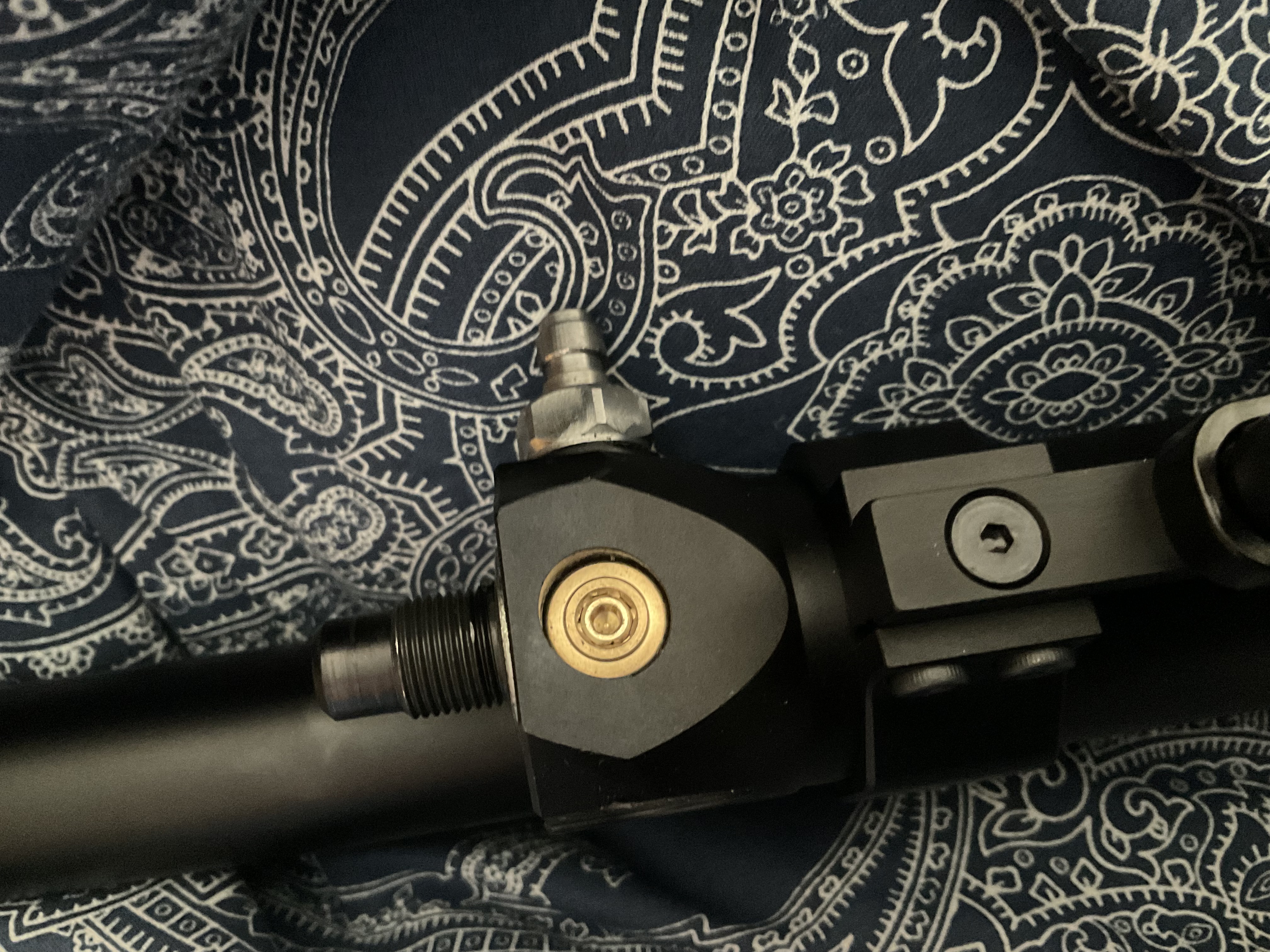

I can help better with leaks from a pic such as this(as an example)
