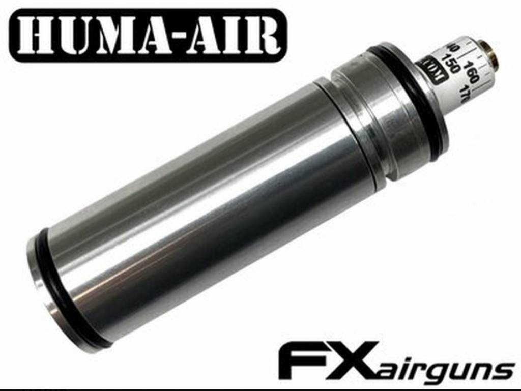

135 bar reg and install this setup:
Along with hammer spring tuning. You’ll easily get in the 900’s ft/sec range.
I have Wildcat’s that do this. A plenum extension is a easy and practical way to gain power.

Also a dual hole transfer port ( with or without matching probe) is an additional mod that will provide additional power in an easy way. Mind that with the HUMA xl plenum you will lose some air volume in your airtube but it works miracles. ( I think it is about 30cc) In case you place a huma reg plus XL plenum in your WC MK3 you obviously lose the possibility to adjust the reg externally with an allen key. This means that for adjustments of your reg you have to take out the HUMA reg. ( easy but not as comfy as the original set up) .
