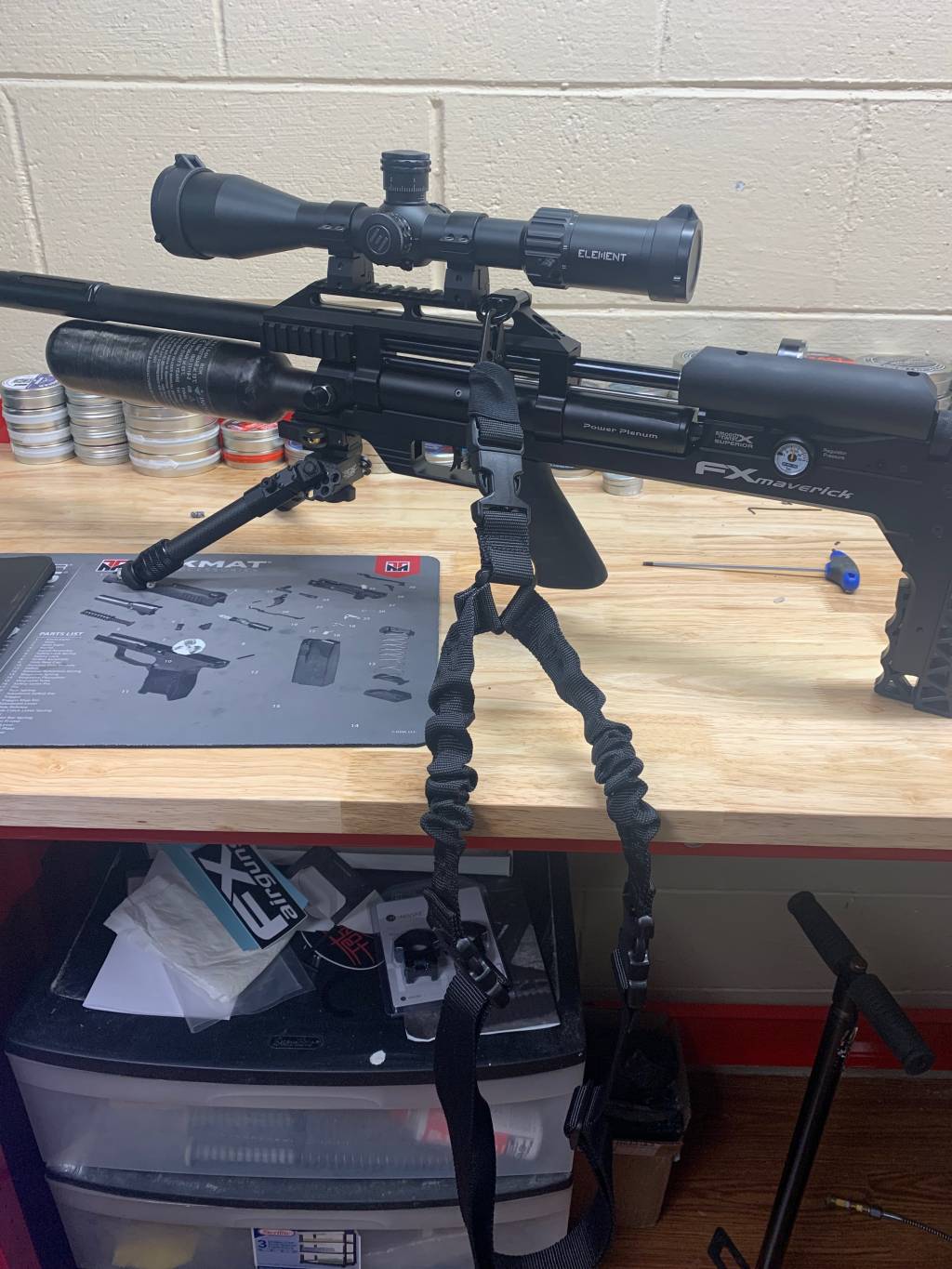

Here is a pic of my Maverick Compact 22cal. Granted I like the looks of the Wildcat 3 but still not sure how it's better than the Maverick. My compact can do 55 foot pounds.

I do like the Wildcat MKIII, but after have a Maverick compact 22cal and a Maverick Sniper 22cal, I just felt like I was going to be disappointed in the Wildcat. Honestly I hunt all the time and the Maverick Compact above is hard to beat in the woods. Plus the power is higher and the shot count is more than double. My Maverick Sniper 22cal can do 70+ foot pounds. I had no problem, after buying the slug power kit, bringing both guns to the power advertised by FX.

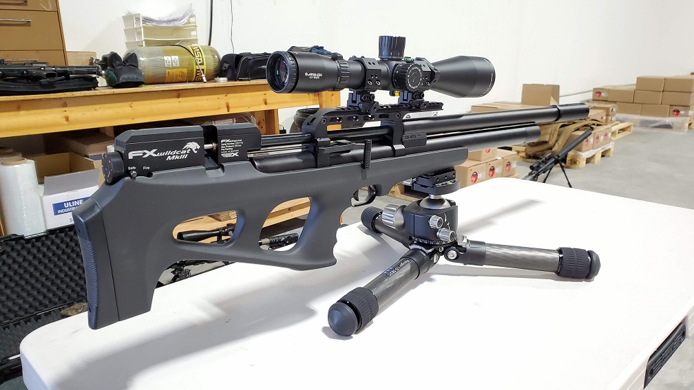

But the Wildcat is so much lighter and so so much sweeter to shoot. It just fits me. Oh and it has the veyron 3-12 on it. Nice clear LIGHT optic.

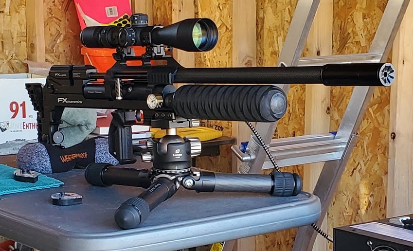

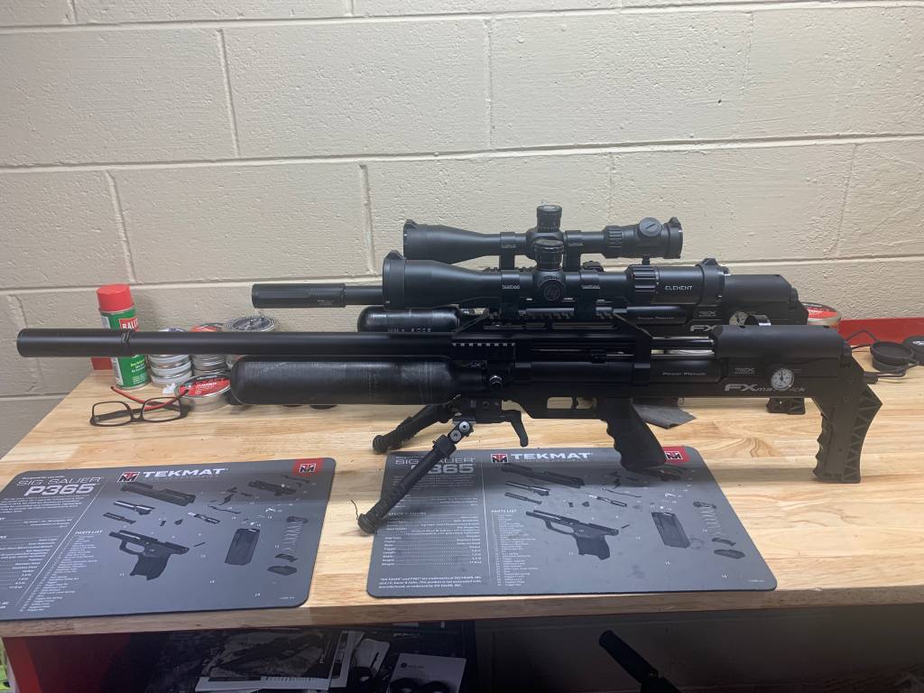

I have both in .22 Snipper and a .30 kit when needed. The ergonomics of the MK3 are fantastic. It just feels good as a package when shouldered. The addition of a Huma reg. (adds 1/2" more plenum than the AMP) and the PP from 910 Airguns allows the MK3, when tuned properly, to stand equally with the Maverick for power. They are both very accurate too and easy to work on. The similarities for me, end there. The first difference is the rigidity of the Maverick all metal stock vs. the synthetic stock of the MK3. On either the bench tripod or the field tripod the MK3 synthetic stock has a bit of flex in it when left under it's own weight where the Maverick is rock solid. I can sling the field tripod with attached Maverick over my shoulder and move on the the next location. Not going to happen with the MK3. Shot count is the next obvious difference 580cc vs. 300cc, no comparison, especially with the .30 kit installed. The dual regulators do have their place in minimizing the stress one regulator would be required to take when pushing the outer limits of power. I personally enjoy the Maverick overall as I have spent many hours customizing it to my shooting style. From changing the grip and adjusting the LOP, which I like a little longer, to adding carbon fiber where I can. The real difference? Depends on which end of the spectrum you prefer. Personalization $$$ will be spent on both... just sayin' . Enjoy your research.
