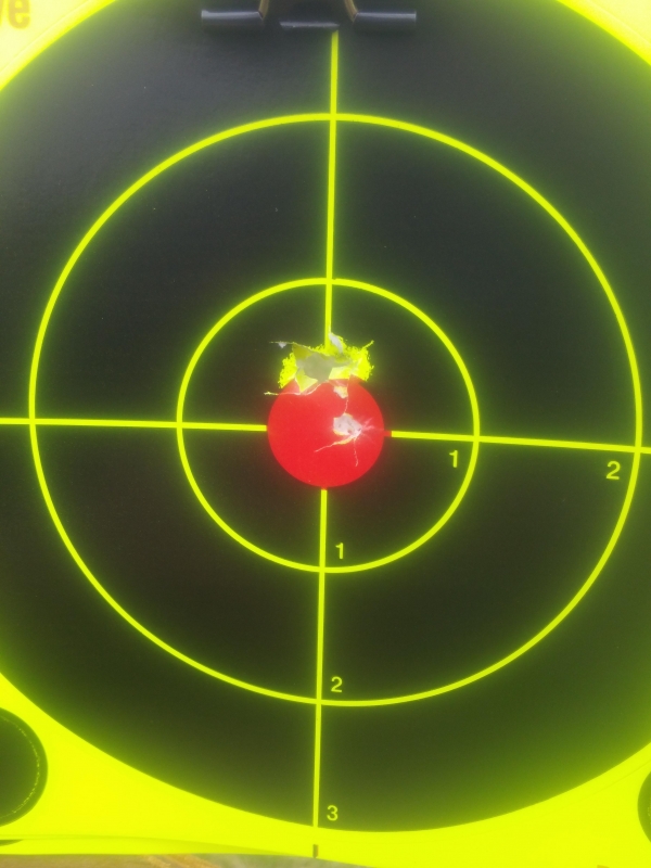

Eight shots at 50y three clicks down and #9 in the red. Good to go on Wildcat Huma regulated.
...and just think, you did that without cleaning or weighing or lubing your pellets, or using an X barrel! I bet you can't wait to get her out to a hundred yards on a calm day and have some more fun. I guarantee you can hit a soda pop can at a hundred every time...and I doubt you would ever be hunting anything smaller than that, or taking a hundred yard shot at any game smaller than a pop can either! Great job! And with your Huma reg you can put that rifle in the closet for a couple months, and take it out and it will do exactly the same thing every time...with no rude surprises.
