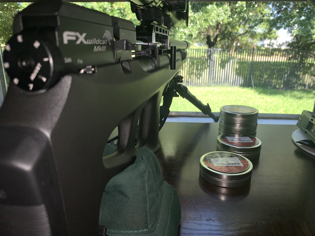

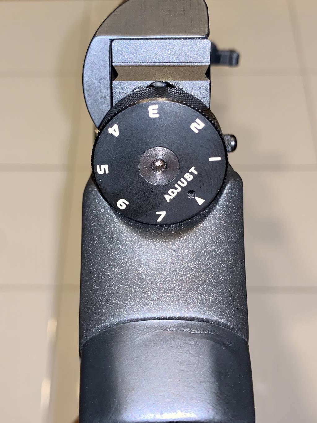

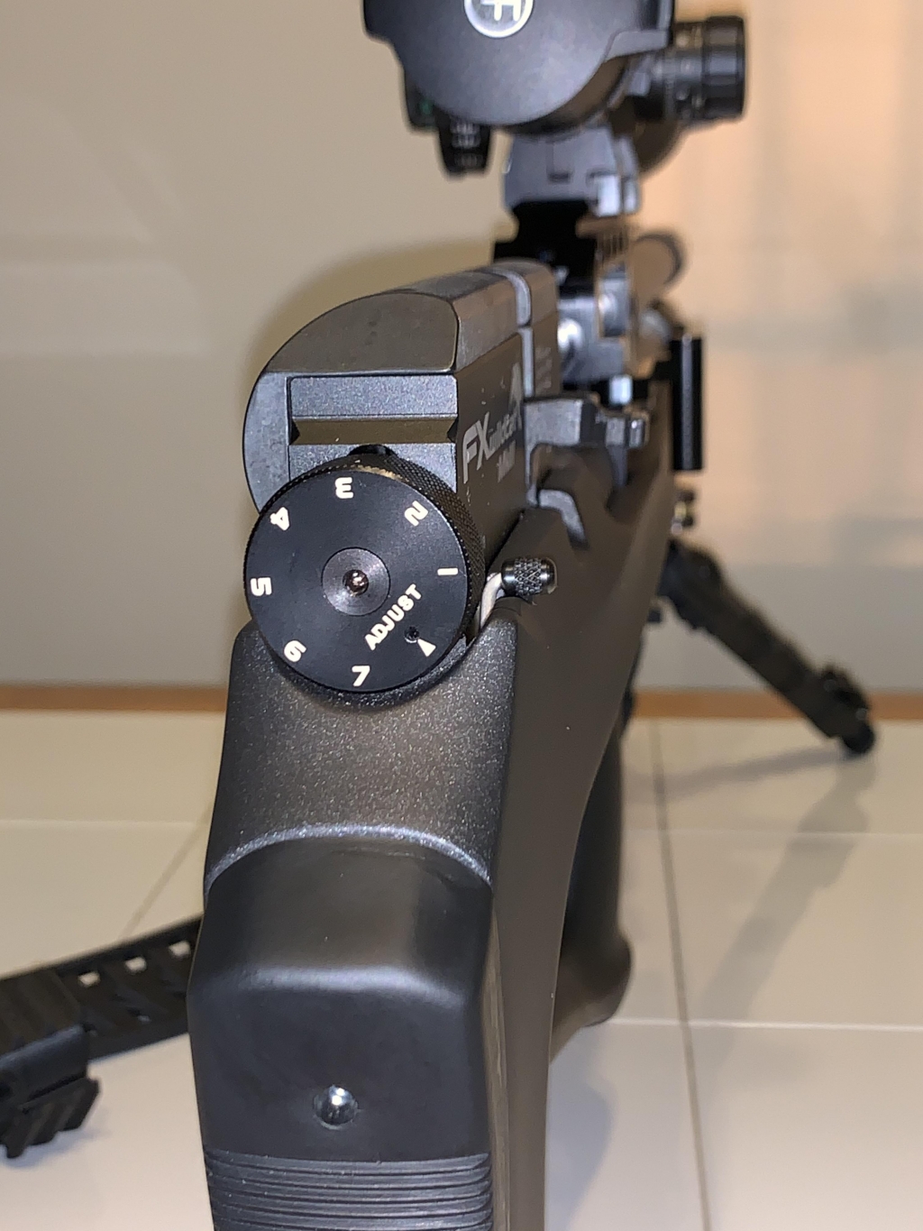

i will check if I can get a slight bit of material out of the way from that hidden regulator adjustment hole so my hex wrench ( with ball point as per your recommendation) can get in a bit easier ( couldnā€™t manage) . For getting the best balance ( did I say balance...šŸ˜‰) I have to have a bigger plenum and I want it extern. Hence the DL power plenum or the ER external plenum will get a permanent place in my WC3. I do need approximately 90 fps more speed in my current preferred setting so I expect this about to get from the added plenum alternatives. ( individual not coupled together) . I will first check ER solution and if that is not fine with me I will go the powerplenum DL route

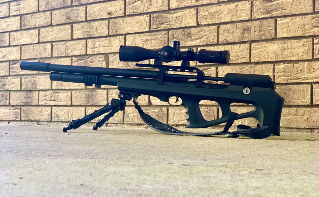

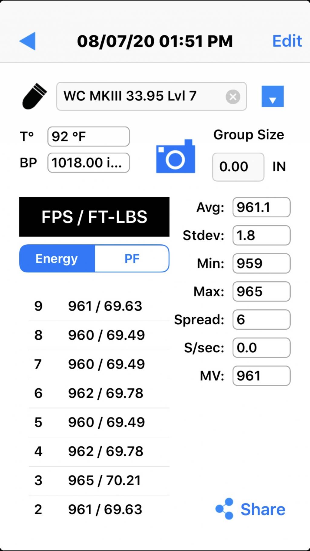

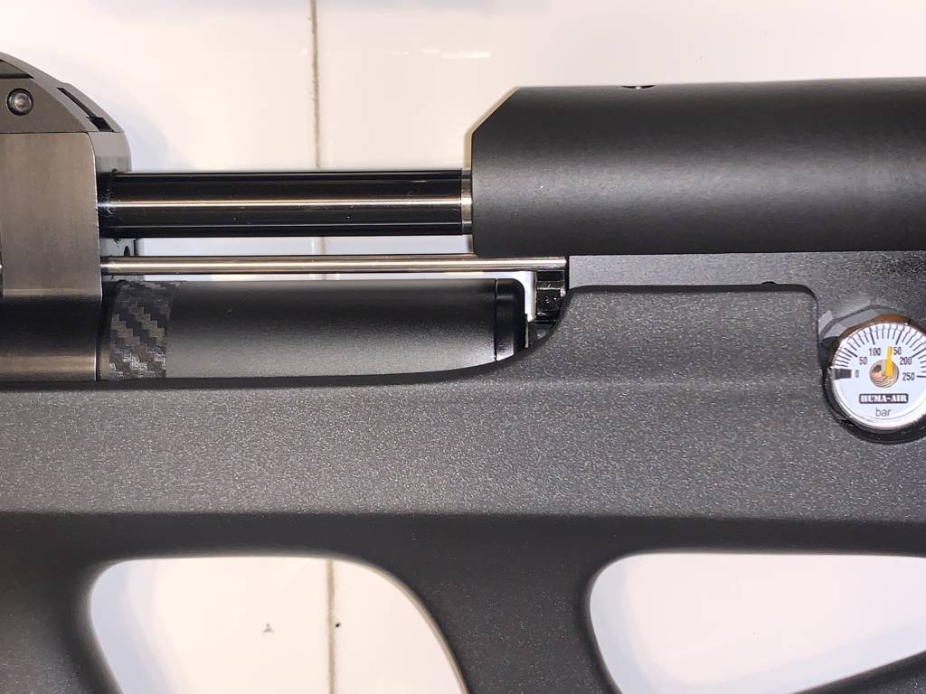

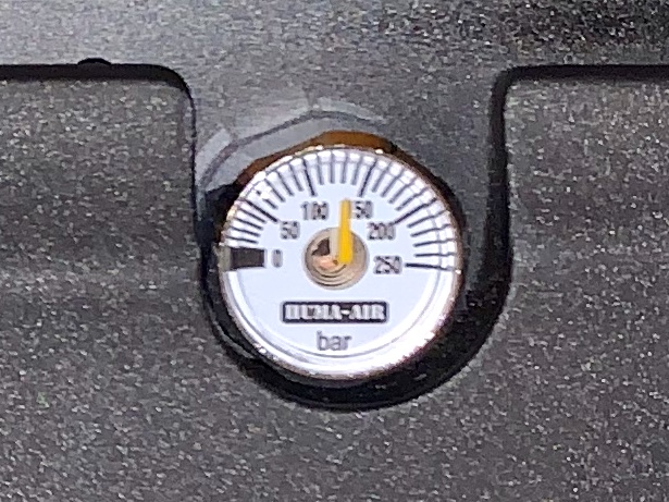

I have since installed the 2.5ā€ Wildcat plenum by Ernest Rowe. With no tuning adjustments & just the plenum install, I am reaching the posted 70 FPE. A.M.P. regulator still @ 135bar and on hammer tension wheel level # 7.
Oh man, I have to hit 165bar or so to get that power level. Getting that at 135bar is really nice.

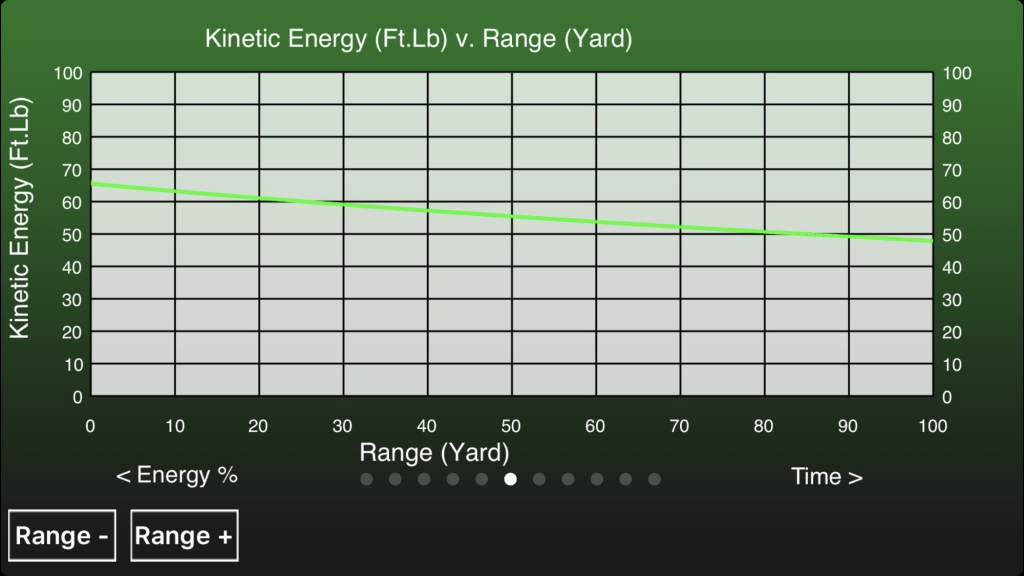

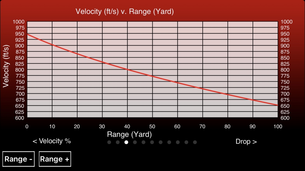

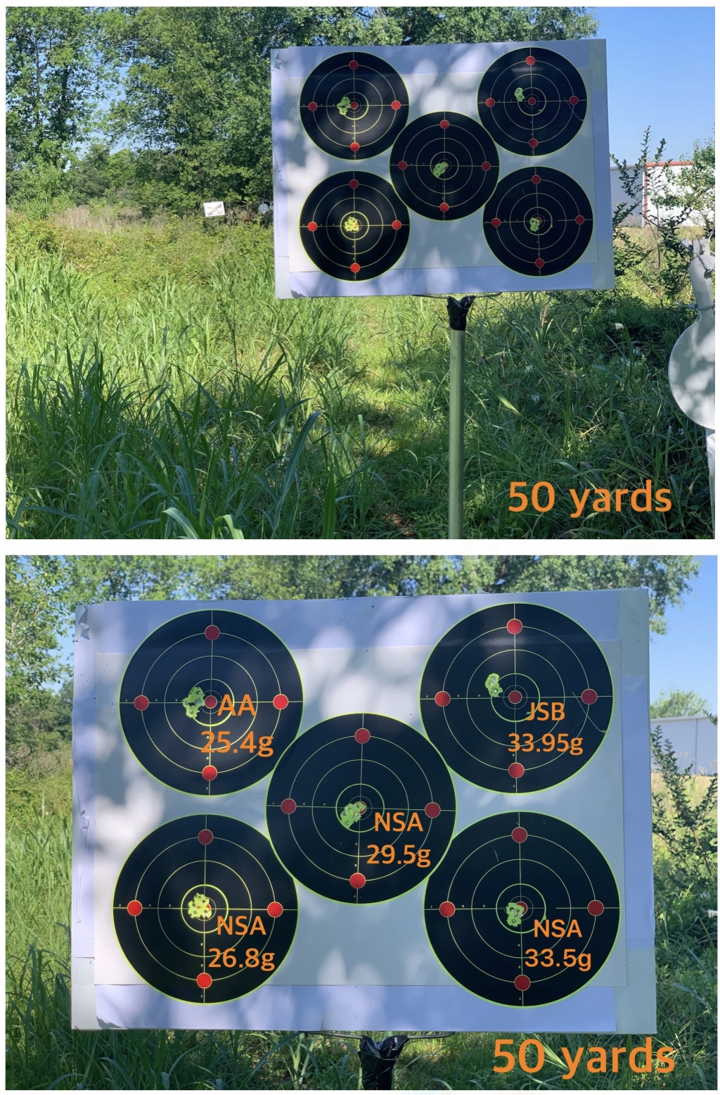

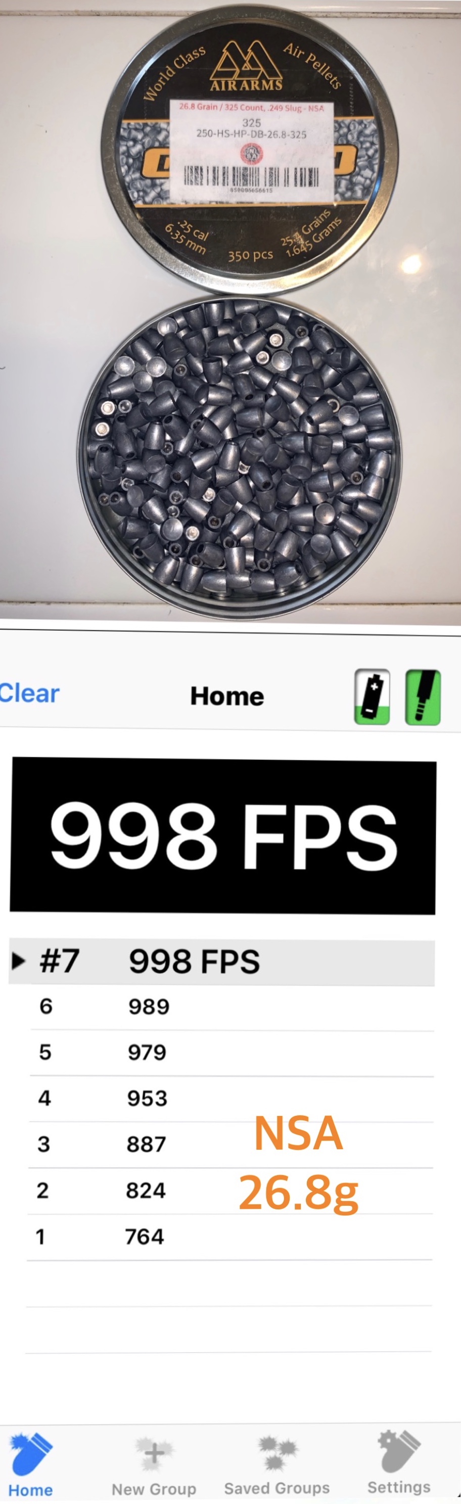

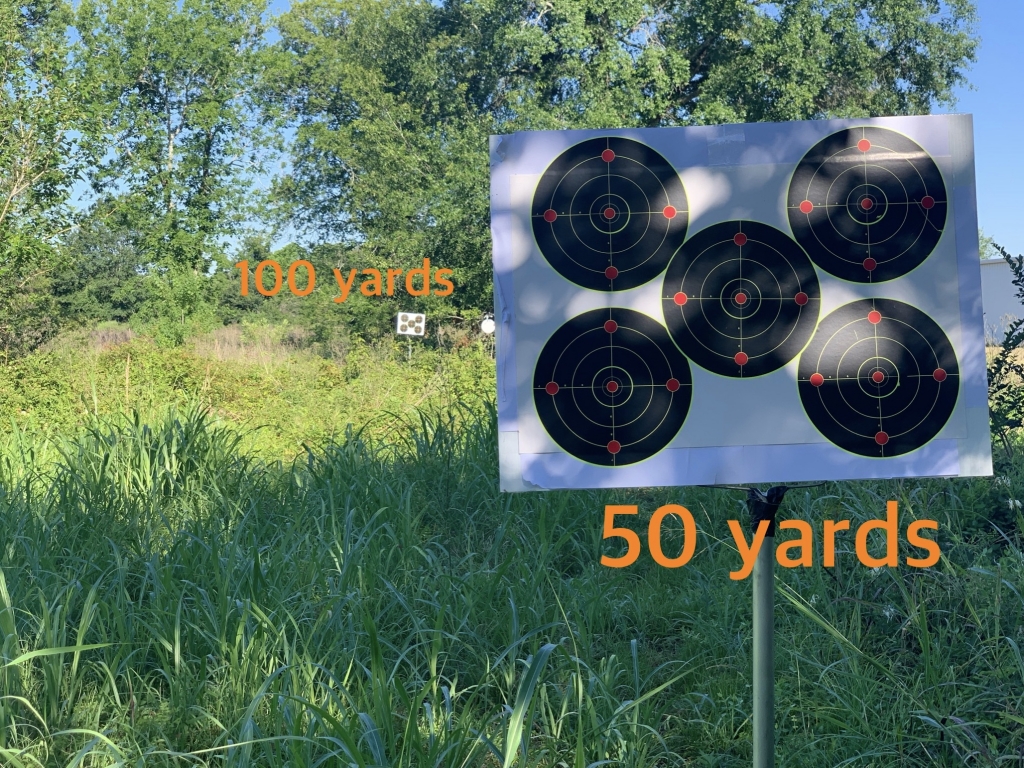

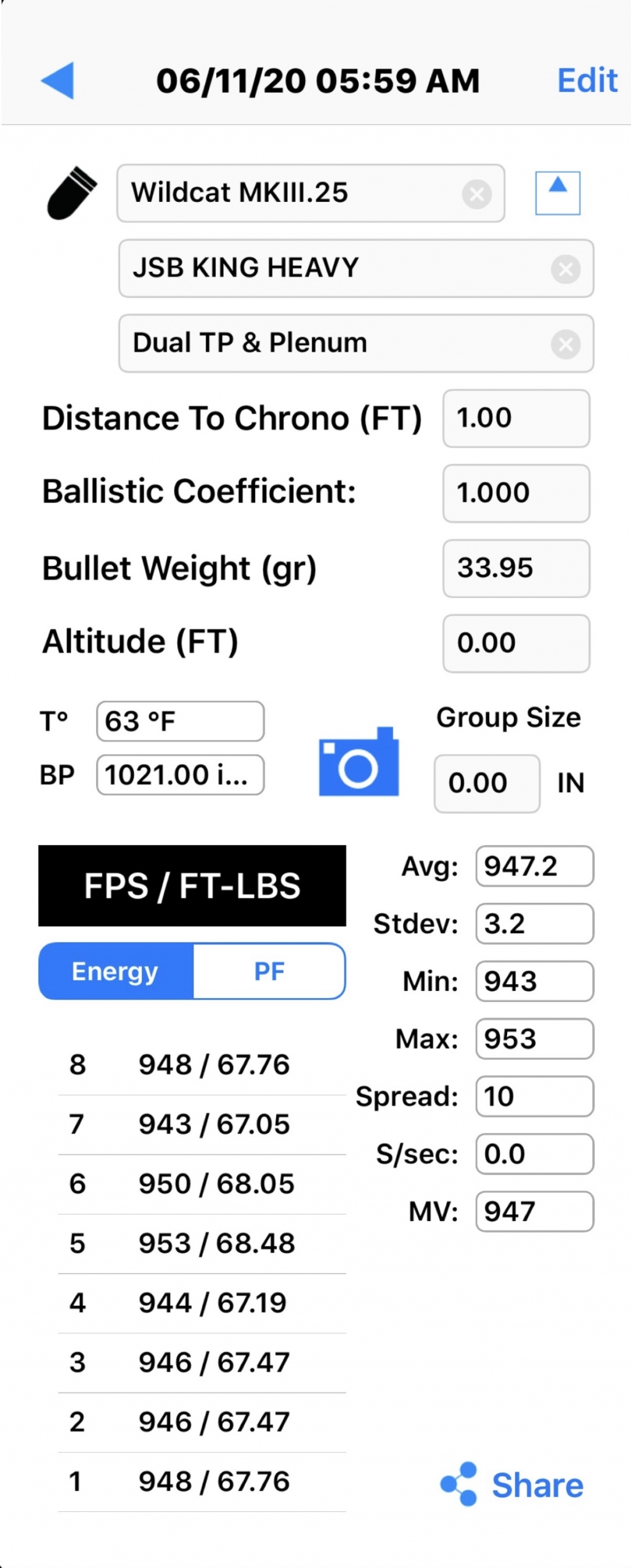

Hey JoeKool...with that 2.5" plenum shooting 33.95s at 960 fps for 70 fpe, what kind of accuracy are you getting? Also, what slugs are working best for you?

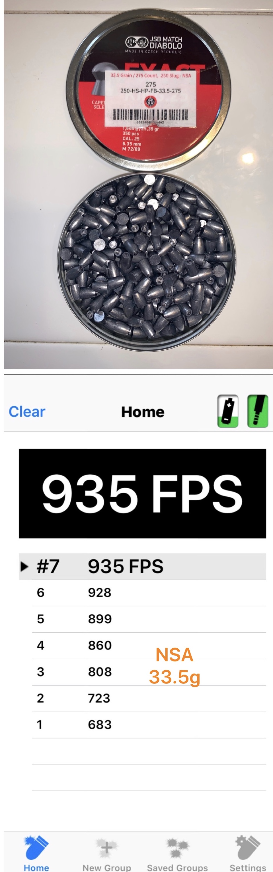

Accuracy is superb! I use Nielsen Specialty Ammo, 26.8g, 29.5g and 33.5g. The 33.5 g are my favorite for this gun.
