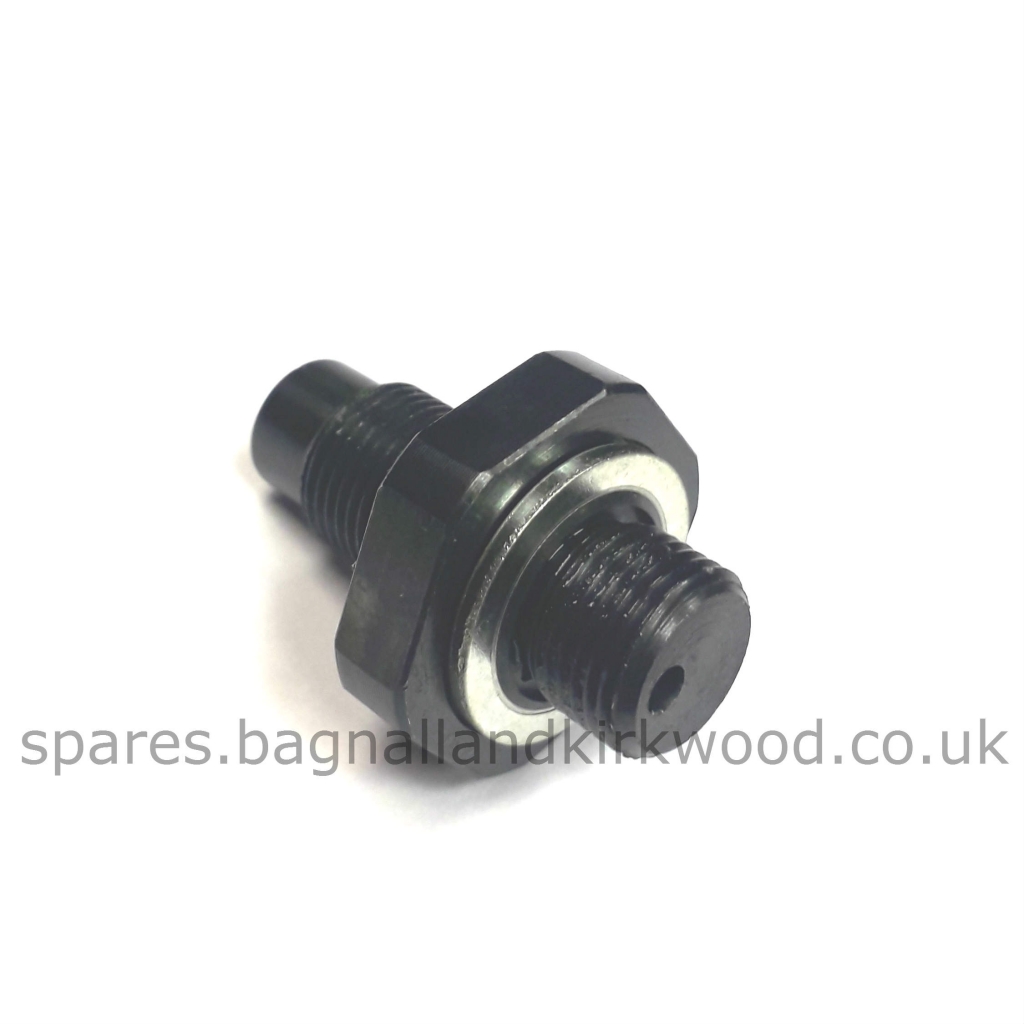

Do you need a cylinder / block adapter drill if it has a small hole , such as small on adapters of other models FX ? If it's such a small hole the added plenum is worthless.
Never been a problem with my WC MKII or MKIII. The air pressure flows well enough I suppose. Kind of like in the micro bore hoses that we fill our PCP’s with. Wouldn’t say the plenum extensions are useless. My foot pound energy shot up from out-of- box 50-51fpe to 67-68fpe after the install.
That part you pictured may be for the UK 12 foot pound version Wildcats? Could be mistaken, but mine has a full bore hole, not the tiny hole like the one in in that photo. But IDK?? Non-issue for me..

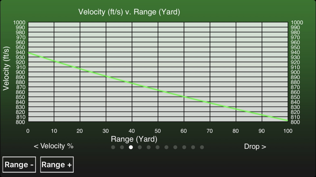

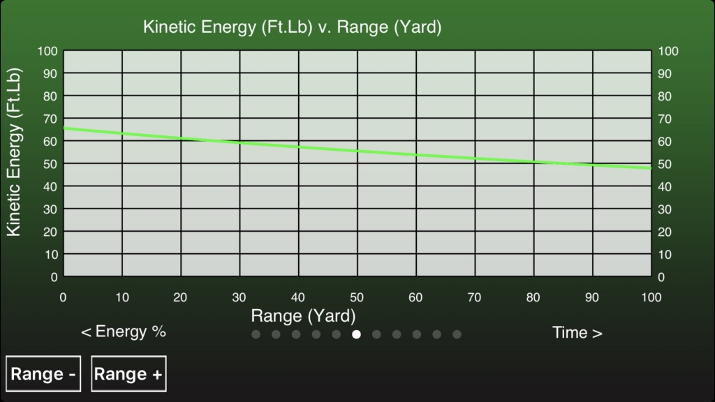

Hey Joe,
Curious what software/App is providing these graphs for you?

Hey Joe,

It’s the ChairGun mobile application.
A Apple iPhone app. Don’t know if it is on other mobile platforms??

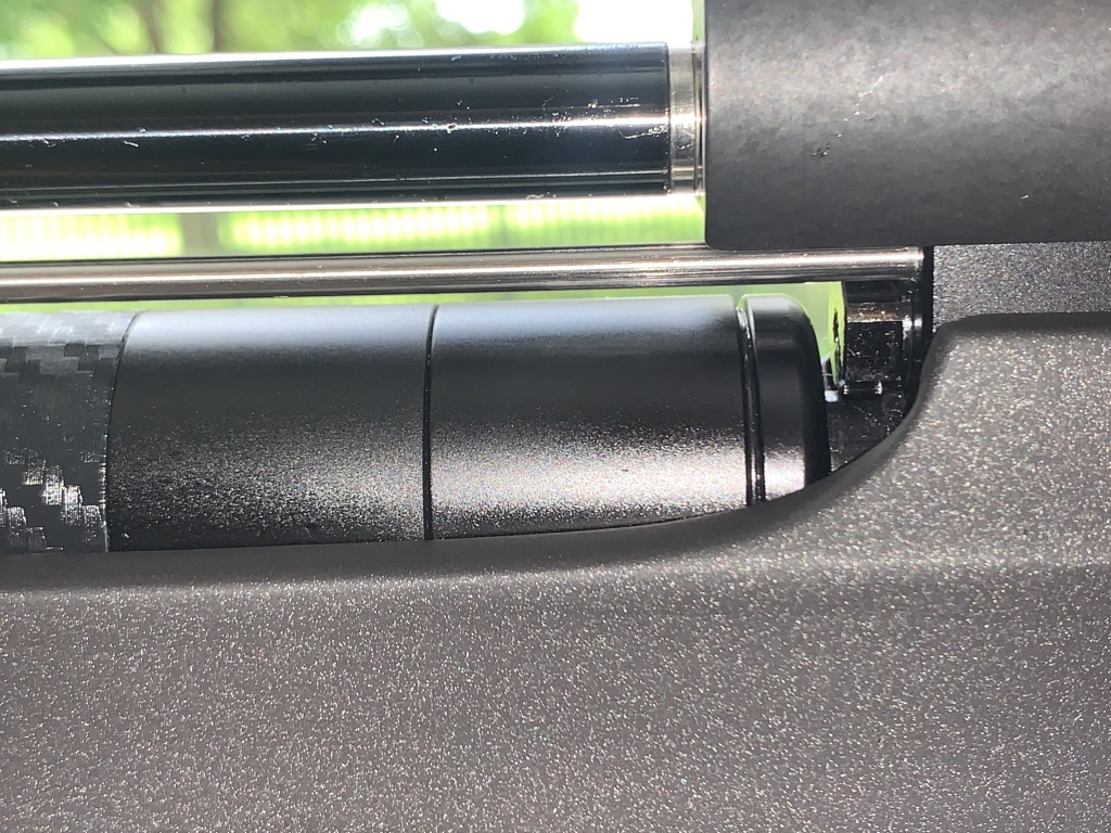

I'm interested to see if the new barrel band improves accuracy. stays the same, or creates weekly POI shifts.
Accuracy is the same to better. Only thing is it is very important on trigger pull and follow through to pay close attention to those shooting behaviors. Because it will put the pellets exactly where you aim so improper shooting habits or techniques will be accentuated. The gun will definitely tell you what your doing wrong. I don’t follow what you mean by a weekly POI shift? The barrel band is solidly attached and will not move with even a somewhat violent knock. May as well be welded to the air cylinder. Can’t get anymore rigid.

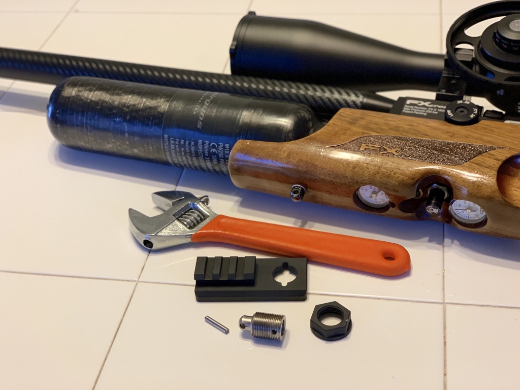

Hi Joe,
you mentioned that you filled up the small gap that is created by installing the DL power plenum . What size rubber ring will do the job ?
have a good day
Yalel
I really have no idea the size of the o-ring. It is just a thin one I found in my stash. I purchased a lot of FX Wildcat, Streamline, Crown, and Dreamline o-ring replacement kits from eBay. It’s one of those.
