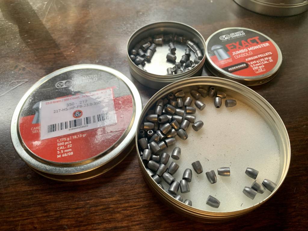

Today, I decided to break out my two Bull-Pup PCP’s, their choice heavy JSB hunting pellets, their favorite Nielsen HP slugs, and my digital caliper. The PCP battle ground was the backyard range shooting a white painted gong at 100 yards flinging 5 shots for each projectile. Just a quick group size contest I conducted between my two FX Bull-Pup babies.

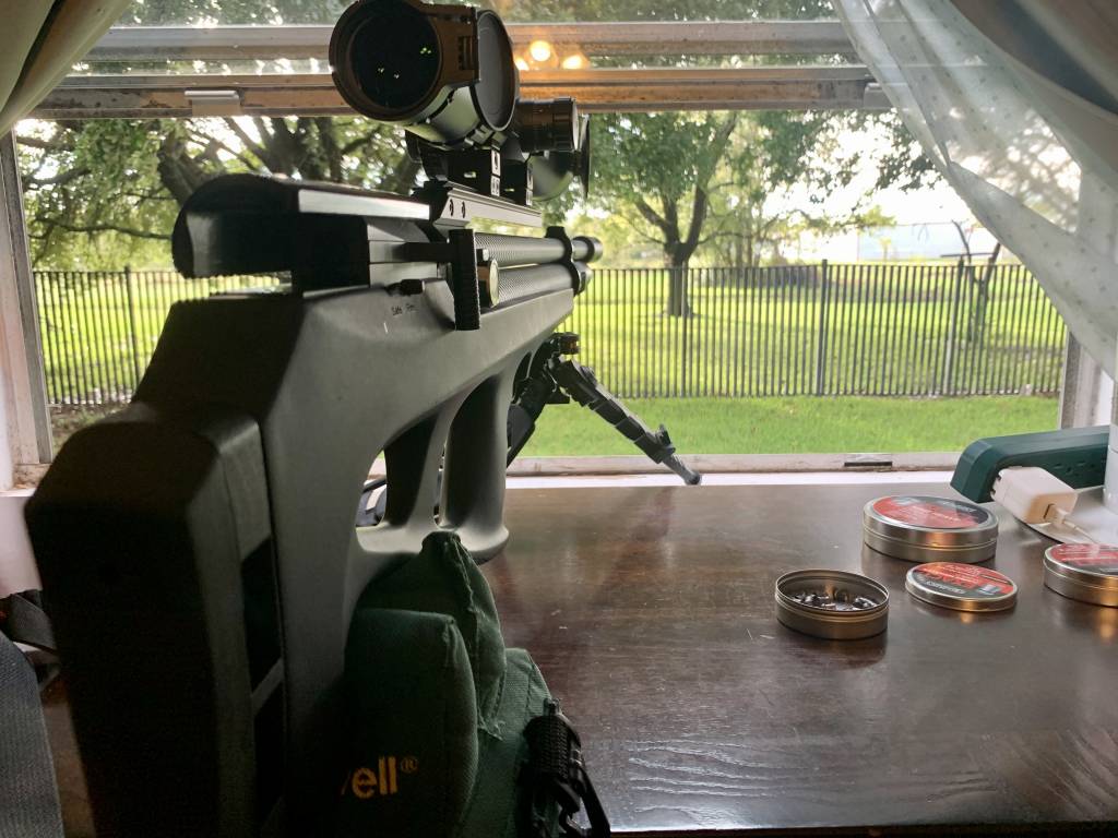

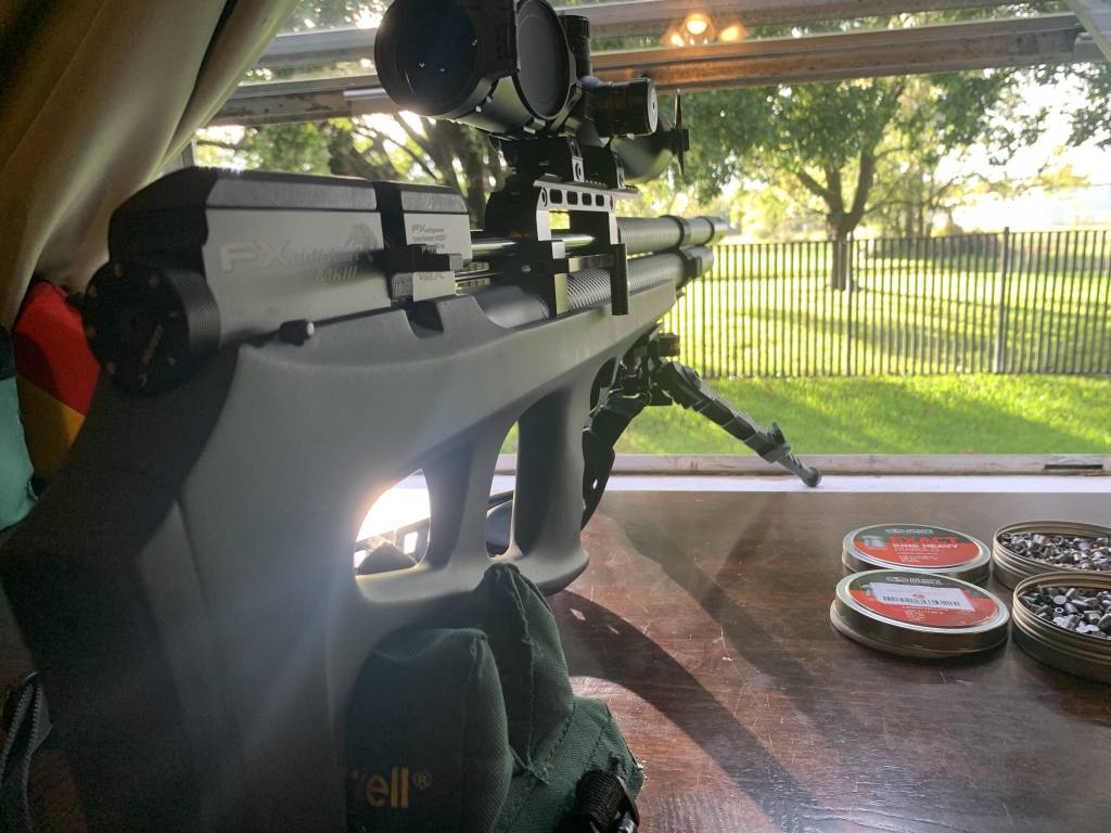

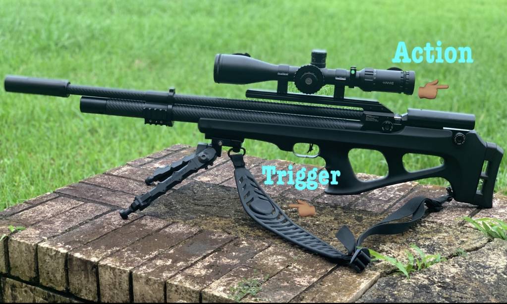

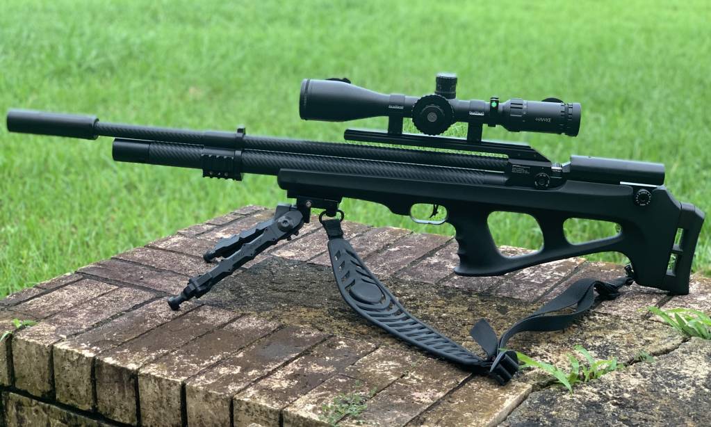

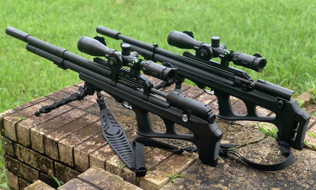

Here are the PCP’s.
MKIII (front) - DreamPup (back)
Wildcat MKII Sniper .25
DreamPup .22

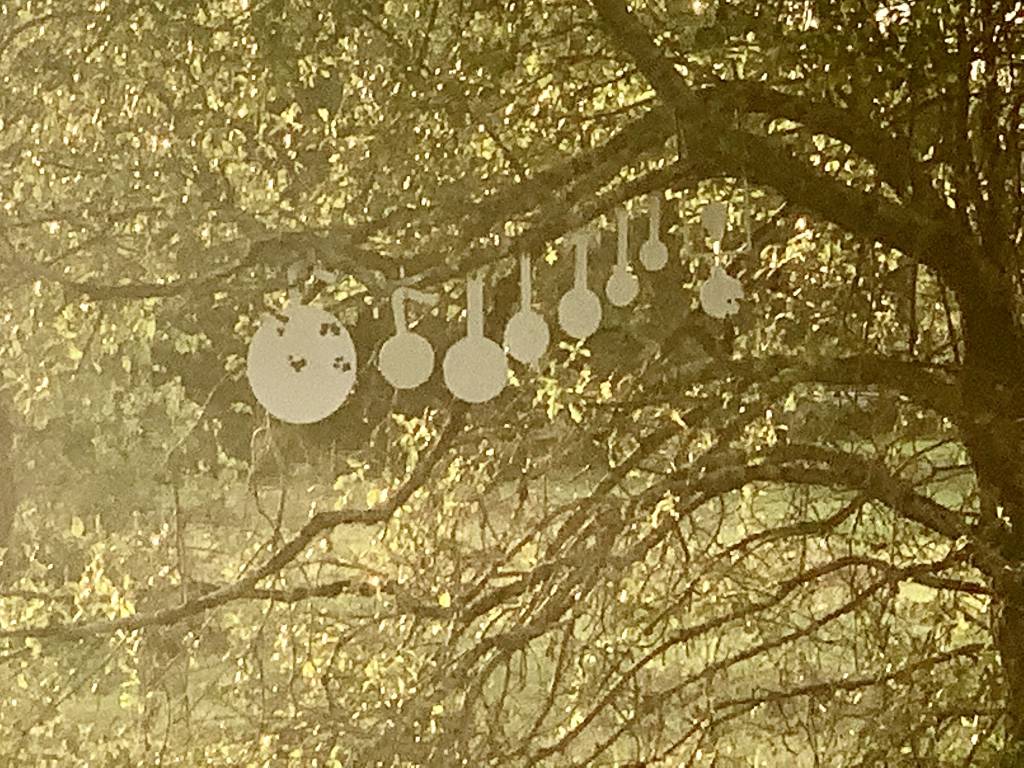

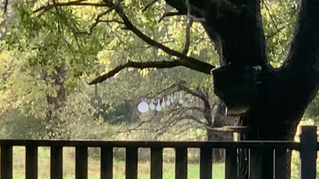

100 yard Gong aka “The Backyard Range”.

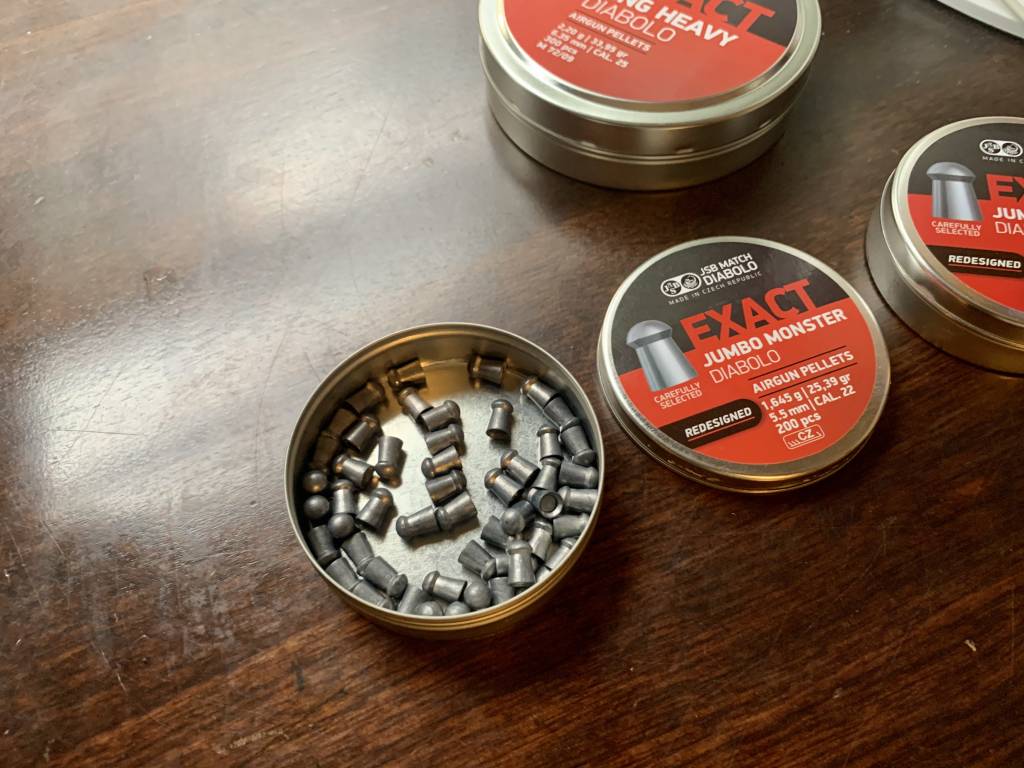

Up first, the DreamPup .22 shooting JSB 25.39g Jumbo Monster Redesigned, 5 shots at a 100yrds.

Now, it’s time for the Wildcat MKIII “Snipe-Doggy-Dogg” .25 at 100yards for 5 with the JSB 33.95g King Heavy.

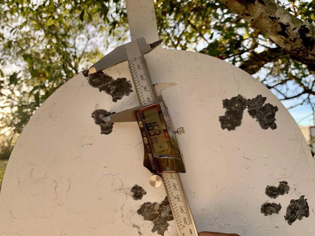

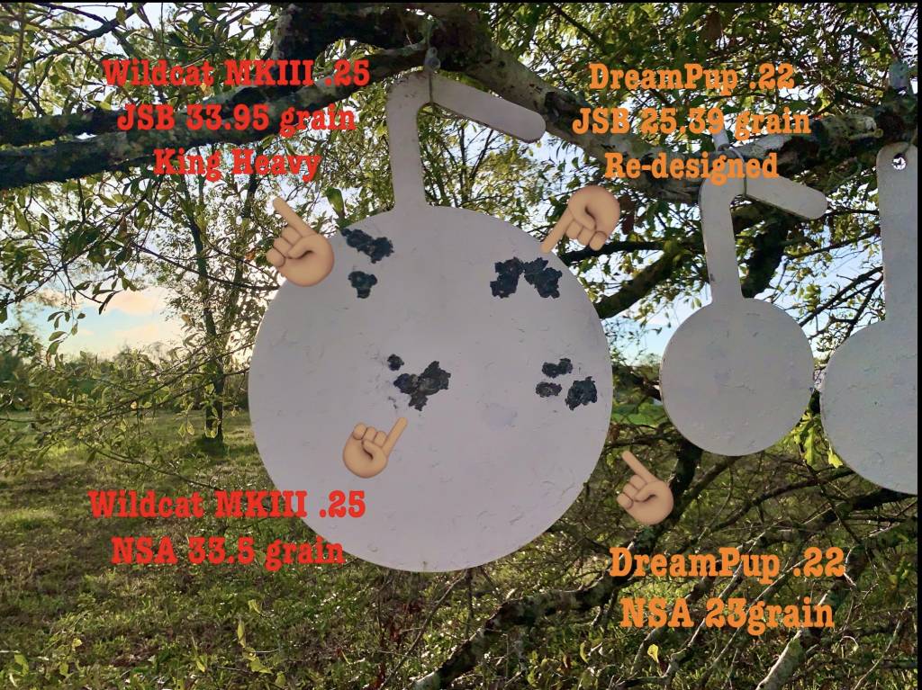

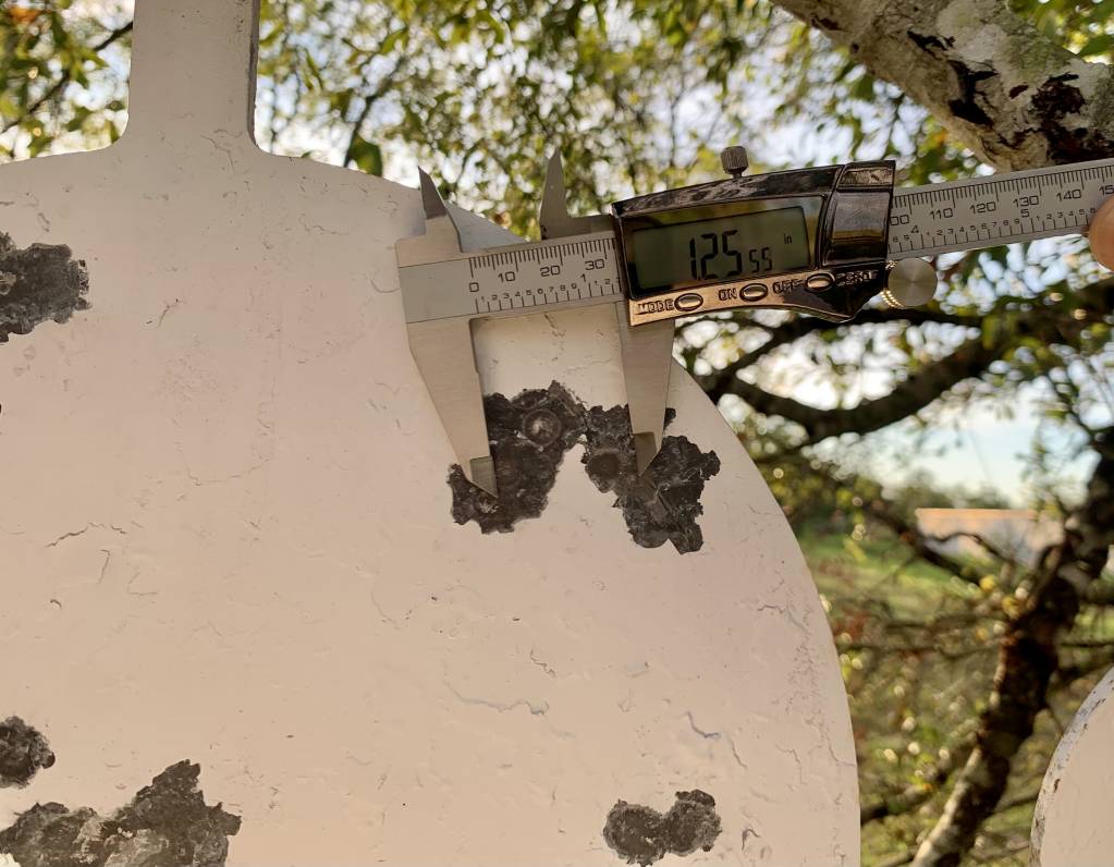

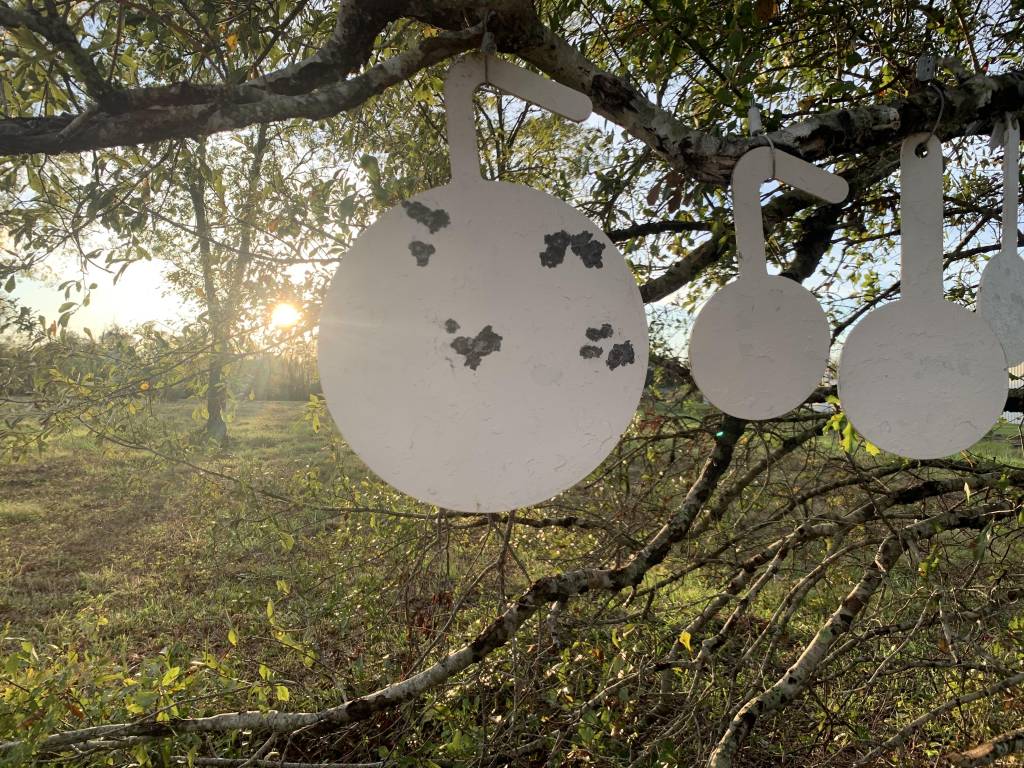

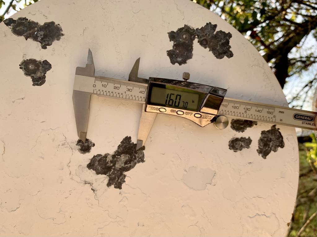

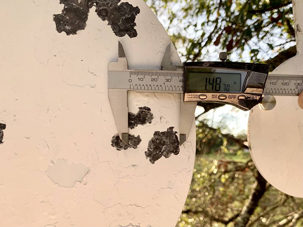

All groups completed, I walked out with my digital calipers to get some photos of the gong targets and measurements (widest center-to-center) of the four groups.
Lastly, here are the individual center-to-center 5 shot group from 100 yards measurements. The paint splatters can be different to discern, but my measurements were from the center’s of the projectile’s lead impressions on the steel gong.
DreamPup .22 JSB 25.39g Redesigned = 1.25 inches
DreamPup .22 Nielsen 23g HP Slugs = 1.48 inches
Wildcat MKIII Sniper .25 JSB 33.95g King Heavy = 1.63 inches
Wildcat MKIII .25 Nielsen 33.5g HP Slugs = 1.60 inches
Like mentioned, at the start of this post. These Bull-Pups have got me spoiled, all under 2 inches from 100 yards! Fair is fair though... The DreamPup .22 just edged out the win today in group size over the Wildcat MKIII .25 Sniper. Today.. Wonder if the results would be the same in higher winds? Thanks for viewing!

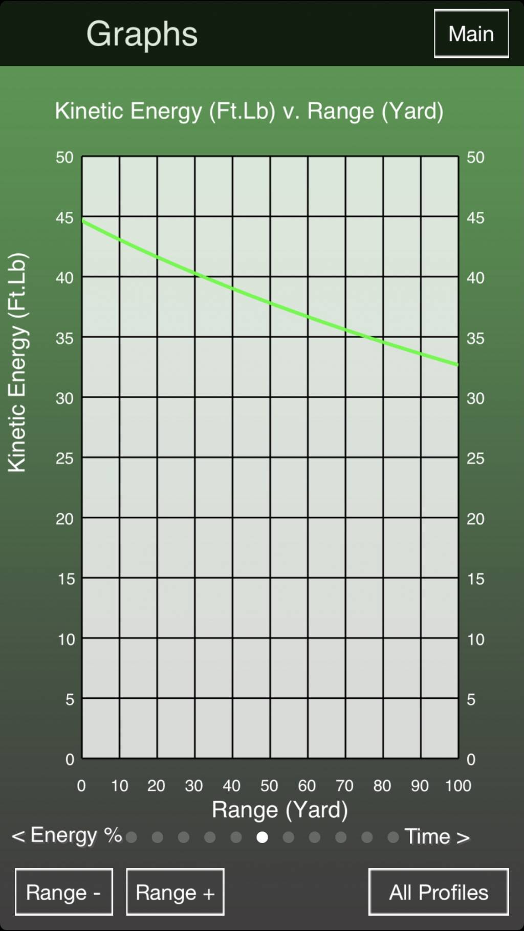

What kind of velocities were you getting with the .25 vs. the .22. Is the Wildcat quite a bit more powerful or not?
Thanks.
Thank you.

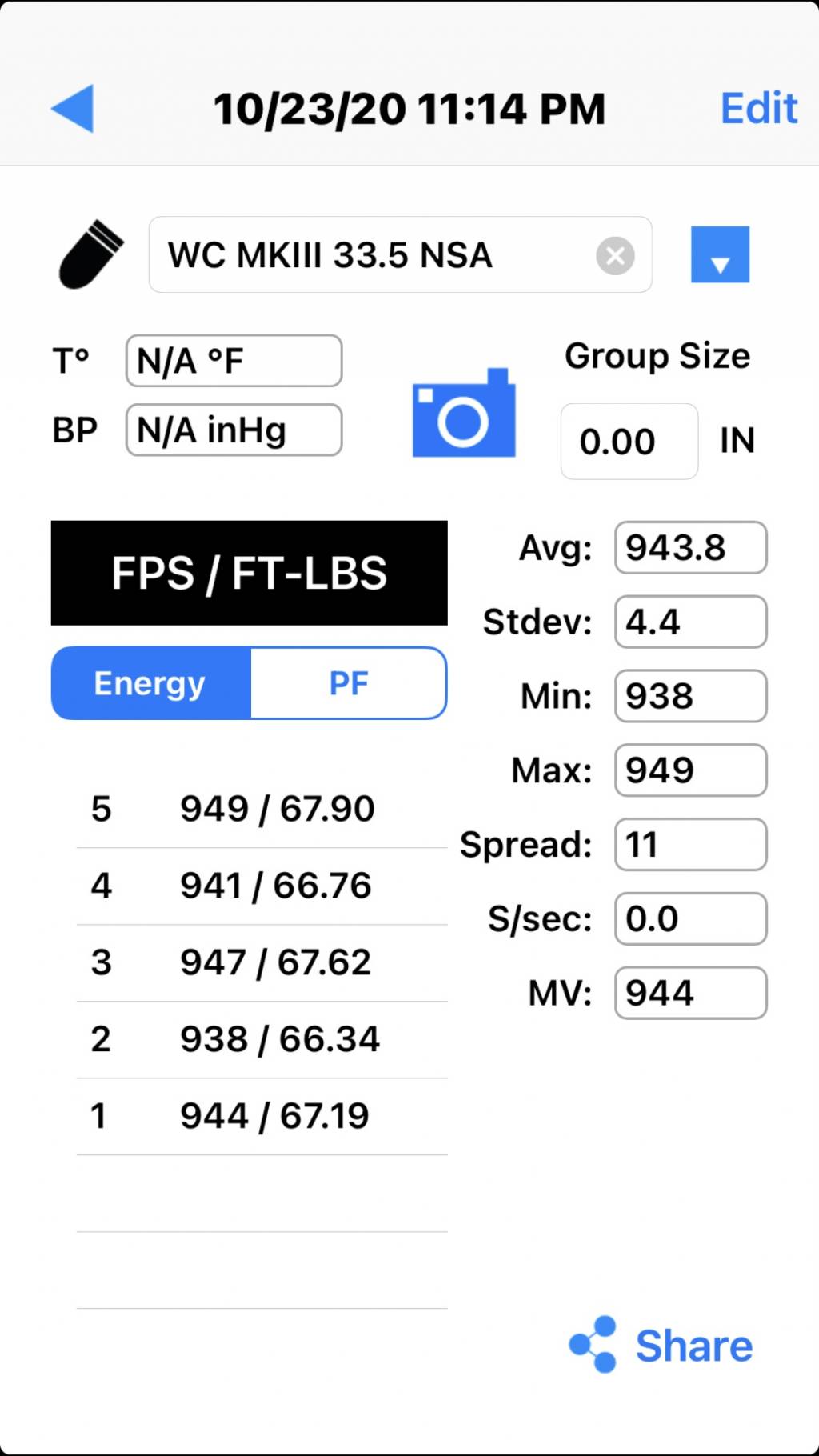

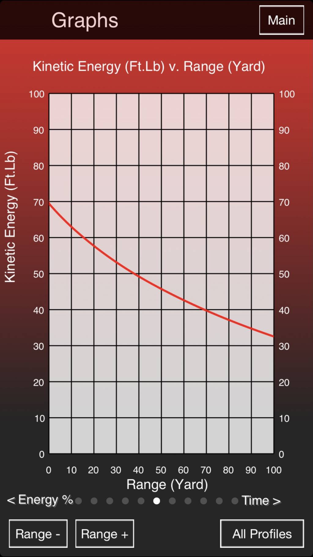

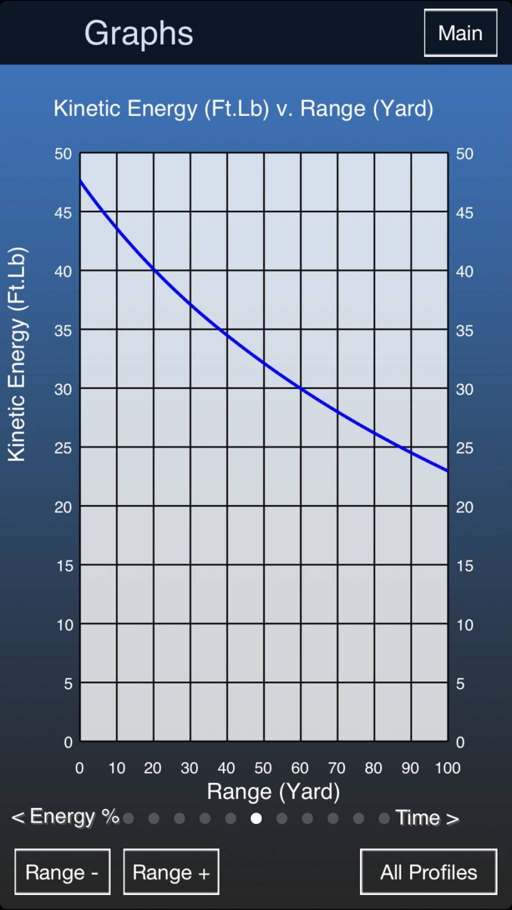

Each airgun was on their respective full throttle power tune. The DreamPup .22 adjusted to “.25/.30” and “MAX”, and the Wildcat MKIII Sniper .25 power level #7. Yes, the WC MKIII has about 20+ FPE over the DreamPup.
Chronograph’d FPS and FPE:

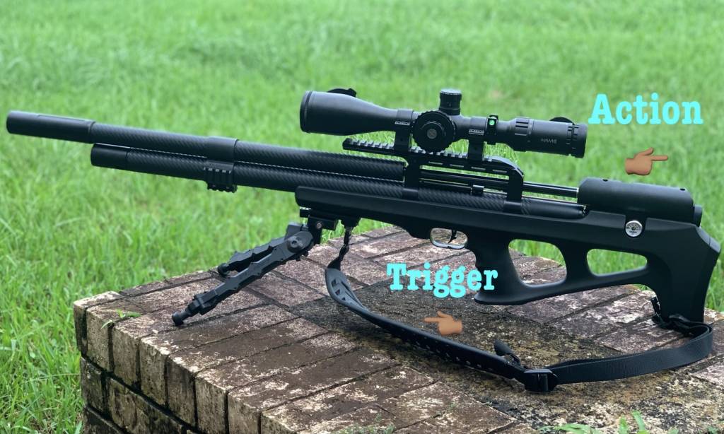

Semi-bullpups. Rear mounted receiver guns.
Real bullpups are short (most under 26", but up to 30" max.) guns made for close combat fighting. Look it up..!

bullpup firearm is one with its action behind the trigger. This creates an overall more compact and maneuverable weapon in comparison to conventional firearm designs with the same length of the gun barrel, and maintains advantages of a long barrel such as better muzzle velocity and accuracy while reducing the overall size and weight.
Limousines are not cars, they are semi-cars. Real cars are much shorter..!

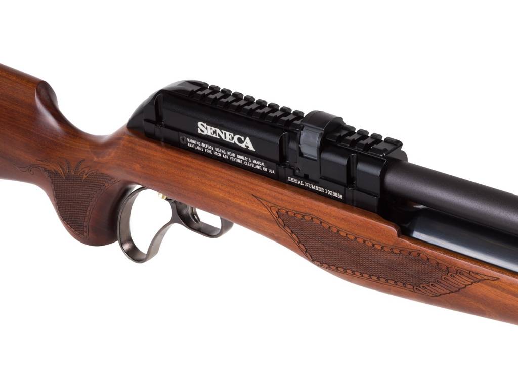

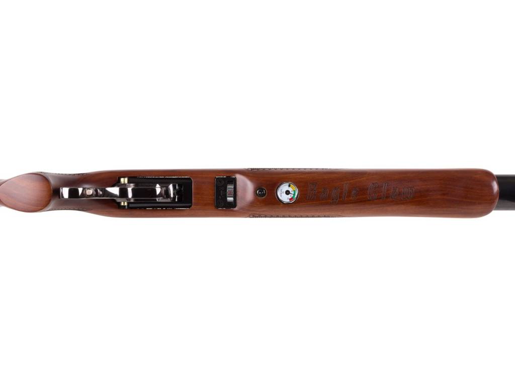

Top of my list for a project PCP air rifle would have to be the Seneca Eagle Claw, Lever Action in .25 caliber (@ $699.99). Dude, I would pop a Huma-air regulator and plenum extension in that thing. Tune her up for heavy pellets and slugs. Slap on a moderator and a quality scope. She’d be my old school style with a modern twist field PCP!!
That would be a great one, for me.

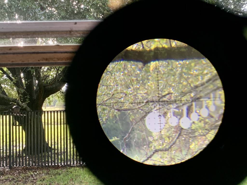

The JSB 25.39 grain redesigned pellets from the DreamPup on high power @ 100 yards need a 2-mil holdover.
The NSA 23 grain slugs from the DreamPup on high power @ 100 yards also require a 2-mil holdover.
The JSB KING HEAVY 33.95 grain pellets from the Wildcat MKIII on high power @100 yards use a 1.5-mil holdover.
The NSA 33.5 grain slugs from the Wildcat MKIII on high power @ 100 yards also use a 1.5-mil holdover.
