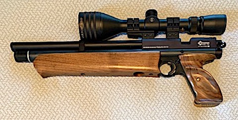

Below are my testing notes on the 1720T that I used to own.
2/21/2016- Three consecutive 5 shot groups at 50 yards averaged .66” with 8.4 grain JSB’s.
2/21/2016- Three consecutive 5 shot groups at 50 yards averaged .70” with 10.3 grain JSB’s
4/6/2016- Six consecutive 5 shot groups at 35 yards averaged .44” with 10.3 grain JSB’s.
7/21/2016- Six consecutive 5 shot groups at 50 yards averaged .74” c-t-c with 8.4 grain JSB’s.
2/27/2017- Five consecutive 5 shot groups at 50 yards averaged .71” c-t-c with 8.4 grain JSB’s
2/1/2018- Built a Mannlicher style fore-end and reduced the power to 12 FP for better PFT work.
4/9/2018- Three consecutive 5 shot groups at 50 yards averaged .76” c-t-c with 12 FP 8.4 JSB’s.
4/15/2018- Four consecutive 5 shot groups at 40 yards from Hunter FT position averaged .73”.
4/22/2018- Five consecutive 5 shot groups at 35 yards averaged .46” c-t-c with 8.4 JSB’s.
4/28/2018- Six consecutive 5 shot groups at 35 yards from Hunter position averaged .64” c-t-c.
