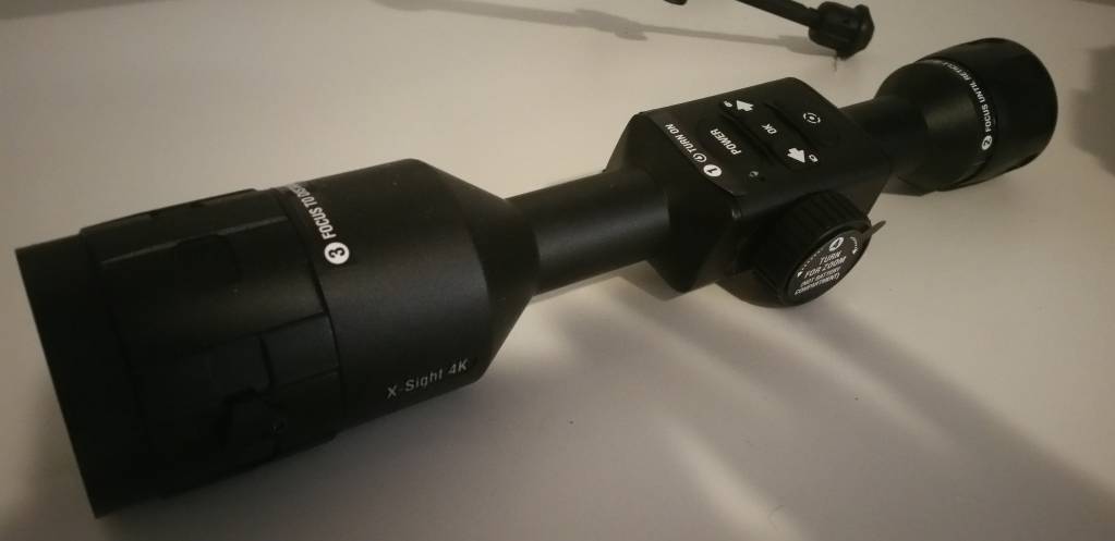

I have the 3-14X ATN 4K scope new in the box. I have not used it because I shoot my Youtube videos and I have to do accuracy tests on all the guns. I figured if I'm trying to put pellets through the same hole, i.e. achive "pinpoint" accuracy, than a digital crosshair could never compete with the etched reticle of a Helix or $500 Hawke scope.
Did I assume right?

I would have to say eventually when the resolution of the screen gets so poor that you are unable to see the target well enough to place your shots. Then the glass scope will win the accuracy contest.
But from my experience with the scope that is going to take quite a bit of distance for that to happen unless you are shooting at very tiny targets. Like a couple of hundred yards or better would be my best guess.
You will however be able to see the pellet holes in your targets better with a glass scope at 100 yards than with the ATN

Besides the clarity comparison at far distance I would say its pretty able. The pixel zero adjustments while zoomed are really tight increments. Its also fine to run night mode during daylight, won’t hurt the sensor and sometimes it helps in low light or just improve contrast to see rings and holes on paper targets. Recording in 120 frames per second is good for video and watching the pellet in slow-mo.
ATN have given me a problem with these scopes, having 4K in the product name, when the sight are only able to record 1080p, and as far as i know the screen in the sights are also not 4K, the sights could use a 4K sensor and then do 4 in 1 pixel binning to ramp up low light sensitivity that way,but i dont think that is the case.
IMO that is faking it.
We have long see the same in the Dashcam marked, now these dashcams will output a 4K footage, but it is 4K up scaled form a 1440p or 1080p sensor and so the image quality are not better, and no one should buy one of these fake 4K dashcams.
My ATN 4K scopes are just as accurate as any of my other scopes. You can chose a reticle that is just as fine as those in the Helix and Hawke. I have also found the video quality to be clearer than using a phone mount or even the Tactical, I tend to get glare from those mounts, but don't with the ATN Scope. Resolution will degrade when you zoom in with the ATN, which is why I prefer the 5-20X over the 3-16X ATN scope, No zoom at all gives the highest resolution.
