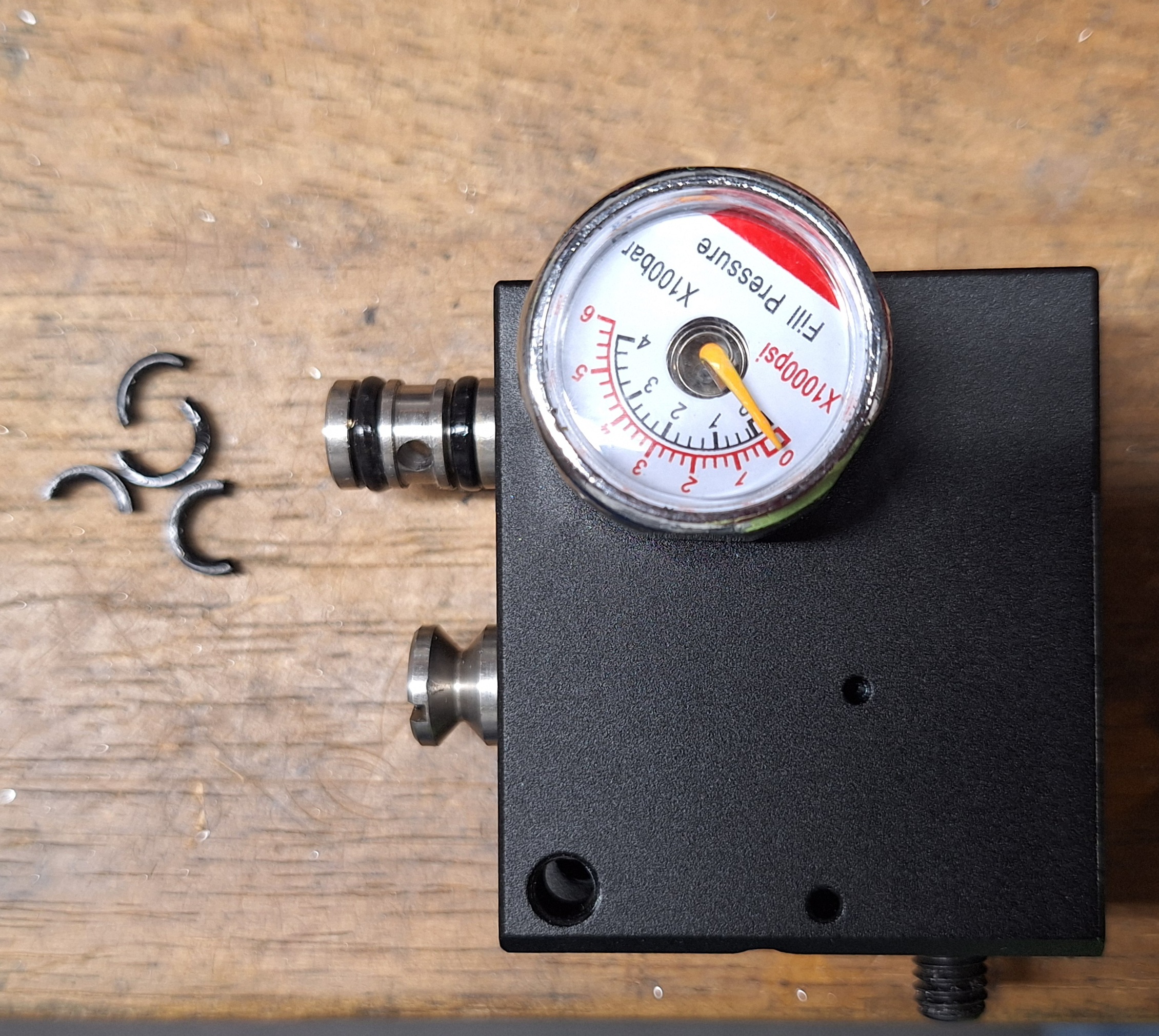

I don't know if your found your leak yet? But I've been finding a common leak that sounds like it's a valve leak but is in fact an external leak from the receiver block.
The pin is called an axle on the schematic drawing. If you remove this part from the airgun and it's easy to pull away, the orings are junk. They've been dry rotting. It's an easy fix but a frustrating one to find if you don't know about these orings.
I've replace these two o-rings twice already - along with many others - finding the same thing - o-rings are deformed and both hard and brittle. These are also an o-ring that the kit includes in two different durometers (70 & 90) - same size but different softness - if you gently squeeze the o-rings sideways, the softer ones easily squish out of round between fingers and the higher durometer ones are noticeably stiffer - require effort to deform them - only obvious if you have one of each to feel the difference.
The brass "plug" that the block fits into also has had deformed and brittle o-rings on it for me but I had to make a tool to unscrew it without damaging it.
