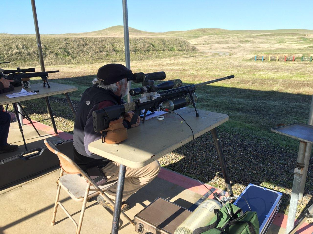

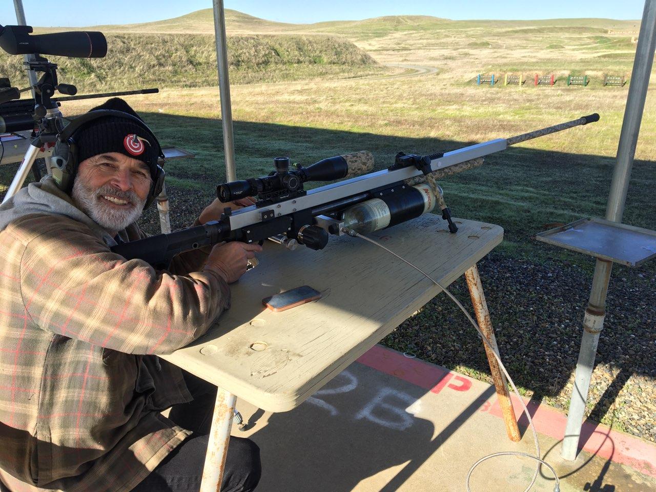

Scott H came up last month and we shot at IONE for the Long Range silhouette match.
Scott H shot his newer 308 PCP Rig and I got to shoot his 7mm PCP rig that has won at EBR ( Arizona ) a couple times being a VERY capable rig !!
The match with some sighters and for giggles shots likely @ 80 shots with the 7mm going out as far as range allowed ... 500 meters !!
The 7mm was solid out to about 350m or so, but wind shifts made any accuracy beyond that iffy at best.
Scott H with his .308 monster !!

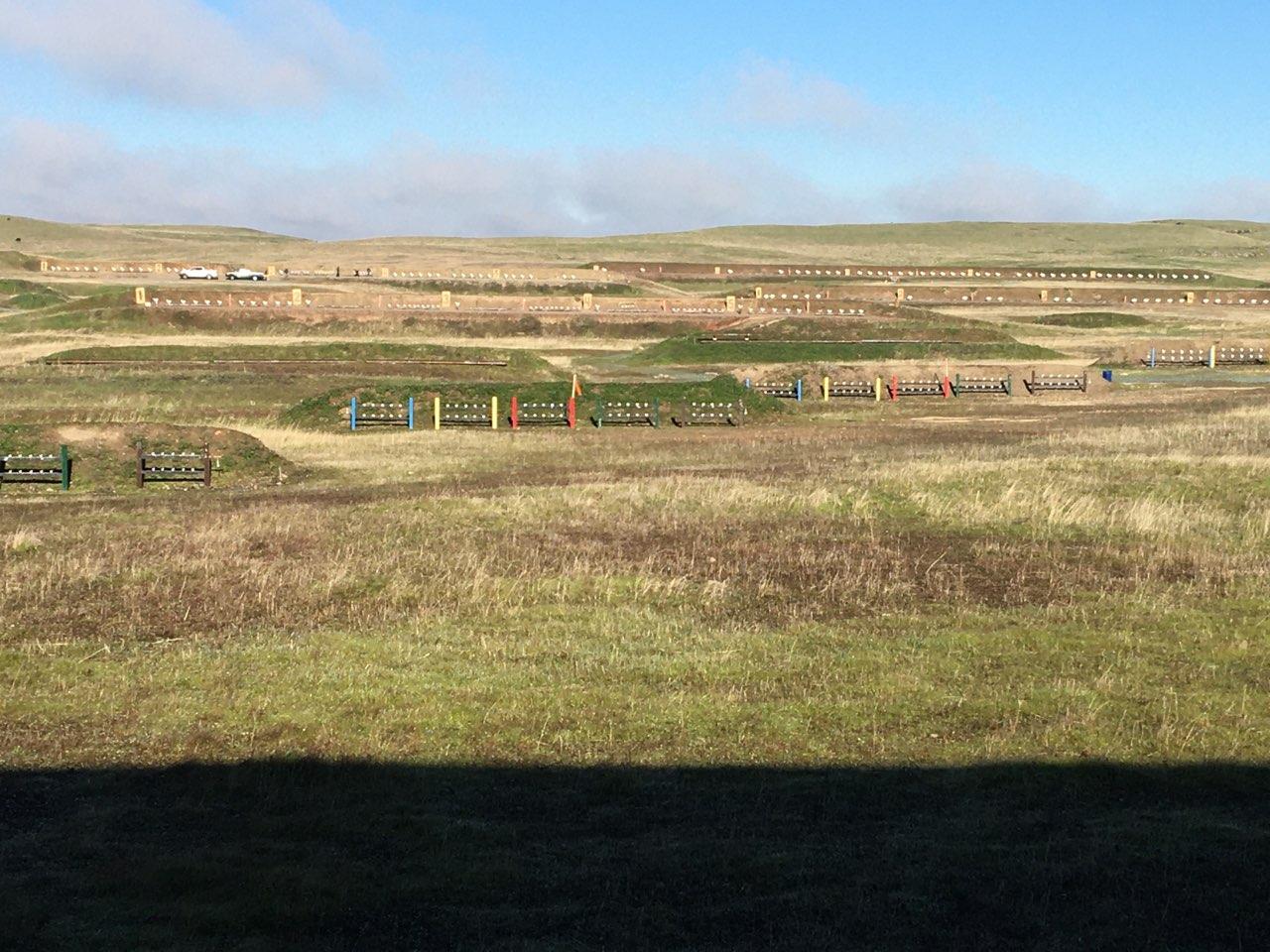

The Ione 500 m range
Myself with the 7mm beast

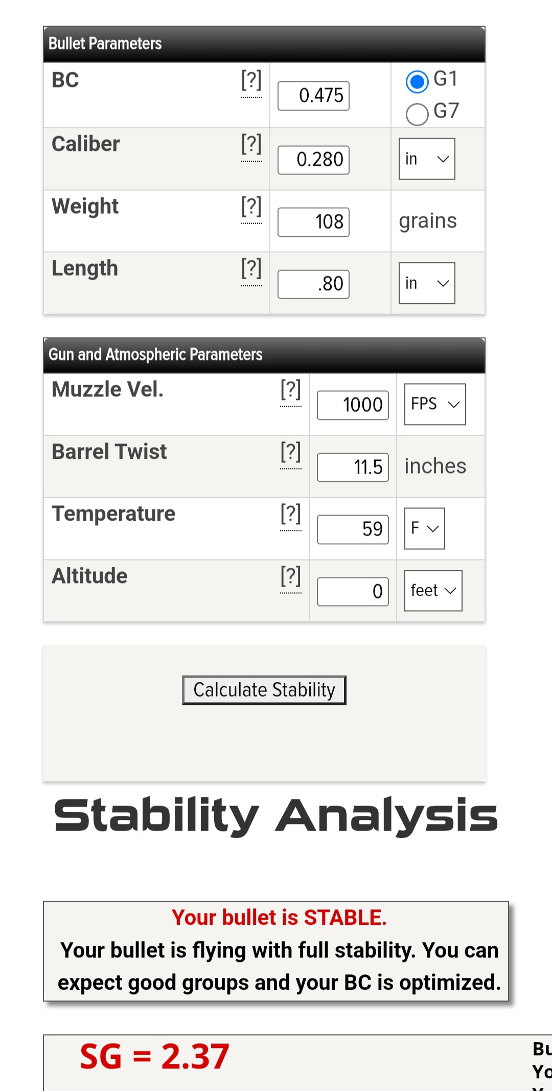

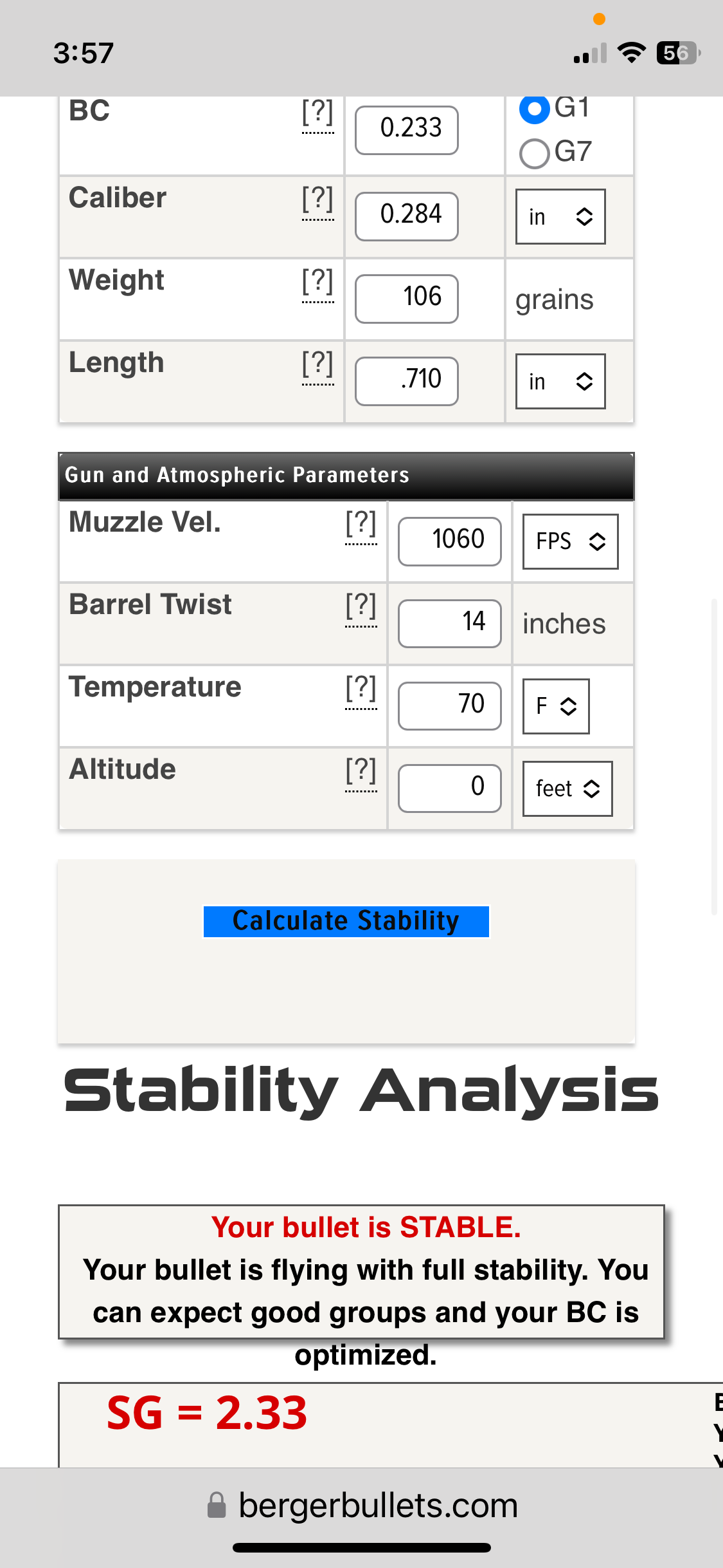

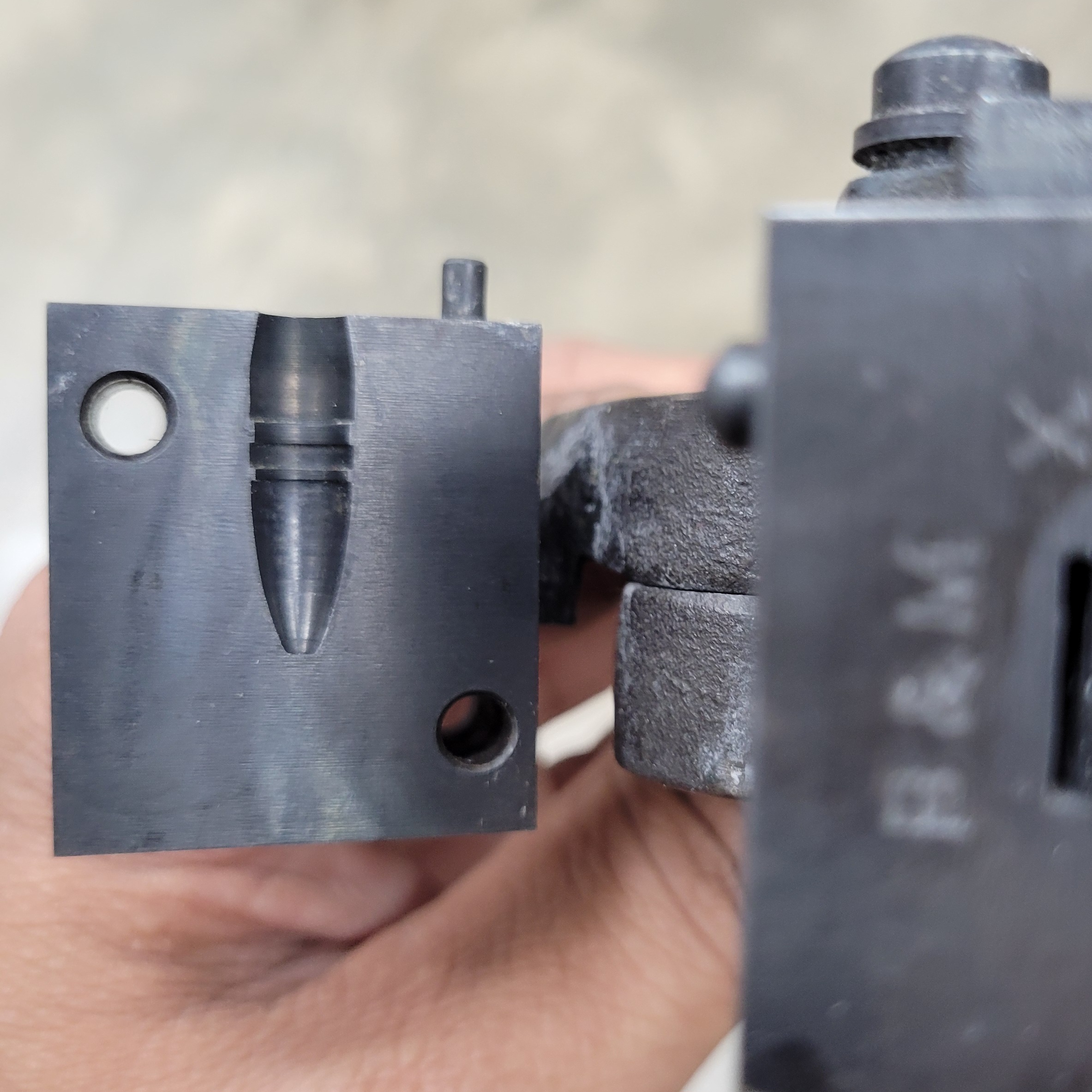

The 7mm twist rate aviable at tj , are either to fast 1-14 ot to slow 1-18 .. the first 7mm air gun I saw was a corsair by Cedric with the 1-14 and it shoot great but only slugs from 135gr n up not to many guns with the juice to push that weight at 950fps at that time. And only 2 or 3 molds aviable on that weightn. now there has been a few texan buids when the 1-18 was made . But I imagine that wasn't stellar either .. why I must think that the twist is wrong.. some air guners kept using the rule of the 1.5 of minimum stability factor n that rule doesn't apply to pcp in a PB you could always ad more power but we can't add more air.. in post about the .257 was a line that said.. I don't know why the combination of the 1-14 and the 257-420 would so good , but it does.. when you use the measurements n weight of the 257-420 in the 1-14 twist it gives you a stability factor of .244 way above the 1.5 .. so in order to prove to my self .. I paid for the tooling and have my barrels made.. in .224 - from 48 to 52 gr 1-10.5 .. for 52 to 57 gr 1-9.5 for 60 to 70gr 1-8.5 .. and they all work flawless for each weight n length that was intended for.. I have 3 in 257 made also but those are next to be worked on.. 1-12 for 85gr and 1-8 n 1-9 to see wich of the two work with 105 gr spizer boat tails.. all using the .244 as a base for stability.. base on that for a 7mm slug with a weight of 108gr wich is the best bullet mold aviable for 7mm this should have been the twist...that is as close as i could get it to .244 .. the caliber with the best selection in molds is the 257. For casters 6mm. N 7mm is a hard choice . very little variety of molds.. n for me would suck that in order to shoot i have to keep buying slugs at $25+ by 100 slugs.

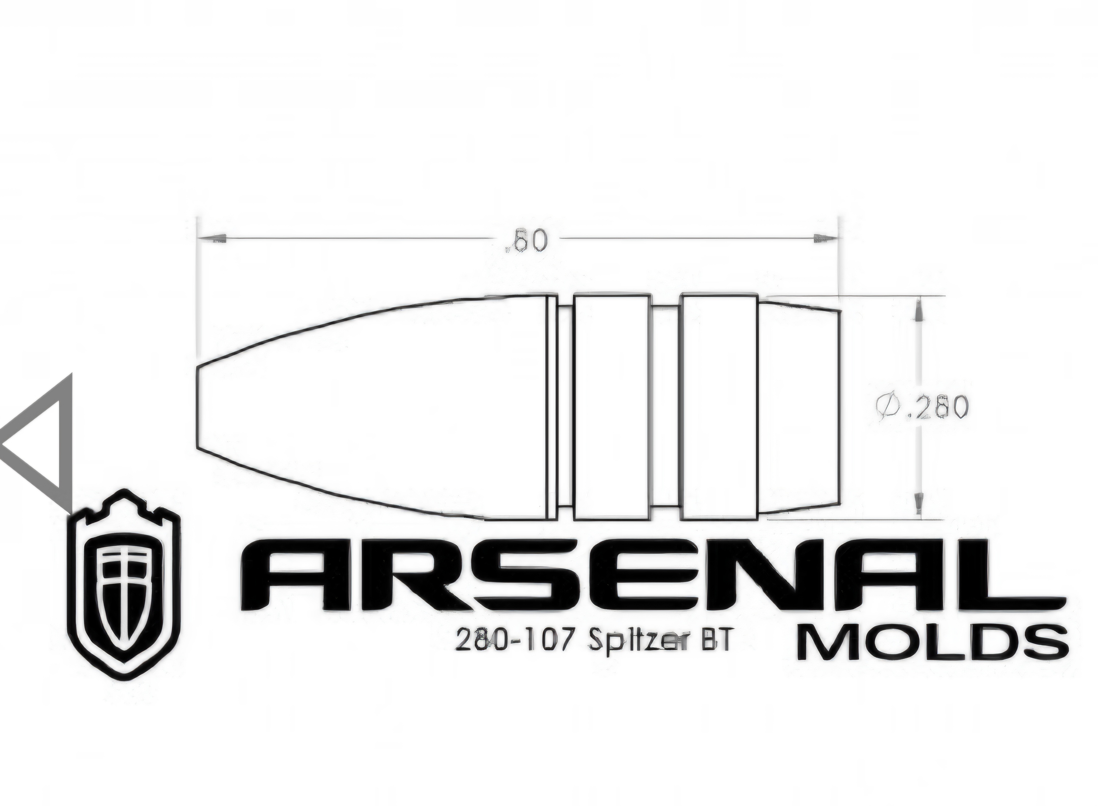

They are probably trying to make the 7mm airgun caliber comparable to the 6mm PPC of the powder burner world. I do offer 130gr. .285 for airguns and blackpowder.
