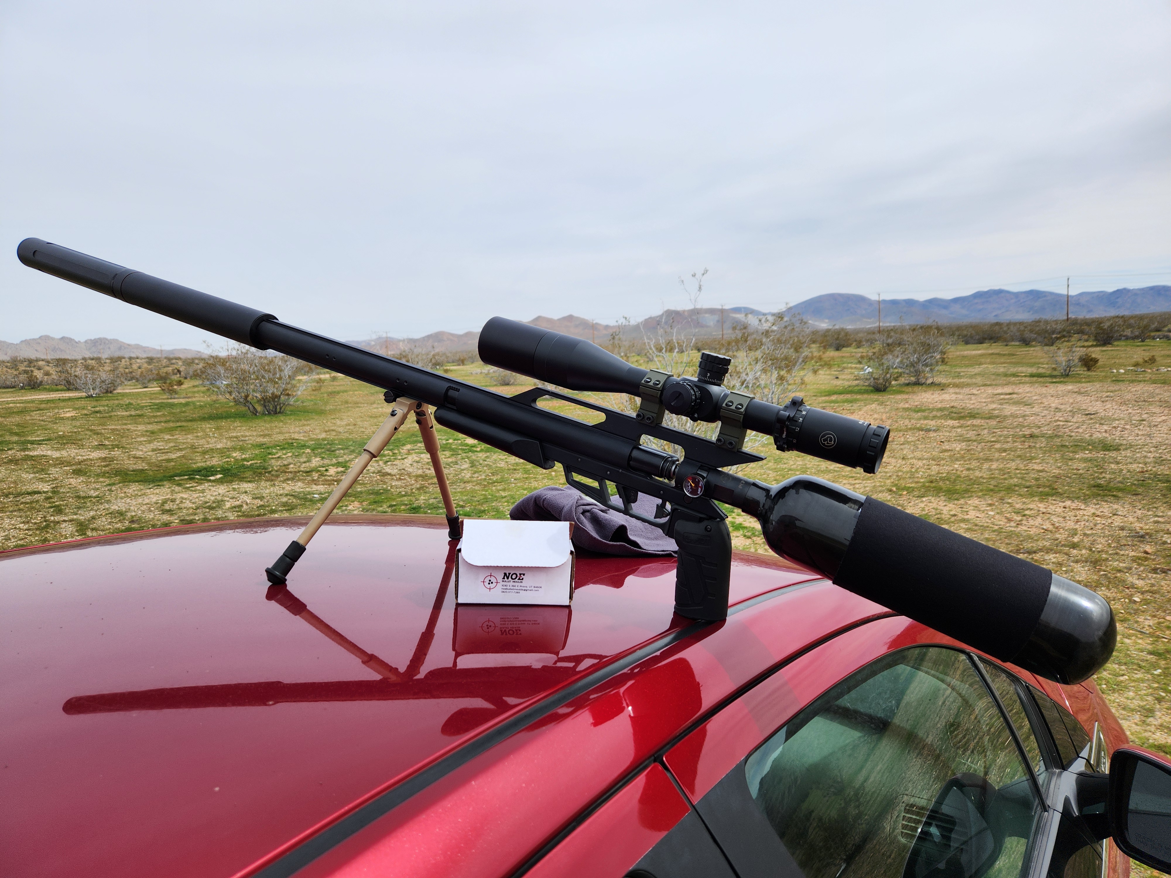

The 257-420 bt will work better in the 1-14 .. the one you have.. was successfully used up to 1000y but with a 1-13 bull barrel.. i have 3 different twist in 257 .. 1-12 .. 1-8 .. 1-9 but no machinists.. same for my 224 .. they barely came machined well enough to be tested.. the bullet mold in the picture is a B&M iron n cast at 92gr spizer bt .. the other is the 257-418 n that one cast ar 98gr .. but then again no machinists so no testing for me .. 🙃 I don't complain much because anyway I really don't have the time.. to much work not enough Days. By the way awesome looking custom rig you have built.. Good luck in this next competition season..👍👍

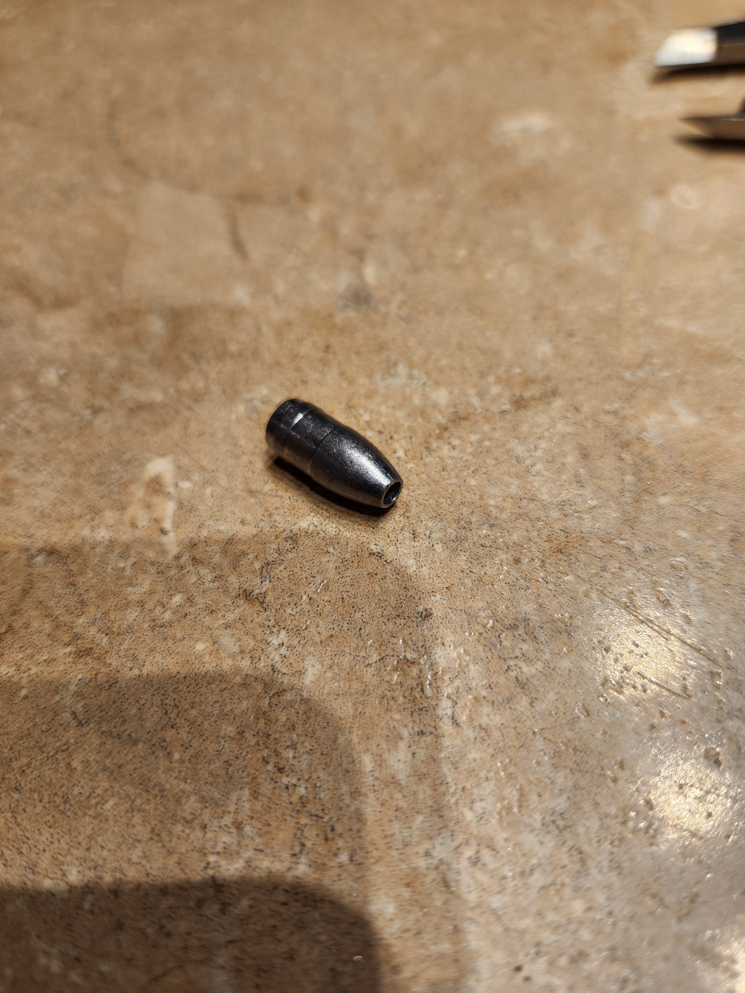

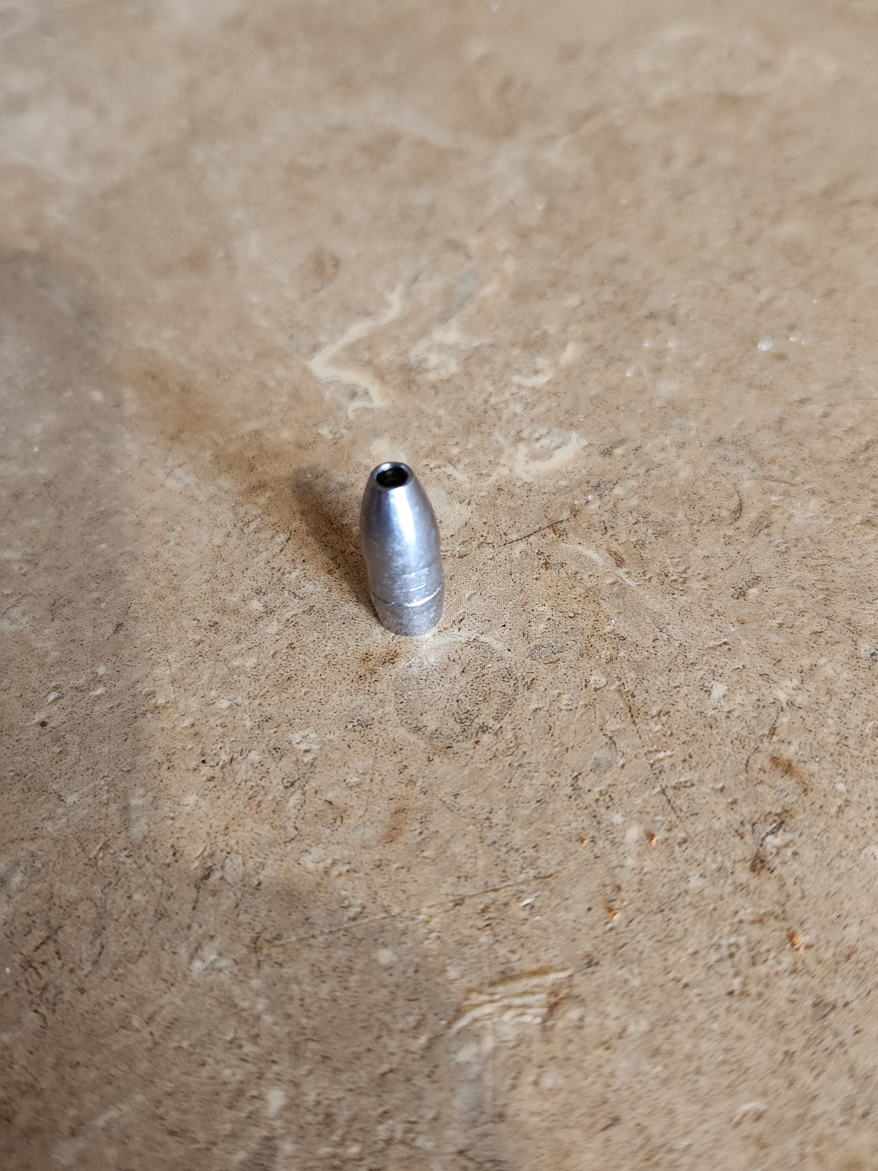

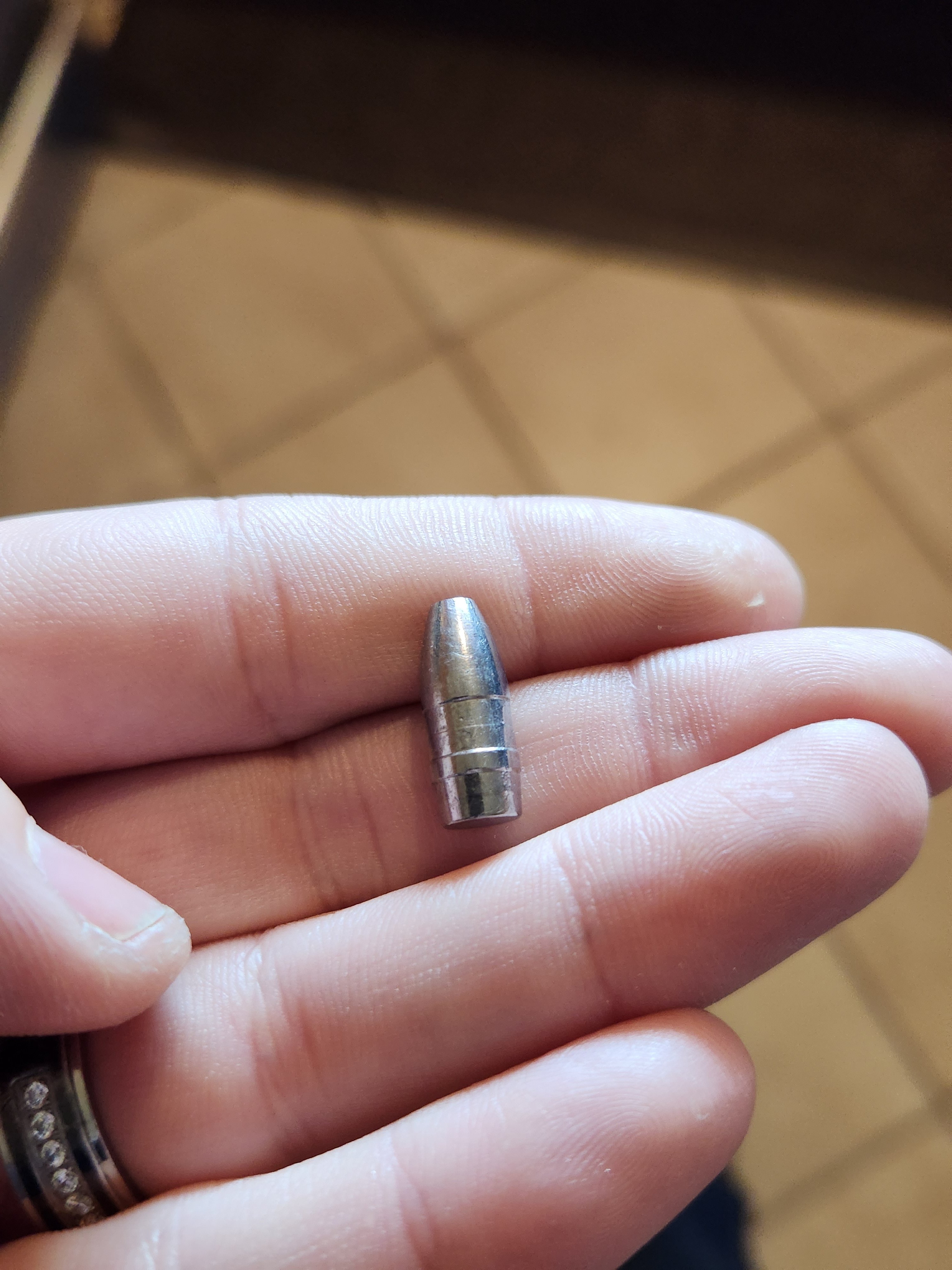

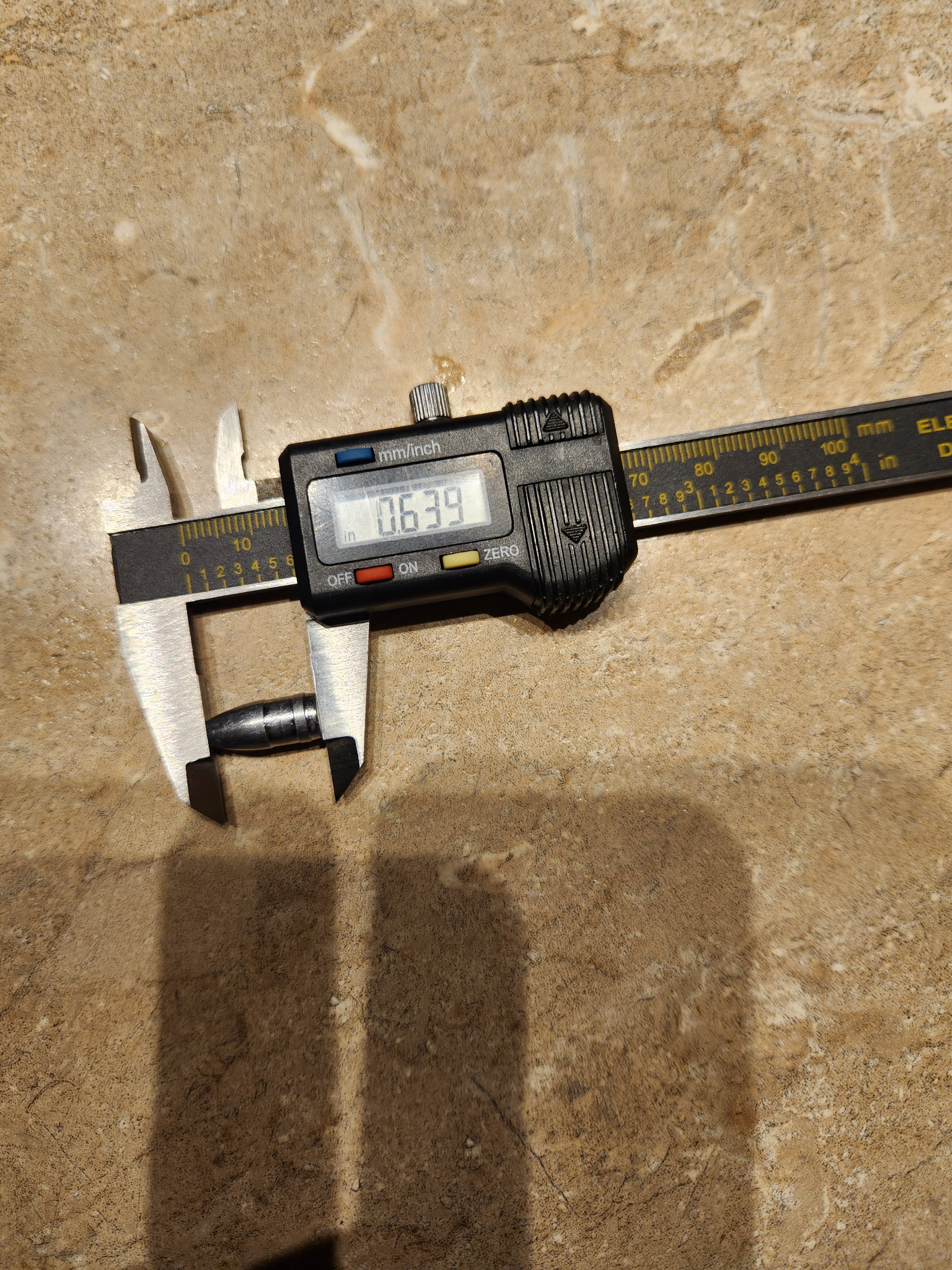

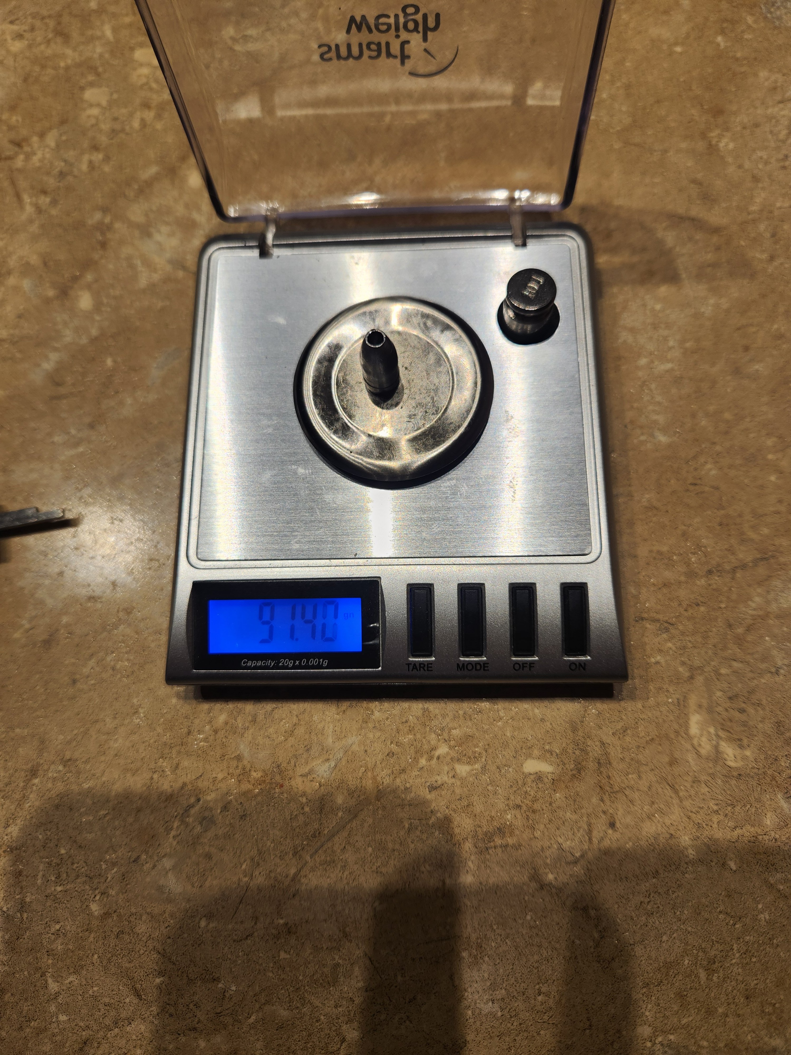

I have a 34" 1-18 .284 tj barrel on my custom texan. Its more accurate than 1-14 twist .284.I have the noe 84 gr mold which wasn't as accurate in either twist as the noe 106 mold i had decked to drop at 91grn....its super accurate with 1-18 twist at 1010fps 91grn hollow point. Its probally best long range caliber....next best is .257....I have both. .258 is good out to about just under 300 yards. .284 aka 7mm is good out to about just under 500 yards. 91 grn .284 just bucks the wind and has good bc.
