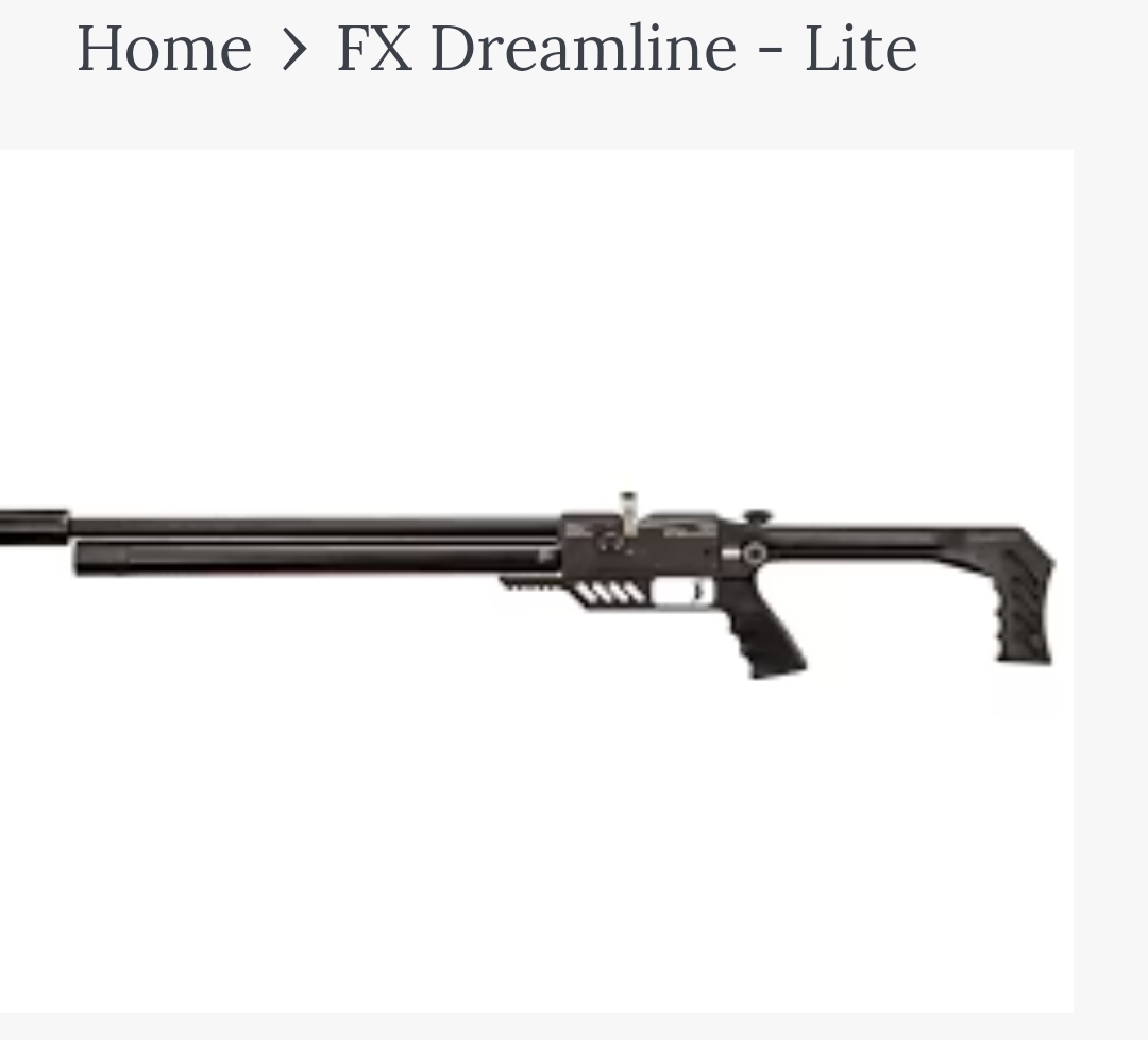

They do come with more stuff than they used to. This is only a stock photo I found where it appears to be equipped with it. My dreamtact compact came with it, the plenum, and an AR stock adapter with the weaver rail as part of the tactical trim kit. If yours doesn't have the side foster and drop down regulator adapter and is like this on pictured , there's more parts to get your 700cc on there.
ok... i just need to wait up till my damn gun comes in.. i am buying everything blind without knowing what my version has on it... its even more complicated because i am getting the weak 5.5fpe german version (original full version parts included in a bag)..so mine will come probably without the extra power plenum.. so i better wait up

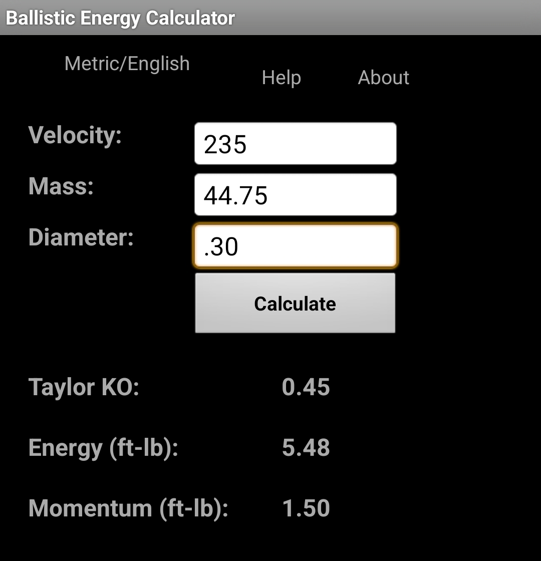

Looking for lighter pellets for a flatter trajectory for you, knowing it's 30 cal and 5.5fpe. Here's the bad news. You will probably not need a big bottle, but it won't hurt for shot count. You will likely struggle to keep this thing 5.5 and the trajectory is going to stink. Here's what I cooked up in a calculator for you. 235 fps. With your barrel it's going to be hard not to exceed that with transfer on low and regulator probably at 80 bar. Which means crazy shot counts and a trajectory like a mortar.

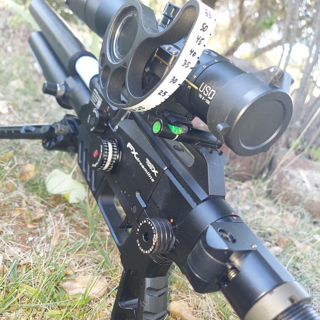

There pretty slick if you adjust power a lot ?
My Dream/Tac came with one and really hardly need to turn it once tune was established.
i see... its 2 am here and i am wide awake i think, but maybe my thinking is a little slow... why do you have 3 dials on your dreamline?
one should be the hammer power adjust and the second for the port size..
and the third one??
Reactions: Motorhead
6gun- please, stoooop it! you are hurting me with your calculations :D
do you honestly believe that i would buy an fx powerhouse to shoot it at 5,5fpe?? you know i love destruction and will only buy things which help me with my mission to destroy the world :ROFLMAO:
and the third one??
It is a INCLINOMETER to measure degrees of up/down slope.
Field Target set up having Dope correction for slope as well distance correction (y)
