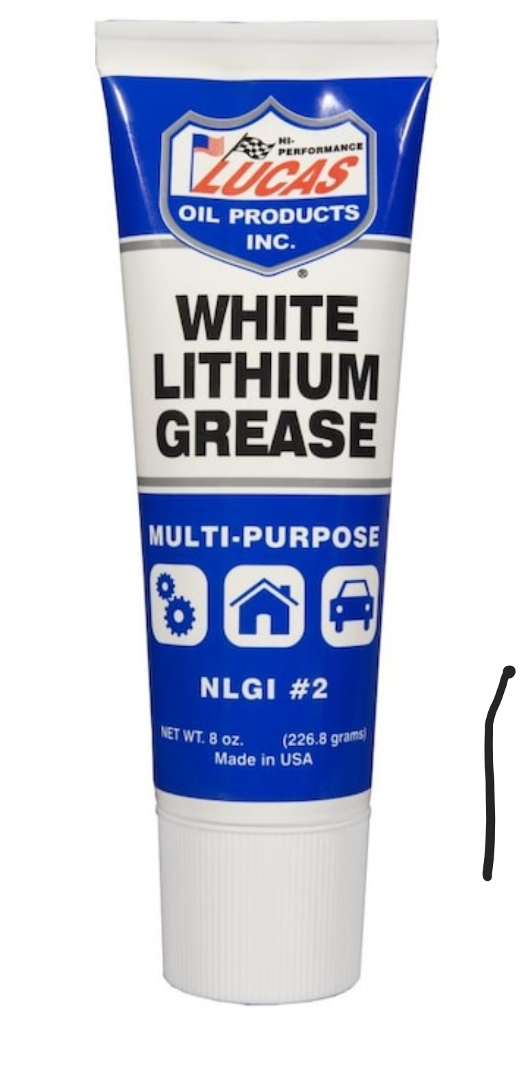

I ordered a kit Vortek (PG4) to try with a new piston seal for my TX200. Kit has a light spring tar/grease with it. There is no moly type grease.
Should I order a separate grease as well to use on other than the spring? Will white lithium grease work? I have this?

Krytox was suggested above . If you go with it you better super clean all the old grease out . I mean famn clean or youll be doing a redo to redo that ..lol.
Personally its best to use the known recomended grease wether the moly or krytox. You want to eliminate the combustion not add to it with the wrong stuff. Them little jars and tubes of recomended stuff go a long way if applied correctly. Cost for amount is a bit misleading at face value.

Surely they would not give you a lube thats no correct for the job using there parts . But strange its not regular common moly used
Maybe the " better" moly impregnated seals dont it it so somthing compatible is all you need on that.. email thrm and ask why this and not that .. maybe somthing woth the seal compound used for that application higher moly paste may not be best?
