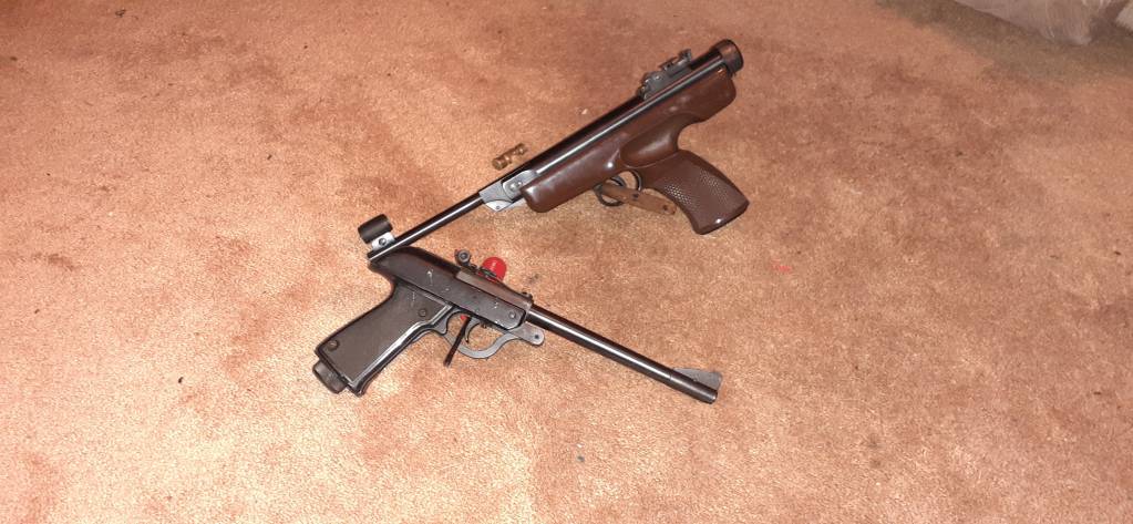

Winchester 353 and Predom Lucznik side by side.
My Diana made the model 5 pistol from 1958 to 1978,, Actually, the pistol I am shooting
marked as a Winchester model 353. Winchester never made airguns, but in the 1970s they had Diana make certain models branded Winchester. This one is a .177 and shoots 367fps averaged.
This is my Predom Lucznik WZ 1976 air pistol. It was manufactured by Zaklady Metalowe Predom-Lucznik in Radom, Poland from at least 1972 to about 1980 it is a copy of the Walther LP53. It is a .177 caliber and shoots 419fps averaged.

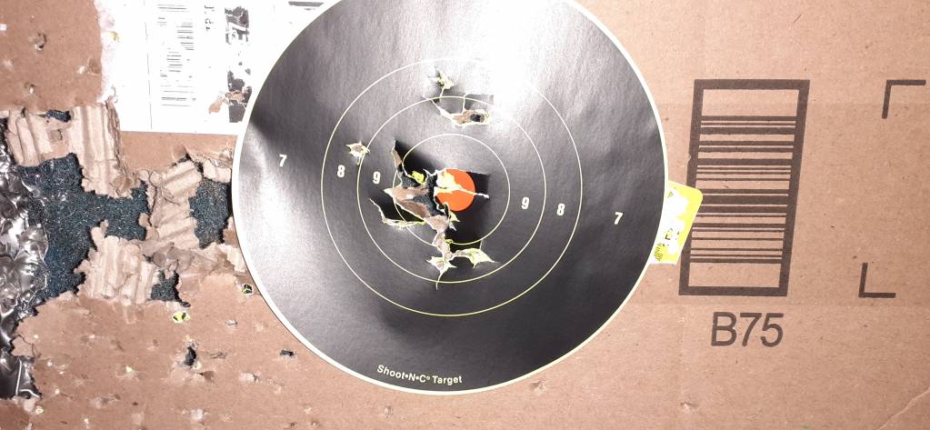

I shot these pistols side by side today to compare accuracy at 25 feet. I was shooting in a kneeling and off hand, firing 25 shots each.
The first target photo is the result of the Winchester 353 the second the Predom.
Nice shooting!
