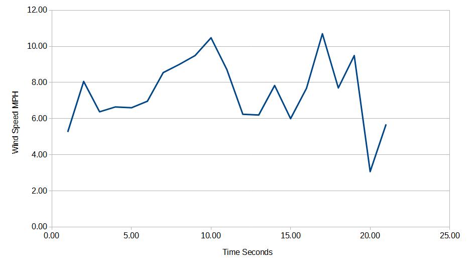

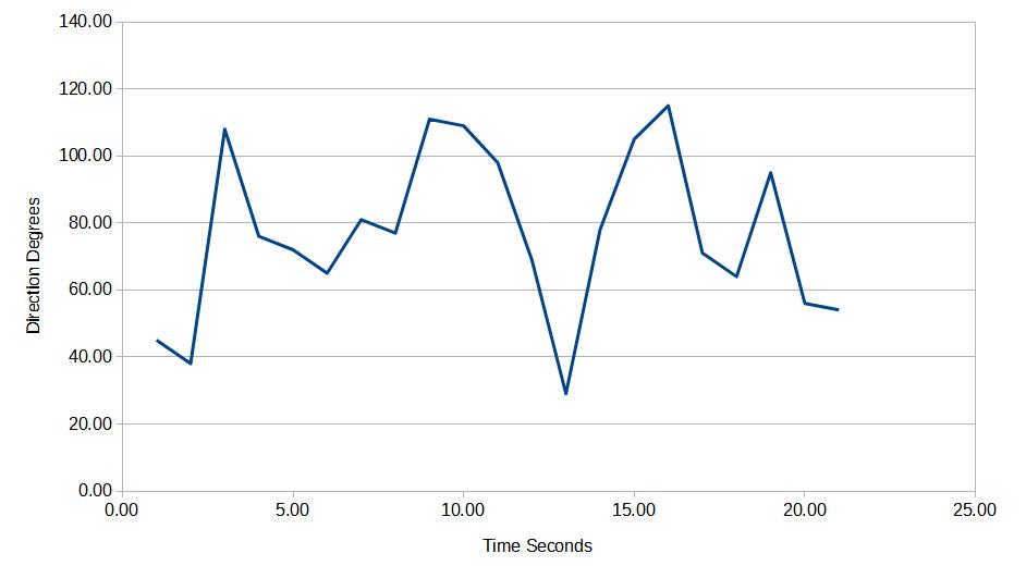

On one occasion when I was working, I got the range staff to measure and record the wind speed and direction close to the gun every second for an hour. The graphs below show twenty-second samples taken from the measured data.
The wind instrument was out in the open, away from any obstacles which could cause turbulence. The data shows it is the wind direction which gives a major cause for concern as well as the wind speed, even in the open.

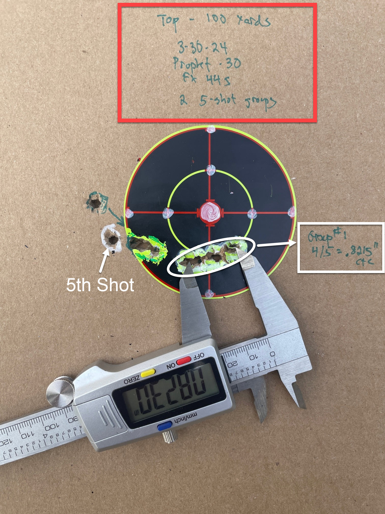

Look at these two 100 yard groups (these are darn good 100 groups for me). 4 of 5 touching in both groups, and the 5th shots get pushed way left by some “unexplained force”.
I have never shot slugs, but those who do seem to feel that they stay on their flight path better than pellets beyond 80 yards.
I’m going to start shooting and tuning for 75 yards - using .22 and .25 calibers - to see how good they can get. I’ll leave 100 yards to .30 caliber… losing interest in that distance for now.

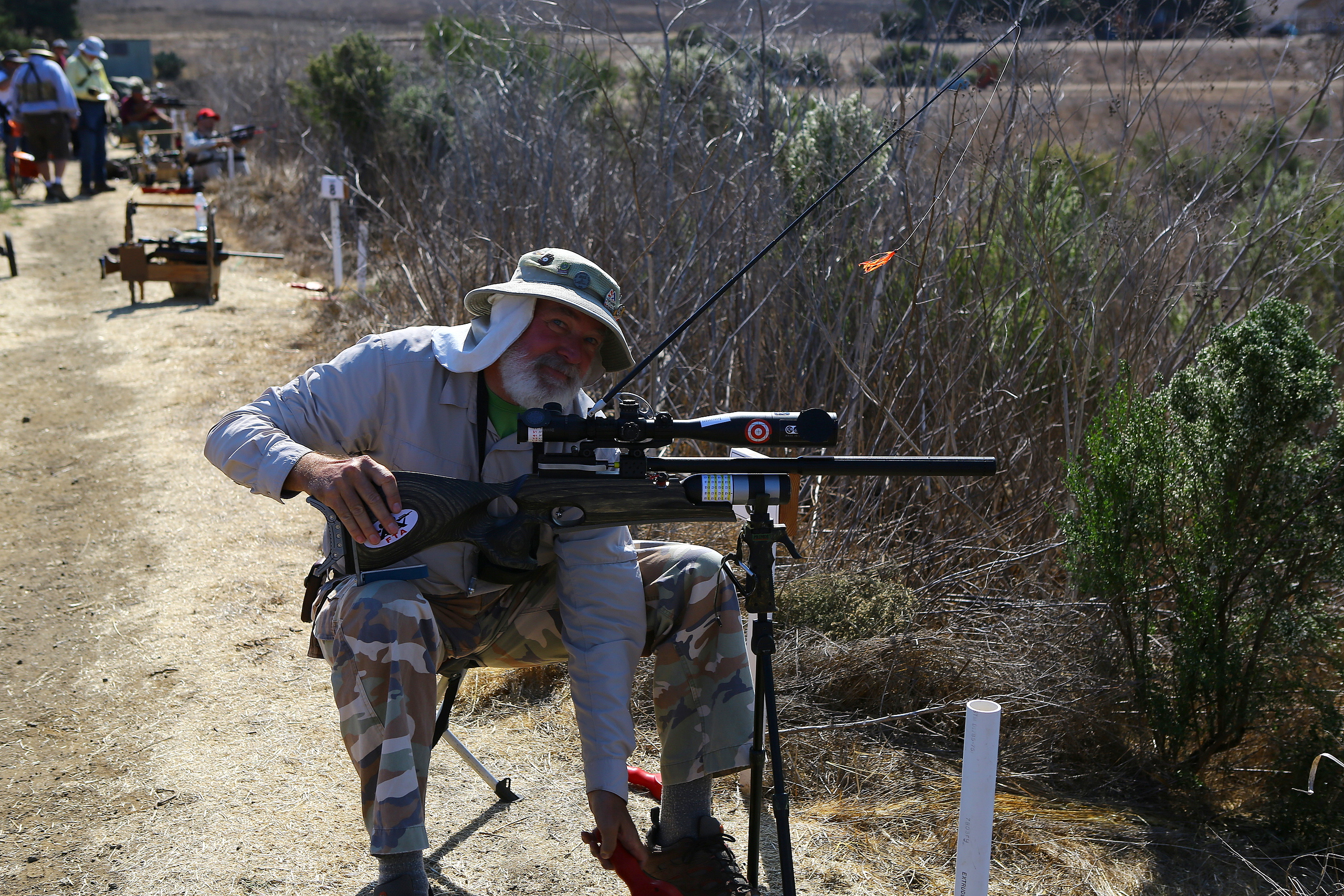

I came up with this idea a few years ago of having a telescopic mast ( Antenna ) that mounts on the scopes center line, having a drop string and custom flagging tip. * Feathers or odd shapes DON'T WORK as they flutter about, this type just sits still pretty much.
It extends out and above your line of sight threw your optics BUT CAN BE VIEWED with your non scope eye ( Shooting both eyes open )
Being it is over the scope out around muzzle out in open air it is very accurate in showing you air movement direction switches, and with some practice some relative speed changes by how far the flag is getting drawn back in the prevailing breeze.
Many of our clubs members have adopted similar wind flag systems on there FT guns :p
