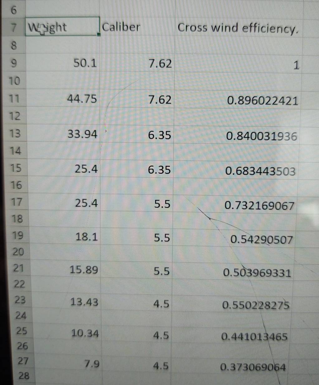

"The largest factor governing the magnitude of this drift is the BC." If we agree that
BCs can be used to accurately estimate the amount of drop a pellet takes at different ranges, that means that BC is meassuring the interaction with one force: gravity. Wind drift is a diverse force that is not vertical but mainly horizontal to the ground Then I would lke to go back to my initial comment in this thread: "Let´s try to meassure eficienciy vs. wind on each pellet".
For sure there has to be some factors to take into account:
Weight of the pellet and surface in contact with wind, ant time of suffering the efect of the wind force before getting to target.
The quickest loss of acceleration of a pellet, the more time in contact with wind force before getting to target.
Loss of acceleration is related with weight and speed. If the speed is a constant in all calibers, then the weigh and volume is what determines the interaction with the cross force of the wind.
