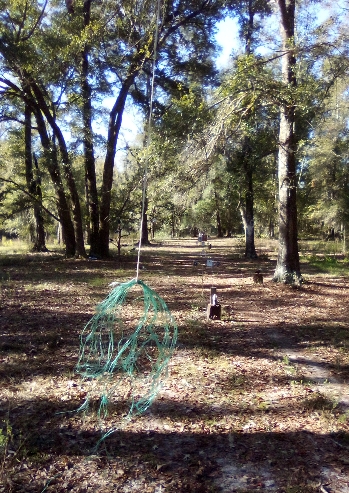

Starting from VHS tape strips to ....Windmeister (I have seen only online pictures of this one)
