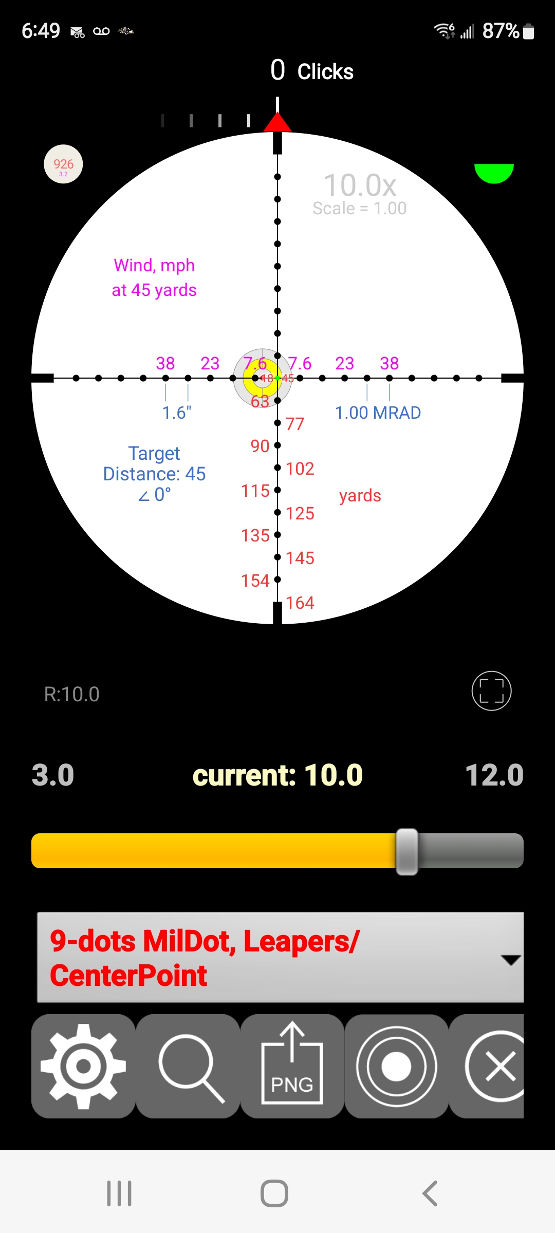

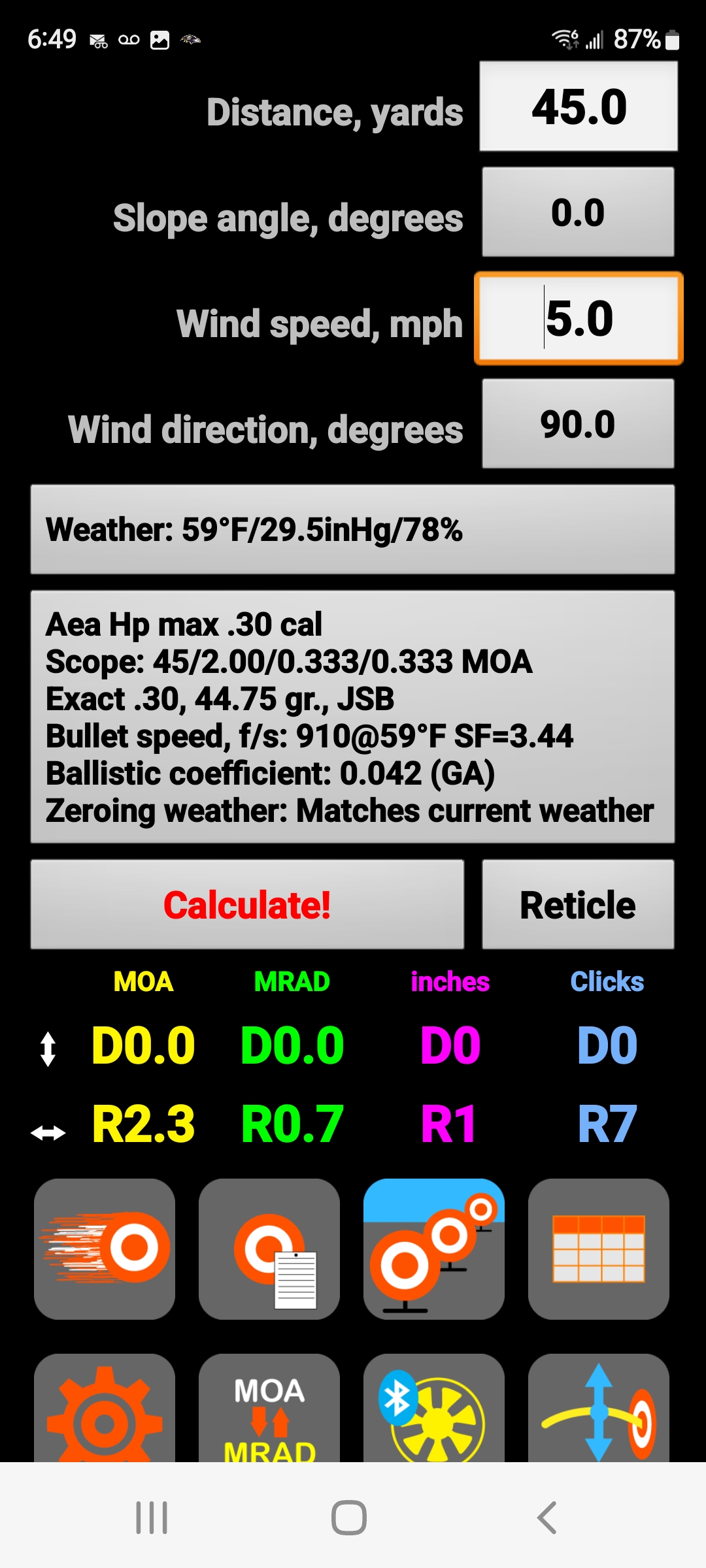

No magic pellet in wind. In this example a jsb .30 44.7 910 mv will drift with a 5 mph wind. Practice shooting in wind is your only hope.
