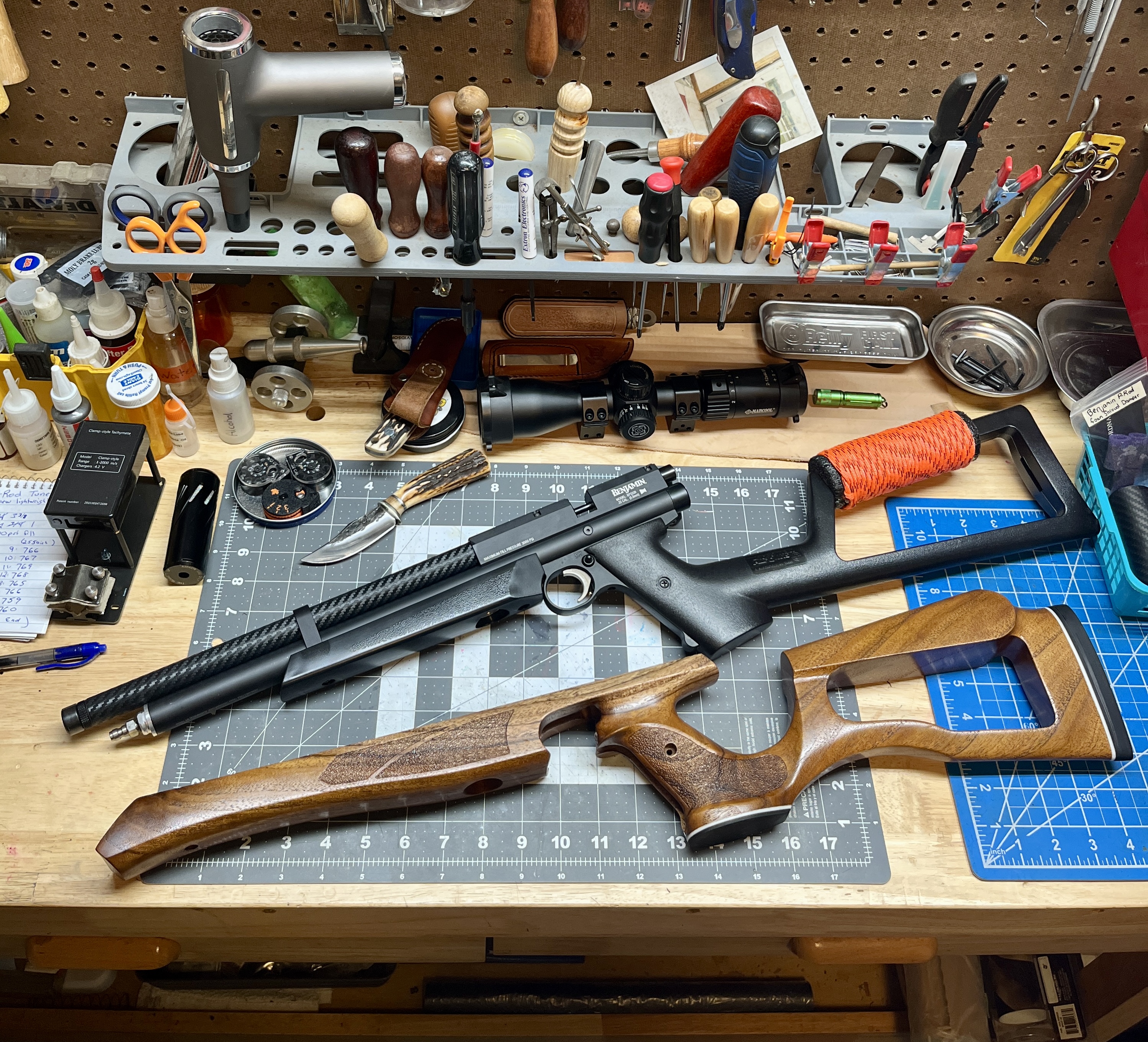

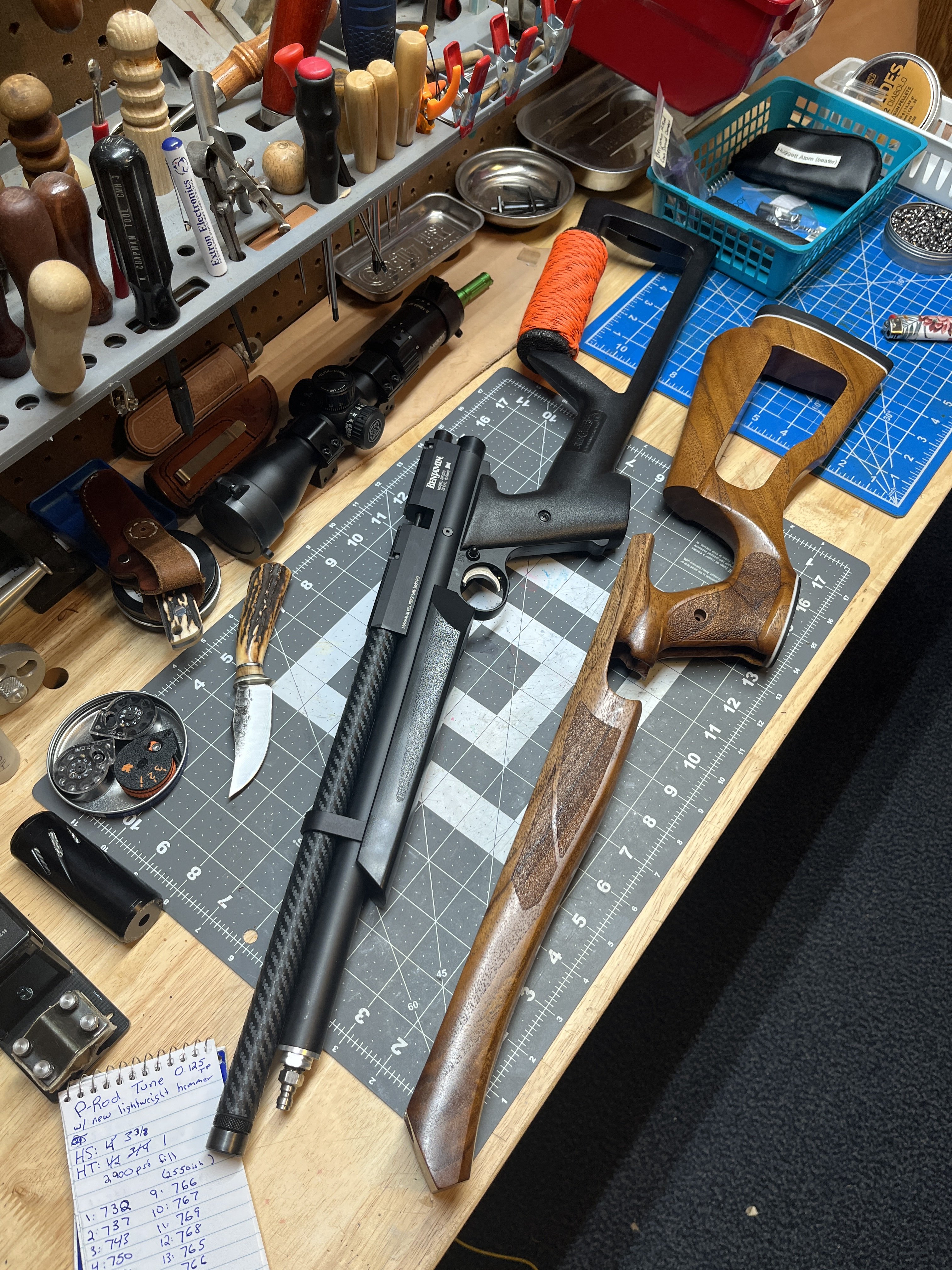

What’s everyone been working on this winter? I get bored and tinker with a bunch of random hobbies. I have a P-Rod back on the bench now. I experimented with the usual B-Staley, HS, TP, etc. Just added a Hill lightweight hammer. Only shot a few strings, but it’s surprisingly pretty consistent.
Gun shoots great but I’m sure I’ll get bored and add a reg. Only so much you can do with a P-Rod.If I’m ever happy with tune, I got this pretty wood stock for it haha. I’m having fun and learning. That’s all that matters.

If I may...where did you source that beautiful stock?

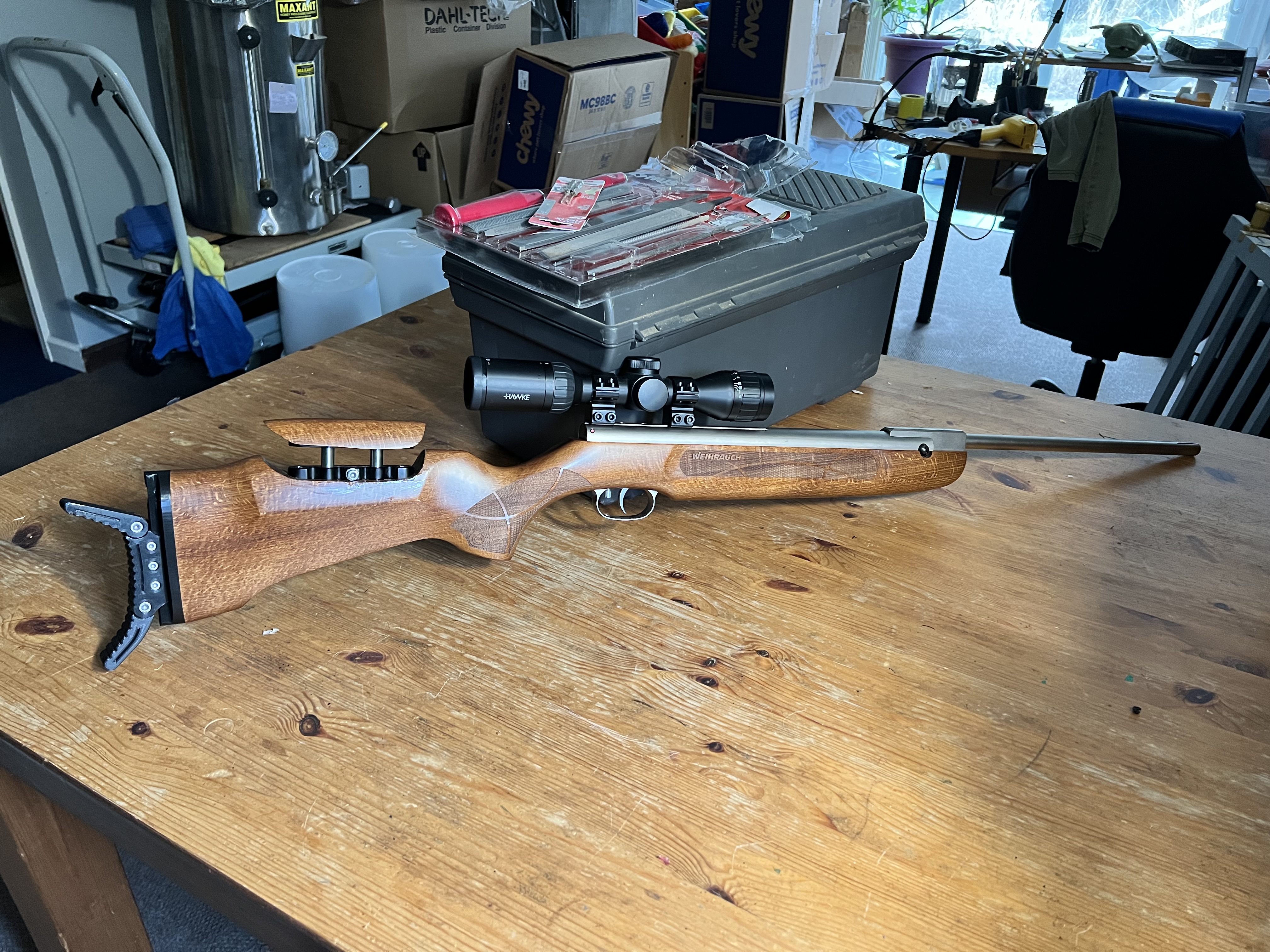

HW50s with the stainless action. I call her “The misses”. I decided to dress up “The Misses” in fancier clothes. I bought a spare stock from Alsky just in case I made a disastrous mistake, but so far so good. In a few weeks I hope to get to AOA in person and give her some new glasses. When spring comes she’ll look as pretty as all the other girls at the MAFTA range in Oakdale, MN. I’ll be making a stock for “The Mistress” sometime, but that may take a while.

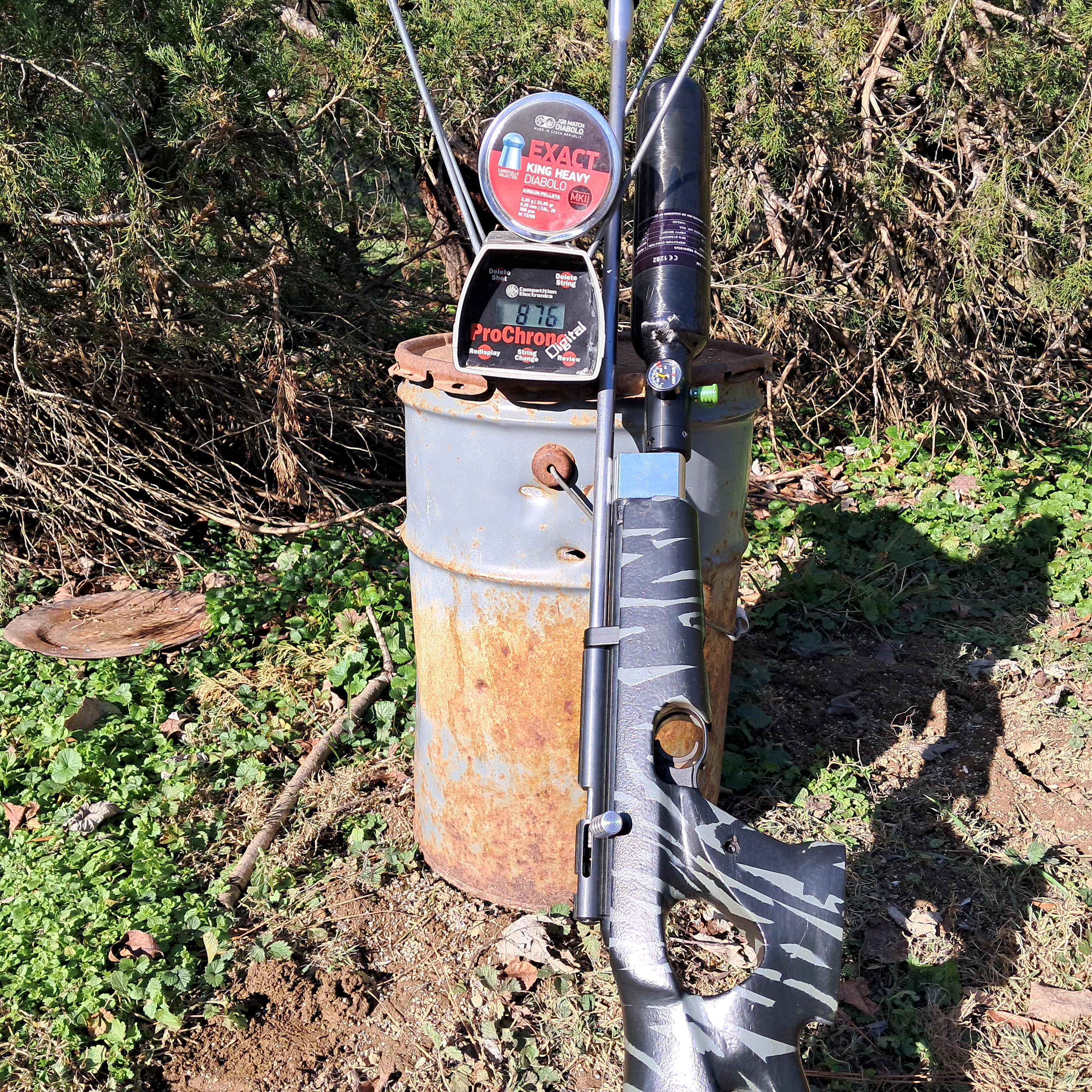

Well, just another 22XX bottle build, has a Cothran valve and a 24" LW .25 barrel.Been using a paintball reg, but just switched over to a Huben Cricket adjustable reg, much more consistent, will post pics and chrony numbers if can ever catch up on the "honey doos"
Not too shabby, got the reg output set around 2100 psi. Switched the reg gauge to a 3000 psi unit, better resolution.

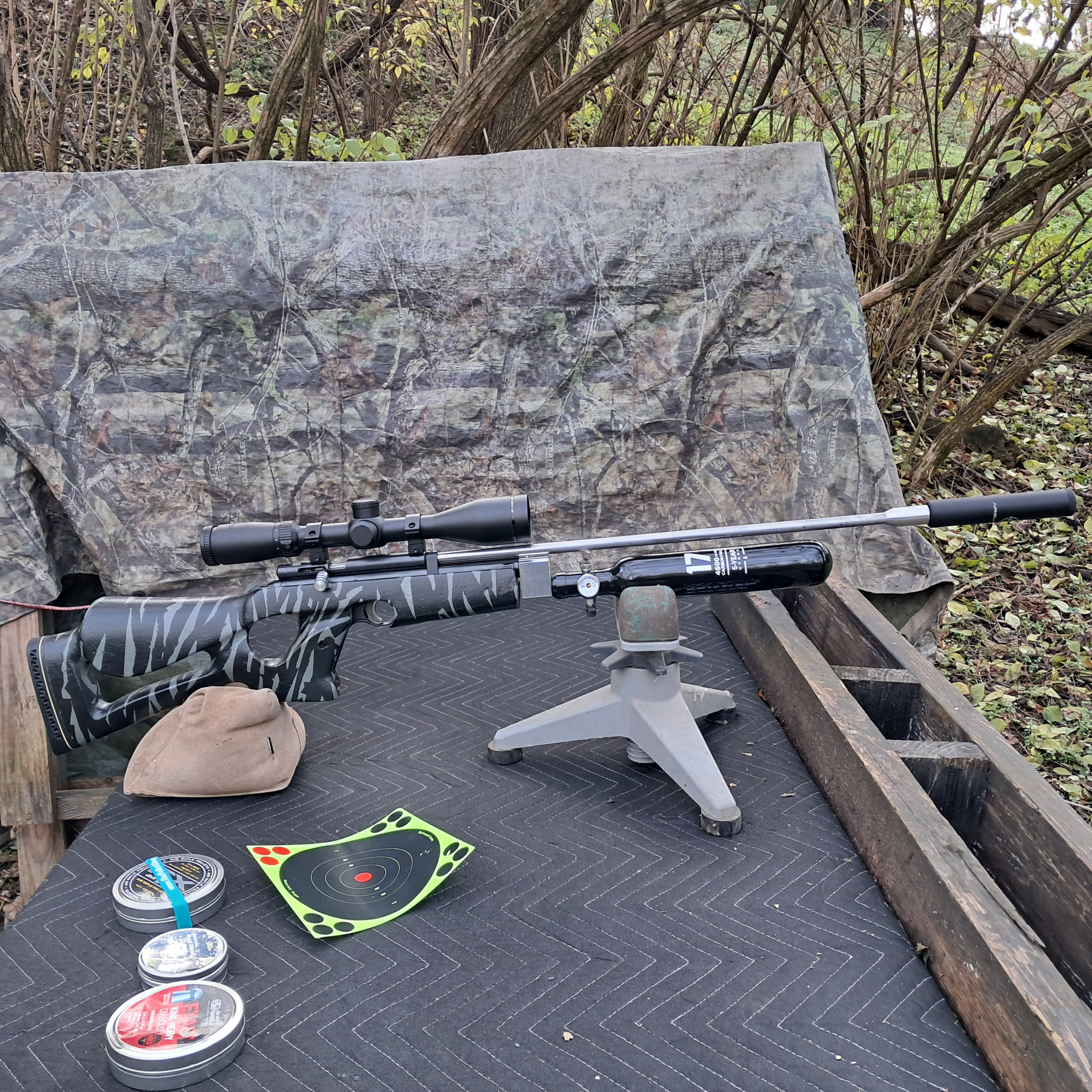

I'm working on shortening a BRK, Sniper XR (300mm cylinder).
When complete the shroud will end just before the short 300mm air cylinder. As short as I can make it with the larger diameter 0dB muffler in place.

That’s a great idea. Stinks when guns have big empty shrouds that do very little. Then you add a mod and it’s not so compact anymore.
If you remember send me pictures when it’s done.I considered a Sahara myself. Would be more appealing to me if it could be kept around 30”- with a moderator.

Should be between 30-1/8" and 30-3/8" overall.
Unless I can dig up a shorter, smaller in diameter, muffler before I get the shroud welded. Would be GREAT if I can find a muffler that's the "same" diameter as the shroud. Then, the end of the muffler will end at the end of the air cylinder.
