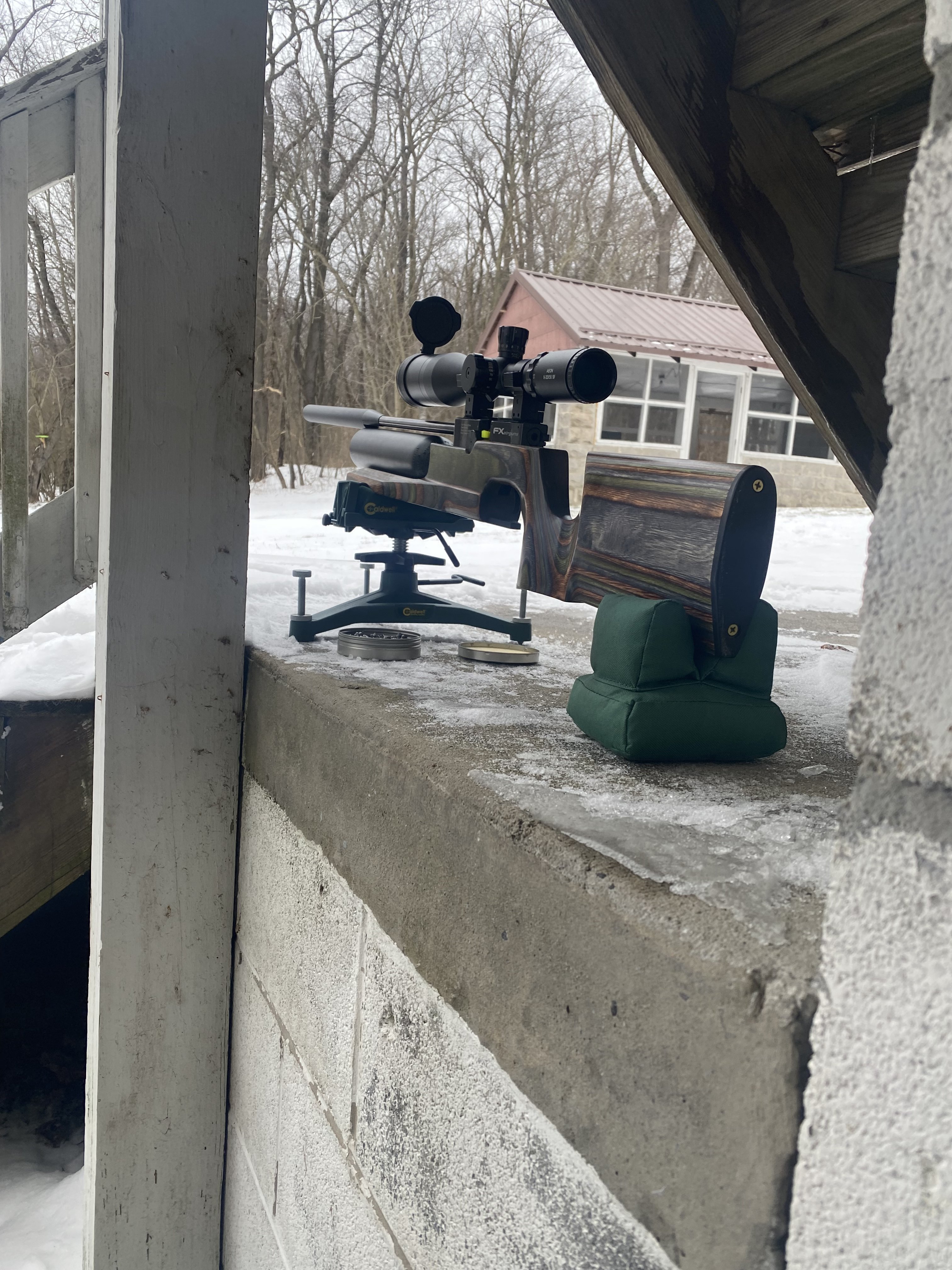

Why put them away.. improvise, adapt and overcome 😀
