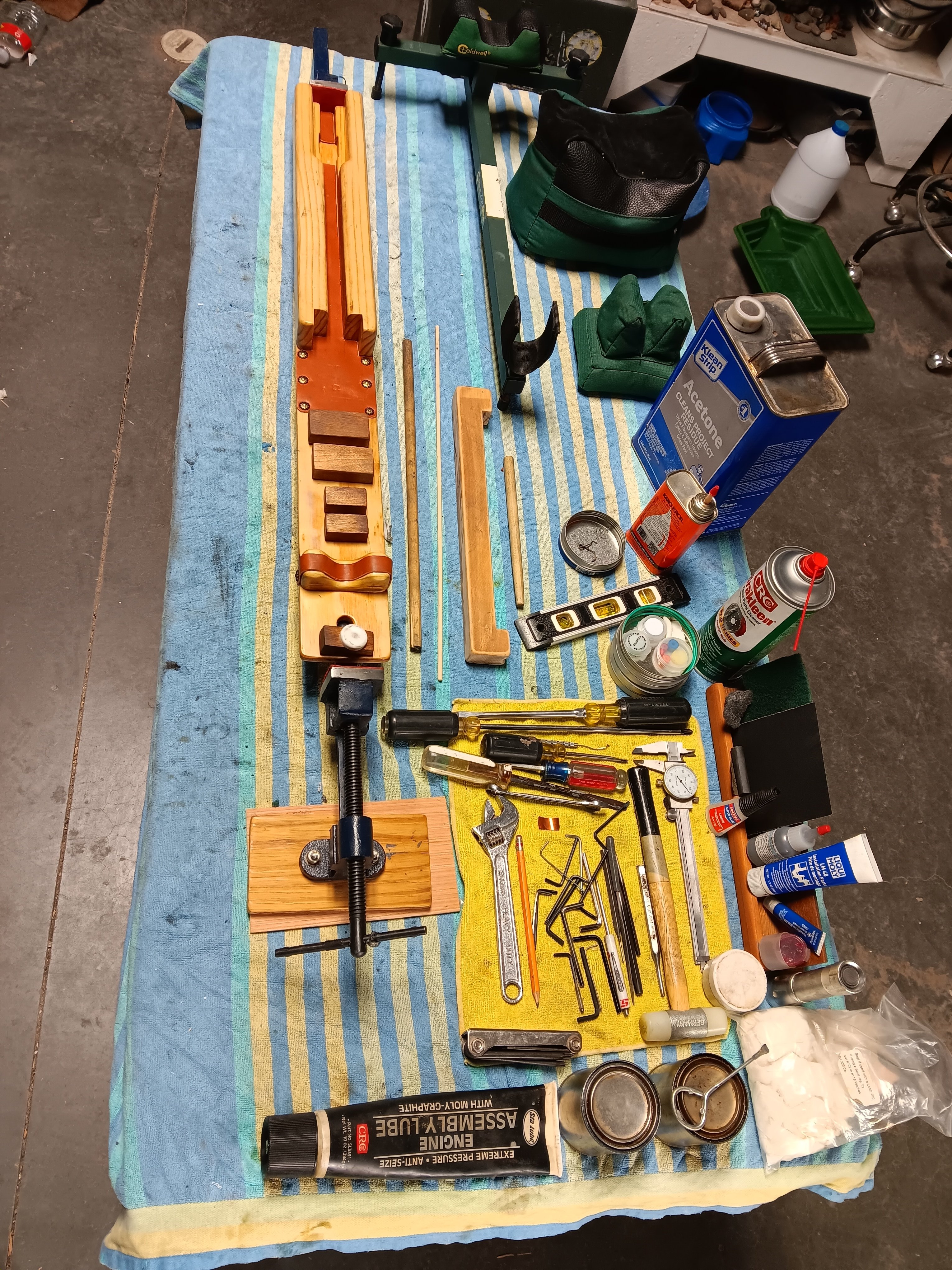

Everything you need to operate, maintain and repair a springer is on this table. The press and barrel bending jig is home made. Total cost about $200.
