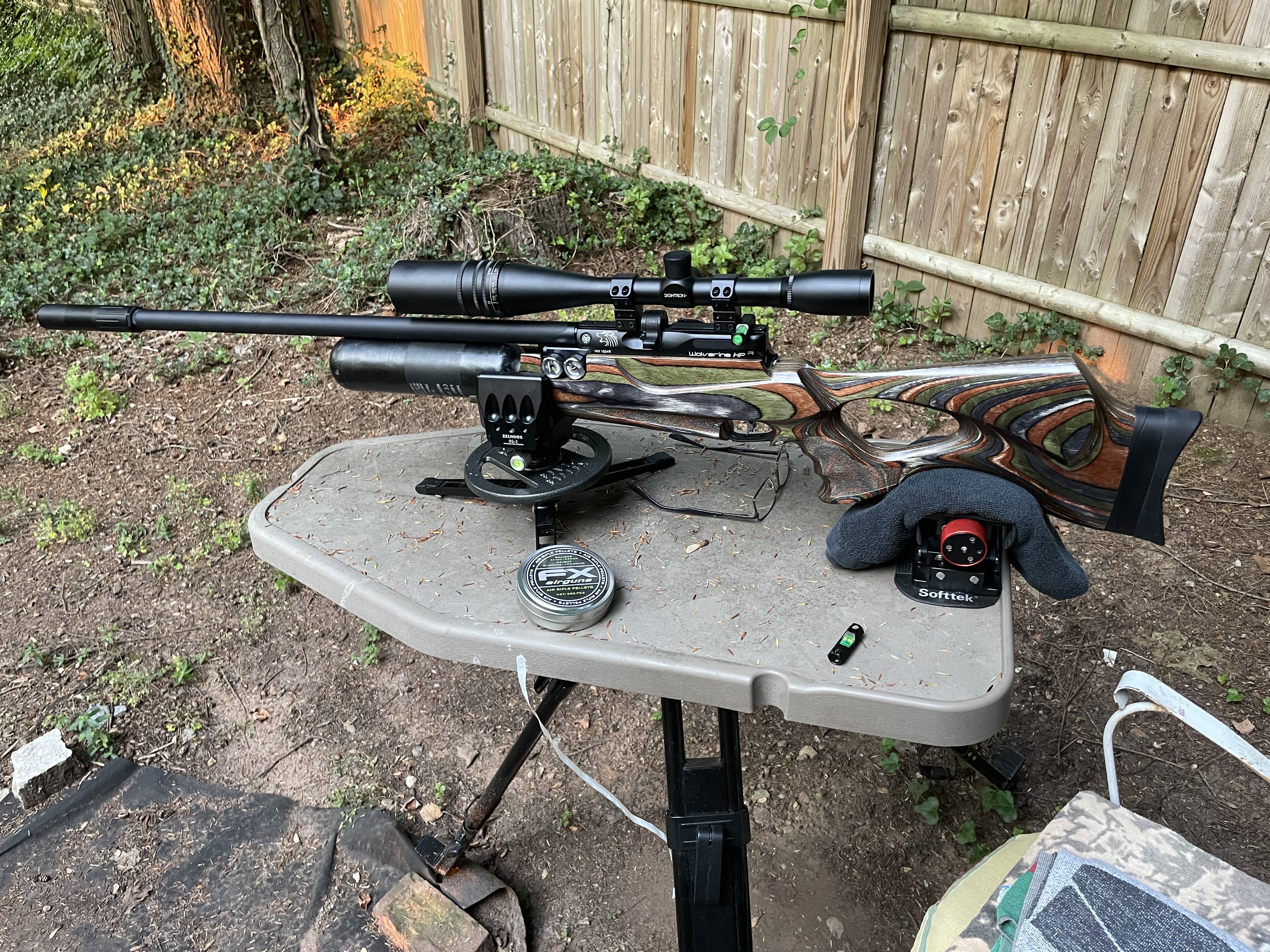

Moderator quietness is a bit subjective, but I have your exact rifle and shoot it constantly within 20 feet of my neighbors house.
I’m using a Huma Mod 30 - just 3 sections are necessary. This is the Huma Mod 30 with the felt inserts - not the new Avalanche inserts.
Another cool thing you can do with the felt Mod 30s is replace the felt with rolled cork - I did this in the 1st section of the Mod 30 on my Wolverine R HP. It’s very quiet.
