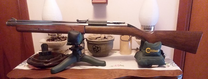

I have been looking at a Benjamin Sheridan oldie pump in .20 ? (but i do not need it / but i do not need it / ....................................
Somethin like this by chance....lol
EXACTLY what i am looking for beautiful gun thanks (be sure to package it very securely )

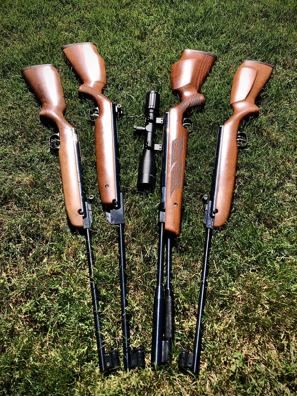

OK, I had to share a picture of some HW guns. Second from left is a HW95. I have 3 actually. Love the 95/R9!
Thank you! You have some gorgeous guns there man!
That's me loading, how they feel to my thumb and what I should have said. Couple are a bit snug but not what I'd consider hurt your thumb snug...lol.
Might have to do like Mr Arrow there and take a family pic of mine although one would be the Diana distant cousin of the HW/Beemans since I own a D34K Premium in .20...lol

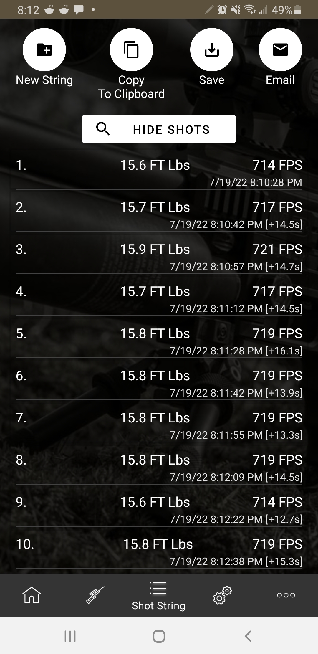

Yeah I think I'm going to stick to the JSBs. The gun is starting to settle in very nicely now and I'm ALMOST printing some 0.4" 10 shot groups at 30m with them. Shoot, the one group looks to be almost 0.3" if it wasn't for that high shot. They're pushing 16fpe as of right now as well so I really won't complain.
3x attempts with the FTTs before I called it a quits with them. I'll come back to the later to see if there is any progress but for now it looks like this is going to be a JSB gun.
