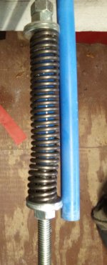

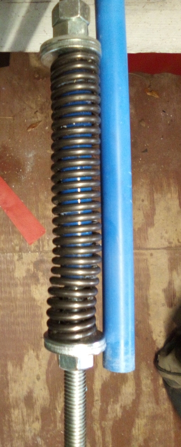

One thing I do recommend is to scrag / set your spring first .. assembly goes much better .
Tool with a guide sleeve
Notice with in the guide sleeve no kinking ...😉
The springs in JM KITS are pre set. Don't attempt to set a spring without a fairly snug mandrel. The spring shown may cause graunchy cocking. And not necessarily the smoothest firing. If you buy a separate spring from Jim why not have him set it for $2? He has the correct size mandrels on hand. The mandrel must fit snug with the spring at rest just like a well fitting guide. 1726148152683.jpeg

The springs in JM KITS are pre set. Don't attempt to set a spring without a fairly snug mandrel. The spring shown may cause graunchy cocking. And not necessarily the smoothest firing. If you buy a separate spring from Jim why not have him set it for $2? He has the correct size mandrels on hand. The mandrel must fit snug with the spring at rest just like a well fitting guide. View attachment 495541
Maybe I don't know I just buy springs and seals . I do know for $2 or5$ he will set the spring in a offer listed ..
Ok .. says set spring not in kit 3$. ..
So the kit spring is more drop in then 👍
Well I did say that's what the blur tube is a guide to prevent that .. lol. That was a old spring used as example straight where on the tube but kinked with out .. if you were to look at the picture ..lol
