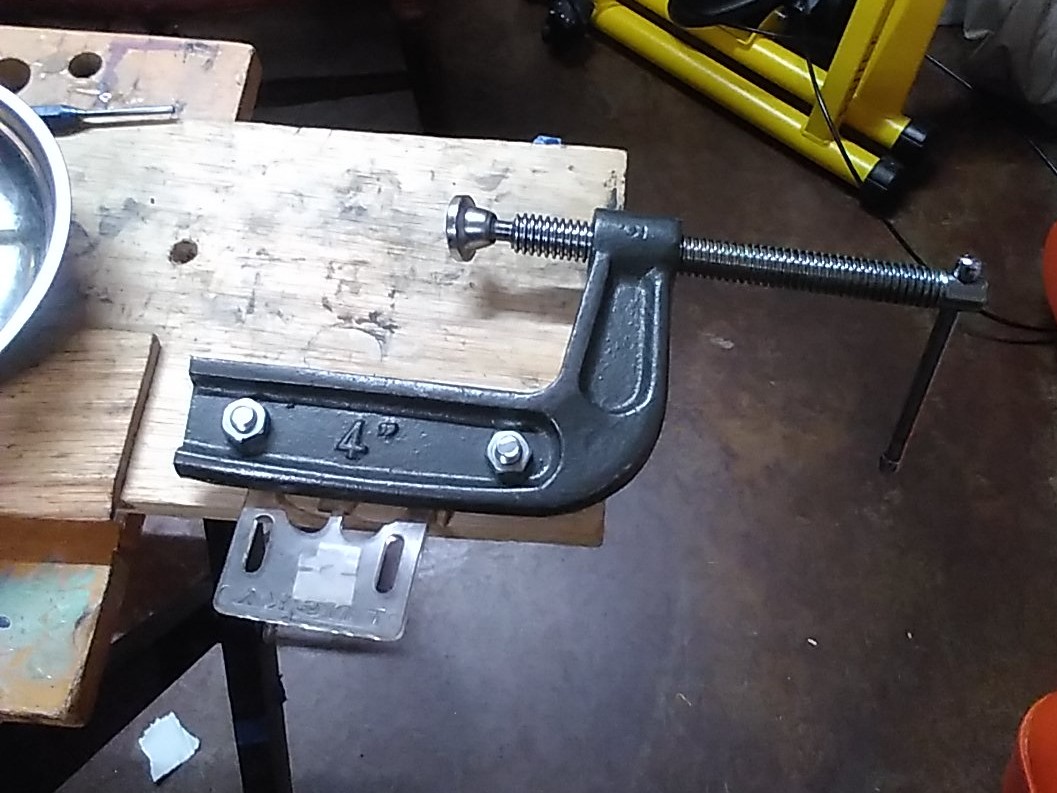

You can make a dirt cheap spring compressor with a "C" clamp from Harbor freight cut off and mounted on a board or bench. I just clamp blocks on mine depending on where the end of the receiver tube fits and works great.
