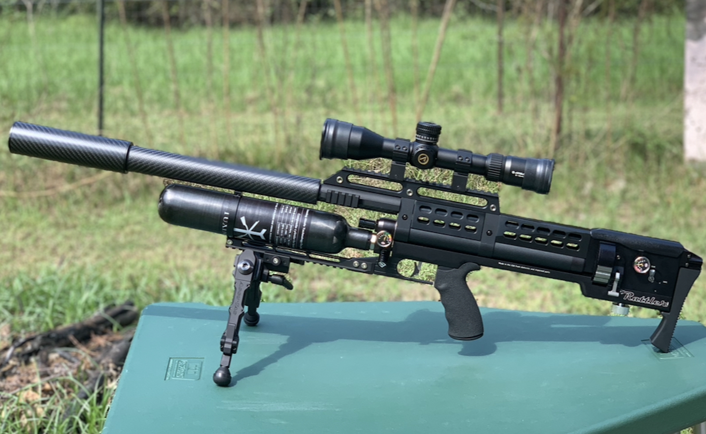

Today was my second session working with this rifle. Right now I have it paired with an Athlon Helos Gen2 2-12x42mm FFP IR scope. Within 50 yards this scope seems to be ok for me. As much as many of you all like it, I'm still trying to like it. Anyhow, my first time out I mounted this scope on my Rattler with the turret settings from when I removed it from my Benjamin Bulldog M357 with a 50 yard zero. When I shot the Rattler using this scope it was pretty close to dead on without touching a thing. I initially shot it from the Caldwell Turret Rest seen below.

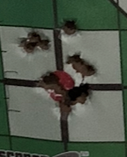

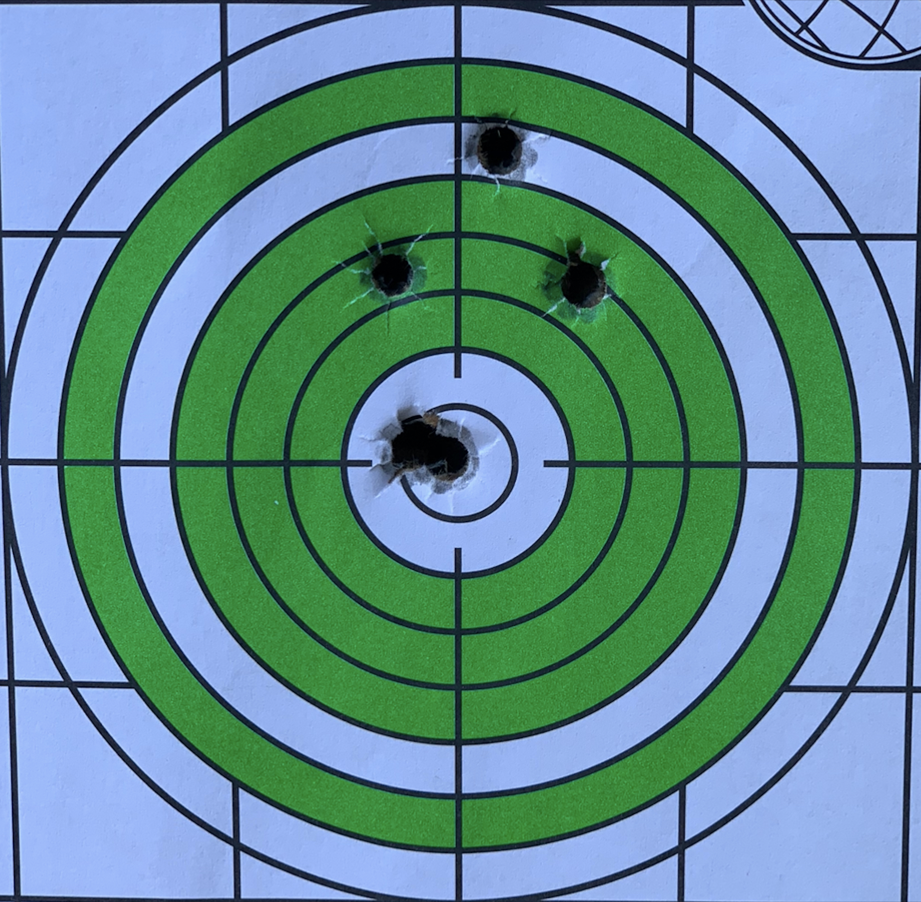

Here's my first target. The first two shots are touching the edge of the bullseye and touching each other.

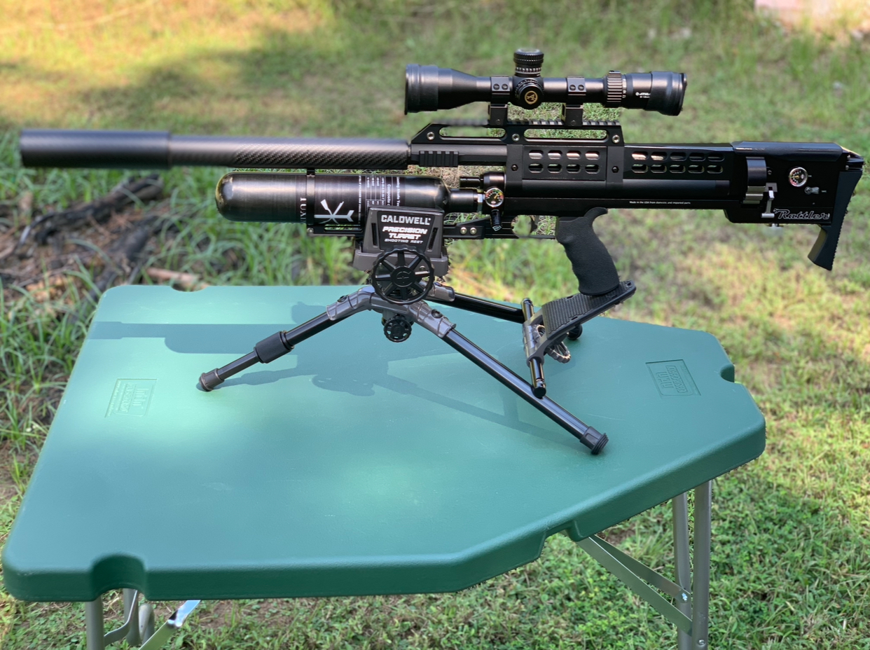

Then removed it from the mount and affixed an Accutac bipod (that was pretty comfortable to shoot with without a rear rest). I felt pretty good abut my first time shooting from 50 yards.

The first target started out great with the 1st two shots hitting the bullseye, but my chronogragh was not reading the shots. As a result I set the gun down, fiddled with the chrony, and re-situated myself behind the Rattler. The 3-shot that grouped above the bullseye were the next three shots. I was shooting 140 grain slugs that I swaged.

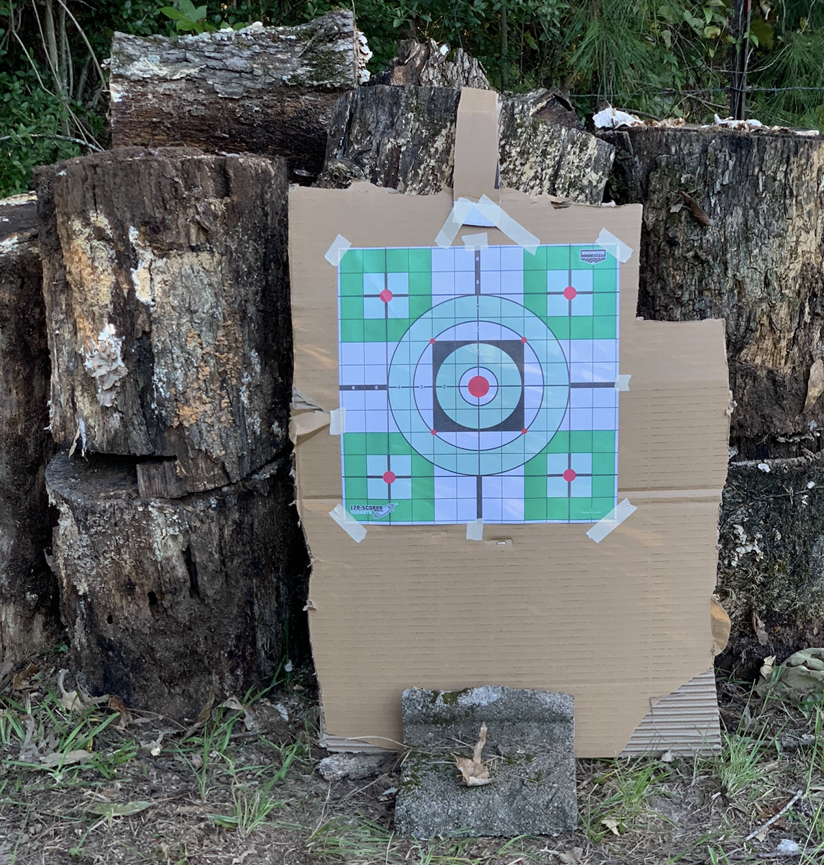

My makeshift big-bore backstop and target for the day.

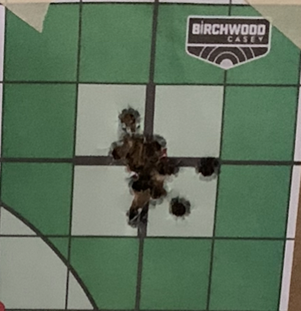

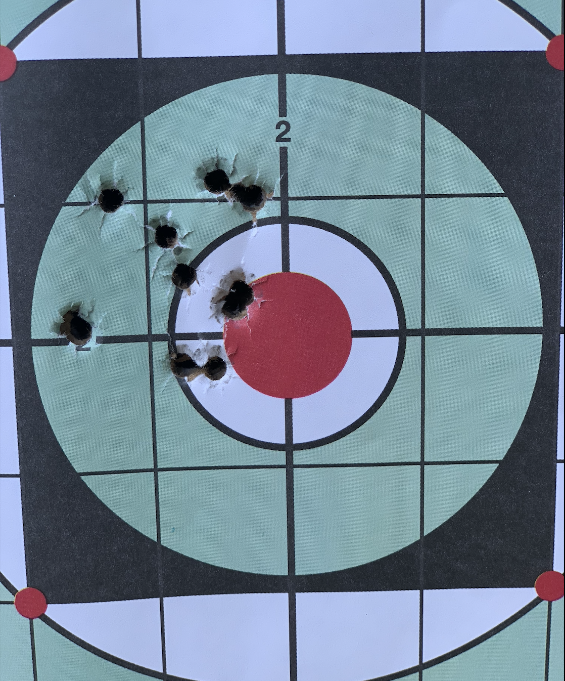

I decided to start at 25 yards. These were 140 grain slugs. 14 shots were taken while seated an resting the fore end of the reservoir on the yoke of a Primos Trigger Stick bipod.
Then 120 grain slugs. 15 shots.
Second target at 25 yards, 120 grains slugs, 15 shots.
Now I moved out to 35 yards with the 120 grain slugs. 11 shots, I turned up the power wheel so the Rattler was using more air and I didn't want to fall below the regulator set pressure. The hold also changed. I'll know more when I shoot from a few more distances.
I did shoot below the regulator set pressure a couple of shot strings. I don't advise doing so. I think it shot down to around 115 bar without my knowledge until after the fact. What I noticed was that the magazine release arm was slightly up and had very little tension when I pushed it back down. Then I raised it up again and rotated the magazine. The magazine felt as if it was halfway between two chambers. Thankfully all 15 were empty or it probably would've jammed and dumped air. I've realized that the more you turn the power wheel, the more air the rifle will use. It can get to a point where the increased air use does not translate to increased velocity.

What stands out to me is your ammo and the tune are not working. Right out of the gate 80gr. JSBs should be stacking at those distances with this setup. I'd suggest shooting with pellets first to get a baseline. Then start tuning for slugs, using the pellet group as a baseline. To make your life easier try light slugs first, then move up to what you were originally shooting. I don't know the FPE of this gun, but after looking at one video between two slug weights, this gun is more than capable of very tight groups:

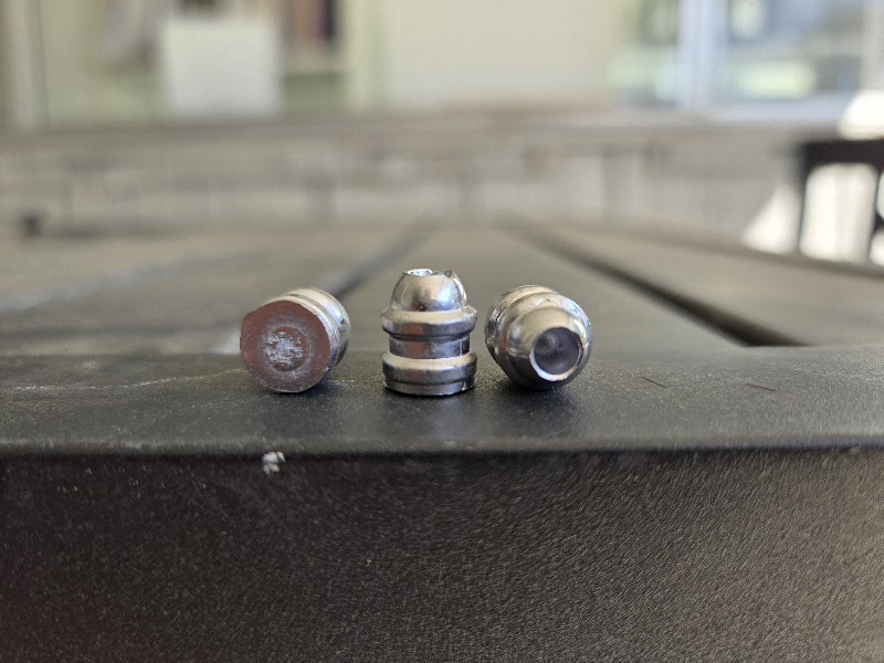

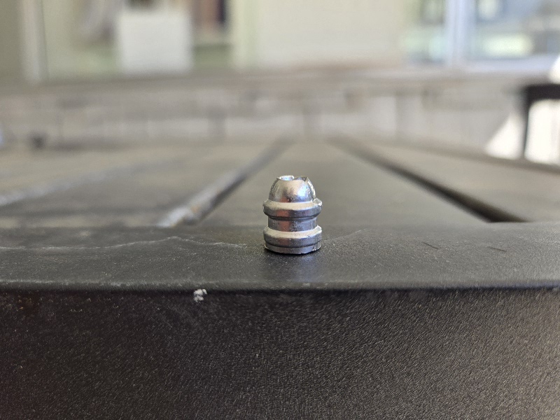

Attached are 90gr. EPP-UG HP .357 slugs I'll be trying in a recluse after the JSB baseline. I'm sure it won't be as accurate as a Rattler.

Fair enough. What slug moulds are you using?

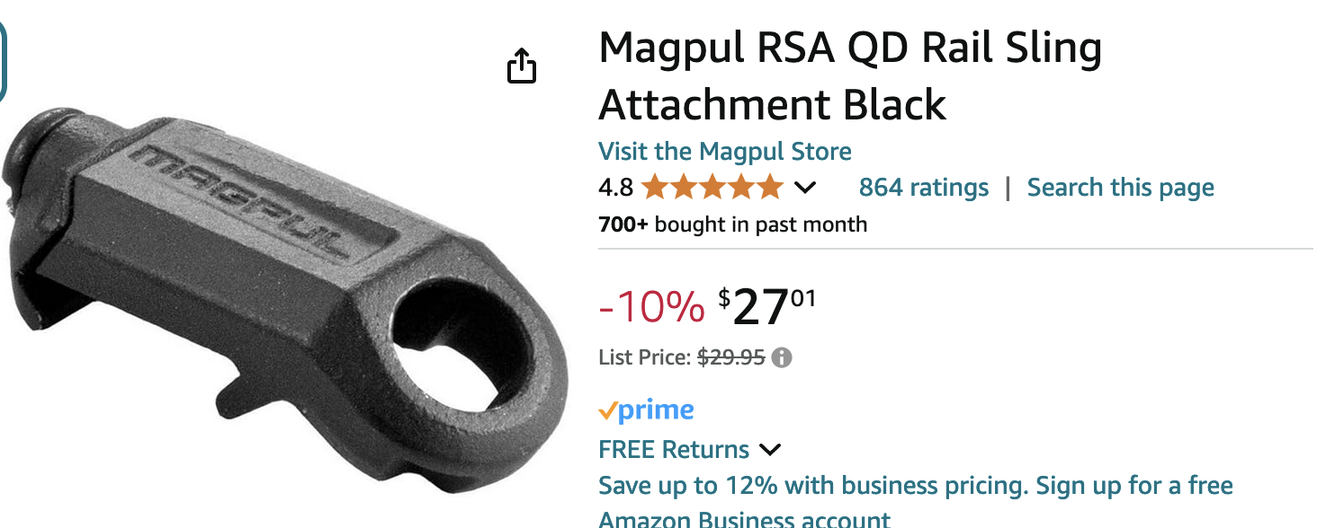

@Pfddi Yea. I need more time with it. The follow up shot with semi PCPs takes some getting used to. I've only done it once maybe a year or two ago. I'm used to bolt action and bullpup lever actions. Have you affixed a sling to your Sidewinder? I'm thinking of using one of these on the pic rail.
I'm not sure what to use on the but end. Any ideas?
Not yet, but I have a picatinny sling mount on the front of my EVOL that I will probably get another for the Sidewinder. It's similar to what he Magpul you are looking at. I have a non-swivel back on my sling so I can move it between rifles without fixed mounts easily. I also have an attachment for my backpack that makes it easy when toting in my tripod, chair and other necessities of an old hunter (TP LOL!!!).
I wonder if your barrel is getting leaded up? Are you lubing the slugs?
Personally I like to sight in airguns at 30Y so all shots inside 30Y and outside 30Y are all holdovers or dialing up, that way theirs less confusion. Basically you want your zero to be so 26Y and 34Y are withing .1 mil of each other.
@steve123 I'll take this into consideration. I haven't zeroed this scope for this rifle yet. I mounted this scope after sitting up for months using the zero that it had from another rifle. So far I've been feeling out the Rattler and how it shoots different slugs without changing much of anything. Considering that time is something that I don't have a lot of, I'll be taking some time to learn this rifle better. I've written about all of the times I've shot this riffle in this thread.

@steve123 You may be on to something. After further analysis it appears that the apex of the slugs’ trajectory is around 35 yards.

A couple of updates. After communicating with Shane at AOA, in order to affix a sling to the Rattler he recommends installing a Kraford and Lypt KLS Butt Pad w/Sling Attachment for the Western Rattler
In the front you can install a Magpul pic rail mount (also seen in a photo in post #8). These work well. I use one on another rifle.
I don't think that the slings with the slipknot loops in the ends would be appropriate for this riffle.
I was also advised to increase my regulator set pressure and told that regulator rebuild kits for the Rattler can be obtained from Airguns of Arizona.

Did they give you a set pressure for the reg? I've shot mine at 200 once or twice back when I first got it and it didn't self destruct or anything. (The reg was creeping due to a metal shard in the reg). Been keepting it at 180 since then.
That reminds me... I need to call AOA and get a part.
Some slightly off topic thoughts: odd that the rattler is only rated for 250bar since the tank and reg are marked for 300. I've been wondering if this is a CYA move on the part of western, or if they were concerned about over pressurizing the plenum in the case of reg creep.
@caliusoptimus I was instructed by Shane to bump the reg to a minimum of 150 bar. He didn’t recommend a specific setting and I didn’t ask. What I did ask for is a reg rebuild kit and the o-rings are on the way. If I need more parts for the reg I was asked to notify AOA.
Yeah bare minimum of 150. Going below that it will dump a ton of air in a single shot. Same thing happens when the power knob is too high.

Mine did not like the heavier slugs. Anything over 120 and groups started to open up. It appears yours is doing the same from the pictures.
I never shot mine over 160 bar.
It was really fond of pellets at lower settings. It shot the 120’s very well.
