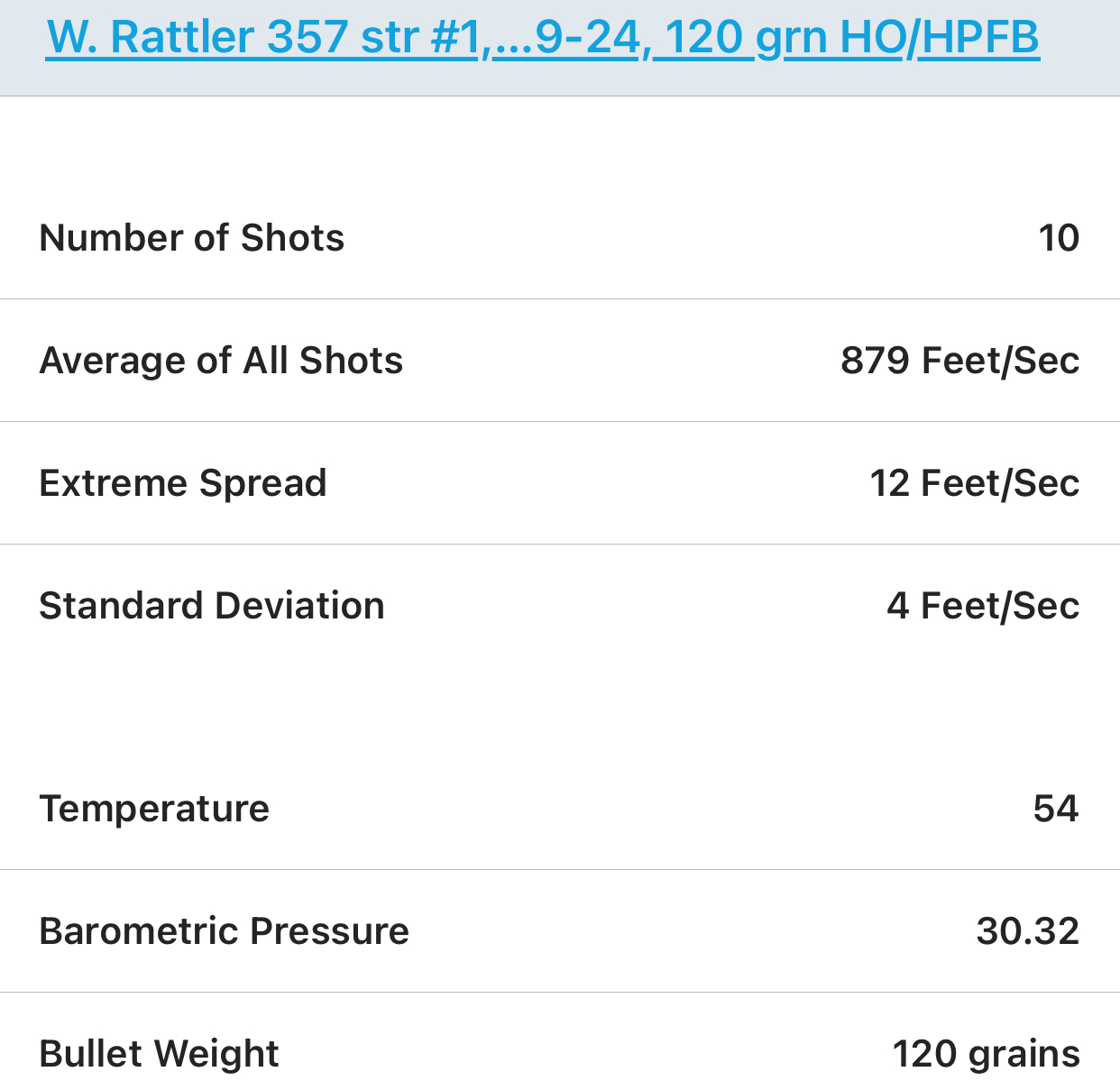

Ok so I shot a couple of mags through my Rattler .357 and chronographed what I could after bumping up the reg from 145/150 to 160 bar. Temps were between 54F - 48F. Now I’m running into the issue of the magazine not advancing. I literally had to start manually advancing the mag. Has anyone ran into this issue? Could this be temperature related or do I need to also adjust the power wheel now that I’ve adjusted the regulator?

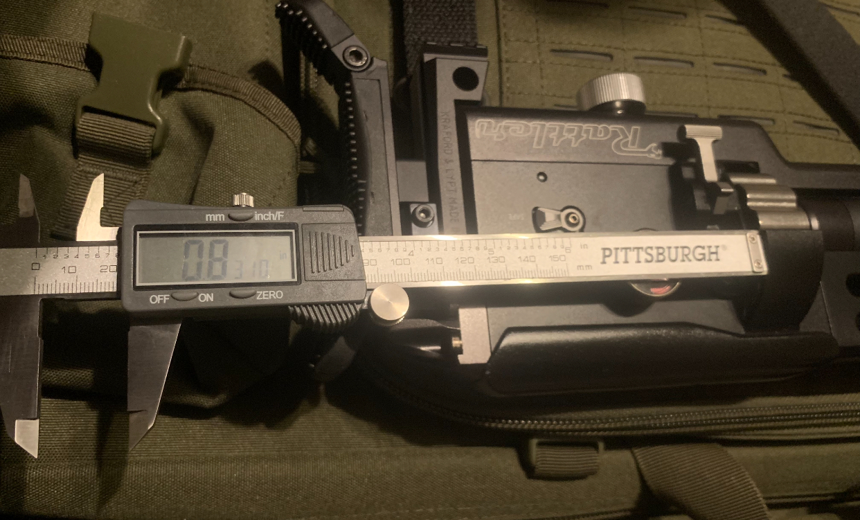

For inquiring minds, what is the depth of the magazine of the 357 for the longest possible slug length? And, how fast does it shoot your heaviest slug at full power?

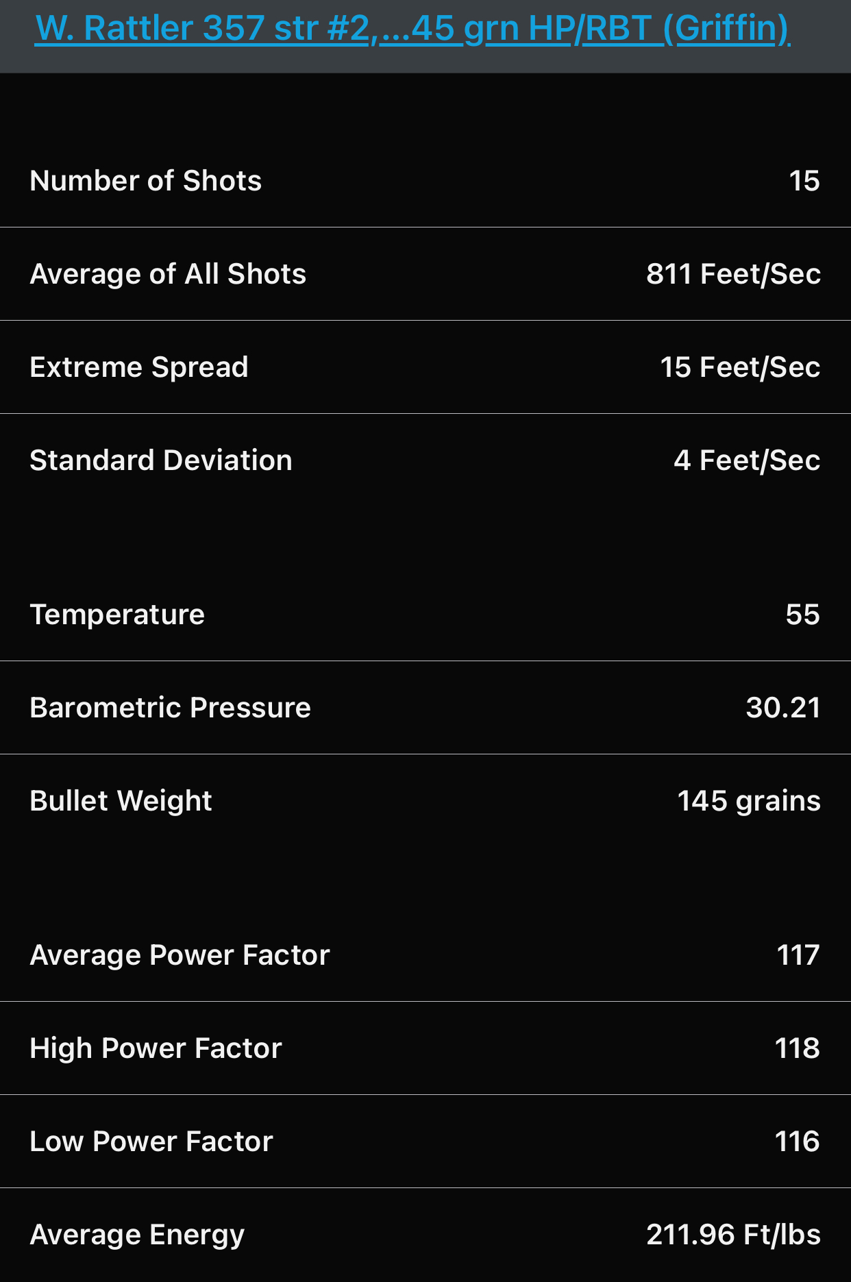

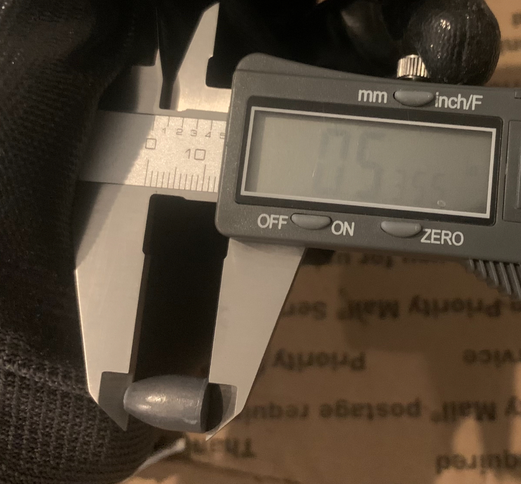

@Airgun-hobbyist I’ve shot 110, 120, 140, and 145 grain slugs. I haven’t shot my heaviest slug (185 grain) yet. Nor have I shot the gun at full power. I just bumped up the regulator yesterday from where it was set when I bought the Rattler.
Here’s data from yesterday.
I can measure mag depth later.

@Airgun-hobbyist Ive shot 110, 120, 140, and 145 grain slugs. I haven’t shot my heaviest slug (185 grain) yet. Not have I shot the gun at full power. I just bumped the reg up yesterday from where it was set when I bought the Rattler. Here’s data from yesterday.
That's pretty consistent and good power right there.

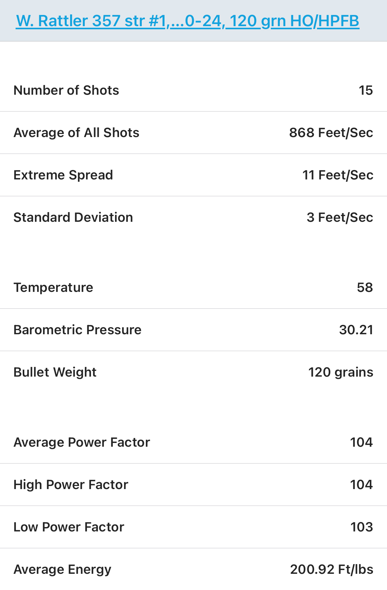

Below you can see that the 145 grain Griffin Rebated Boattails aren’t grouping so hot at an average velocity of 811 fps.
Shot string data. They need more velocity.

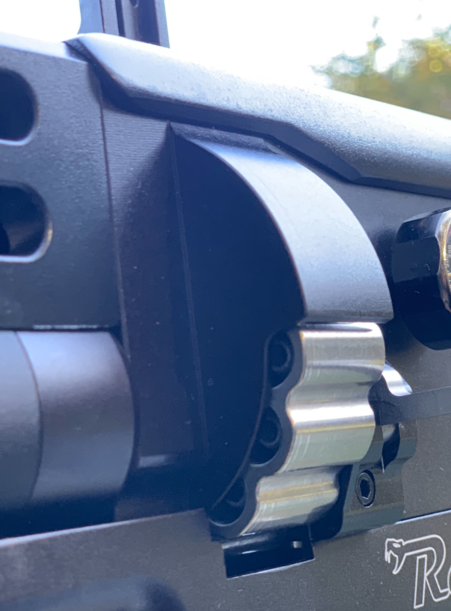

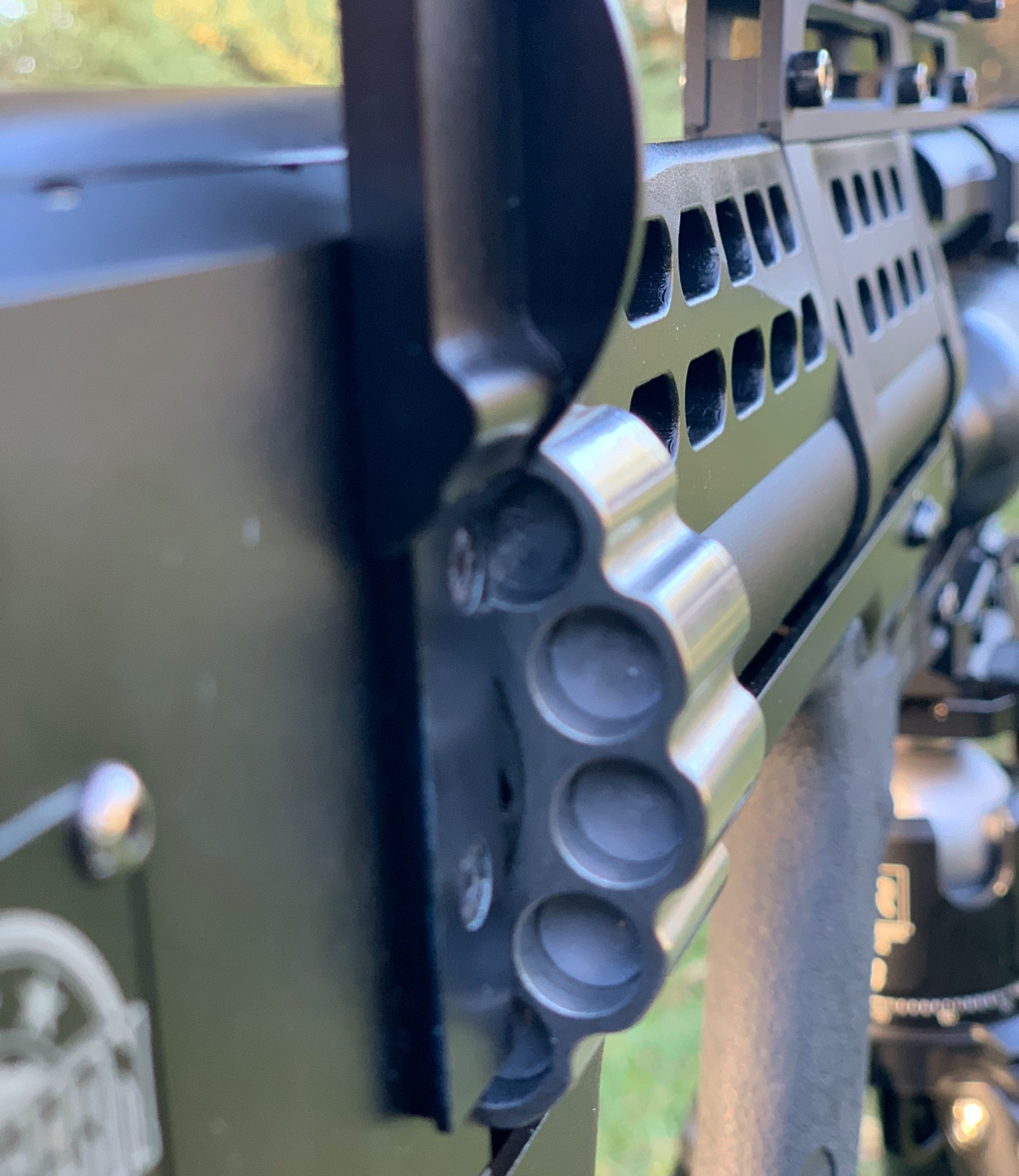

Here’s how they look in the mag after being seated with the pad of my thumb.

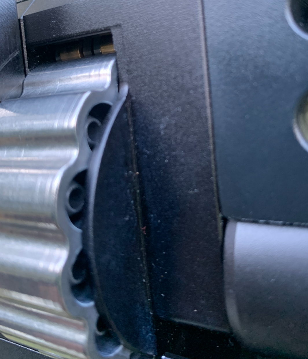

After the temperature hit around 51 F the cycling issue occurred again (mag didn’t automatically cycle after taking a shot). By this time the metal on the rifle was pretty cold to the touch. I didn’t do anything differently and I was shooting the shorter 120 grain slugs. I’m really curious if anyone else has experienced cycling issues in cool weather - once your Rattler or ambient air reaches a certain temperature.

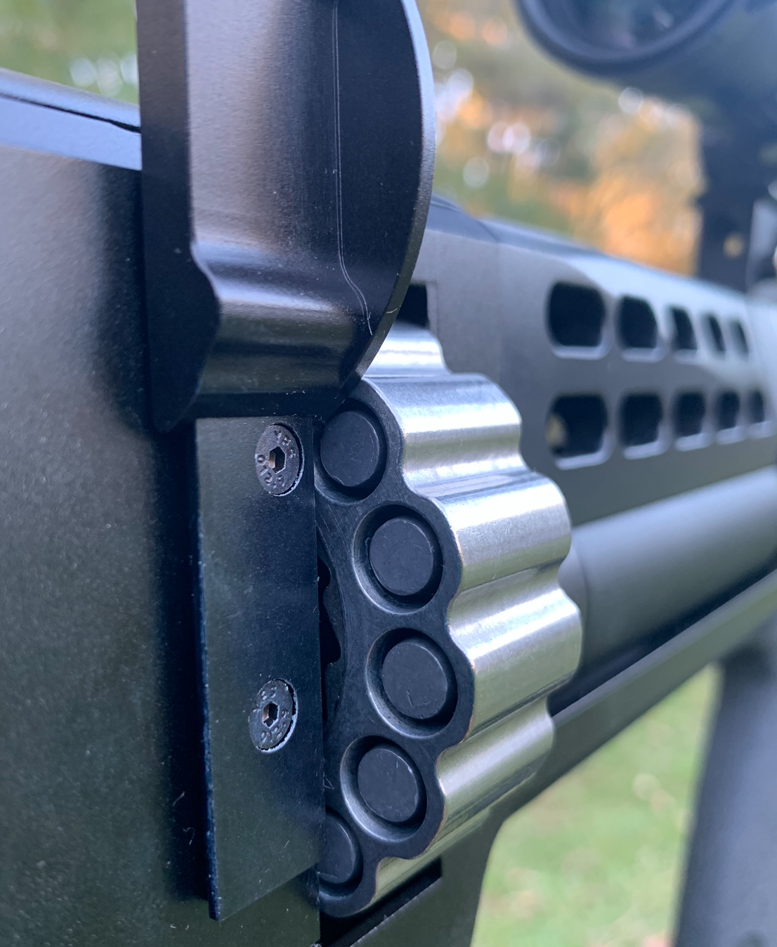

Here how the 120 grain slugs look seated on the mag.
After temps hit around 51 F the cycling issue occurred again. By this time the meat la on the rifle was pretty cold. I didn’t do anything differently and I was shooting the shorter 120 grain slugs. I’m really curious if anyone else has moved cycling issues in cool weather or once your Rattler or ambient air reaches a certain temperature.
For the cycling thing... someone mentioned the barrel. Good thing to check, it may be to tight against the mag and getting tighter as the gun contracts from cold temps.
And don't forget the lever on the left side. I've forgotten to flip it down after loading the mag and it won't cycle.

I’m also curious about what’s going on with this regulator. Today’s shot string looks very close to a string shot a couple of days ago. This is after bumping up the reg a tad. I want to know what I did to lose velocity.
