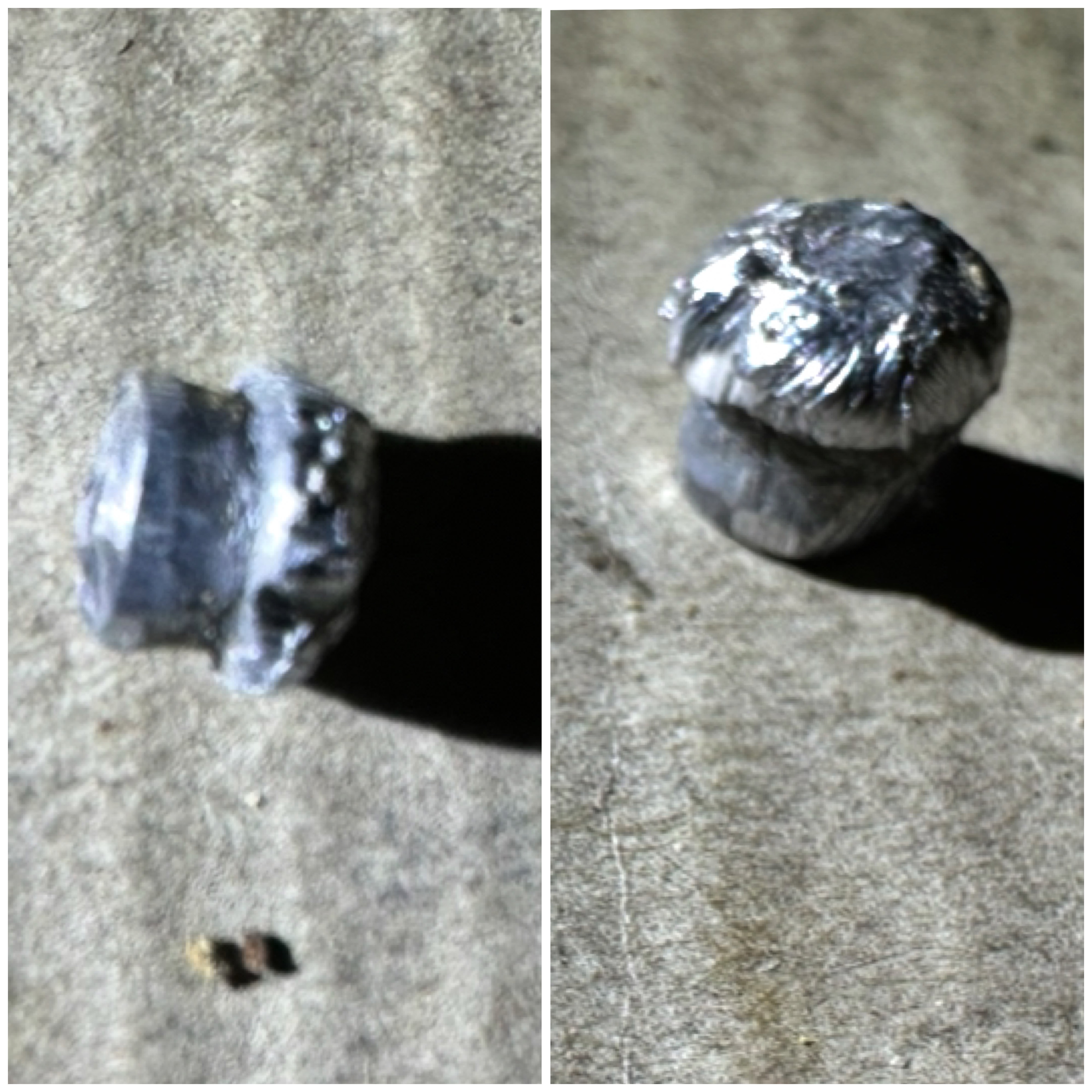

Finally, I also discussed how loose projectiles can become marred or deformed at their bases within the mag. Here’s a photo of a pellet whose base was obviously getting deformed as the mag rotated. This is a mild deformation.

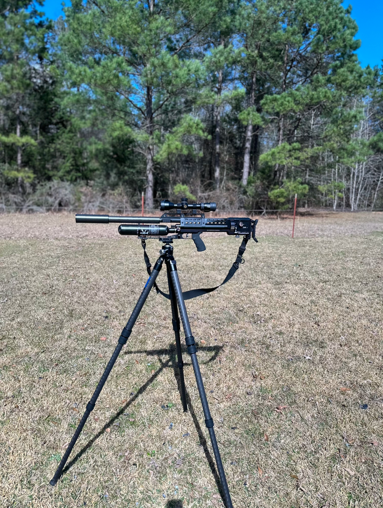

Back at it working with these 81 grain pellets in some pretty nice wind gusts.

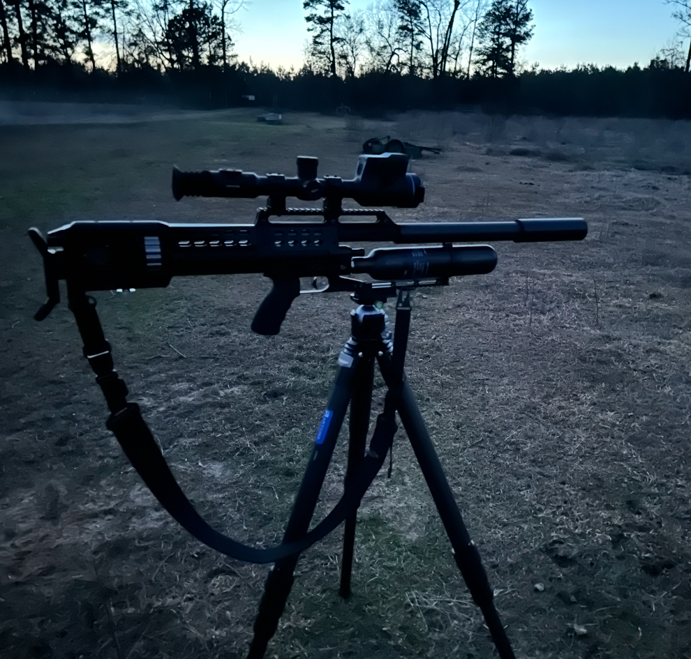

15 shots shooting standing behind my tripod. These were pretty rapid, but consistent shots.
I think I’ll move closer before moving further out. The farthest I will shoot today is 75 yards.

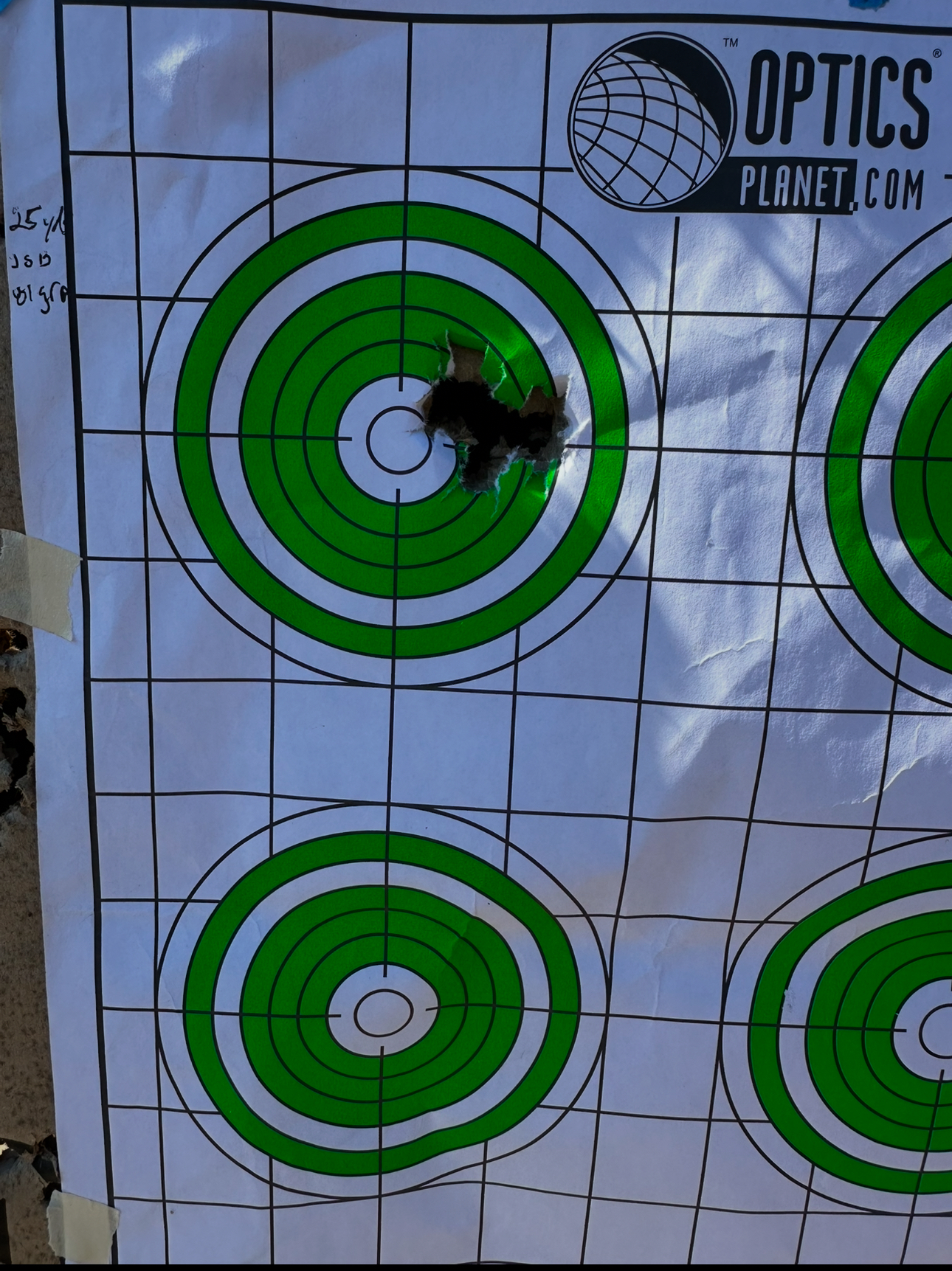

I spent a few hours shooting in the wind today, mostly shooting pellets. I didn’t shoot beyond 60 yards and I probably shot around 180-200 pellets. I cannot say that I got good results with them farther out. Now I need to figure out if it’s my tune, shooting technique, dirty barrel, etc. It was windy with changing wind gusts close to 20 mph (I think 18 mph was the fastest). I made a few good shots reading the wind. I do think I need to remove this scope. As much as I’ve tried, I just can’t say that I like this Athlon Helos BTR Gen 2. Please don’t message me asking if I want to sell it. If I do you’ll probably see an ad. I have an idea of what I want to replace it with. I did notice that when I shot slugs for my last 3-4 groups, they looked better. I really couldn’t see my targets clearly after shooting the first group. I was out at 60 65 yards towards sunset and it’s tough for me to see fine details in low light at a distance with this scope.
These groups were about as good as it got for me shooting out at 60-65 yards. The top target was from 60 yards. The bottom target was from 65 yards. On the bottom target I could hardly make out a faint white spot (the bullseye) on the target at 8x mag using my illuminated reticle. The illuminated reticle looks thick at a distance and can get in the way of a small target area. These targets are shot shooting NSA 110 grain slugs.

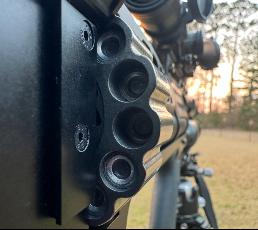

NSA .357, 110 grain hollow-point dish-base slugs tend to work their way loose in some of the magazine chambers after shooting a few shots. I experienced about 3-4 misfires where the gun dry fired and I had to stop shooting, put it on safe, lift the mag release lever, and manually advanced the mag to the next chamber. Here’s a photo of the base of a slug when I stopped to manually advance the mag following a misfire. Can you see how the other slugs are still seated (farther forward) in their chambers?

I did recover a spent pellet next to the back stop. Here’s how it looks.

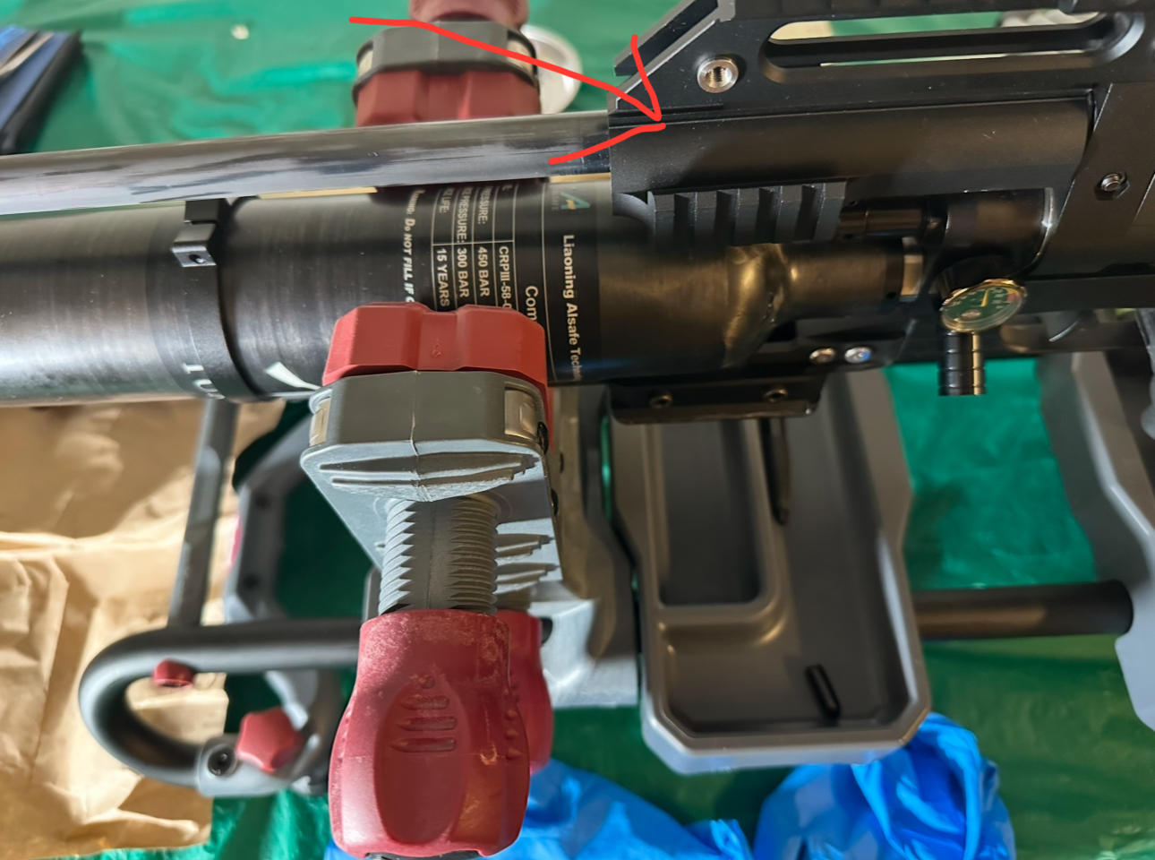

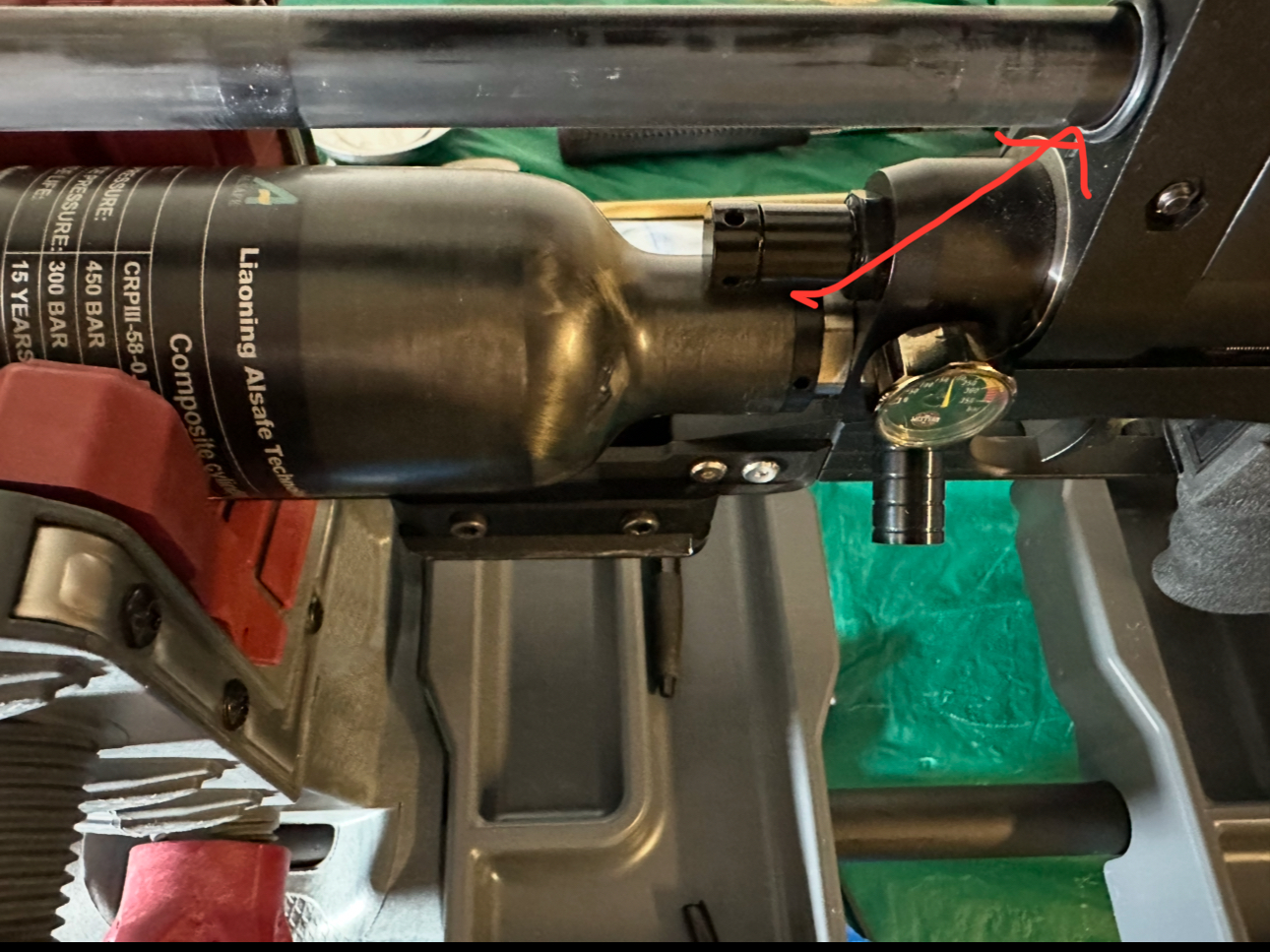

I was curious about the puff of air your feeling on your face and I found this on page 10 of the manual:
*If you feel a burst of air blowing against your face when the Rattler fires, it is probably because the barrel has been backed-off slightly too far. Loosen the barrel clamping screws, rotate the barrel A VERY SMALL AMOUNT clockwise, re-tighten the screws and test again

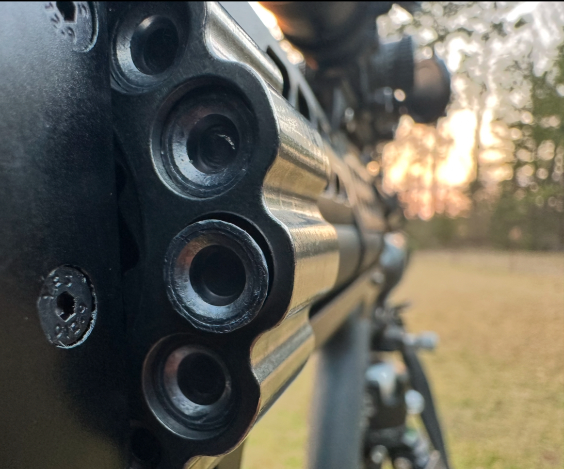

I have a question about the bores thru the magazine. Are the bores straight thru (no taper) or is there a slight taper to them...like wider at the rear where the base of the slug sits, and a little narrower at the front where the nose of the slug sits?
@davee1 Good question. I have no idea if the magazine chambers are tapered or not.

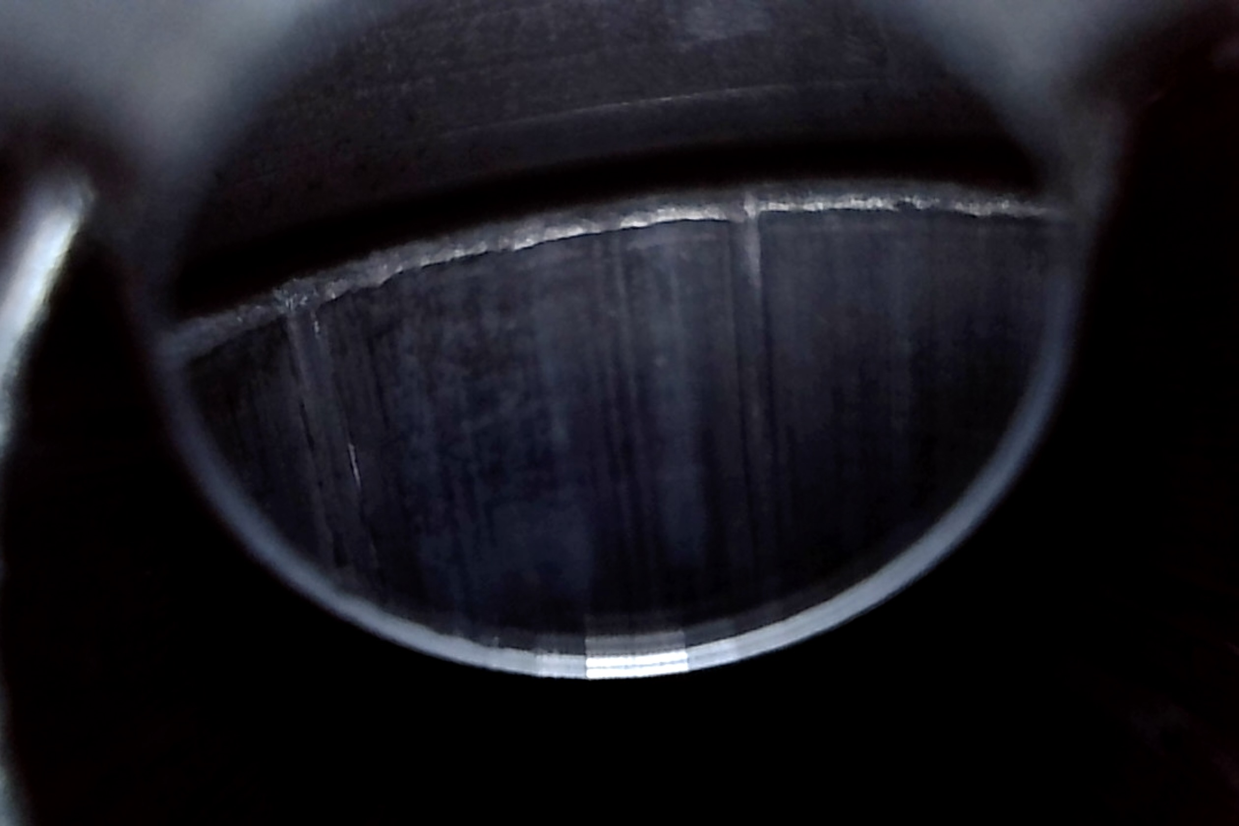

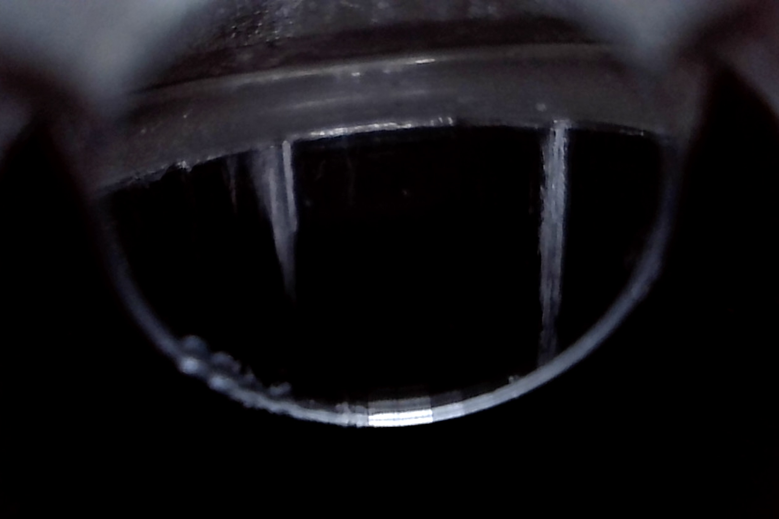

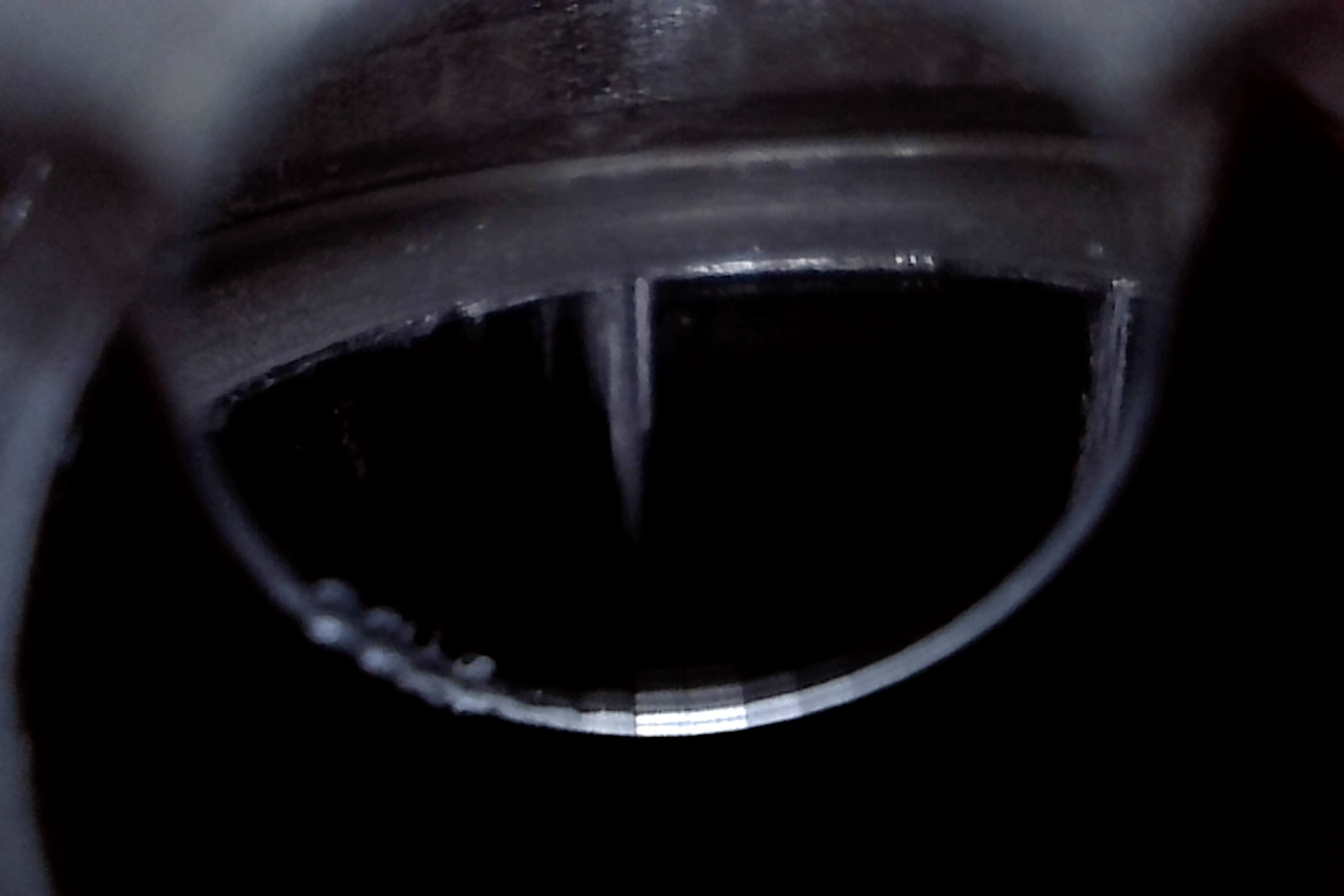

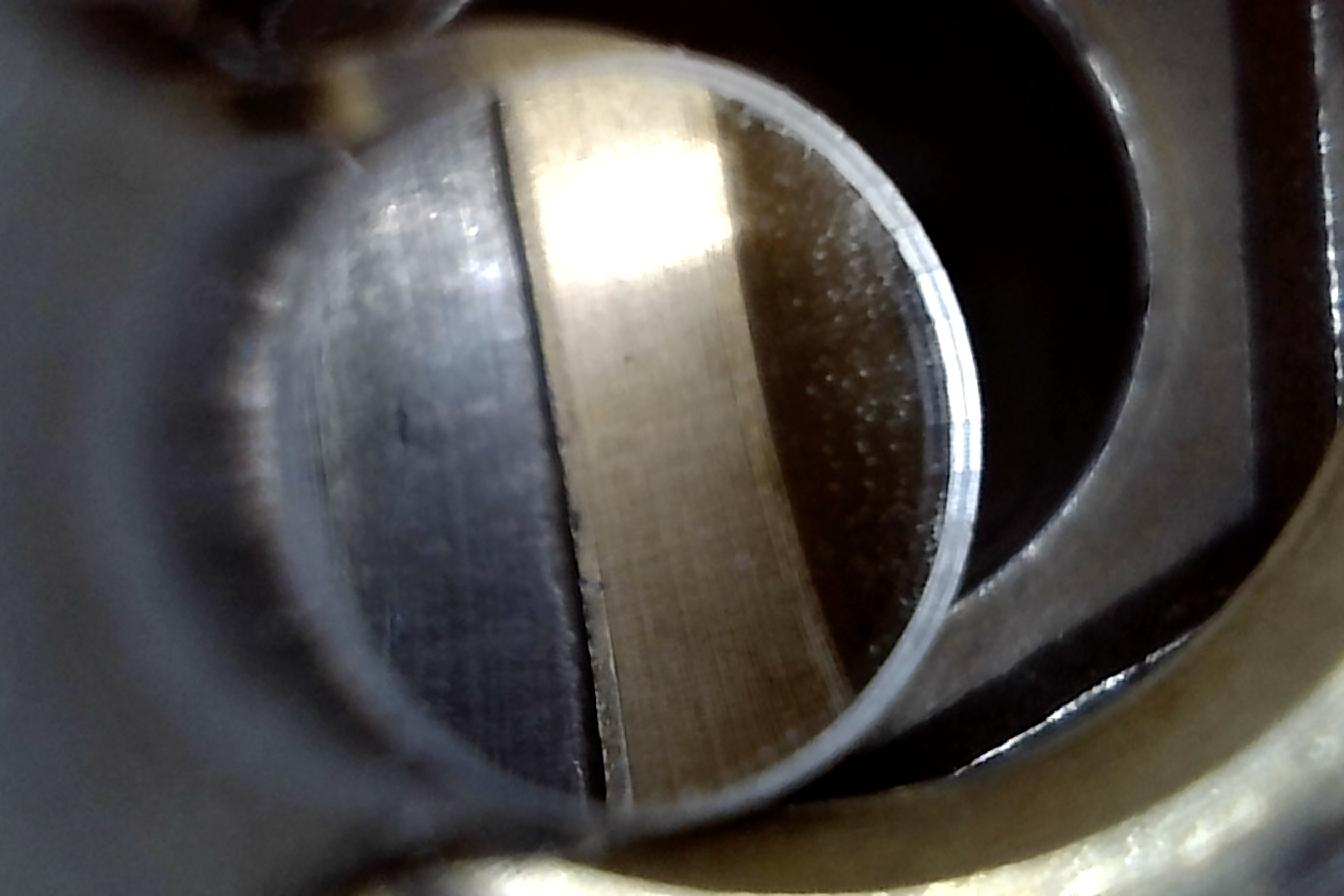

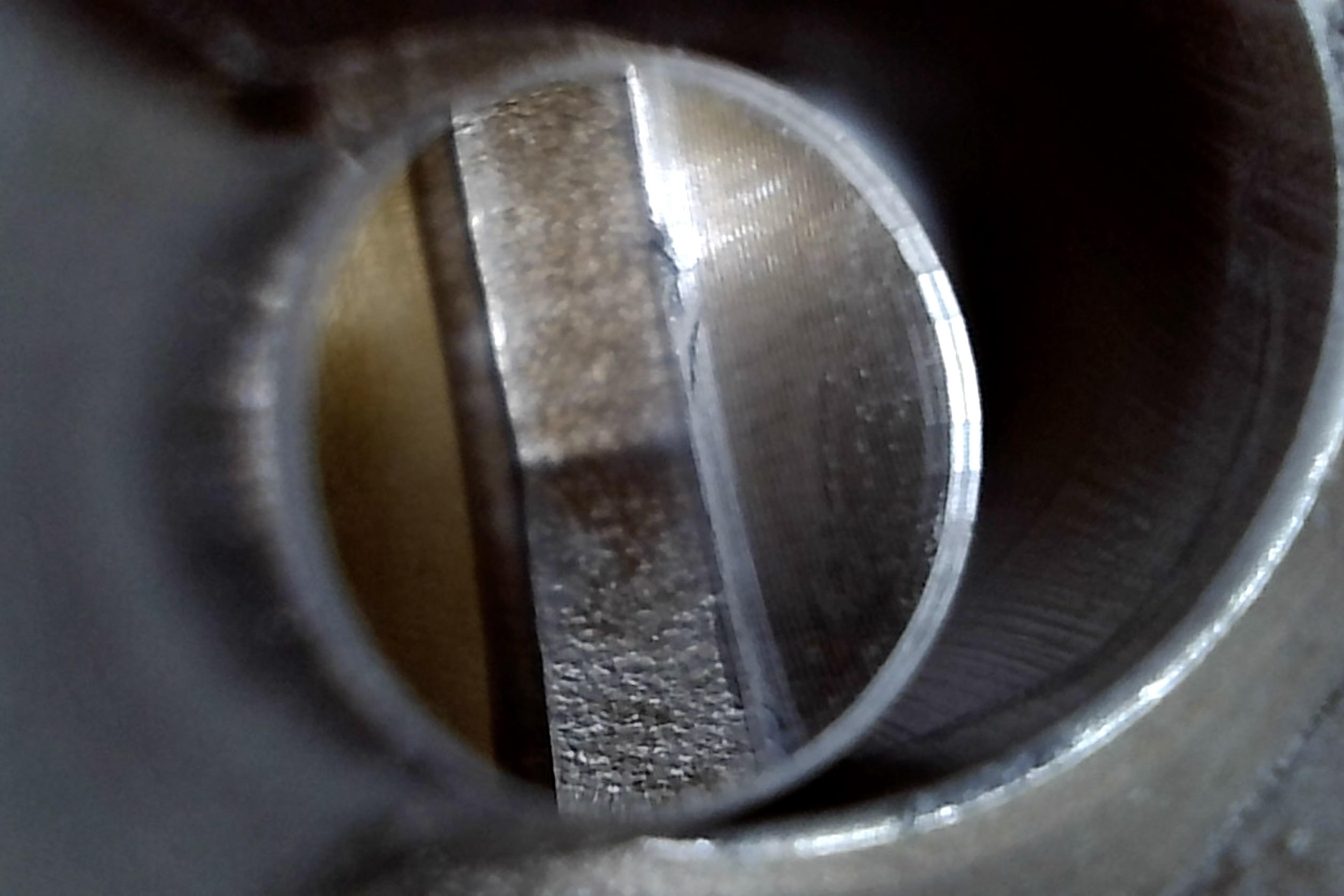

Ok so I have a string of bore scope photos starting from the rear of the magazine to the junction between the front of the mag and the breech end of the barrel, throughout the barrel, and up to the crown.
Rear of the magazine.

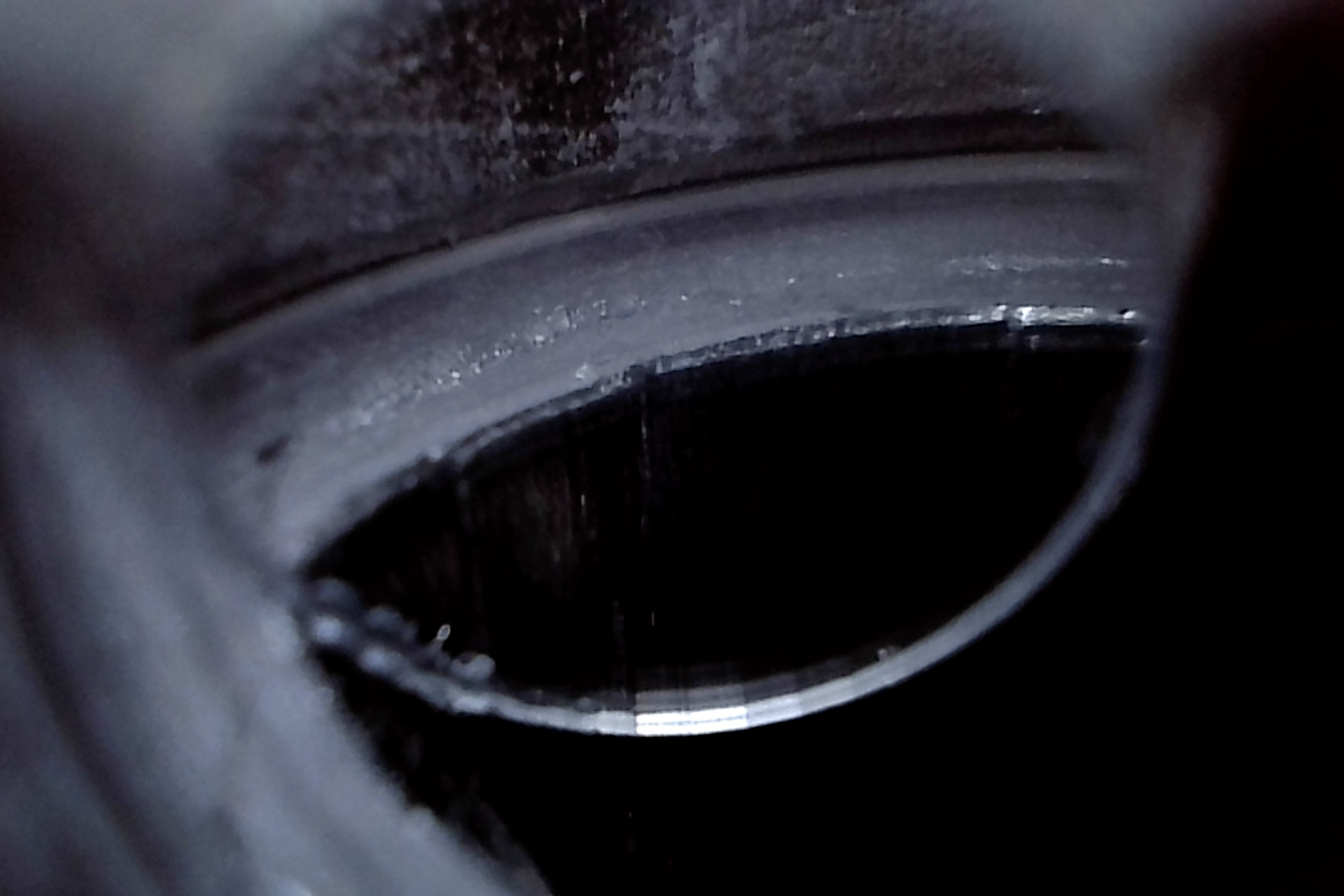

Front of the mag where it meets the barrel

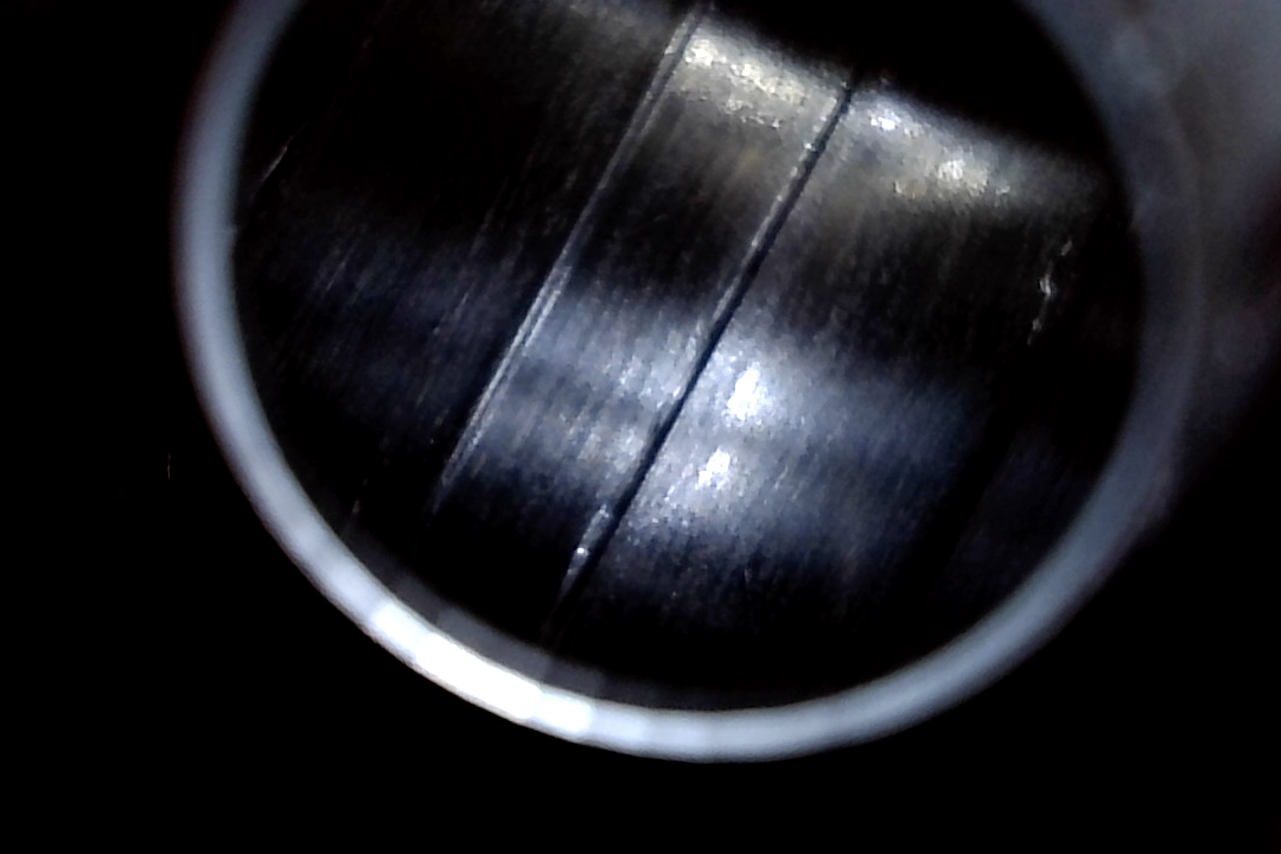

Leade of the barrel

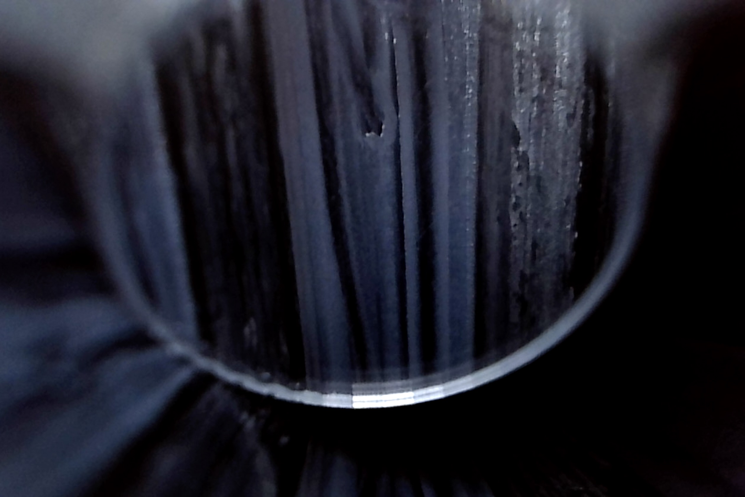

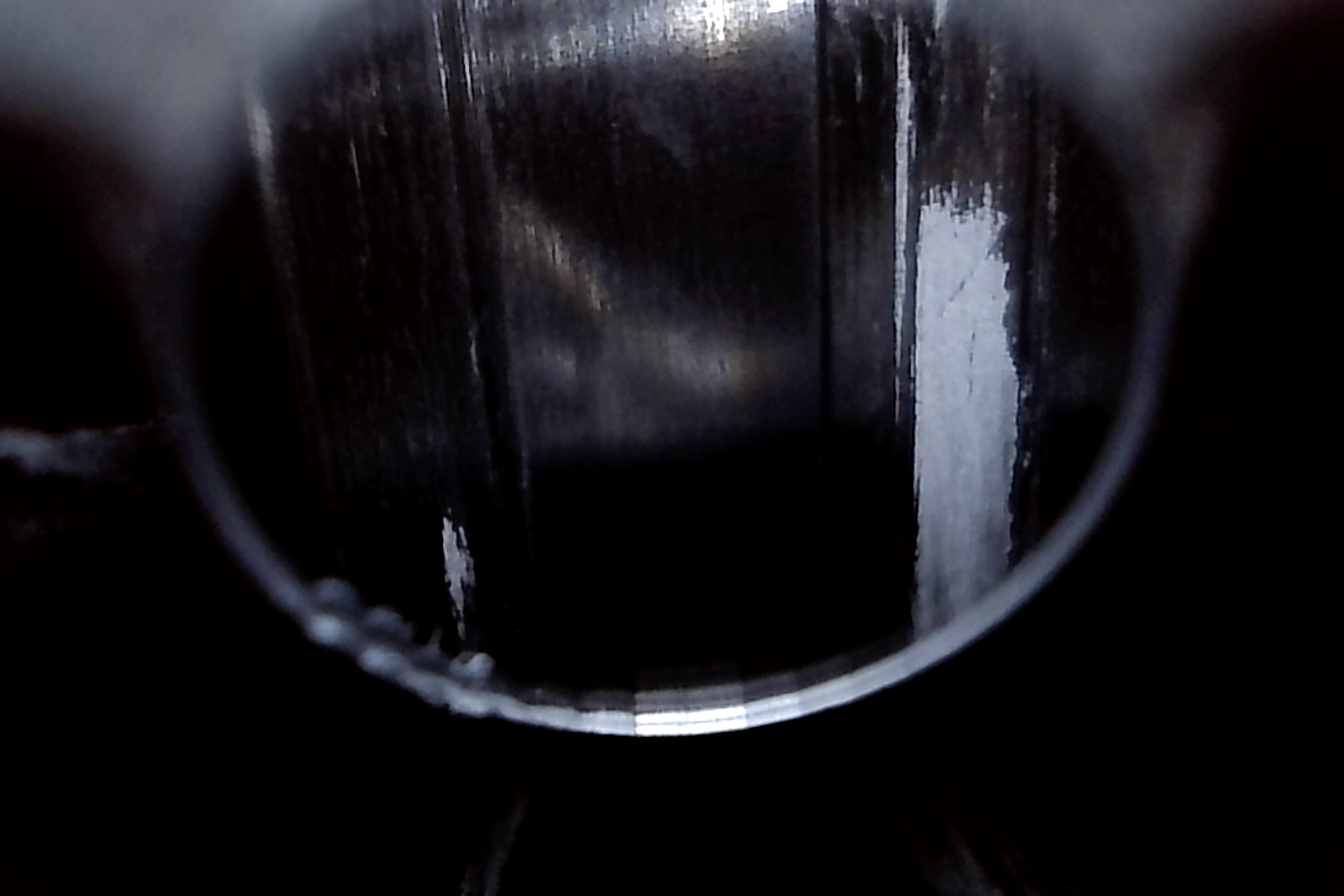

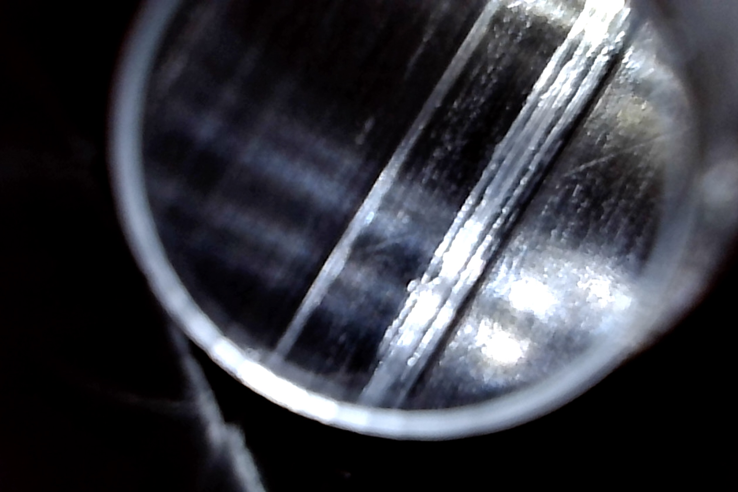

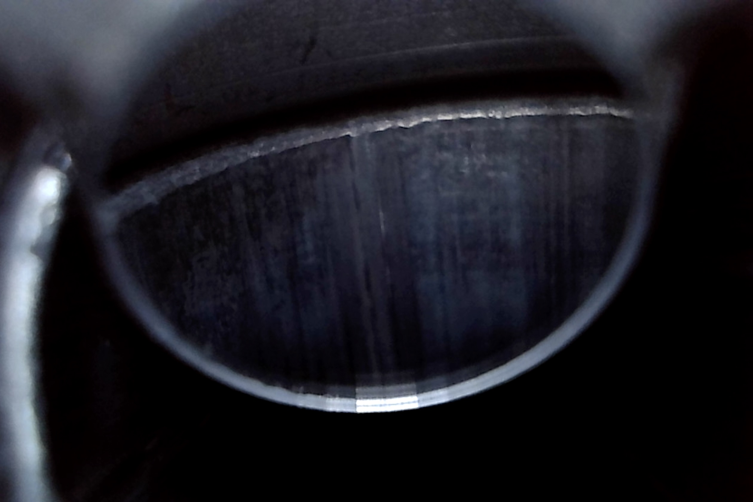

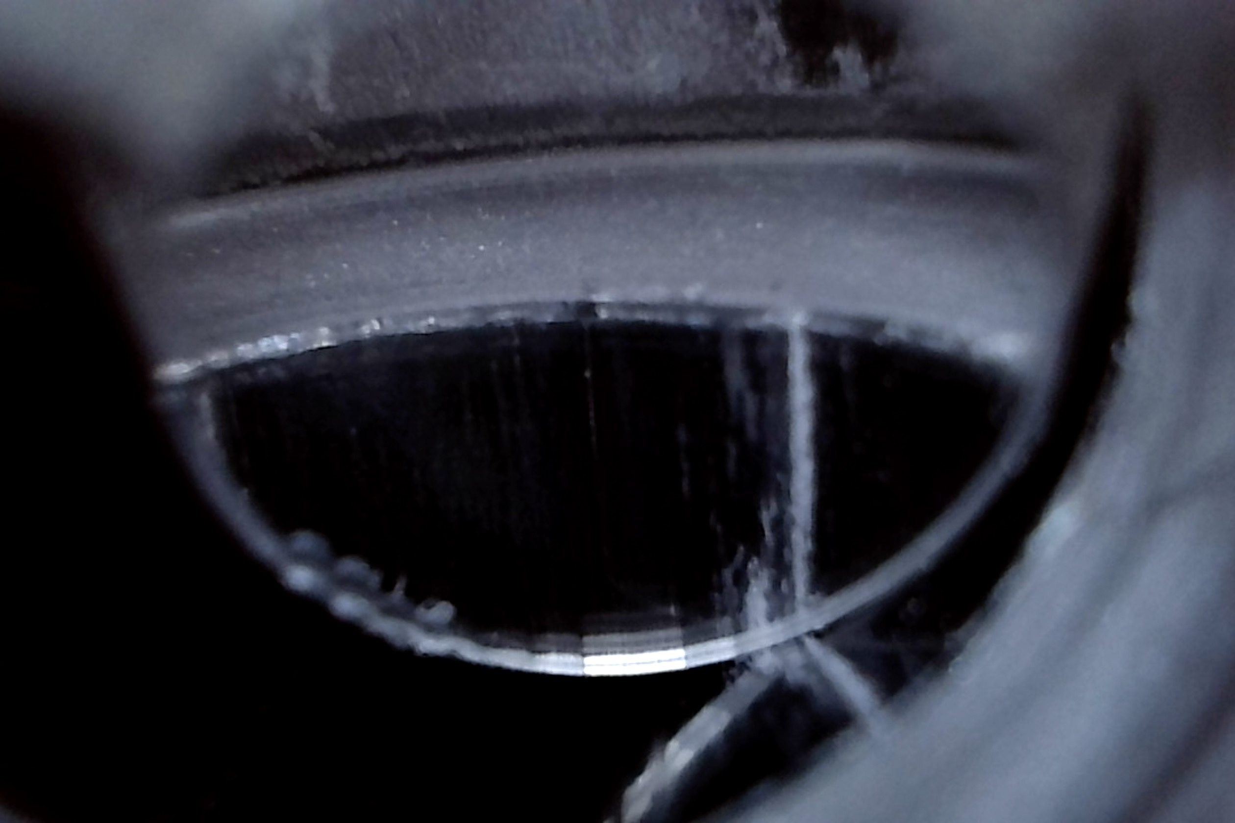

Leading within the barrel
It looks like some sort of lube or gunk is in here. Not sure what that gray stuff is.

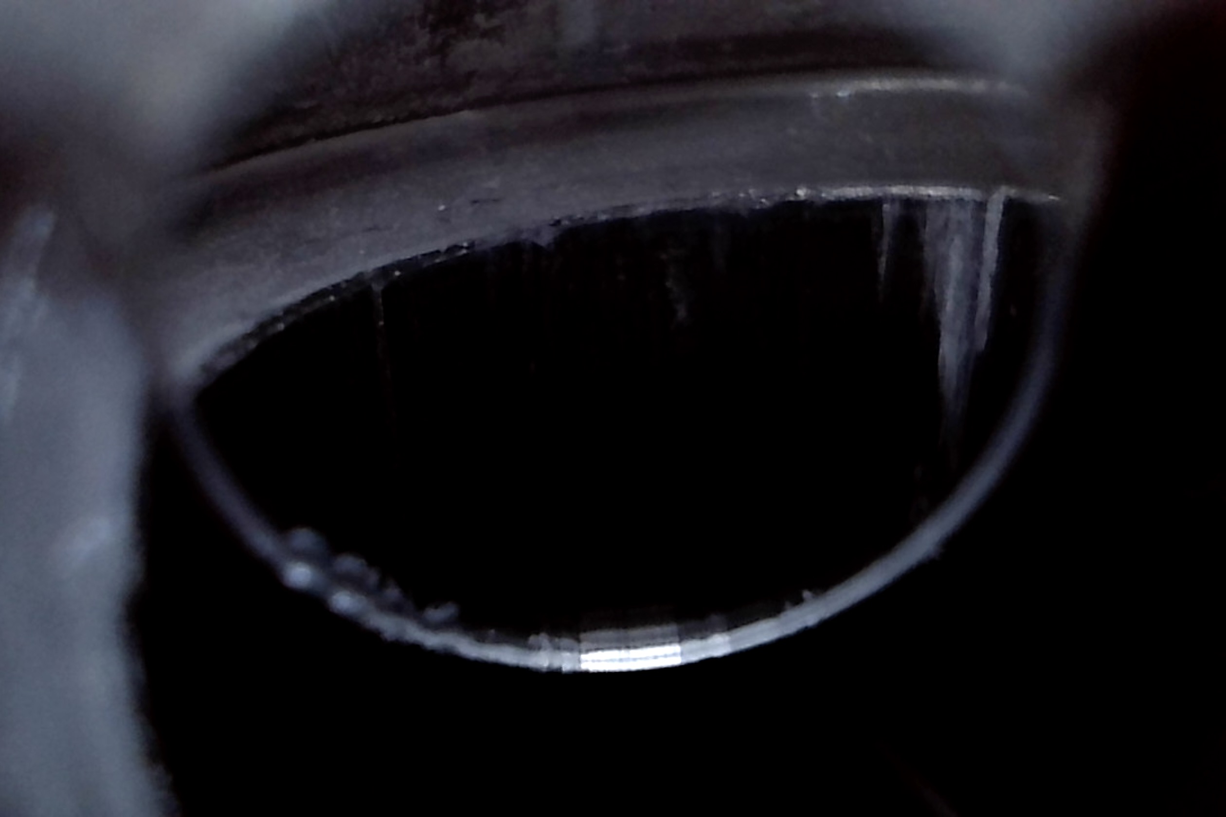

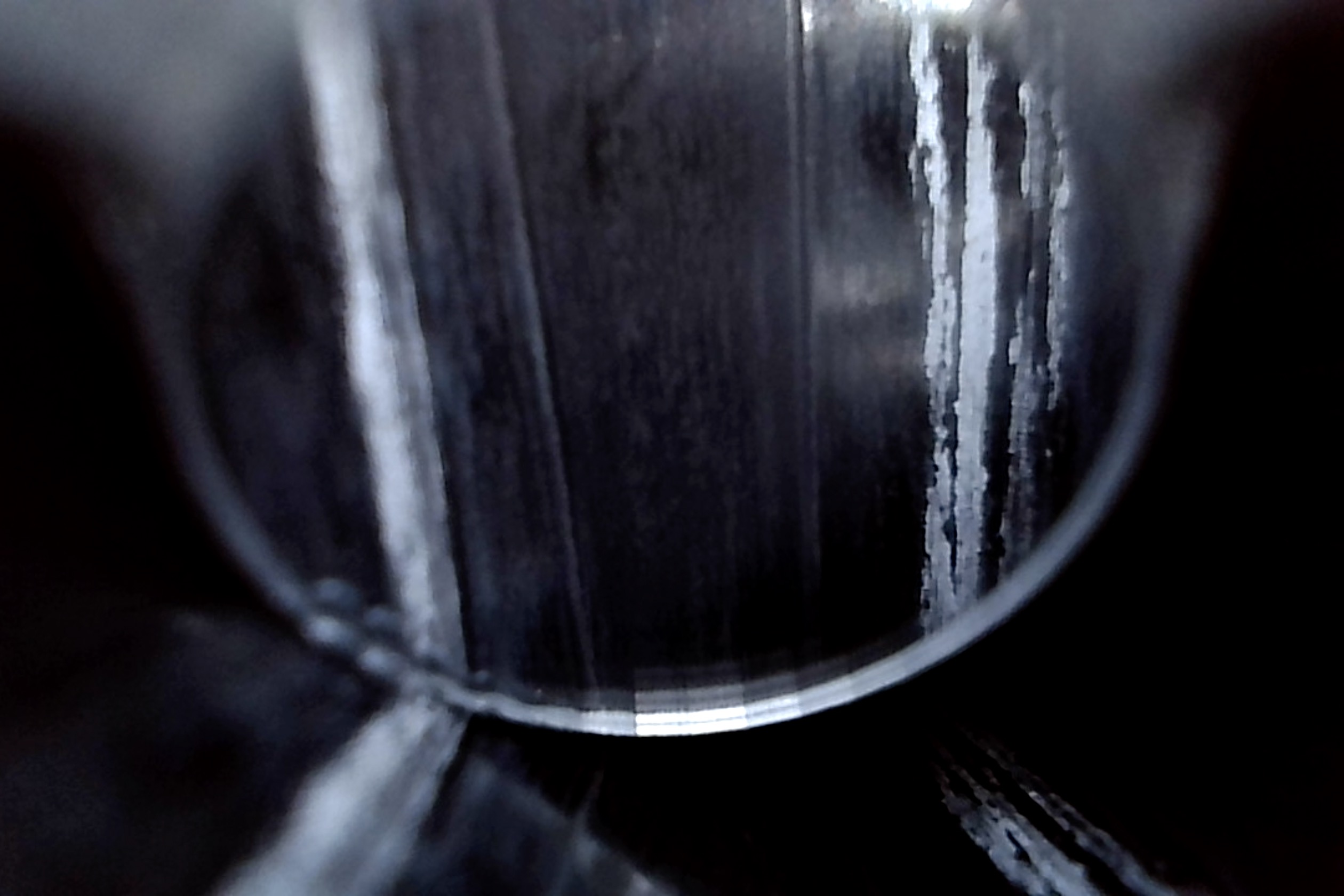

Leading at the crown
Another photo of the crown
Edited misplaced photo (out of order)

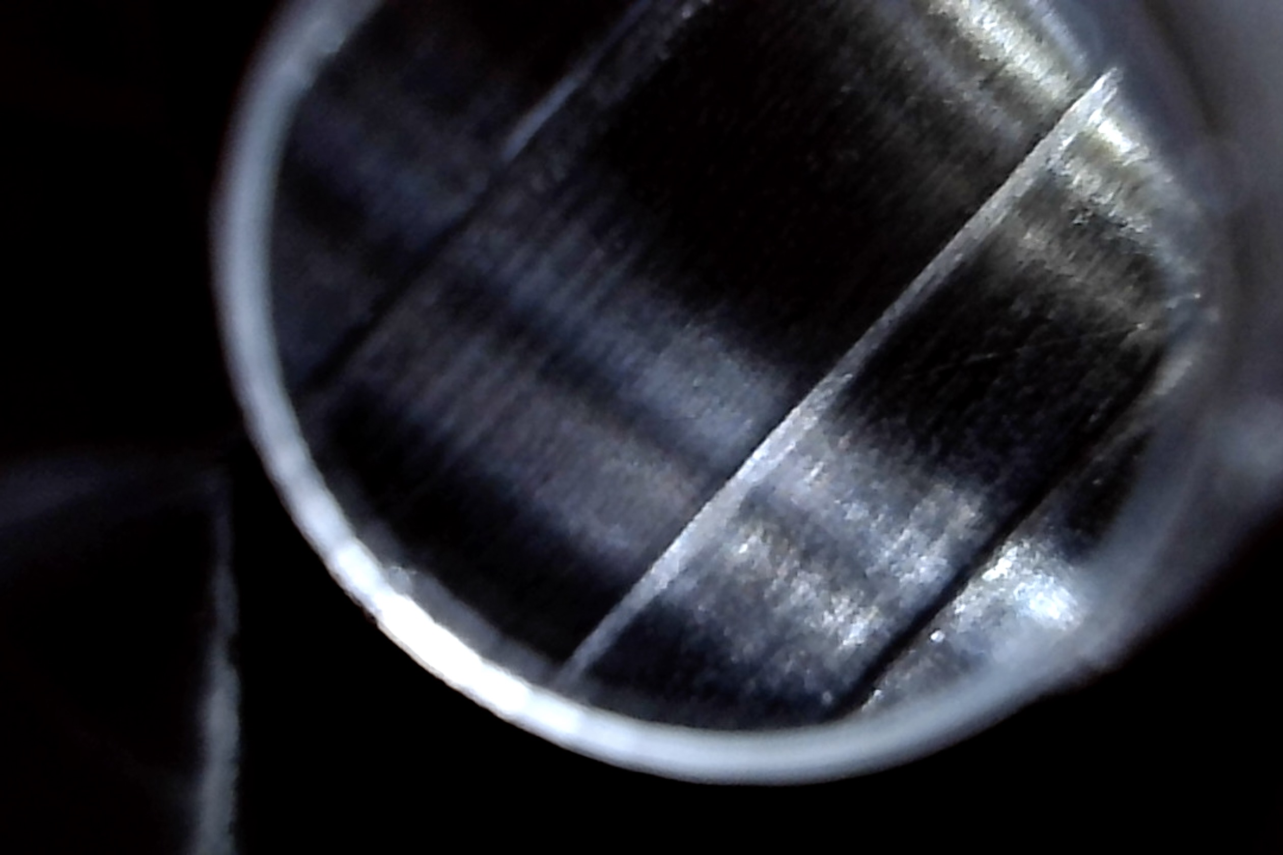

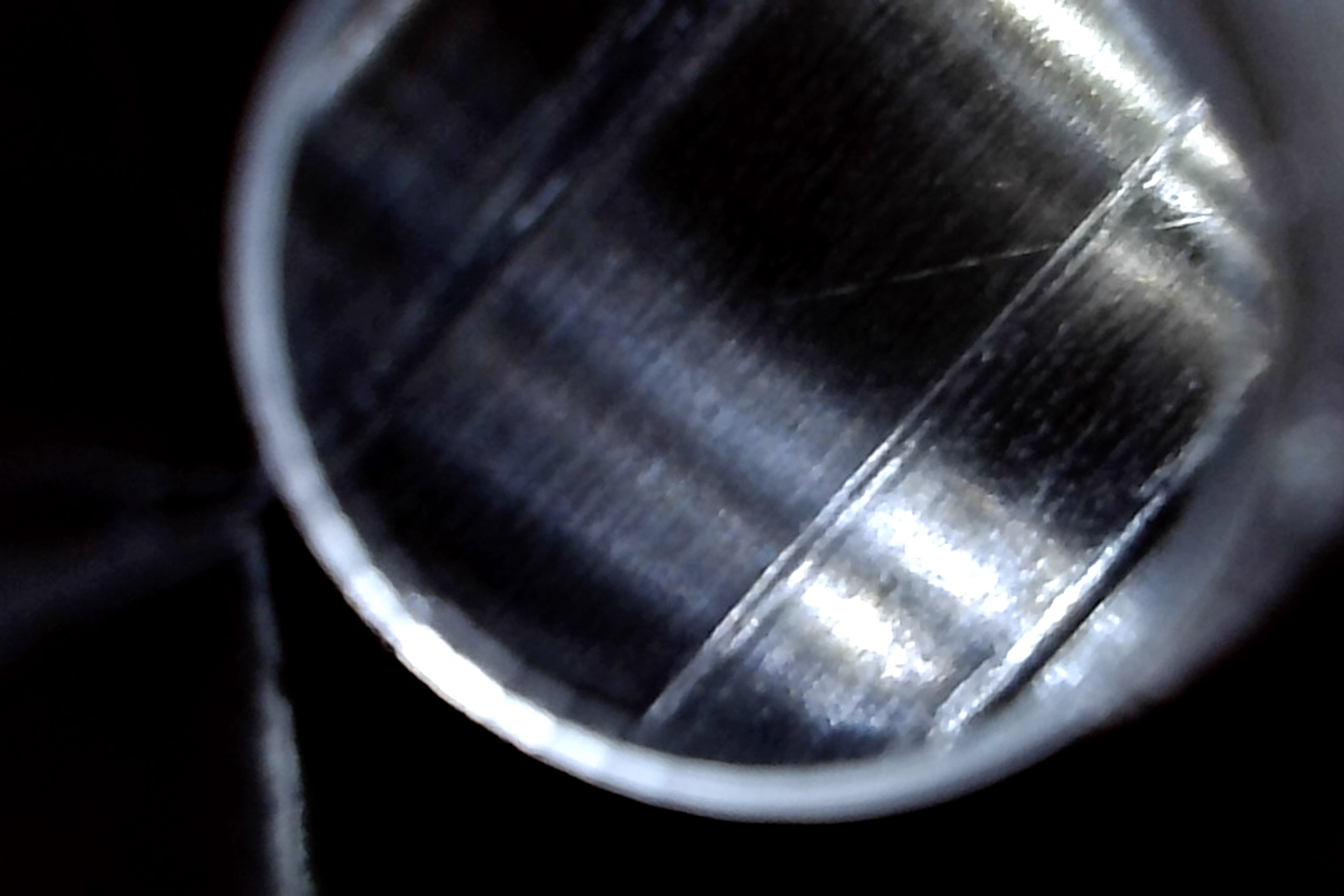

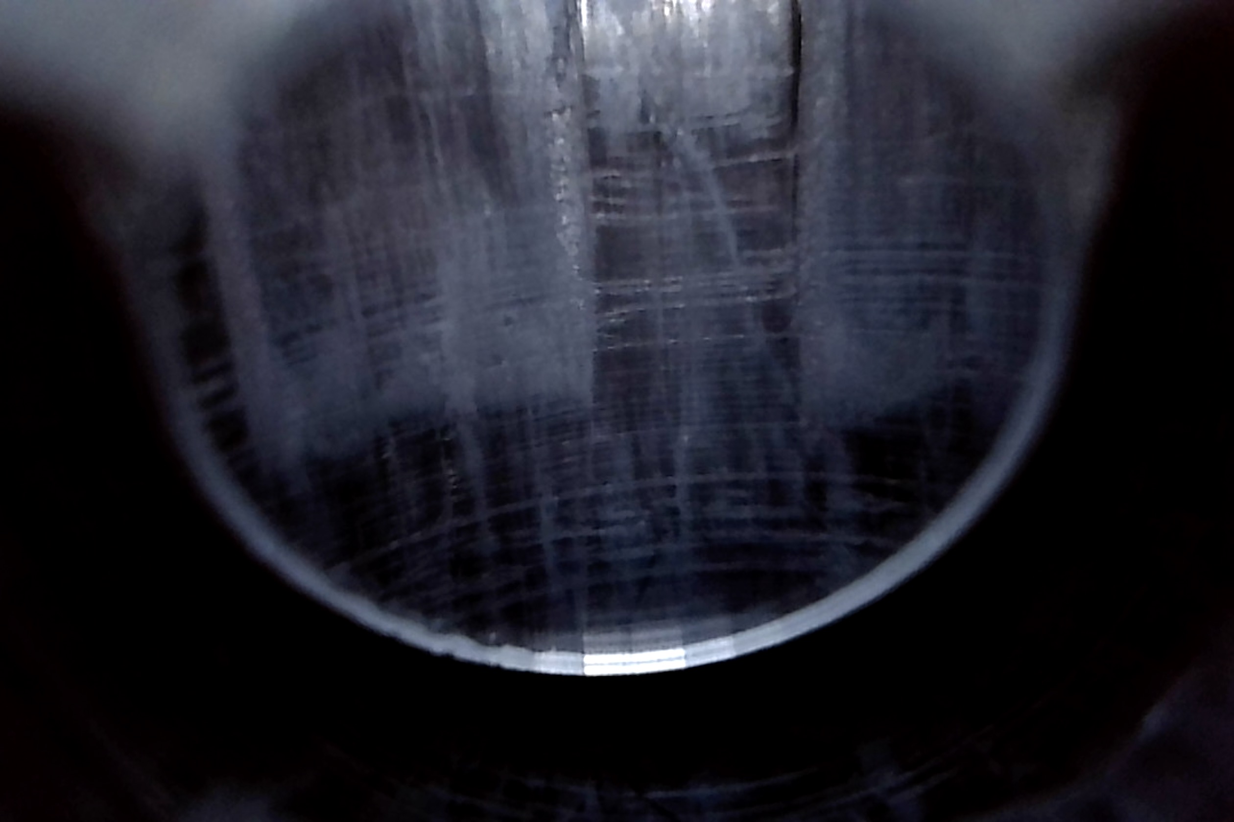

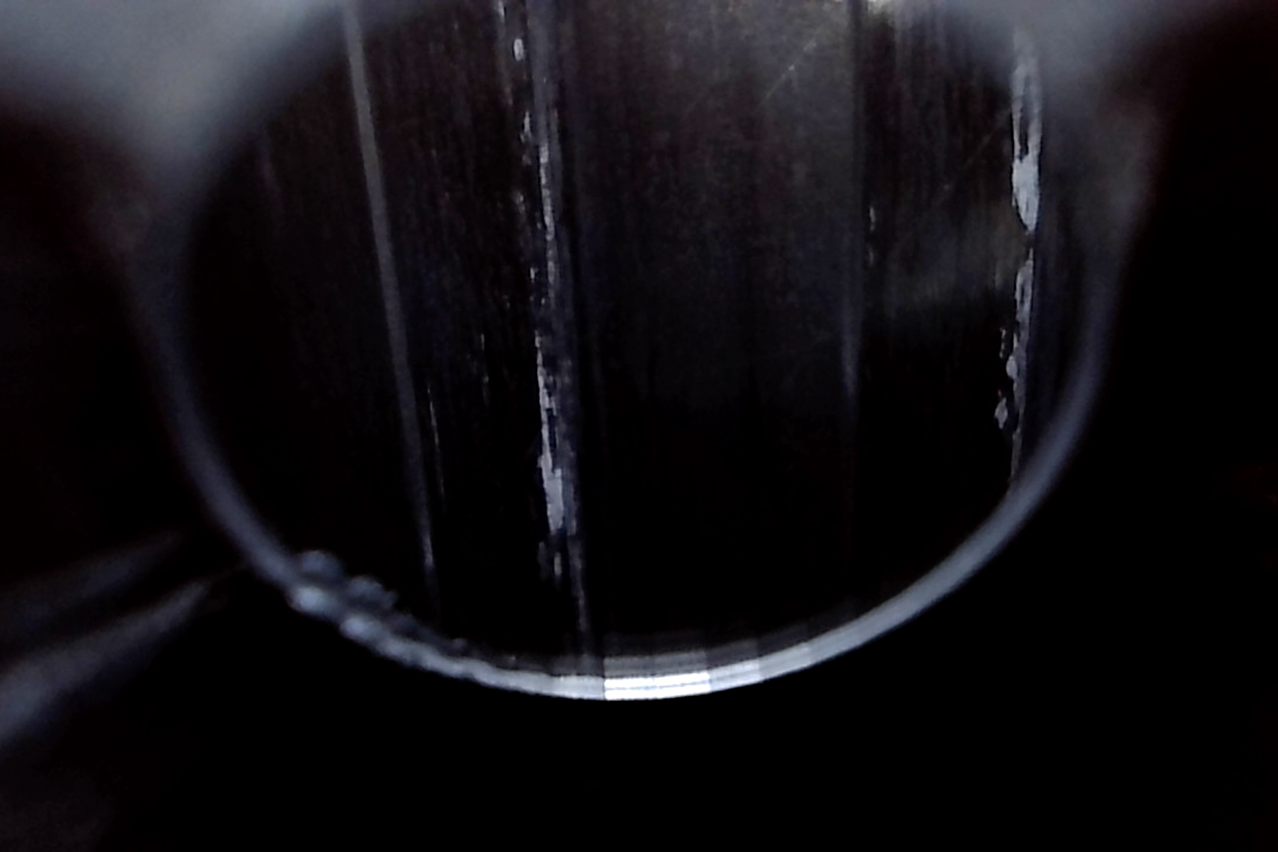

A kind member reached out to me earlier and was good enough to take time to walk me through some of the maintenance steps to remove the barrel in order to make adjustments to address this blast of air to my face. I also took the time to clean the barrel at his suggestion. I didn’t aggressively clean it, but I did use a carbon-fiber rod, lead/copper remover solvent, a brass brush, a plastic jag, Ballistol, and some cotton patches. Because I wasn’t aggressive in my brunch cleaning I didn’t get all of the lead out, but the improvement is noticeable. I only made two passes with solvent on the brush. Then dry patches. Next I ran a wet patches with Ballistol and dry patches until they came out almost white.

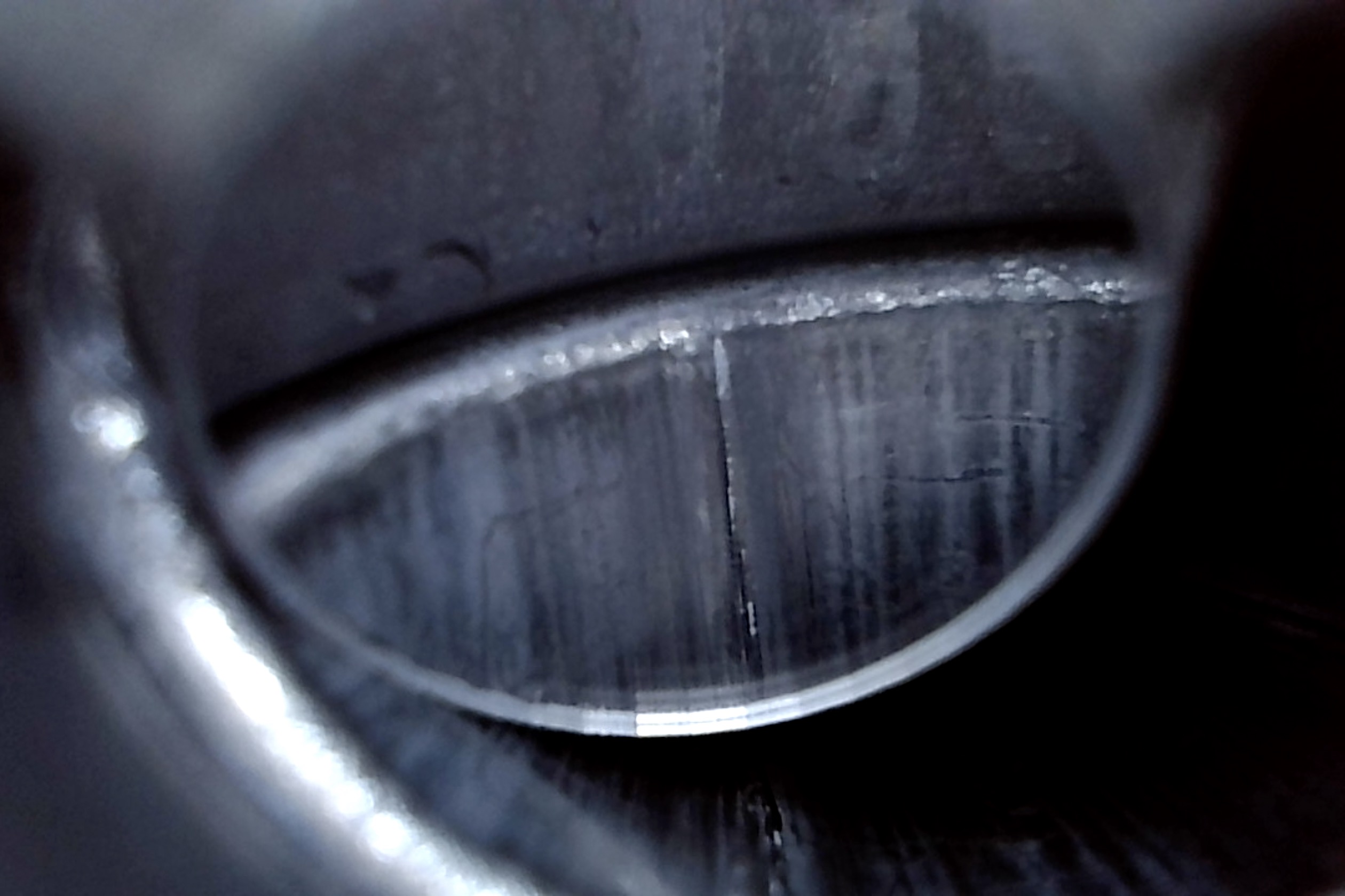

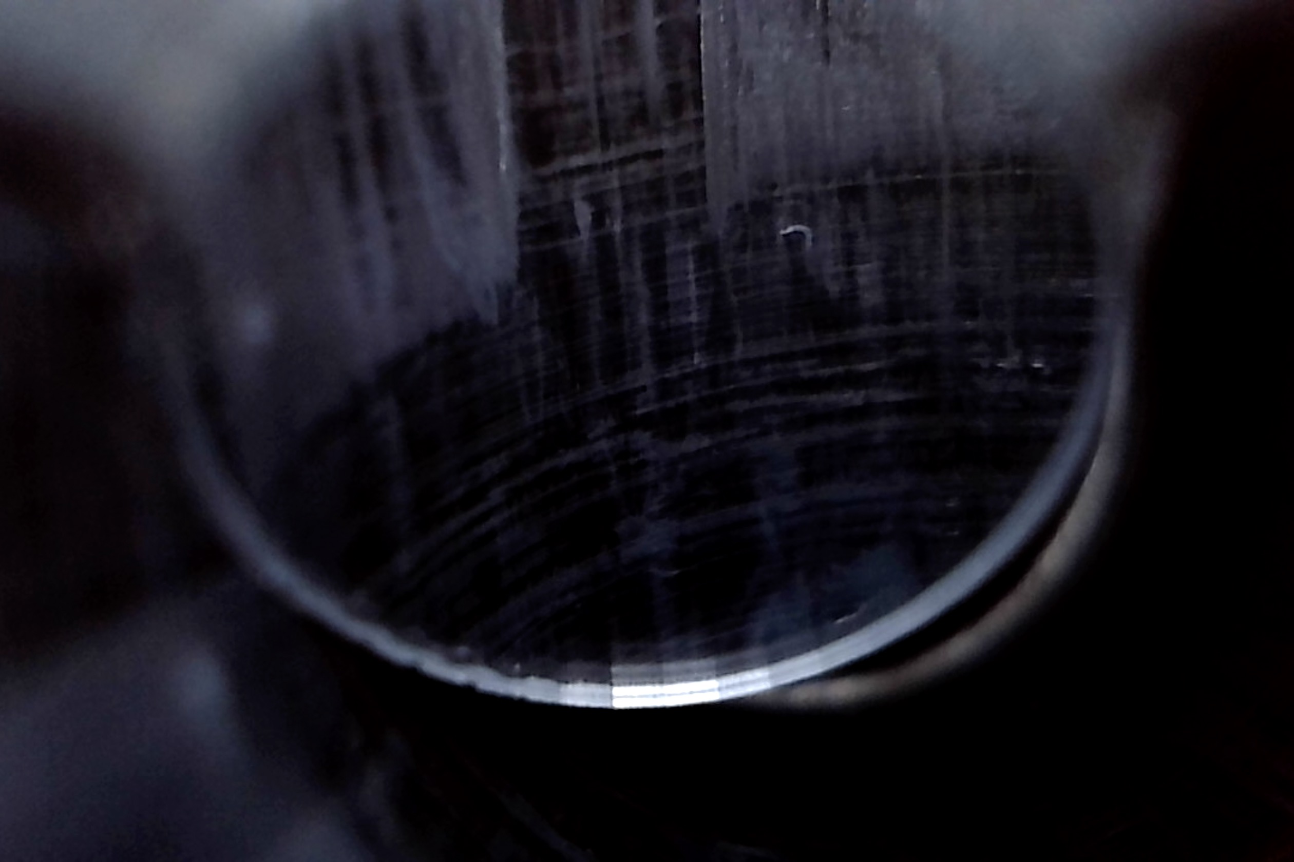

Here are some after cleaning boresope photos.
I didn’t clean the grooves towards the crown well at all because it was resting on the paper over the tabletop impeding the brush from exiting. I try to be mindful not to mar the crown while cleaning.

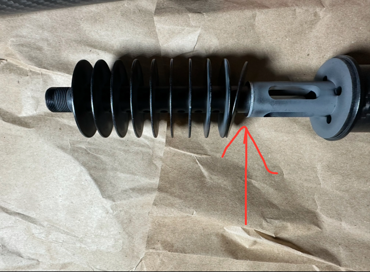

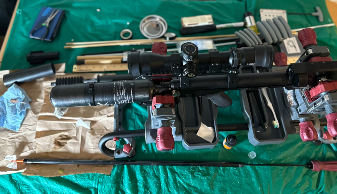

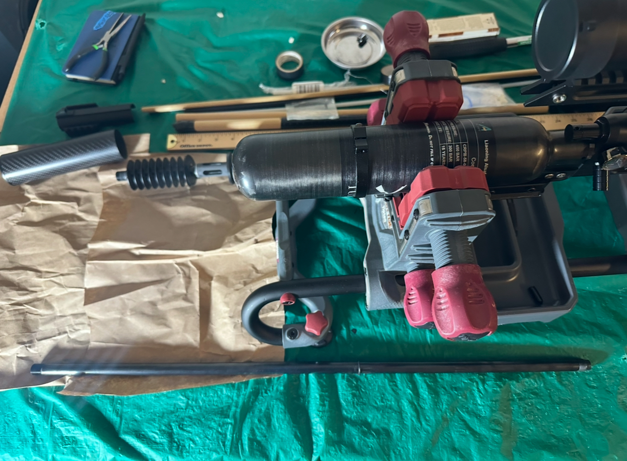

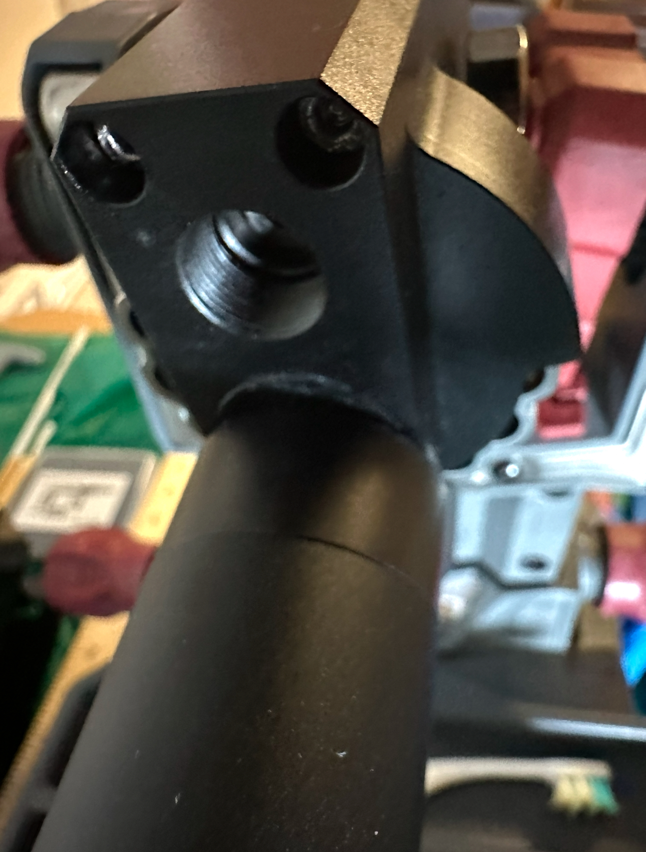

To remove the barrel first I removed the moderator cover which exposed the moderator core. I held the core with a gloved hand and unscrewed the core and shroud together. They come off as one piece. When I set them down I noticed there is a loose baffle to the rear of the core. The moderator internals is a single piece with no loose parts. It seems as if the weld is broken on the last baffle above the arrow.
Next I removed the over-the-barrel pic rail piece.
I noticed an o-ring that I assume is there to cushion the end of the carbon fiber shroud and the chasis.
Then I loosened the two allen screws that secure the barrel, unscrewed, and removed the barrel.
Then I rotated and removed the front cage. Next I removed the two small screws that secure the cheek rest to the receiver. Finally I removed the rear cage.
After removing the barrel I cleaned the threads with cotton swabs. I applied a little graphite powder to the barrel threads just before I replaced the barrel.
This was taken as I cleaned the barrel.
Edited typos and for clarity.

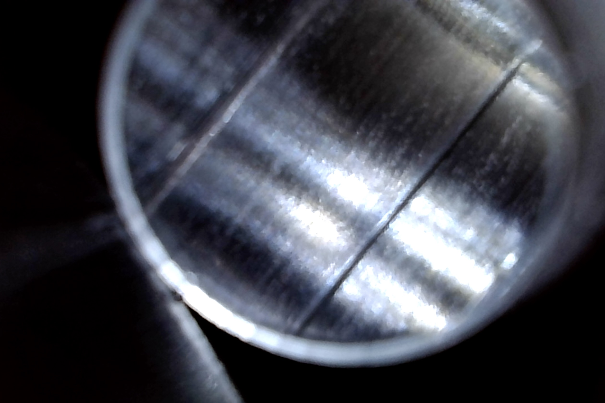

Oh yea. In some of my post-cleaning bore scope photos I see some scratches in the barrel. What do y’all think caused that?

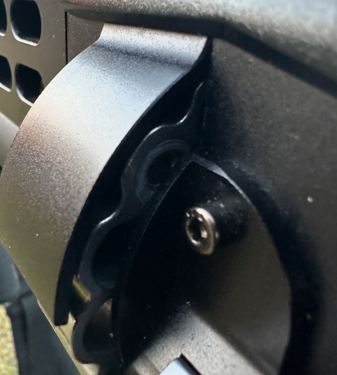

I wanted to address my Rattler’s magazine cycling issue further by adding some advice that I hadn’t previously posted. The quoted excerpt below comes from correspondence with Shane at AOA:
“Regarding the magazine cycling, the cold can definitely affect it. You can try to increase the airflow going to the mag by adjusting a screw underneath the loading gate you slide up and down on the right hand side. Underneath that, you have two screws both 3mm allen, the bottom one adjusts the air flow to the mag and if you turn it counterclockwise you can have more air go to cycling the mag.”
I have not tried making this adjustment yet.
