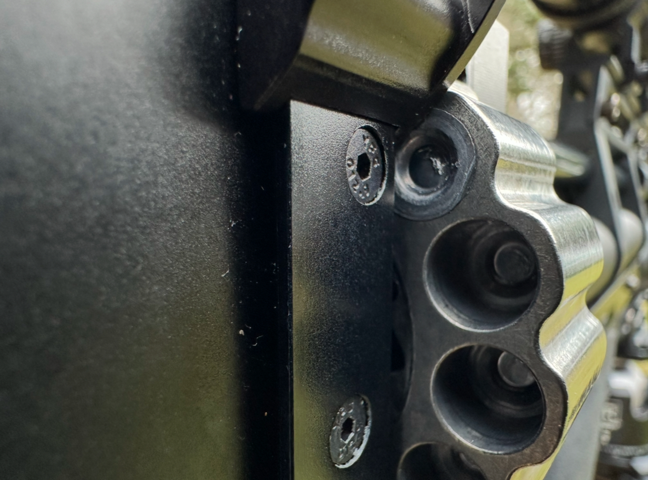

Today I was able to take some time to make some barrel adjustments and get some trigger time in. I learned some things and came to a conclusion I’d like to share.
First of all, it is so much easier to work on magazine and barrel alignment issues and jams with the barrel cages off. These cages are the waffle like plastic pieces that cover the barrel back towards the receiver. I don’t like them. Using a black sharpie I placed witness marks on the barrel and chasis to have a reference point to my barrel orientation’s origin. In order to adjust the barrel I simply loosened the barrel retention screws, grabbed the moderator cover (not the shroud), and turned it in the direction I wanted to adjust the barrel. The photo below was obviously taken after moving the barrel from my starting point. I moved it until the only air I felt during the shot cycle was on my chin. I can deal with that.

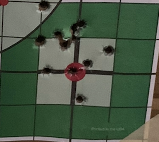

Here is today’s target. Circles 1-5 were shot with JSB 81 grain Diabolo pellets. Circles 6-10 are shooting NSA 110 grain HPDB slugs. Keep in mind that I recently cleaned the barrel also, but the difference between the accuracy of the two projectiles is pretty obvious. Everything was shot form 50 yards with very little wind.
The NSA slugs shot as expected. The scope was zeroed for pellets at 35 yards. I used my holds from my DOPE and some shots grouped high, others hit low. I would change my hold sometimes to see if I could correct the variances, but there was no recognizable pattern to the trajectory deviation of these pellets. My conclusion from these groups and previous groups are that these pellets do not shoot well out of this gun out past 30-35 years maybe. I have to check that against previous targets. My biggest issue if with the vertical movement. That is not all due to my actions. Look at the slug groups. The vertical movement seen there is due to things I was doing behind the tripod. I understand what I did because it’s consistent. Then look at circle #8. I was able to cut down on some of that movement. Also note that targets 6-10 are significantly smaller that the circles above them.

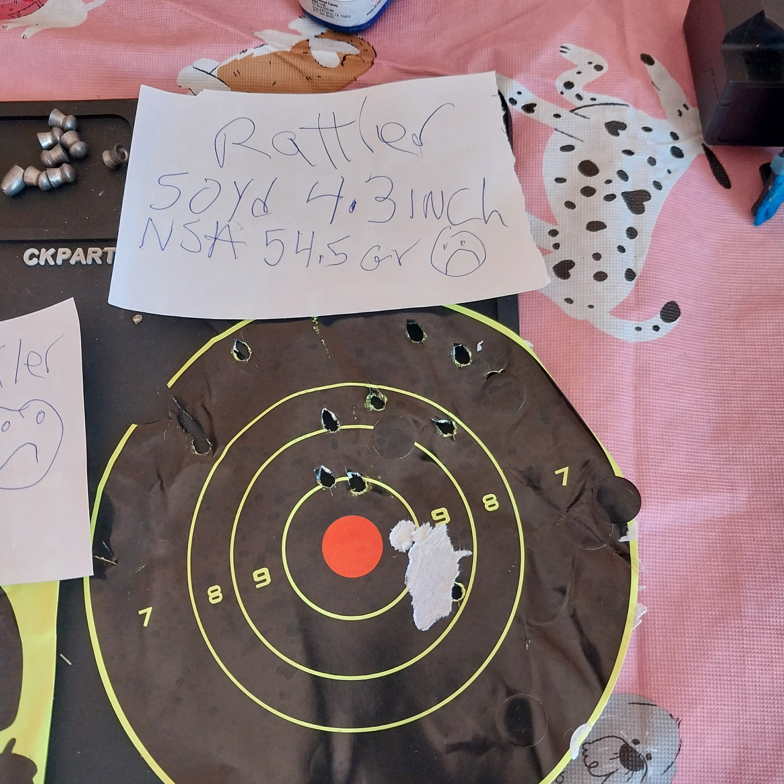

wow i got a rattler 3 days ago , when I first shot nsa grouped horrible i tried some 60 gr pellets my wife made 4 shots then flipped switch and bottle dumped and I had to remove barrel and get out deformed pellet jammed 2 of them , I then cleaned and recrowned to 11% , today I shot 3 groups , 50 yards 32 with jsb 45 gr 900 fps , then 54 gr nsa slugs 880 fps , off tripod , by far this gun is least accurate gun I own , I am hoping i need heavier ammop or different diameter , If it shot I had 5 yotes to take out in my yard coming after my dogs , here is my horrible 50 yd groups and 34 pellets which shot at 8 inch plate 100 yds , anyone with any ammo tips let me know mine is 30 cal

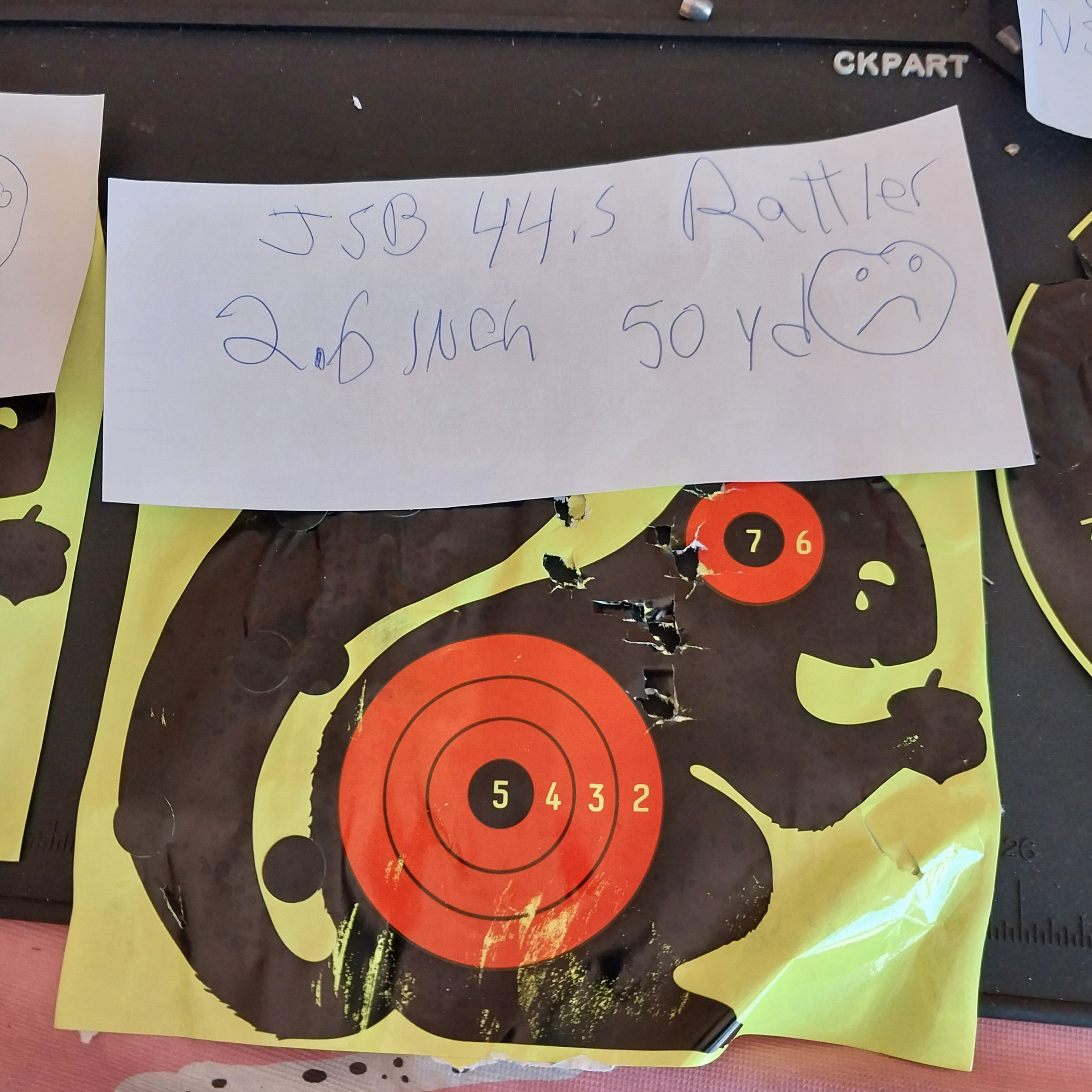

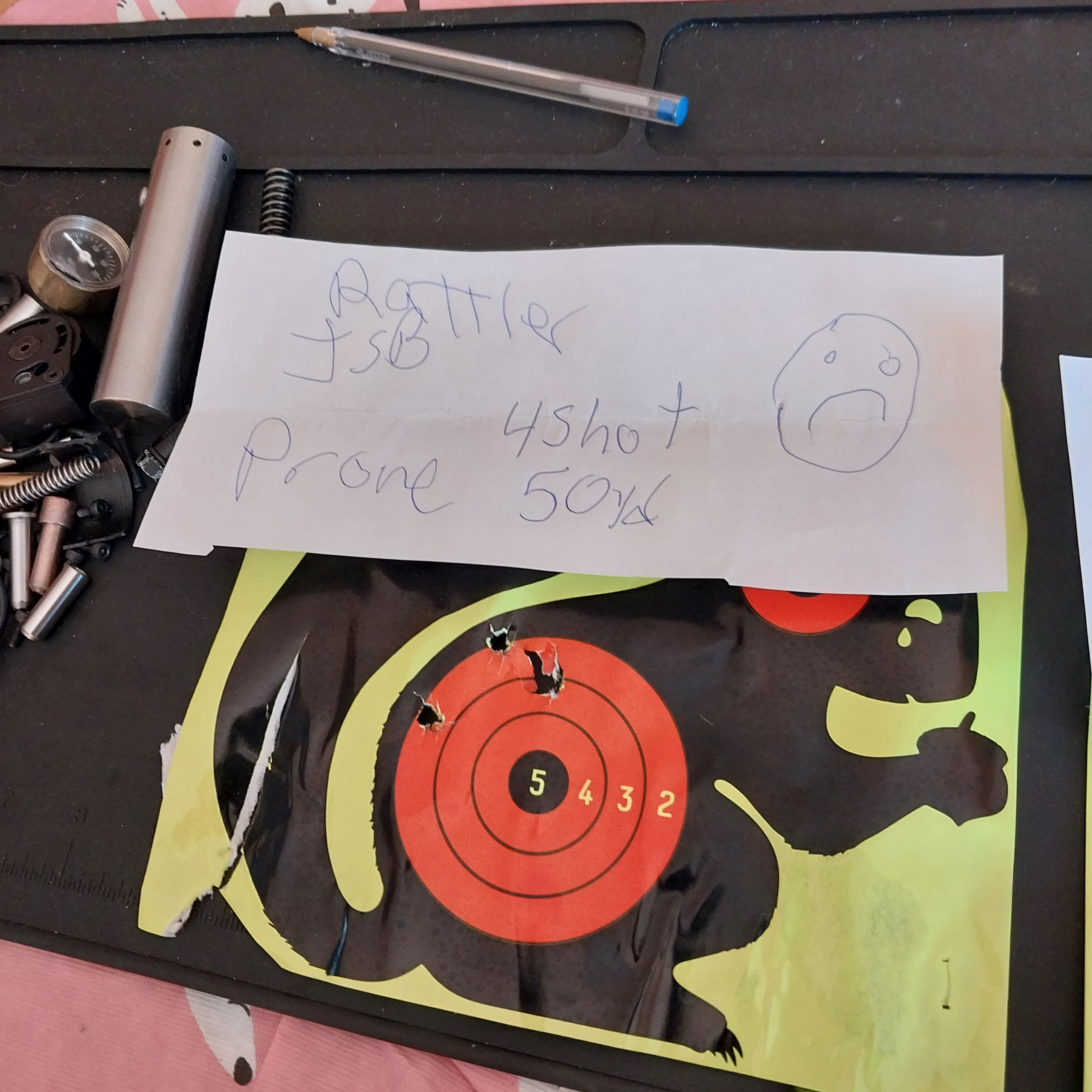

Soooo here’s another Rattler that doesn’t shoot JSB pellets well. This member is a better shot than I. I think focusing on shooting slugs from the Rattler will be more productive moving forward.

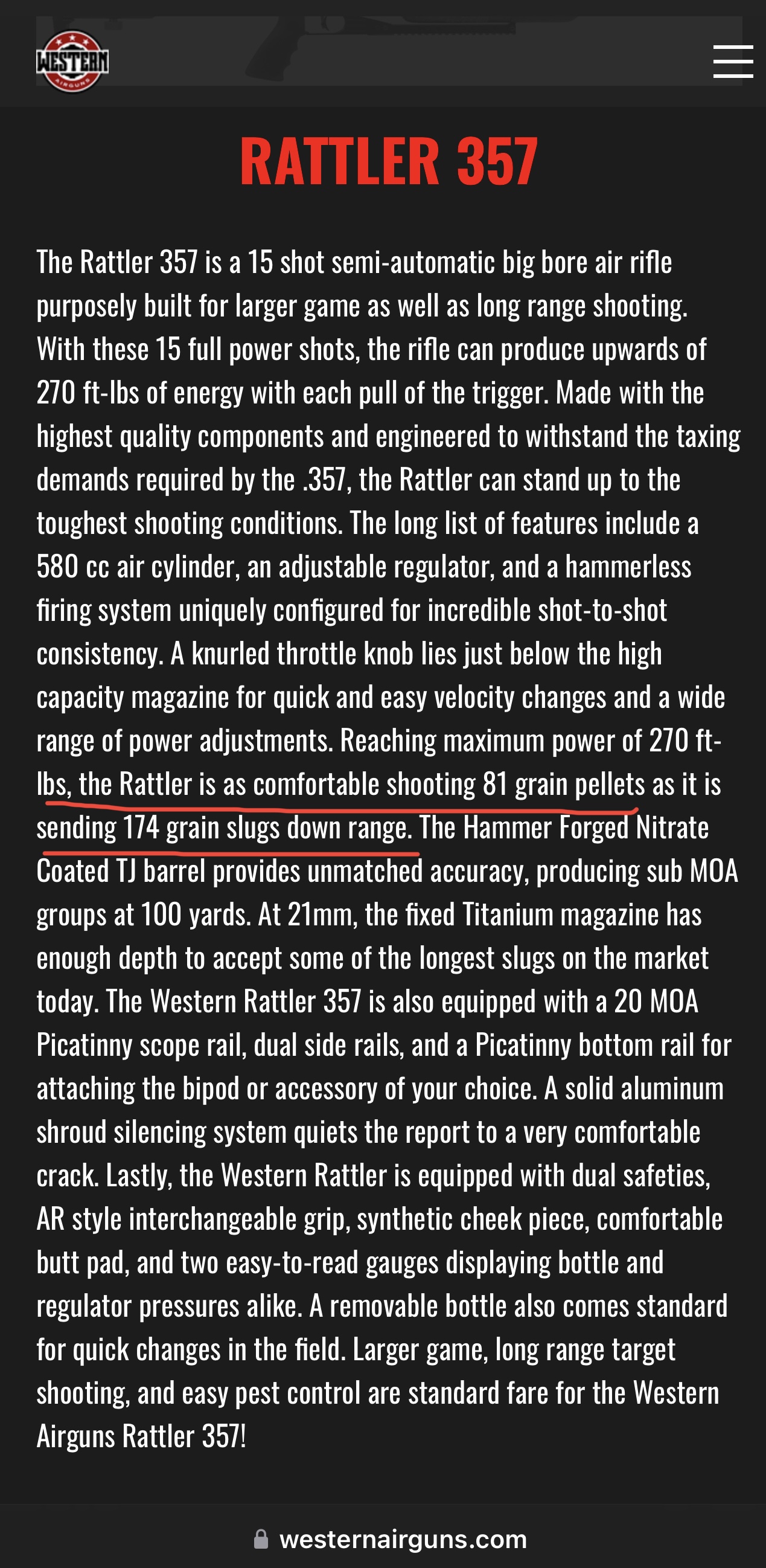

@shootinsquid I dont’t blame you. Shop wisely. Pellets are the thing that I’m not seeing when I compare how this rifle has been marketed and reviewed in videos. A handful of members seem to really like theirs once they got them dialed in. I’m not there yet. This Rattler shooting pellets video was eye opening. I’m not familiar with the content creator, but I assume the video was edited. We probably have different skill levels and I was not seated or shooting from a bench. His is a .30, mine a .357.
Here’s how it has been advertised.
If this never comes together to shoot pellets accurately beyond 30-35 yards, I’m not going to be happy.
Yeah, I hope this isn't misreading advertising also. I'd like to see the upper end power level (in this advertising) be true and the things be moa accurate at longer ranges which are more typical of this style and caliber of big bore.

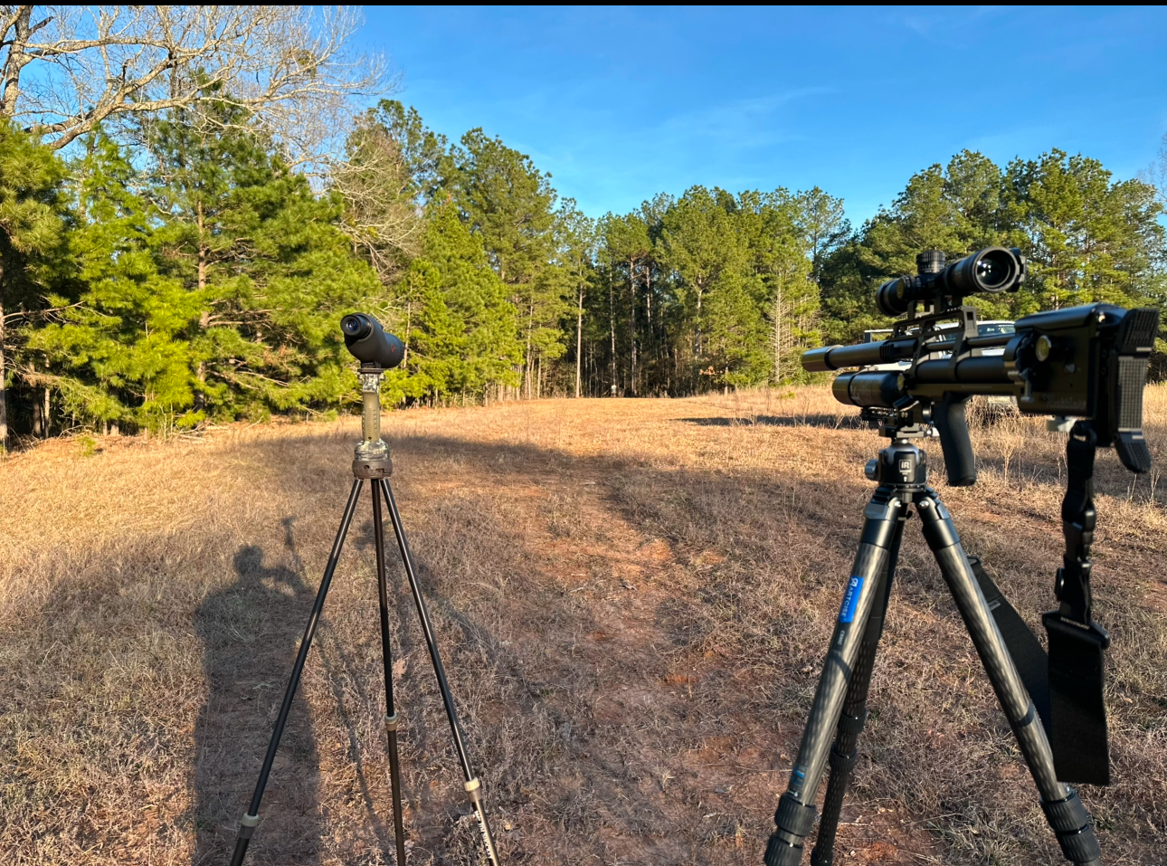

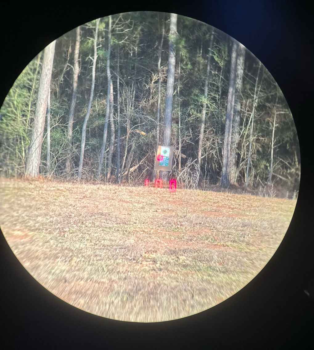

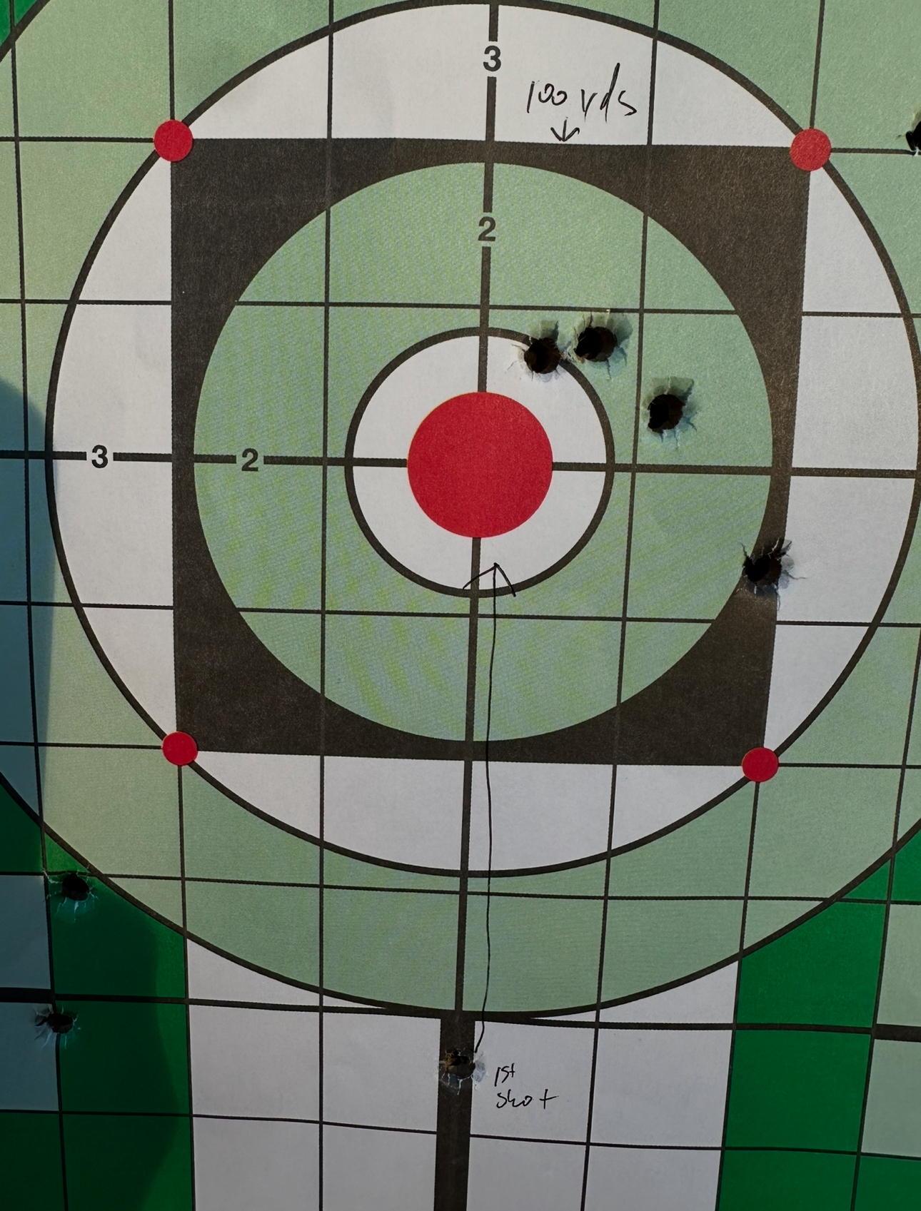

Back at it starting my work from 90 yards again.
Same target as yesterday. Target I drew in lower left corner.
I think I got my hold figured out. I’ll find out on the next target.
I filled my reservoir to 250 bar last night in some cold weather. After bringing the rifle in to sit over night and placing Rattler in the sun in truck and in tripod before shooting my reservoir gauge read 255 bar and the regulator gauge read 175 bar. After 2 shots and a dry fire the reg settled to 150 bar where it is set.
Definitely minute of deer, although I’m not sure I’d want to take a 100 yard shot with an air gun that groups like that. Seems to be an improvement, tho. Nice work, sir.
@shootinsquid It’s not the gun that shoots like that. It is I. I am NOT someone to be looked as one who sets the standard. I’m just a regular guy. I’m confident that I’ll get better the more time I spend behind the trigger.

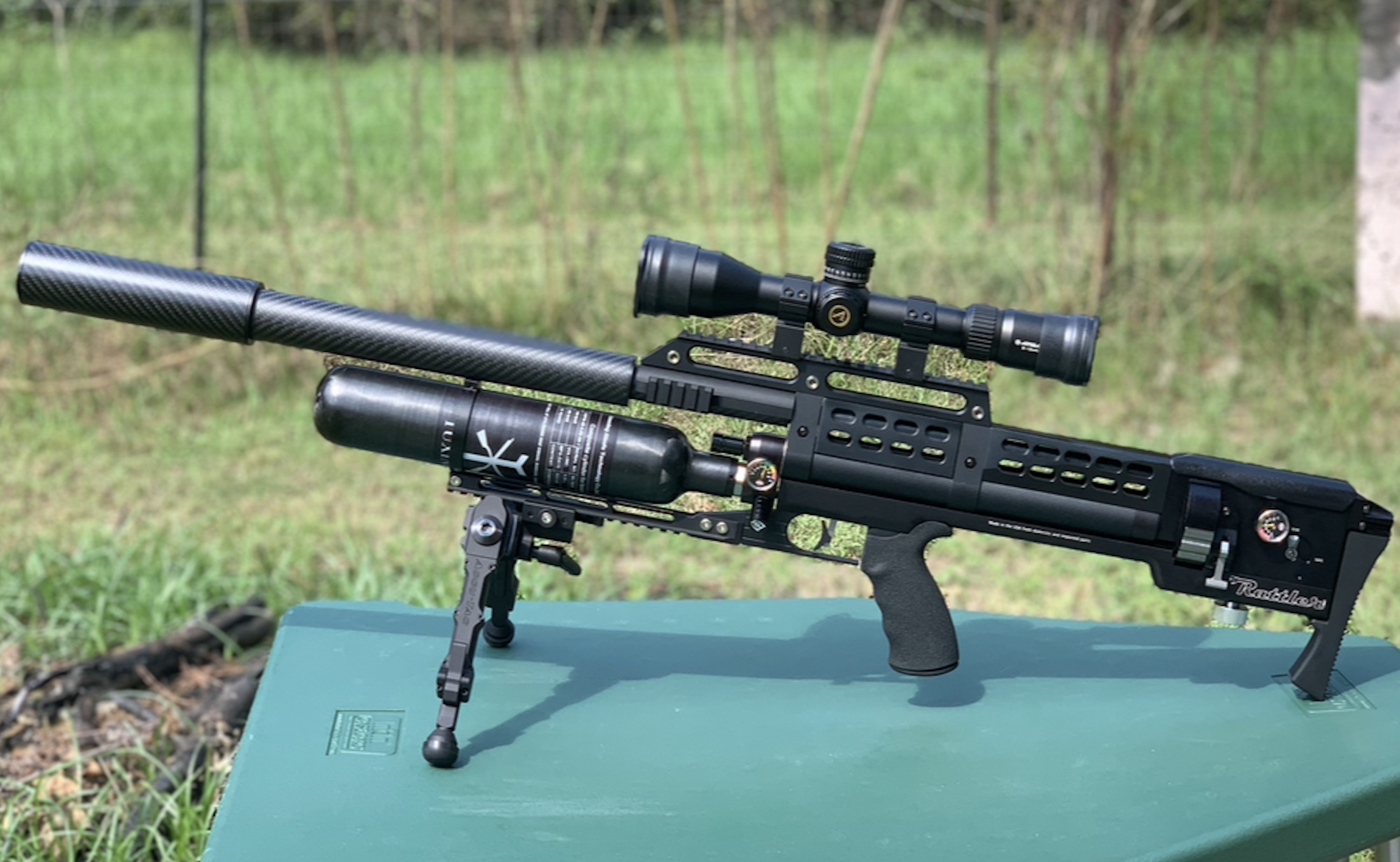

Today was my second session working with this rifle. Right now I have it paired with an Athlon Helos Gen2 2-12x42mm FFP IR scope. Within 50 yards this scope seems to be ok for me. As much as many of you all like it, I'm still trying to like it. Anyhow, my first time out I mounted this scope on my Rattler with the turret settings from when I removed it from my Benjamin Bulldog M357 with a 50 yard zero. When I shot the Rattler using this scope it was pretty close to dead on without touching a thing. I initially shot it from the Caldwell Turret Rest seen below.

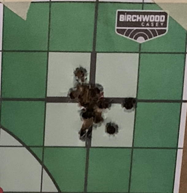

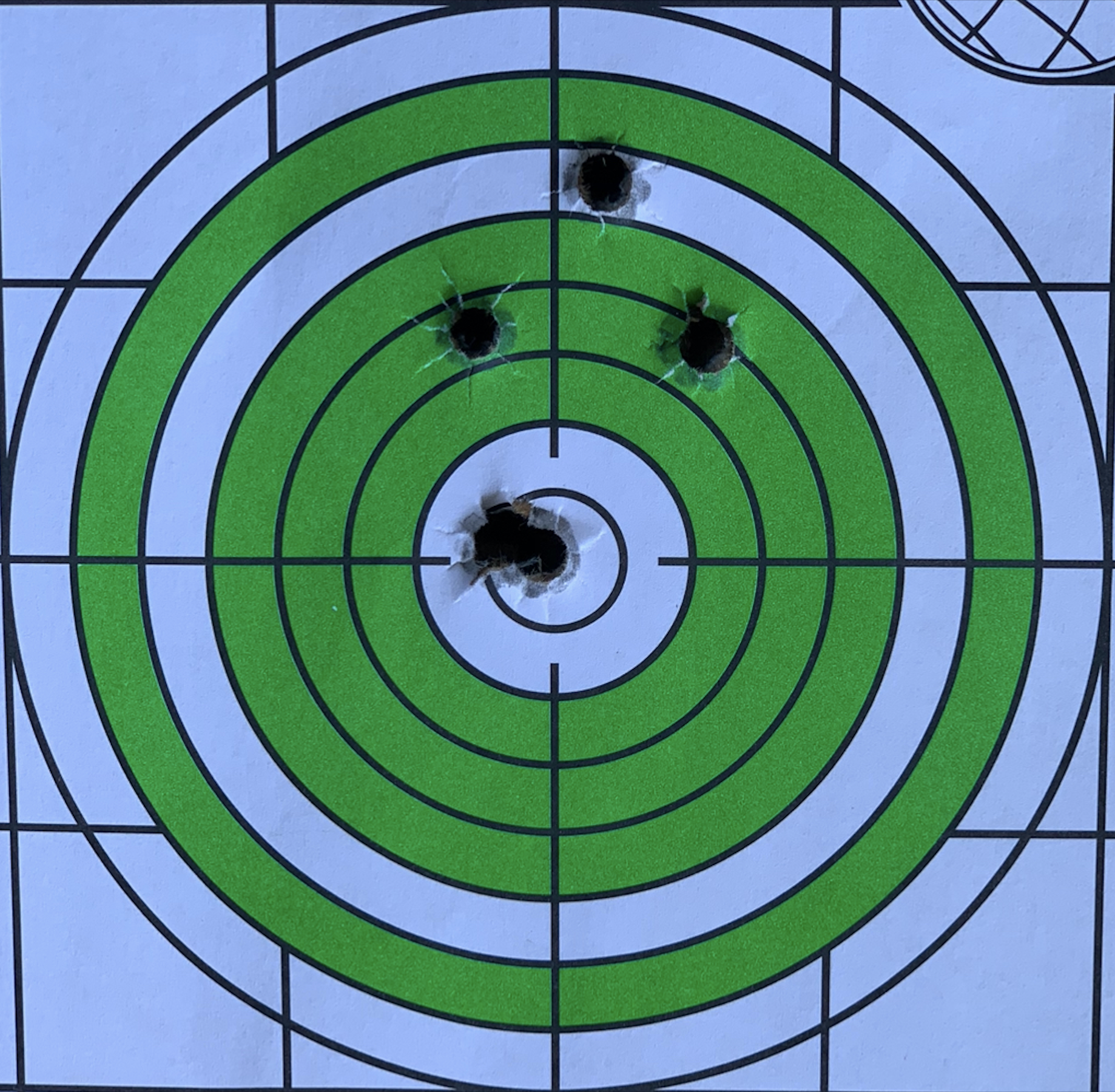

Here's my first target. The first two shots are touching the edge of the bullseye and touching each other.
Then removed it from the mount and affixed an Accutac bipod (that was pretty comfortable to shoot with without a rear rest). I felt pretty good abut my first time shooting from 50 yards.
The first target started out great with the 1st two shots hitting the bullseye, but my chronogragh was not reading the shots. As a result I set the gun down, fiddled with the chrony, and re-situated myself behind the Rattler. The 3-shot that grouped above the bullseye were the next three shots. I was shooting 140 grain slugs that I swaged.

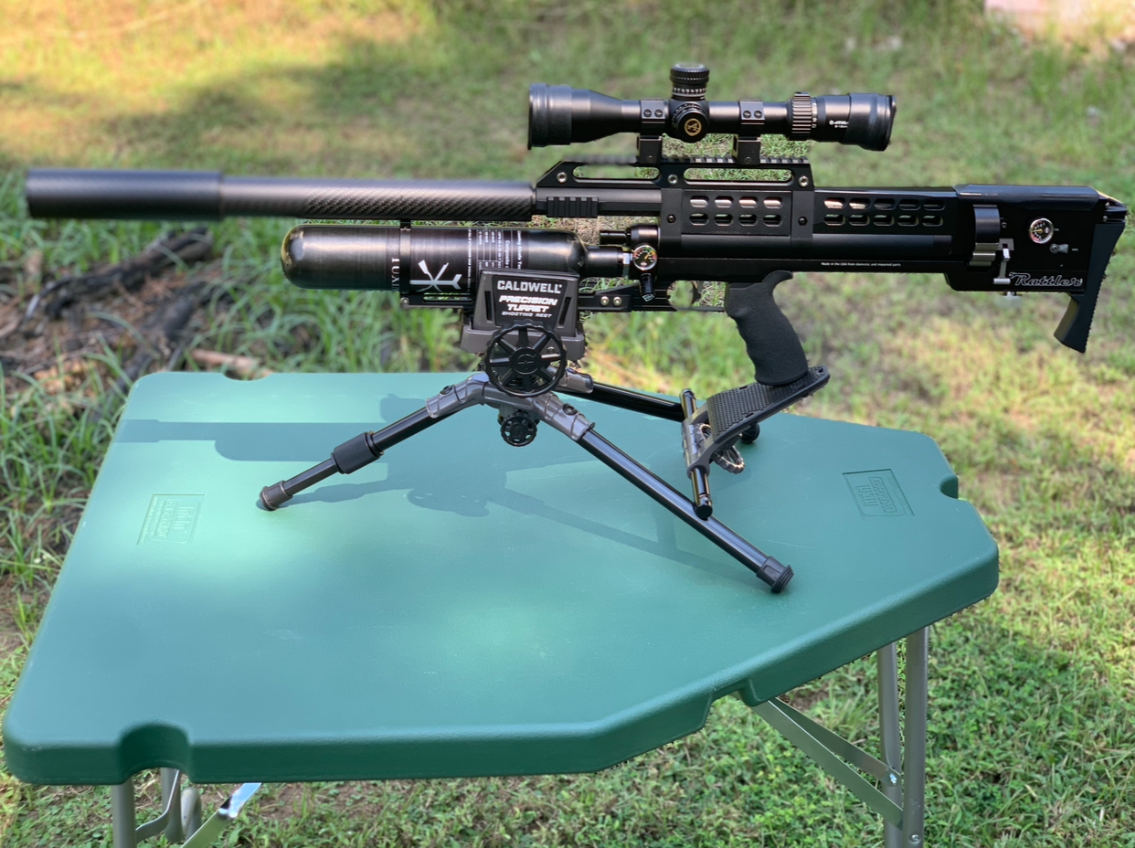

Today I was able to get out and shoot from 25 and 35 yards and there's a noticeable difference in holdunders. I'll post photos of today's targets in a bit.
My makeshift big-bore backstop and target for the day.
I decided to start at 25 yards. These were 140 grain slugs. 14 shots were taken while seated an resting the fore end of the reservoir on the yoke of a Primos Trigger Stick bipod.
