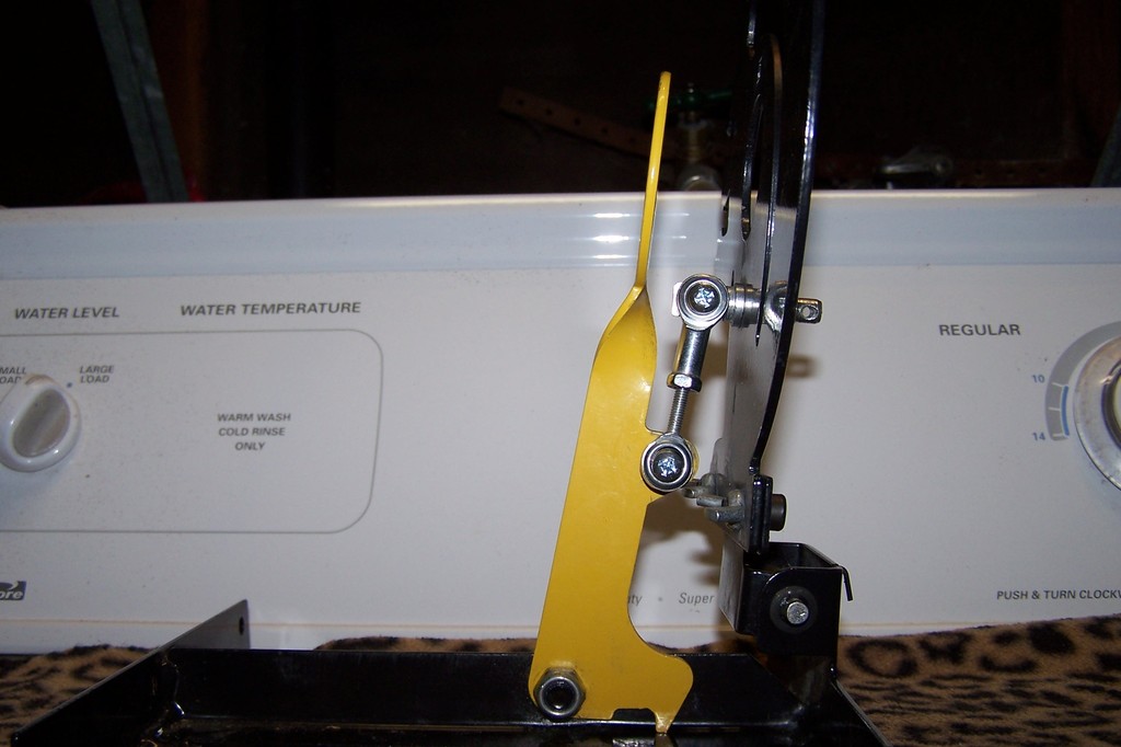

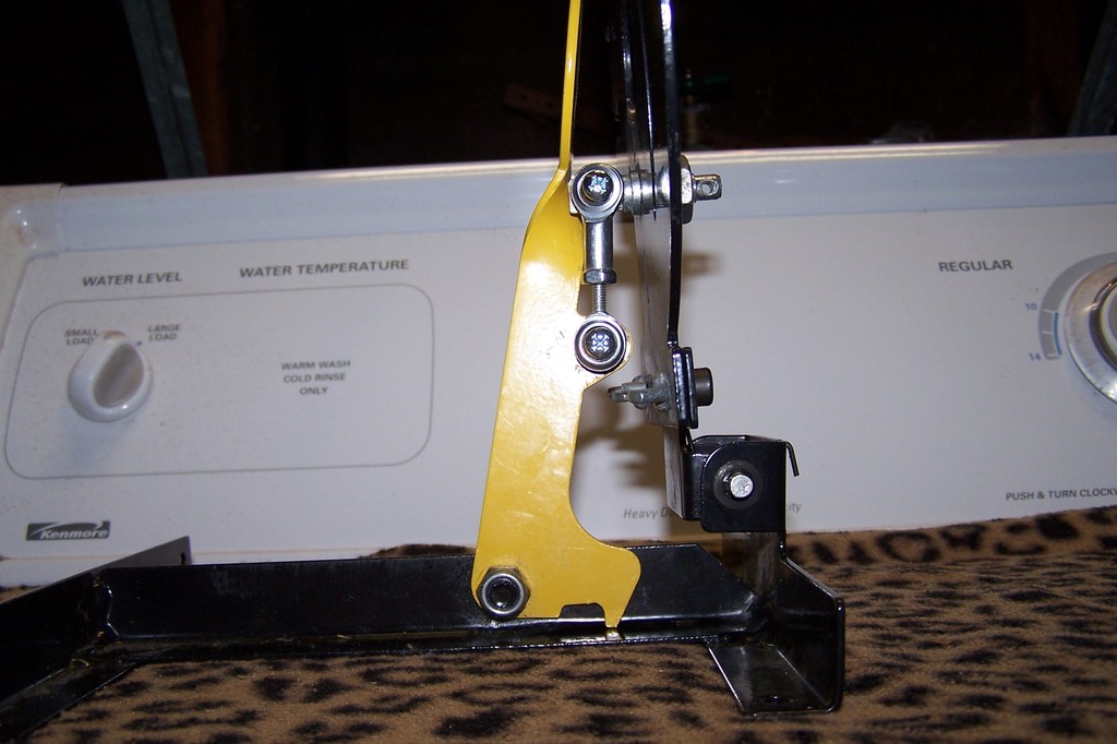

That's the minimum that should be done. I also replaced all linkages with adjustable items. The linkage has spherical bearings on each end, and they can be set to various lengths to change the overcenter threshold.
Here is some early tests of the linkage. I have since replaced the wing nuts as well.
Normal setting:
Very low FPE setting:
