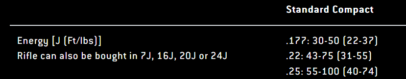

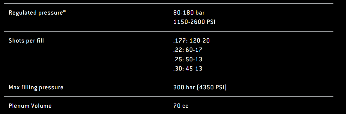

Stock OEM Regulator should be able to handle 150 bar all day. You can't compare a 600mm gun or 700mm gun tune to a 500mm gun that needs more pressure to compensate. Below is a screenshot from RTI website p2 compact tech data. They don't come with 70cc and ability to do 180bar to shoot only 25.4's...heck this gun should be able to push 60-70 fpe easily all day...
