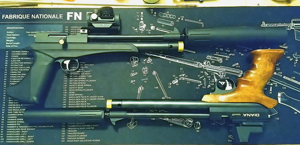

The bandit is good. But that wood handle is too big for most hands. I cut mine down, and threw a regulator in there. Trigger is 8oz. on mine with 1.5mm travel. LOTS of time tinkering with it.
If you want something for pest that will be great right out the box, I'd recommend the pp700 as well. BUT if you'd prefer having the magazine, You can order the pp800 (same as a bandit) with a detacheable stock like the CP2's. From the airgun-archery fun website. (I have one in 25 caliber) The grip on the pp700 will be more comfortable than the bandit or pp800 as it is. But it is a single shot. It does have as regulator built into it, however, and a bit more air capacity. So you can get good power, and a good shot count. You can add a regulator to a bandit, but it will cut down power somewhat. \Biggest issue is it will take up significant volume in the air cylinder.
Mine is tuned to 650 fps in .177 with a 50 shot count. Still enough to take squirrel. But factor in the gun's original price, and the price of the huma reg, plus all the time I spend modifying the regulator setup to reduce it's size. And making the grip fit.... It adds up. But some people enjoy doing that kind of stuff. Or just having the magazine may make it worth it.
Of course you don't have to have a regulator. But expect something like a tight group of maybe 20 shots in 22 caliber without a regulator. I believe the pp700 gets something like 30 in 22. (with power turned up)
Here's an older photo of mine.
