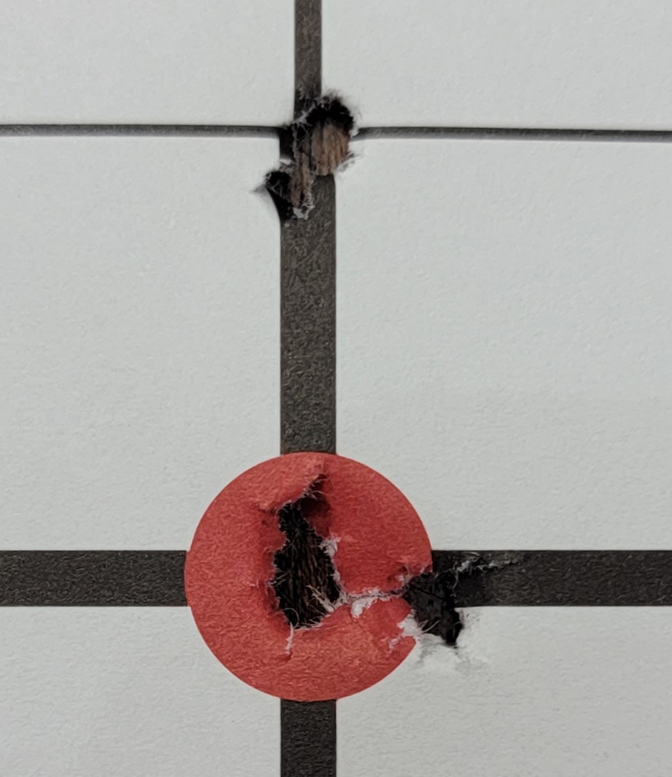

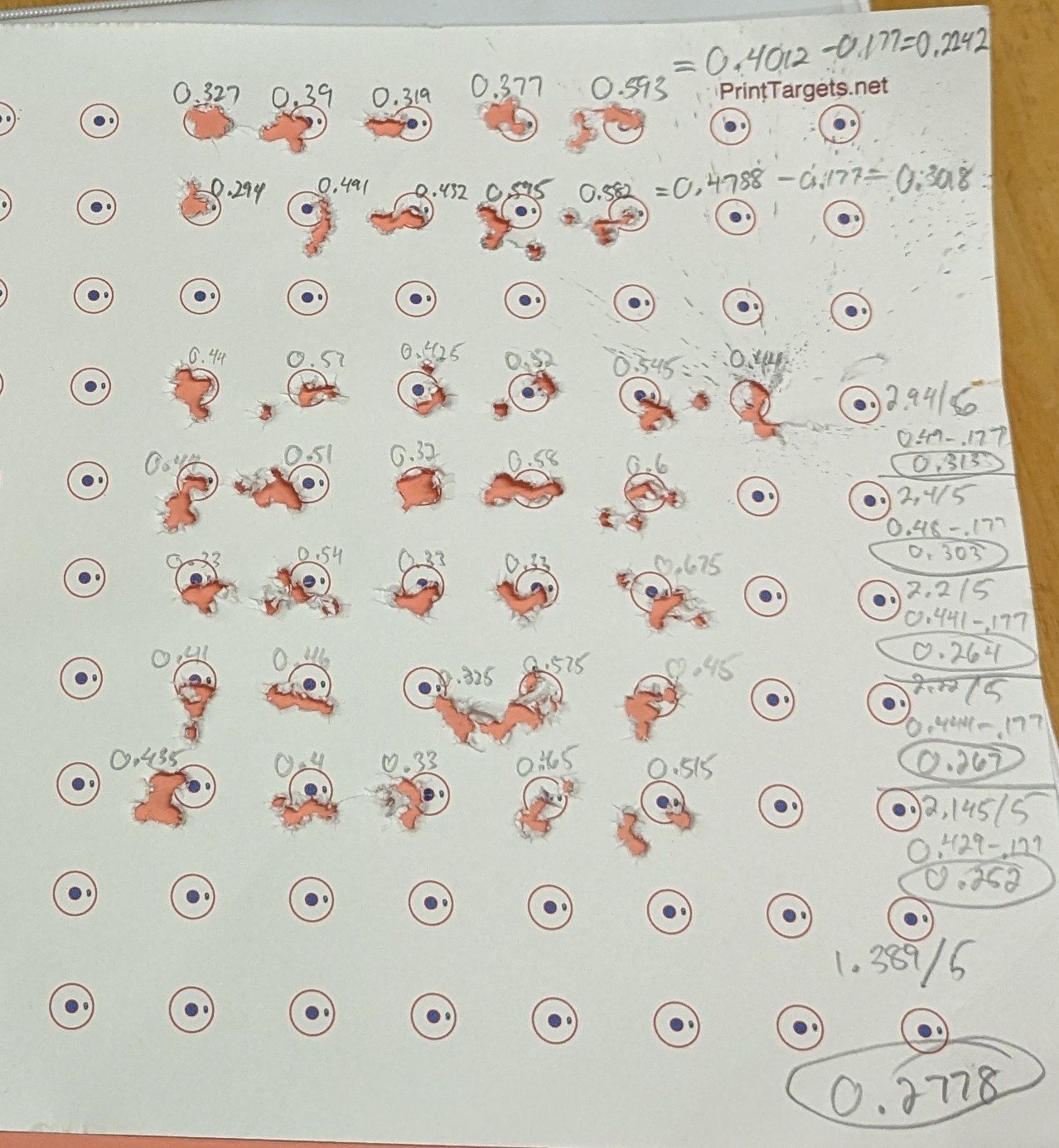

Vet .177 this time. 30 yards again, 25 shots in a row for all 3 attempts. 10.34s at 915fps. Surprised how poorly it did. I shot this gun informally, after a recent ft match, and only missed 3 shots in the whole course. Overall I've been happy with this barrel when shooting it from ft position. So we're really splitting hairs here, at least for a field target intended gun. But when being THIS critical, certainly some shots hitting away from the crosshairs, and not wind nor shooter induced.

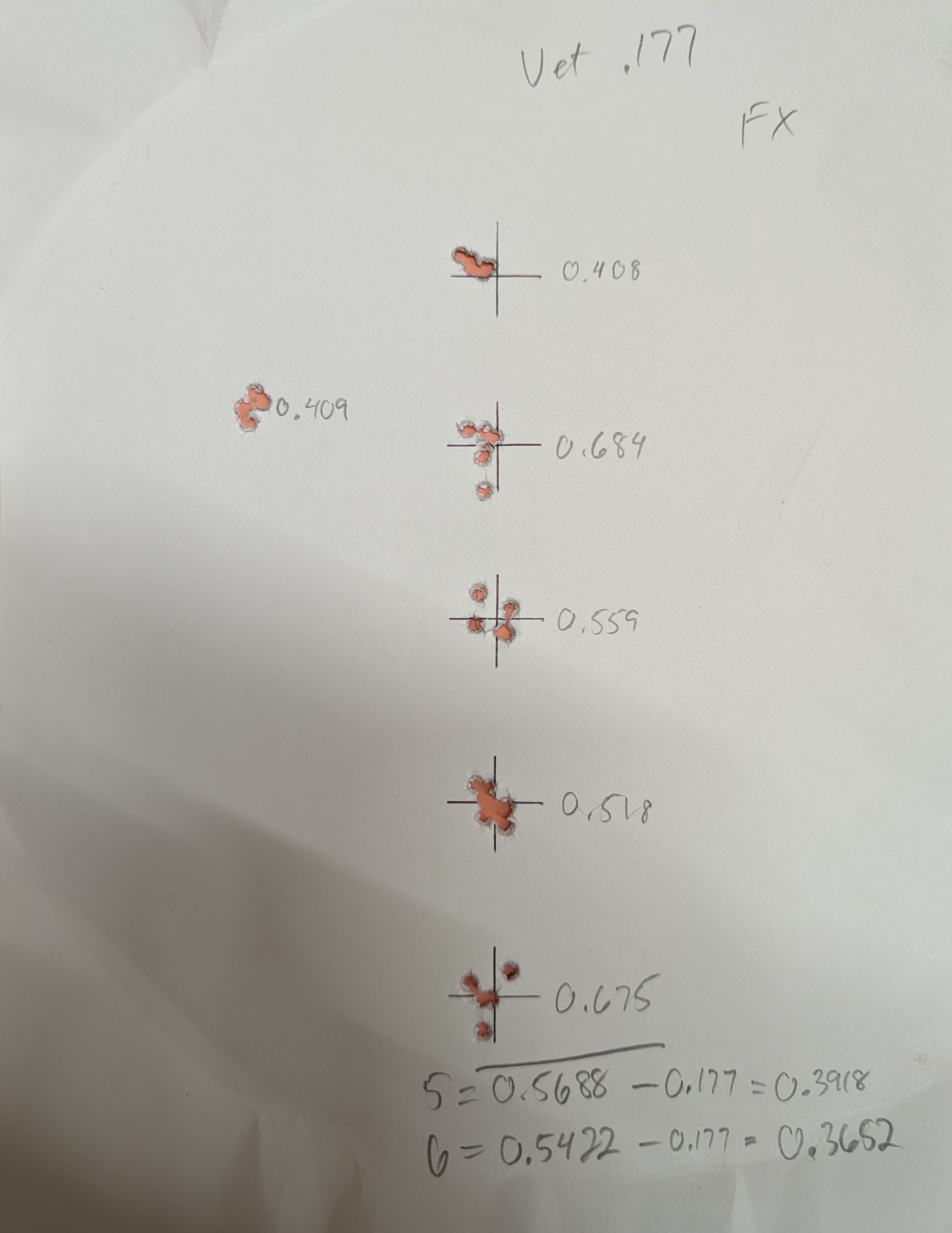

This first one was with an FX labeled tin (10.34s), I didnt like the drawn in crosshair approach, didn't feel like I could get to the same aim point after the lines were shot once or twice. So, 5x5 shot average group was 0.5688" - 0.177 = 0.3918
Switched targets and also moved to a tin of JSB branded 10.34s. shot 50 consecutive shots here.

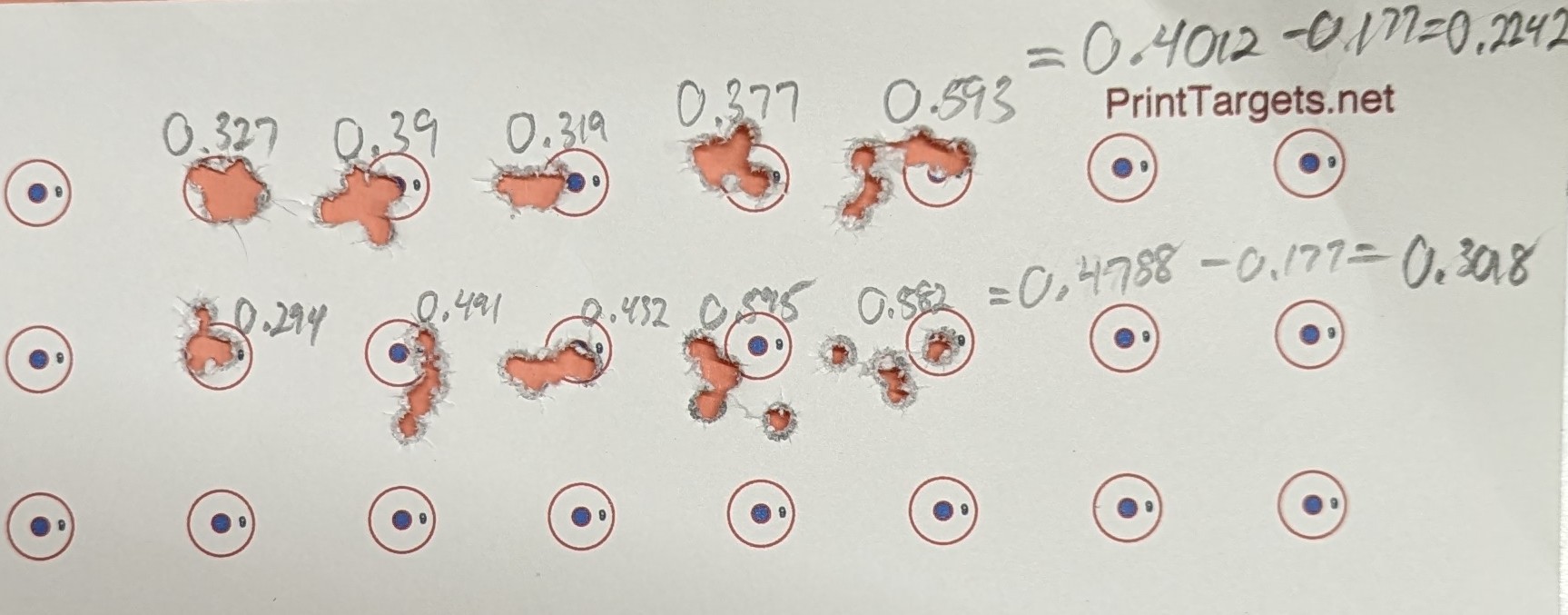

First 5x5 averages 0.4012 - 0.177 = 0.2242
The second 5x5 averages 0.4788 - 0.177 = 0.3018
As a data point, this .177 gun that averages between 0.4 and 0.57 inch 5 inch groups @ 30 is good for 93-94% knockdown rate in an ft match setting. And I think 2 or my 3 misses in that match were offhand, so this level of accuracy is representative of probably more like a 99-100% knockdown capable gun, when the operator doesn't do stupid stuff.

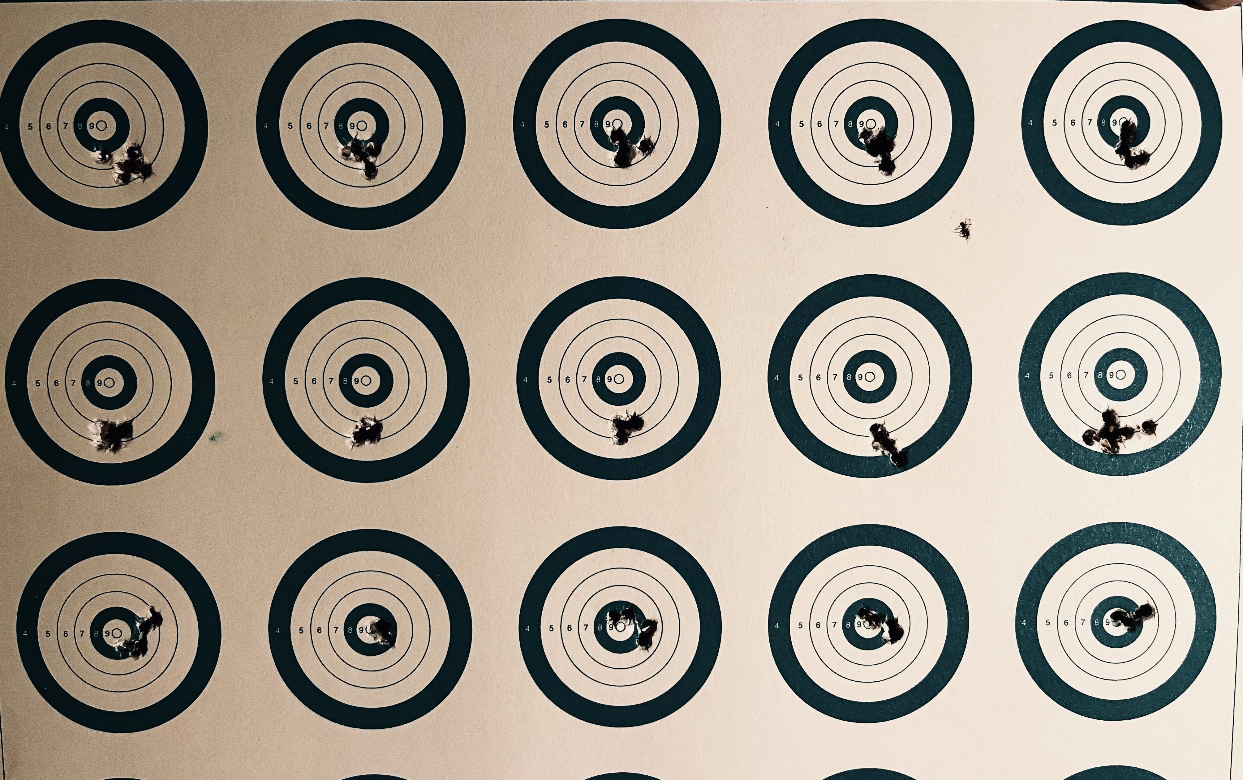

Wasn’t really satisfied with my results the other day so i went out today and shot these groups with the ghost after cleaning the barrel. I’ve come to the conclusion that especially with 177 the only way to prove the potential accuracy is with the gun locked down and indoors. At 30 yds you really wouldn’t think a very slight breeze would move a pellet much but as you can see when it was dead calm i shot my best groups smallest of which is 1/8”. These were shot using the same hold and I regardless of wind.
Forgot to mention top row is 13 shot at 950 with mod middle 805 with mod and bottom is 805 without mod

The 13 was the pellet 13 mrd forgot mrd.
Reactions: Arzrover
0.282 for row 1 avg
0.276 for row 2 avg
0.291 for row 3 avg
Not much difference after all.
Noticeably better than the first posting.
I truly believe that the gun is capable of those tiny holes constantly as i noted when the breeze picked up at all it was taking the pellets the tinyest groups my wind flag on barrel was not moving at all
I know it's been a few days but just shot this with the .177 USFT.
Top two rows are from the previous posting, bottom five rows of groups are the USFT. Top row of those five was from it benched, bottom four of the 5 were from bumbag and shooting harness. I've shot the USFT very little from a bench and didn't like it this time easier. It's simply a gun to shoot from ft position. And that shows, as that group was my largest from the gun. Benched group was actually 6 groups of five.
Took a bit of shooting to get back in the hang of things with this gun.
Best 5shot average group size (subtracting .177) was 0.252.
The average of all 26, 5 shot groups from the USFT was 0.2778.
