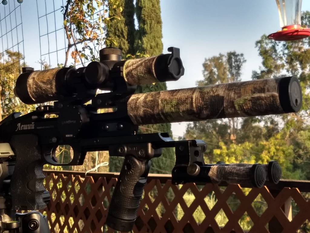

Blackpaw you ask a very timely question which may cause many to pause while they consider their answer. As for myself having sampled various platforms of air weapons on a journey to that longed for nirvana. I am happy to report my addiction is at present somewhat level and now down to a small manageable herd. Each filling a unique job requirement to remain within said herd. The bottom line pros and cons for a Leshiy 1 really depend upon just what a person's required duties are. Knowing not only the Leshiy operating limits, but more importantly that of it's marksman.
It's not really a football field long distance hot shooter as for that single shot, it just requires it's marksman to be patient and accurate. For me being over six feet with ham hock hands the original boxed Leshiy was quite a challenge to hit that ole barn door. Larger grips and a 350 mm barrel made all the accurate department difference. Also adding a silent thunder moderator into the Leshiy tube makes it backyard nosey neighbor friendly, if that's a concern. https://www.silentthunderordnance.com/air/leshiy
Mine is a great simple backpacking unit: .25 Leshiy + extra .177 and .22 barrels with pellets + 1 barrel swap and 1 hammer spring Allen wrench + small air tank + water and sandwich. Bottom line for me it's very simple & dependable like an ole K bar and if need be a damn good club, so YES.

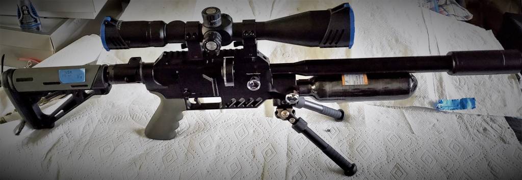

i have always intended to have only one pcp air rifle, and it took over 5 years to decide on which one...which in some ways was decided by the simple ability to "add to cart" and not be forced to pre-order and wait. i hate that.
i had lots of other rifles loaded in my cart, but none that were as easy to swap calibers or barrel length, packed down so small, or was as unique as what i finally ended up with.
as luck would have it, it was also more expensive than the guns that were emptied from my cart, probably not as quiet, and now that i have joined agn, it will be harder to stick to that "one gun" idea.

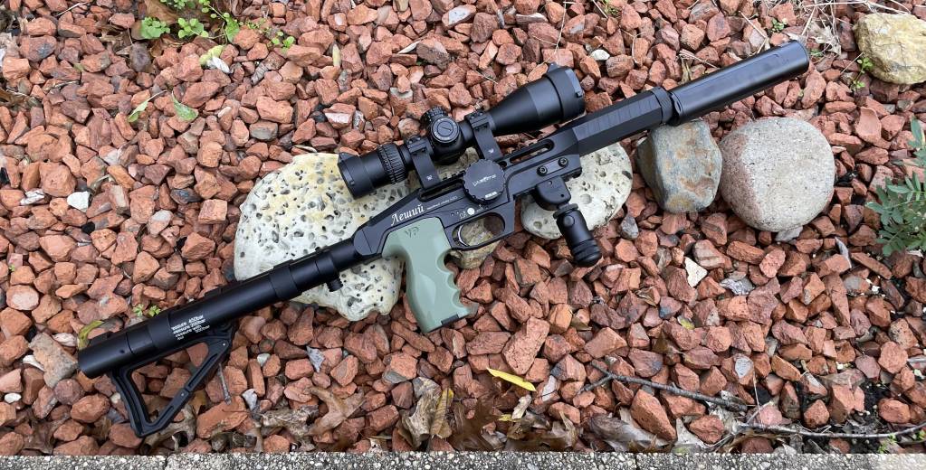

I have the Classic set up in .22 (250mm) that I’ve tuned around 750fps and added a Rustem double air tube and I’m getting a ton of shots out of it. I’m a fan of the single shot, it’s made me a better and more thoughtful hunter. I have big hands so I swapped out the grip for a larger one and added a nice monopod. I also mounted a Huma pellet dispenser which helps me reload in just a few seconds. I’ve also got the long barrel in .22 and both in .25, and a .30 barrel. I’ve also added an adapter for donnyfl suppressors which make it super quiet. This thing is a tank and it’s my one gun. But all I do is pesting within 50yds and woods walking. Also a great gun for learning about tuning.
