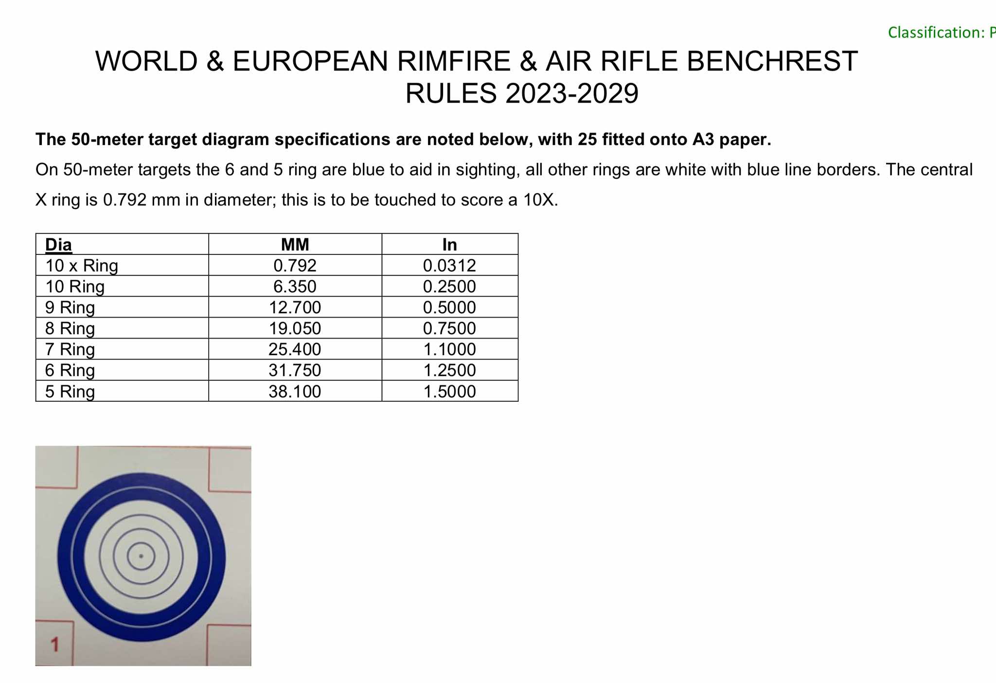

The OP was comparing N50 to WRABF unlimited....but used the pellet class scoring for N50 as his basis.

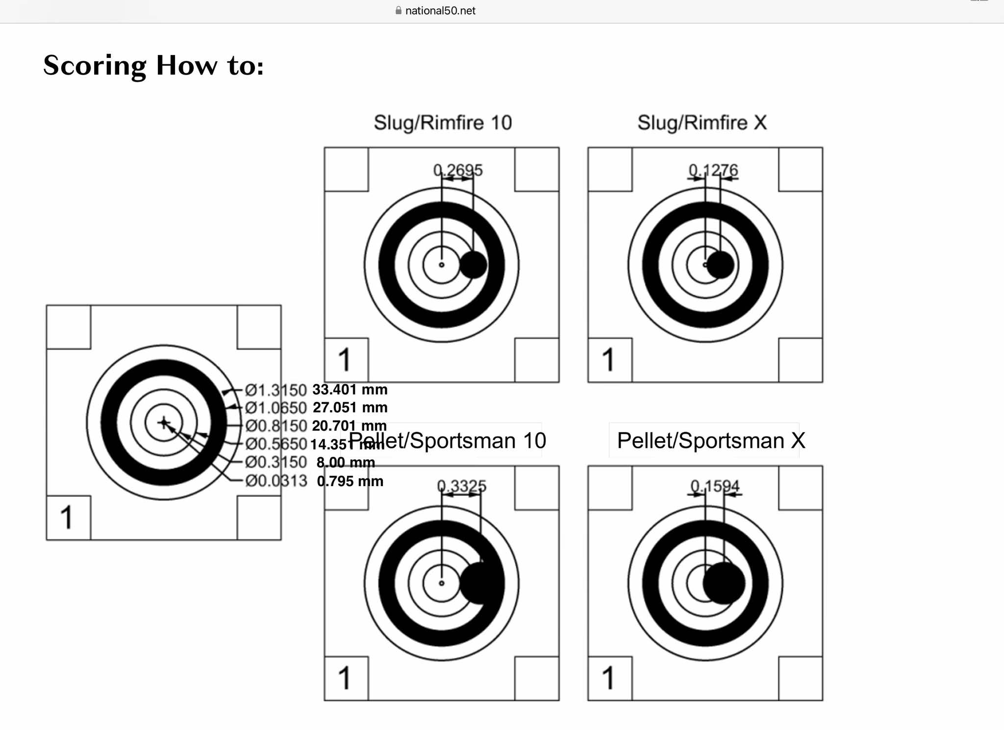

The N50 pro class is scored with the traditional.224 plug just like WRABF.

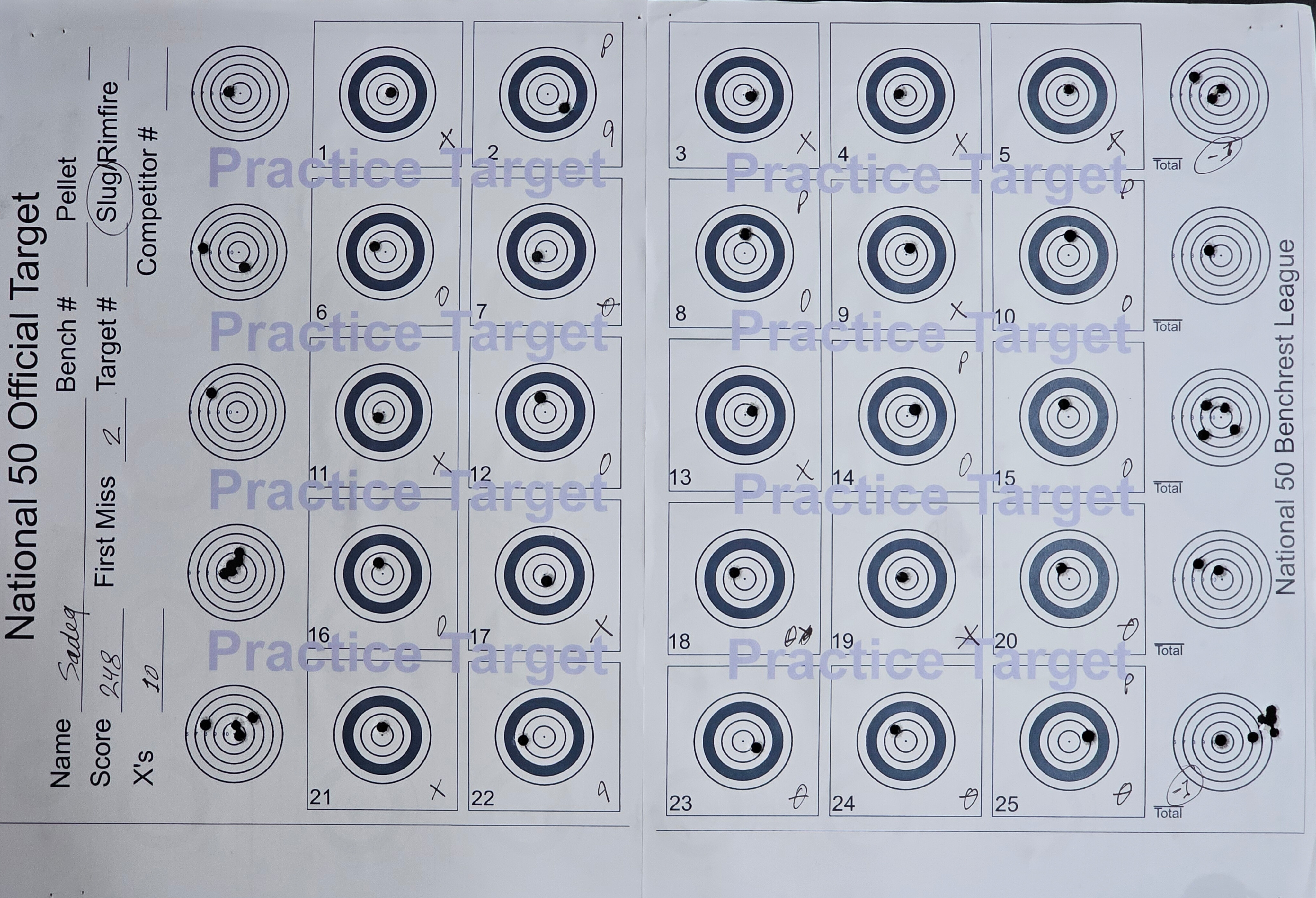

I shot this card with RTI Prophet at 50m. Its my first experience with N50 target.
Sadeq - Great first N50 card. Btw - shoot as many N50 cards as you want regardless of the two disciplines. It’s not as easy as it’s being represented in this thread. This is especially true if you use pellets vs. slugs, which have a big advantage vs. pellets.
Nice shooting!

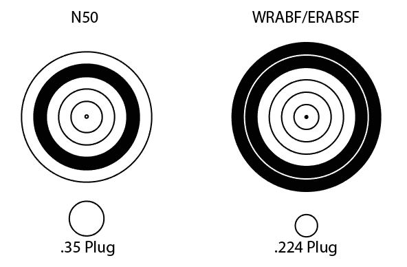

I don’t shoot slugs and it is common sense that N50 at 50 yards is easier because they allow pellet calibers up to .30 cal and scored with a .35 scoring plug while WRABF BR50 only uses .22 cal, scored with a .224 scoring plug, shot at a distance of 50 meters and the target rings are smaller.
