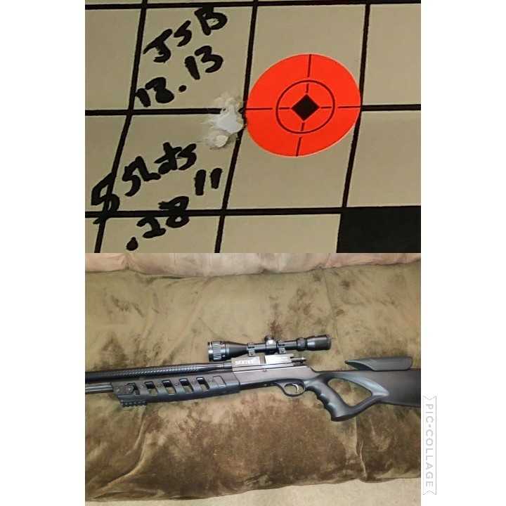

4. Accuracy is very good with 90 percent of the pellets I've tried. Crosman Premier 14.3,
JSB 18.13, and even the H&N Terminator 16.83 shoot very well. Best group at 50 yards with the JSB 18.13gr. Produced a group measuring .28" ctc.
*See attached photos*
