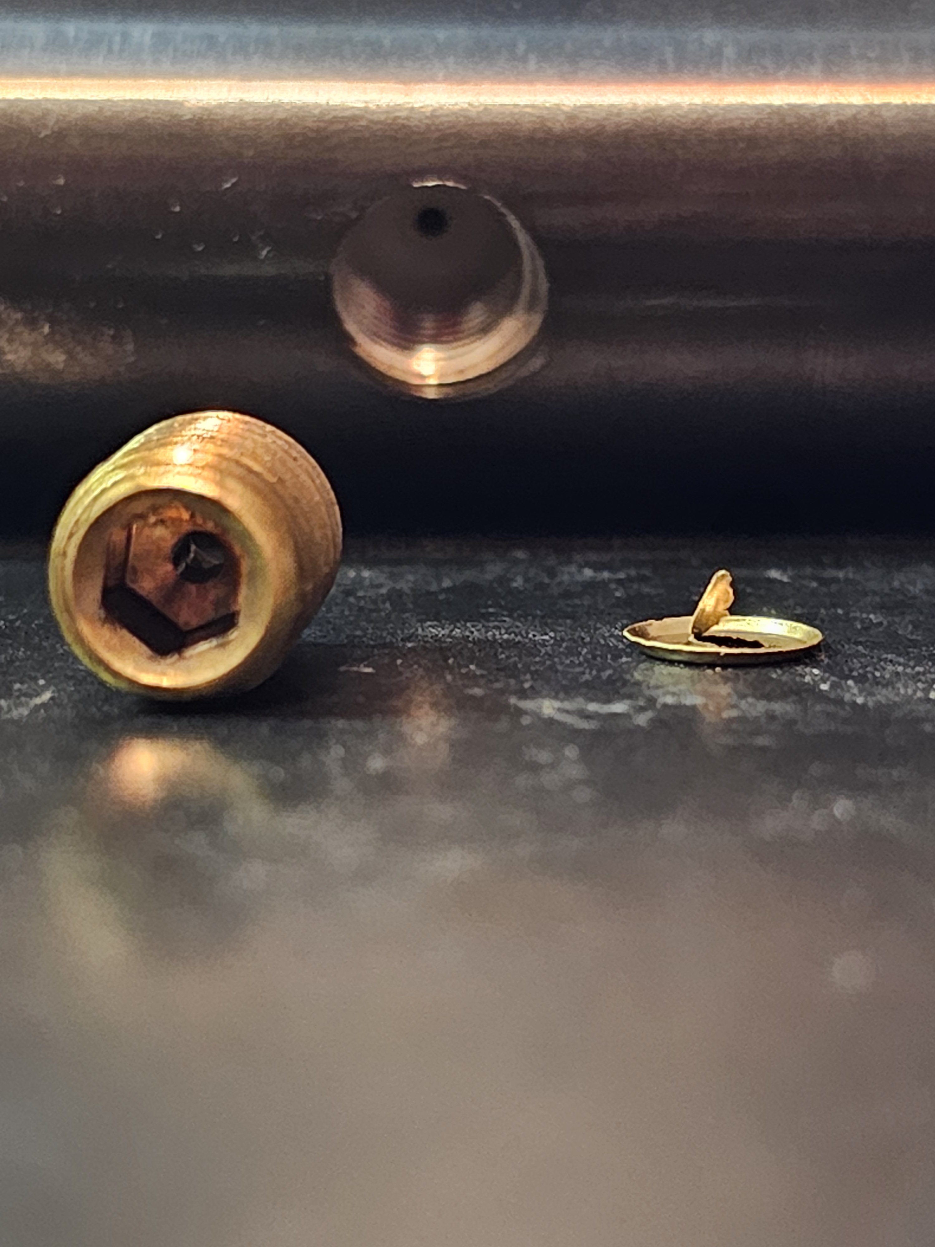

On the under side of the compression tube is a threaded set screw with a hole drilled down the center. Upon removing this set screw i see what I think is in fact a burst disc which has ruptured. Though I cannot be sure because I've never broken down a PCP air rifle.
It appears goldish in color, and appears to have been press fit into the hole by the aforementioned set screw. In addition this disc appears to have a hole caused by a tear, rather than an intentional means such as a drill, as it still has the center attached by a scab.
I tried to post pics, but for some reason the site won't let me citing some security issue, whatever that means. (Nevermind. Got the pic to take!) Anyhow, given my crude description; do you think that perhaps this may afterall be a burst disc issue, and perhaps the item I came across might be said burst disc? TIA...

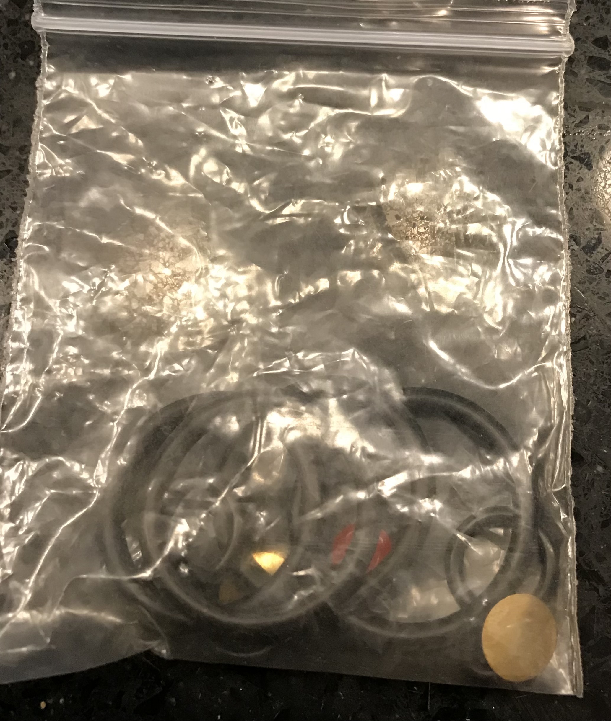

Should be a bag of o-rings with 2 burst disks in it.
I'm gonna have to dig through my accessories stash. If it came with the gun; I still have it.
Somewhere...
Found it! Got her back together, and am dialing her back in. I noticed something interesting while reassembling it though...

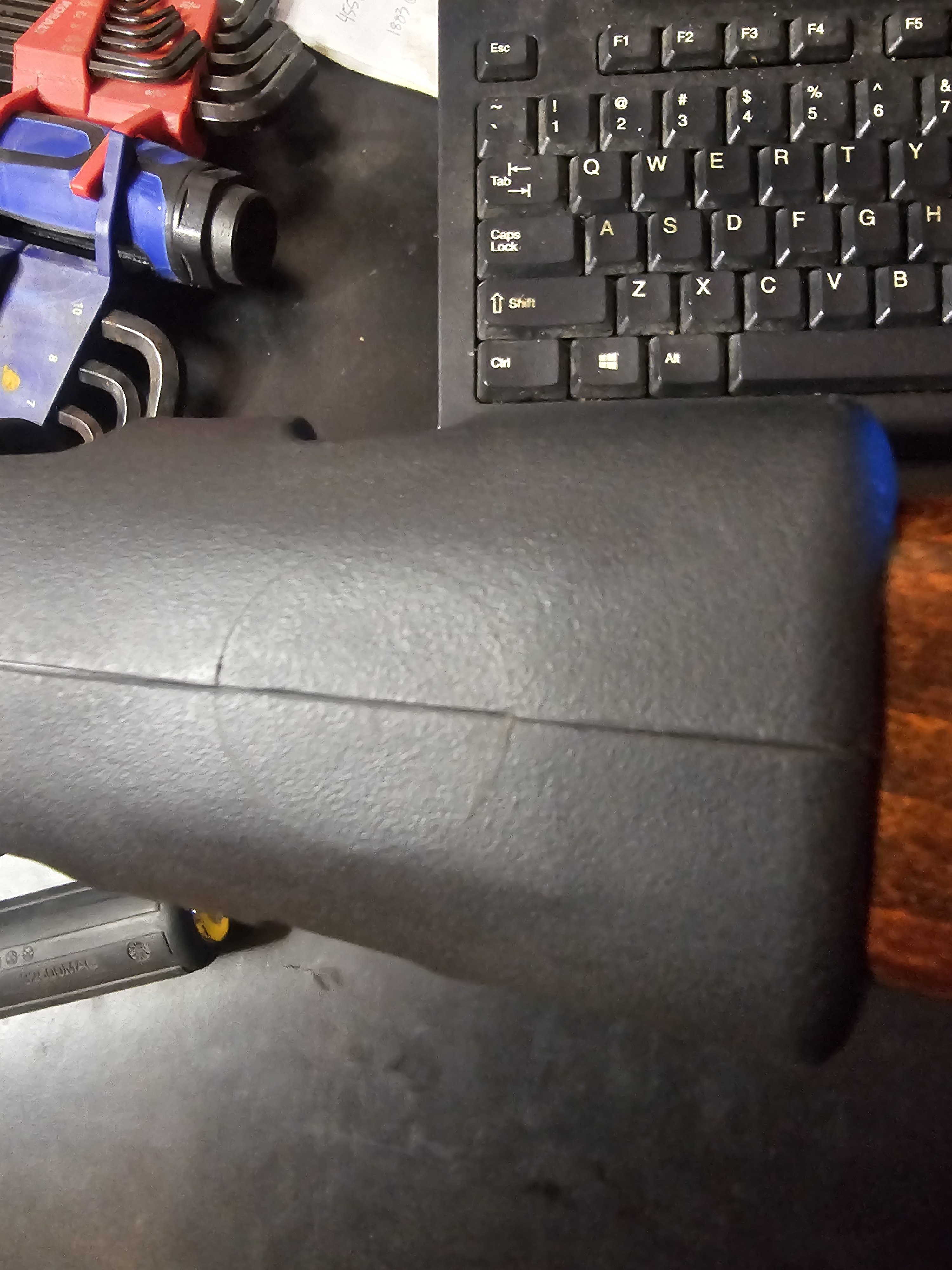

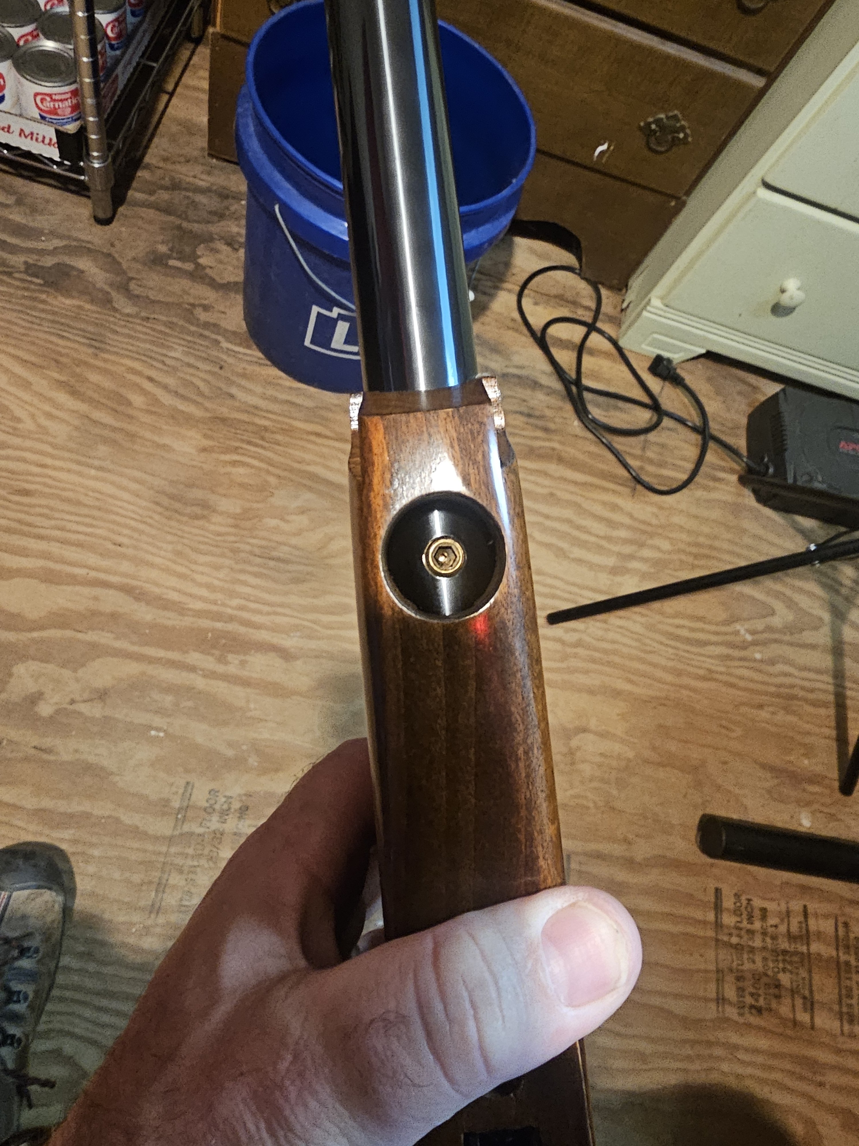

The port that hides the burst disc, and burst disc plug; correlates with a hole made in the stock. This hole is then covered by the forearm assembly. However the forearm assembly even has markings on it tha suggest a hole mighta/coulda been present prior to a mold change?
Can't tell if this is the remnants of a previous variant. Maybe a different fill port location, or possibly a gauge?
It would be nice if I could have my pressure gaugue there, instead of on the end of the tube. Staring at the muzzle while filling has never set right with me...
Glad that you got it back together!
“It would be nice if I could have my pressure gaugue there, instead of on the end of the tube. Staring at the muzzle while filling has never set right with me...”
I agree with this, however, this design is the simplest to maintain tube volume. I have a rectangular inspection mirror that I set at 45 degrees on a flat surface at my fill station to watch the gauge.
