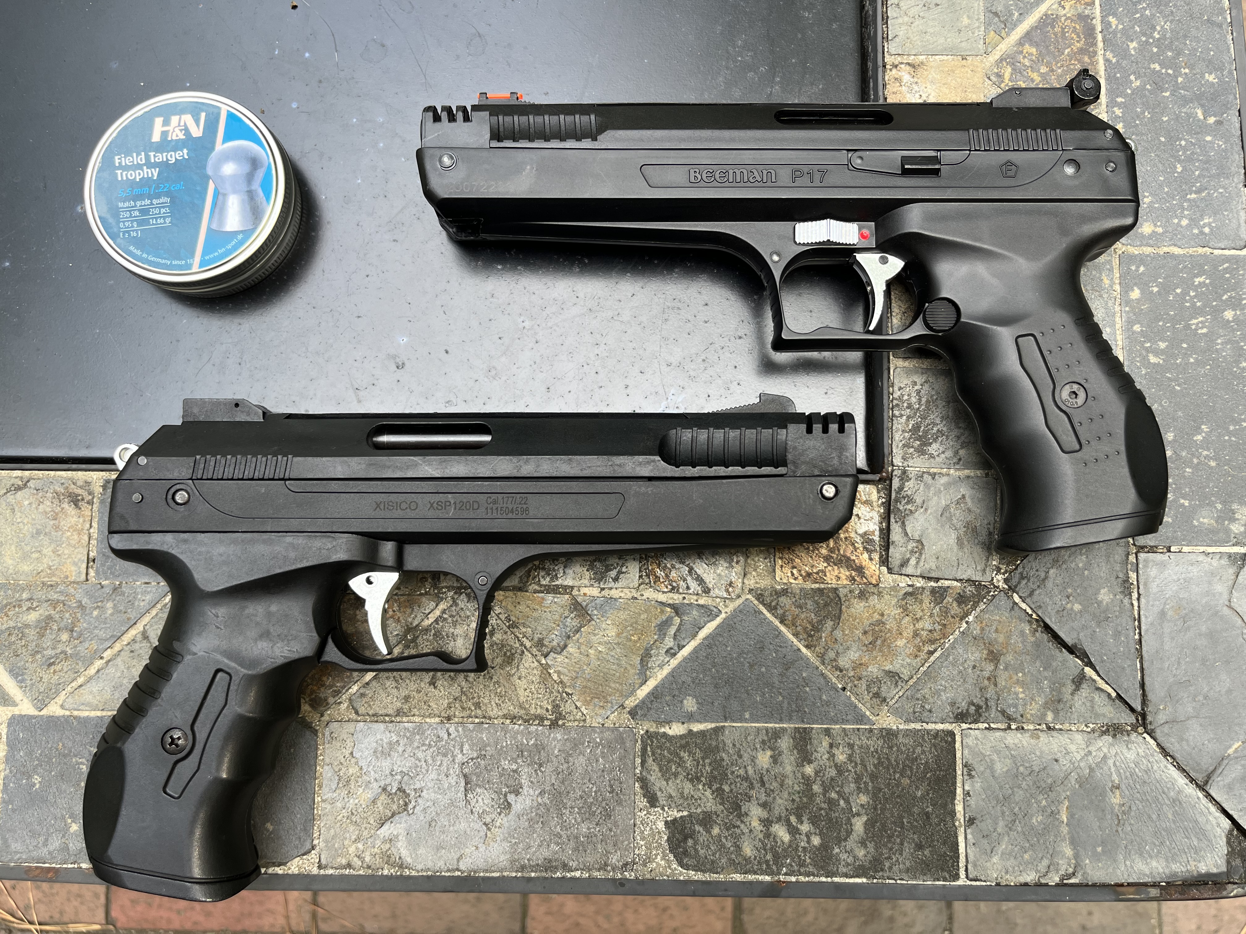

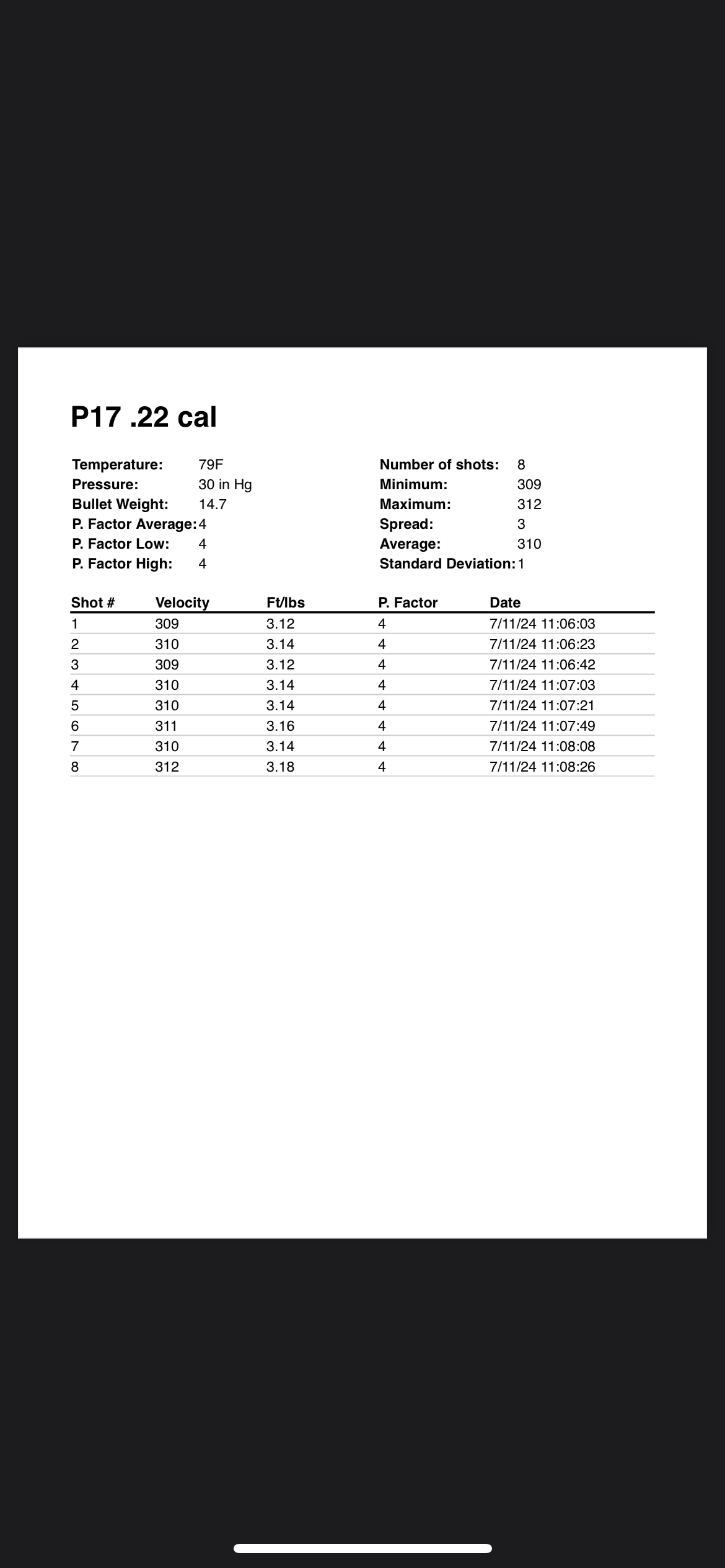

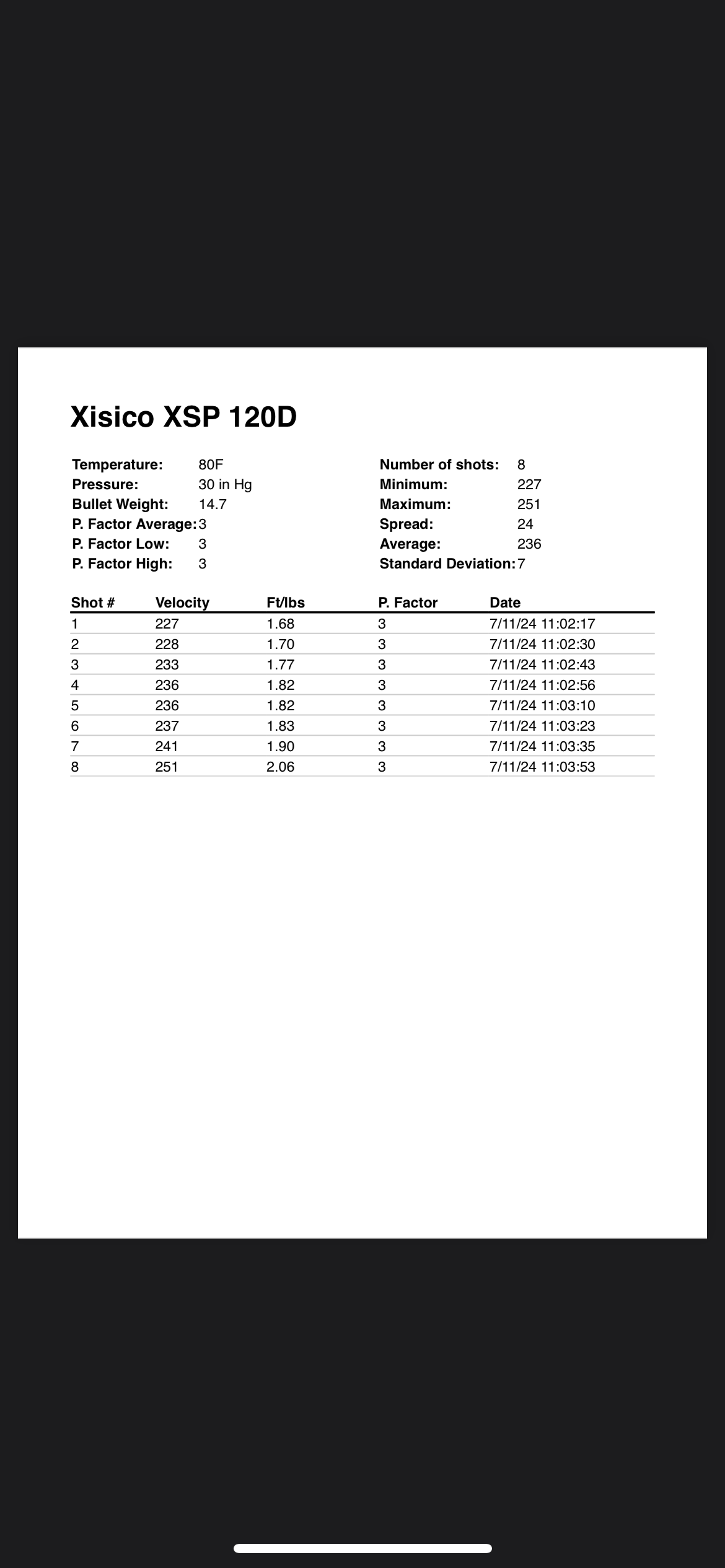

I'm looking for a new piston seal for my Xisico XPS 120D but don't know where to start. I ran it over the chrony yesterday along with my P17, both are .22 cal., but the P17 was a lot more powerful. The trigger in the 120D is as good as the one on my HW40 so I like to shoot that one more. It is very easy to pump so I feel like a new piston seal would bring it up to the level of the P17. Anyone know where to get one? Or is this all I'm going to be able to get out of it. Here are the chrony numbers.

Nope, the P17 is a standard o-ring but this one is not. I could put one on that fits the diameter of the piston and use a drill and some sandpaper to take to the OD but I would rather find one that fits from the start.
I used the same O rings in mine as the P17, works fine. I have of each. The seal doesn't need to be flat, it only needs to seal the compression tube.
