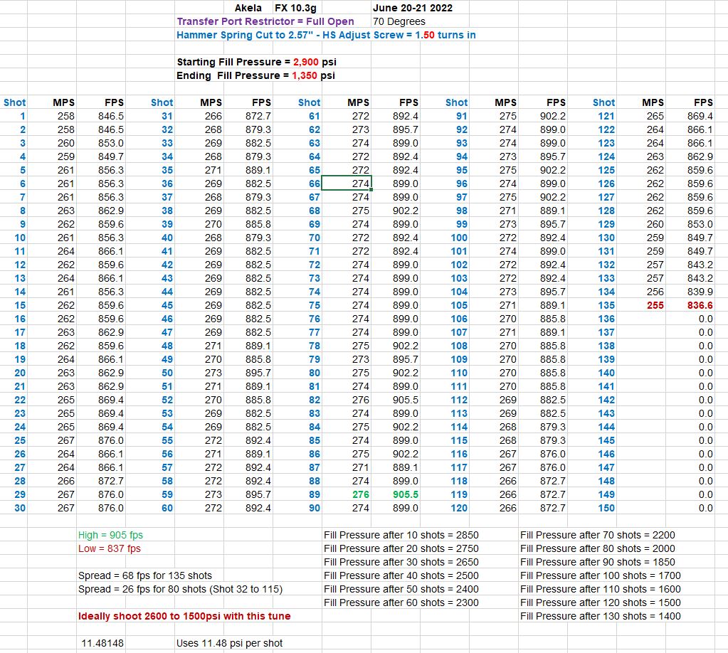

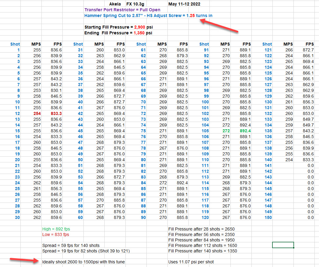

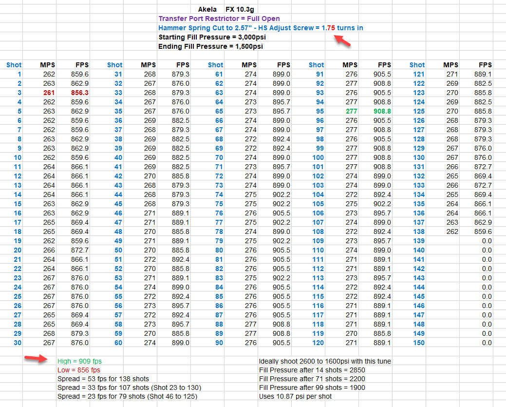

Akela .177

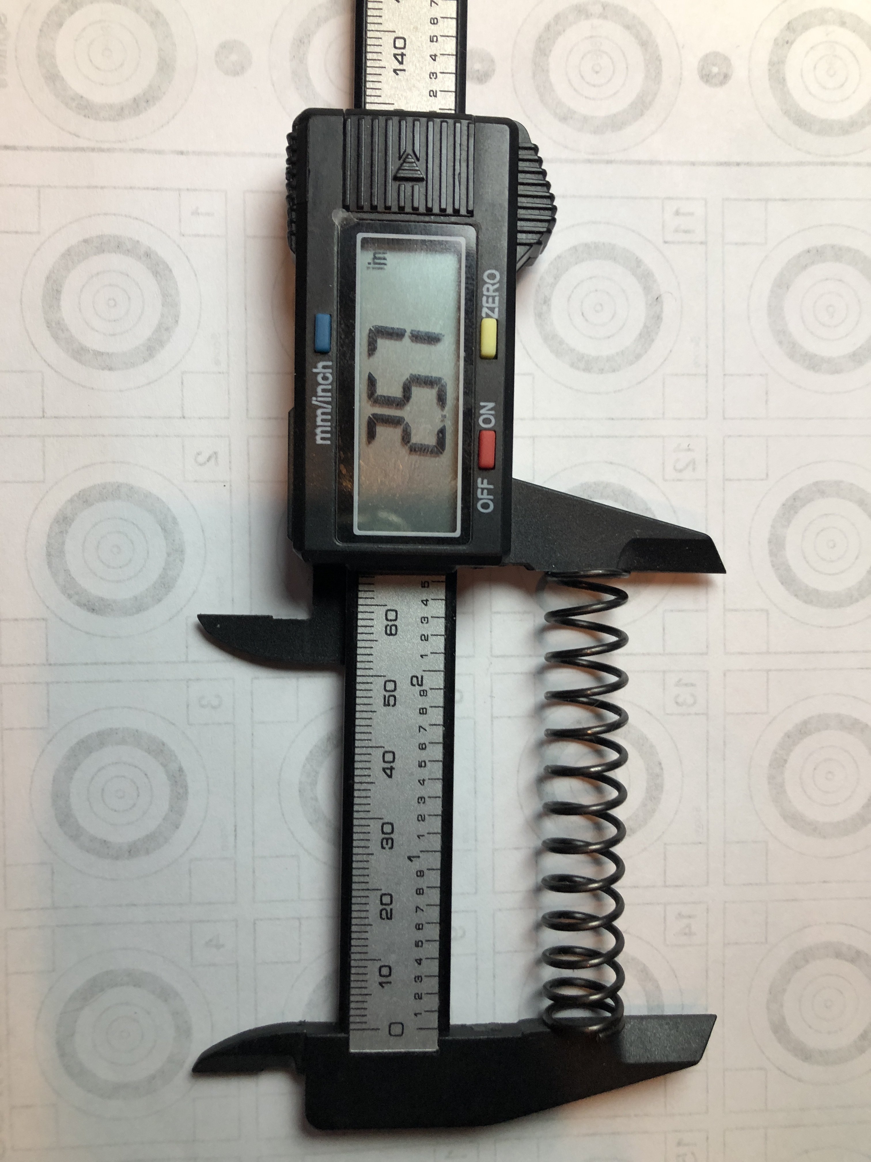

Basically stock - hammer polished, trigger polished. Stock 3.5” hammer spring cut to 2.57”.
Shot strings attached - slight adjustment to hammer spring preload between the strings.
-Ed

Thank you Ed!
Damn that's a ton of shots! Have you thought about regulating it to close up the spread?
I saw sub12airgunners video on adding a regulator and bumping the shot from 50 useable shots to 240. Also his spread was only 15fps spread across the 240 shots.
My unregulated shot strings have about a 20fps spread across 80 shots in the sweet spot. This is at 18.5 ft/lbs.
Sub12 is a great tuner, but those shot counts are for a sub 12 ft/lb (UK legal) rifle. That’s shooting a 10.3g pellet at 720fps.
There are certain advantages to unregulated rifles - among them being 1st shot consistently and simple to maintain.
This is good accuracy at 30 yards. You won’t notice PoI changes with a 20fps spread when shooting 870-890fps at 30-35 yards.

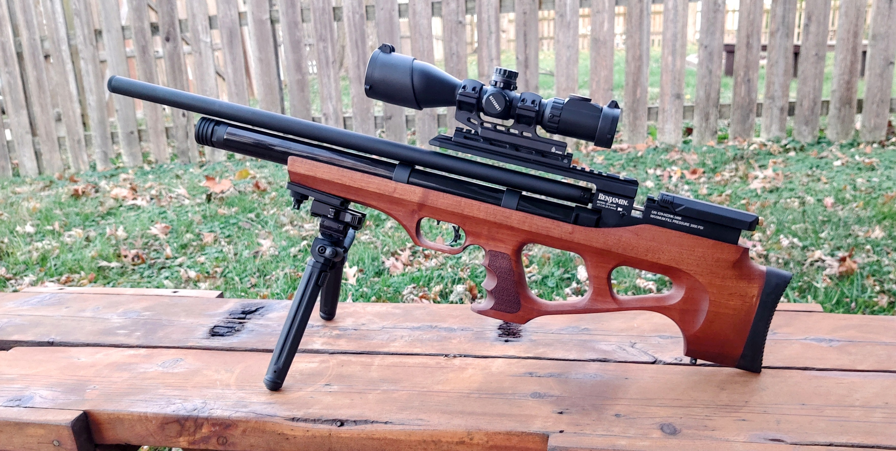

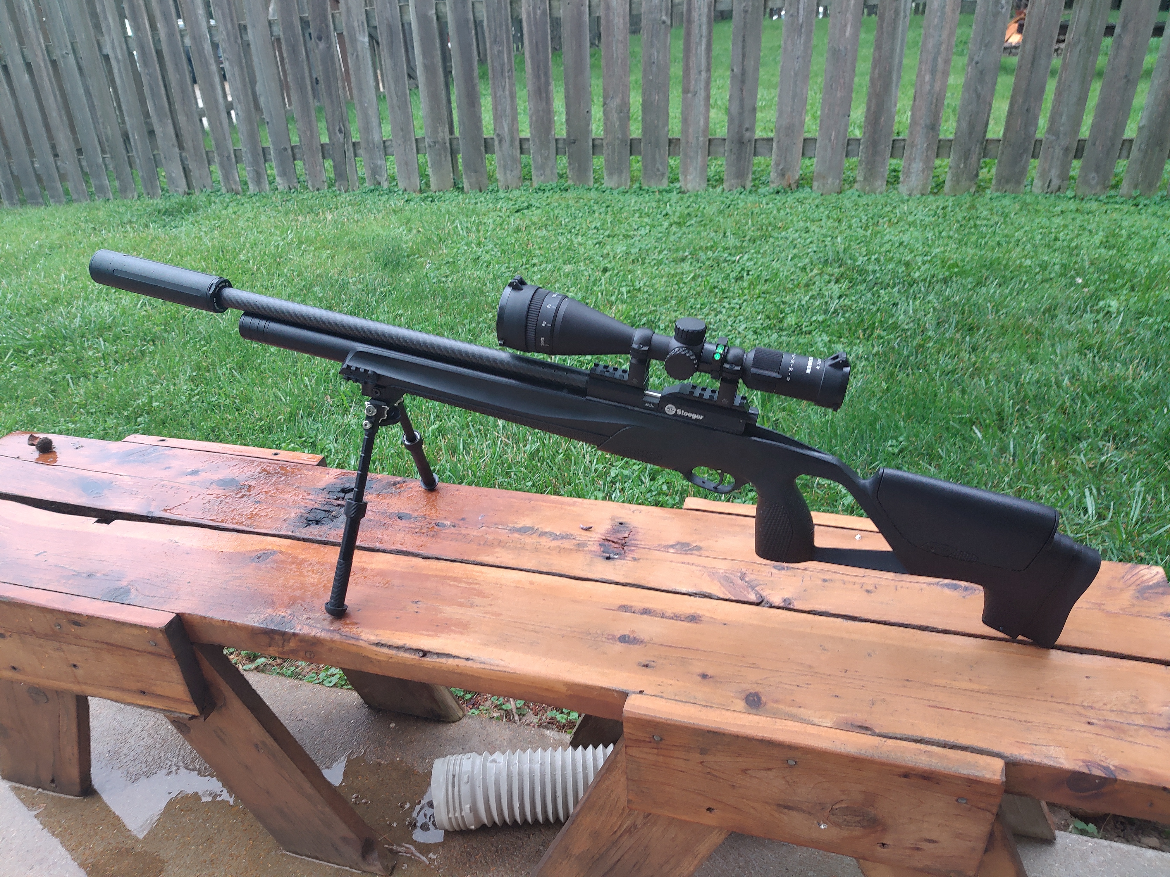

I have an akela .22 all stock no twang. I have a stoeger xm1 scout .22 with no adjustments made and I refill after 4 mags on each cuz that’s all the mags I have. I do like the all metal mags better on the scout. Scout has 200cc tube @ 3600 psi max and regulated. Akela is 280cc tube @3000 psi max not regulated. Both weigh the same. Akela is about 5 inches shorter ( without additional length of mod on scout)and wood stock vs stoeger with composite stock. Stoeger is loud without mod. Akela has baffled shroud and quieter. Both are equally very accurate, I shot sycamore puff balls from 40 yds away standing no rest with both guns.. I really like the scout especially at its price it’s a very solid gun but my personal preference is akela as it’s a bull pup and wood stock as I just ordered another
one in .177 and put the stoeger up for sale to make room.
Reactions: Perle
I have an akela .22 all stock no twang. I have a stoeger xm1 scout .22 with no adjustments made and I refill after 4 mags on each cuz that’s all the mags I have. I do like the all metal mags better on the scout. Scout has 200cc tube @ 3600 psi max and regulated. Akela is 280cc tube @3000 psi max not regulated. Both weigh the same. Akela is about 5 inches shorter ( without additional length of mod on scout)and wood stock vs stoeger with composite stock. Stoeger is loud without mod. Akela has baffled shroud and quieter. Both are equally very accurate, I shot sycamore puff balls from 40 yds away standing no rest with both guns.. I really like the scout especially at its price it’s a very solid gun but my personal preference is akela as it’s a bull pup and wood stock as I just ordered another View attachment 529837one in .177 and put the stoeger up for sale to make room. View attachment 529836
