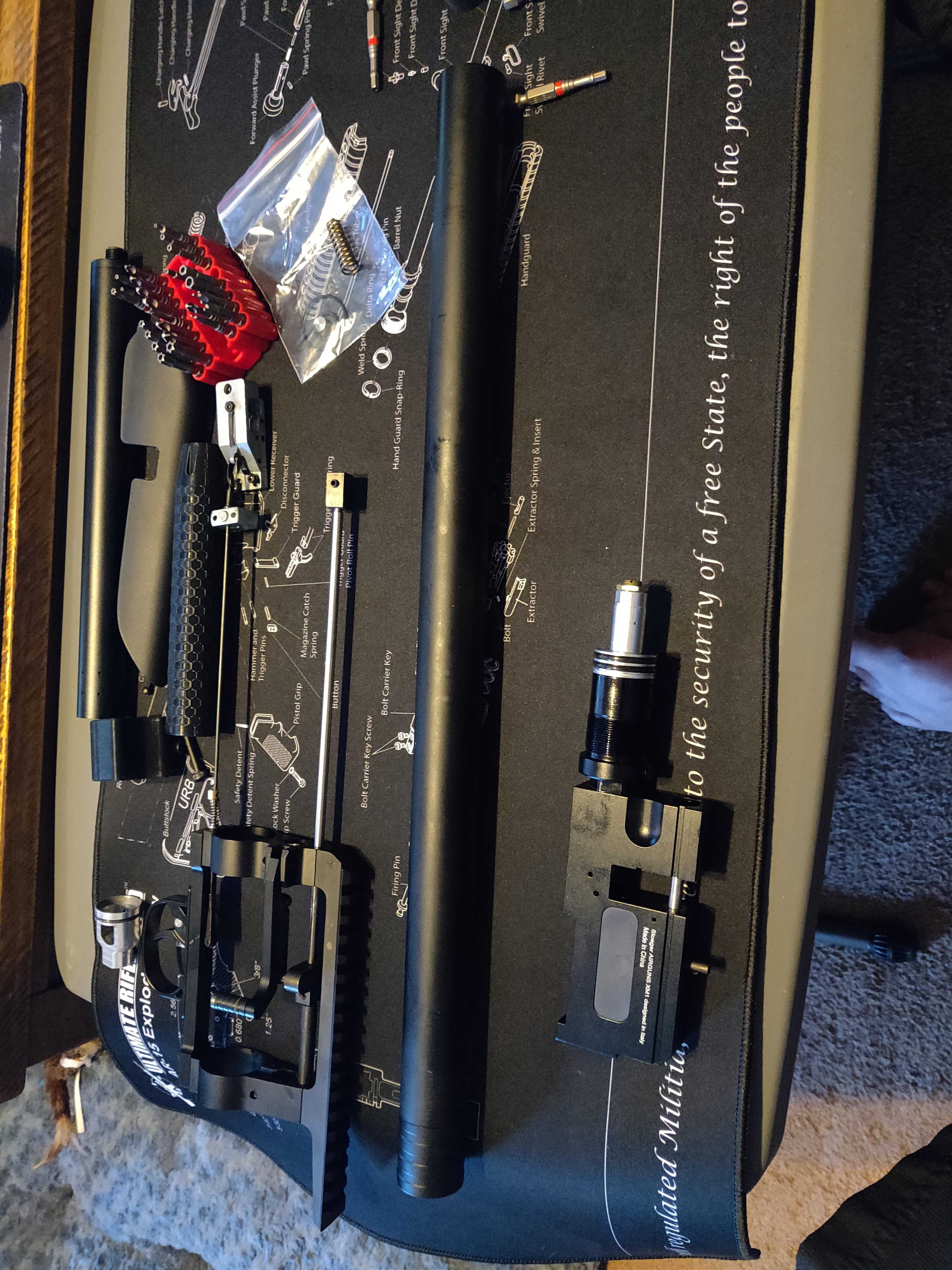

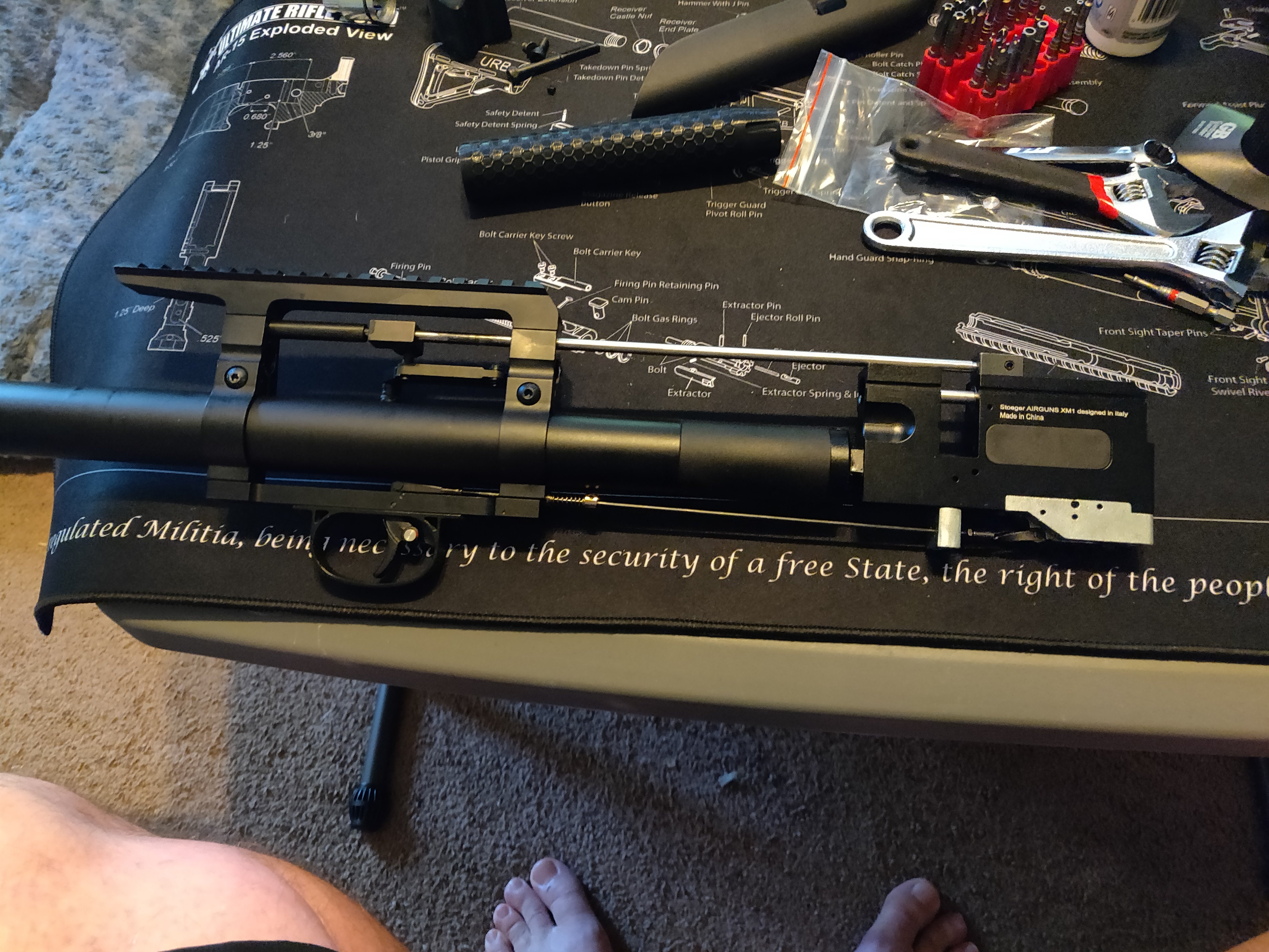

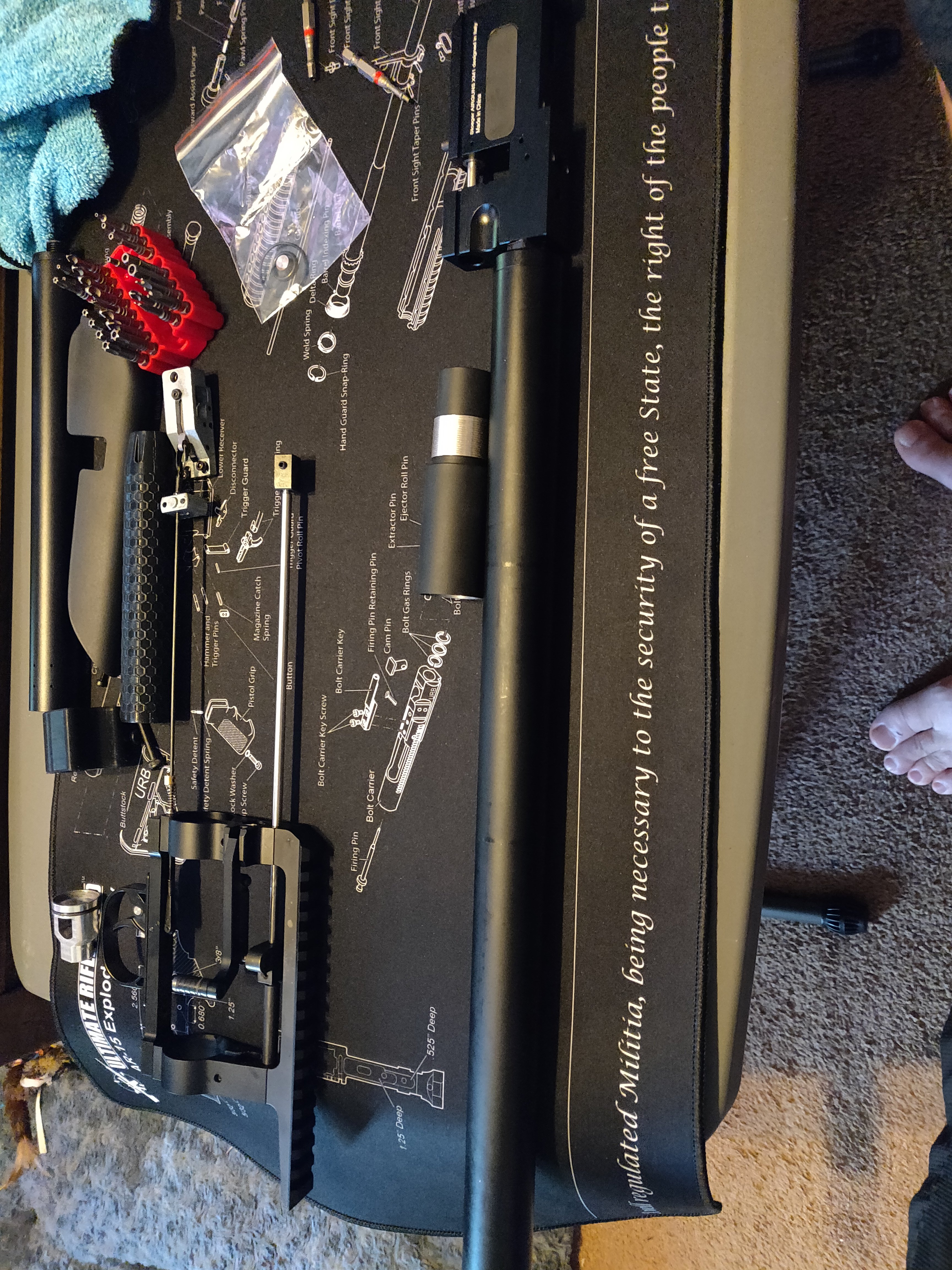

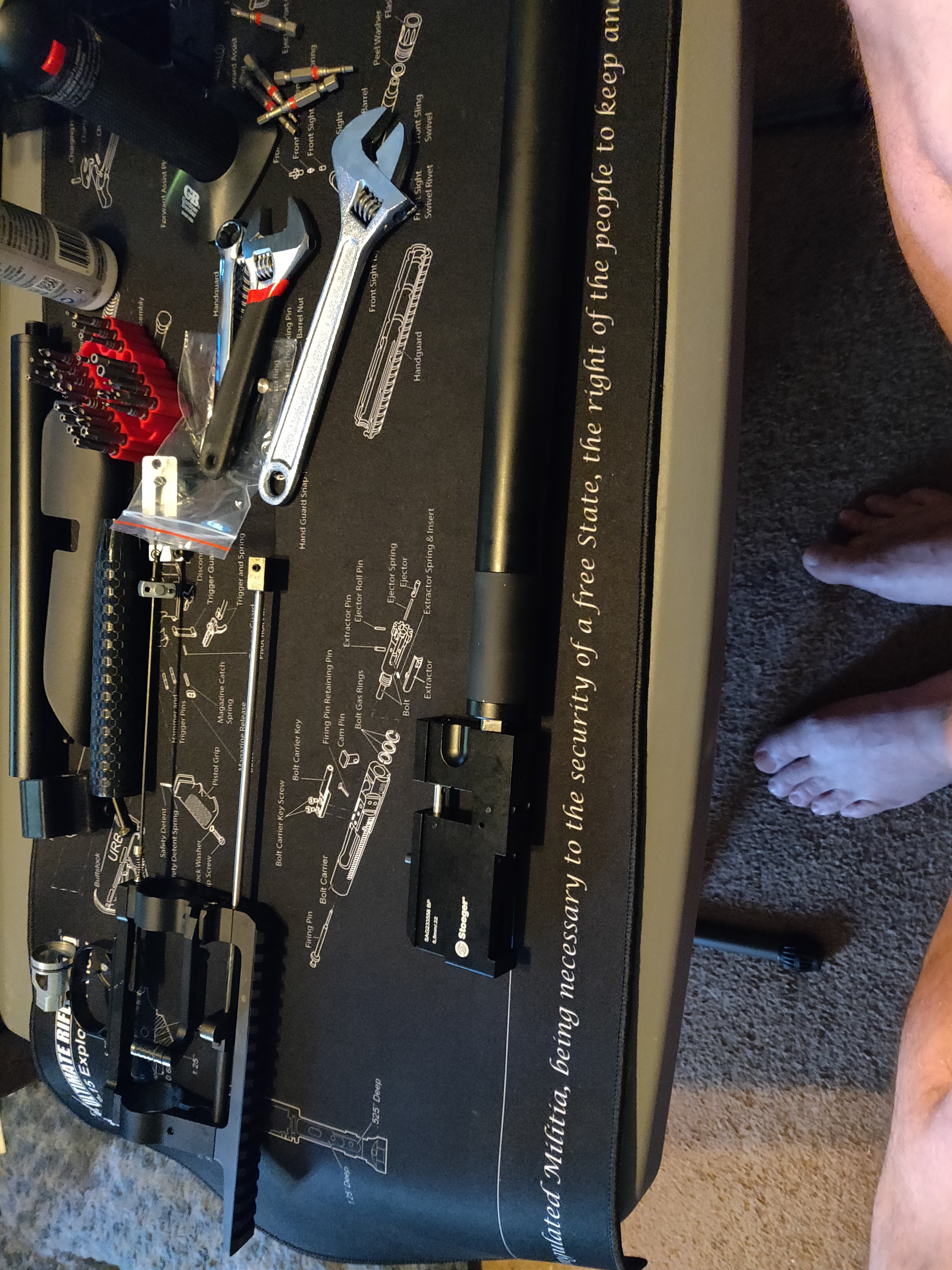

jacques from extreme airguns out of South Africa. Really good guyWhere did you get the plenum? I only found one from a shop in South Africa.
That’s the one I have bookmarked for a 25 P35 I’m buyingjacques from extreme airguns out of South Africa. Really good guy
Yeah he palys around with the p35 he had one with an m60 barrel pushing out over 55fpe.That’s the one I have bookmarked for a 25 P35 I’m buying
My Bullshark reg seems to be set around 140 bar. If I'm not mistaken, you said yours was lower than that? Mine is going to be fed 10.03 and 13.43 slugs 99 percent of the time so speed is what I'm after.The South African plenum gave me about 40 fps more on my P35-25 as I posted in another thread yesterday. I got about 20 fps by drilling out the barrel port, transfer port, and the path through the block between them from about 75% of bore size to about 85%. That puts me at about 45 fpe. Getting 50fpe will require a heavier hammer spring. The one in my P35-177 was too much for the regulator setting it came with and I shortened it. But the 25 came shimmed a little and is too weak for higher regulator settings. Trying to decide now if I go further or not. The current tune has Baracudas (31 grain) going about 815 fps. The 33.95 grain JSBs are about 775 which isn't ideal but the trajectory Chairgun predicts for both is plenty usable. I need to figure out which is more accurate. I was shooting little 3 shot groups as I tested each change of the gun and both looked pretty good.
This the one?Where did you get the plenum? I only found one from a shop in South Africa.
Thank you!Yeah, the guy i dealt with moved from SA to Belgium.
I did see that one as well, I suppose switching to the Huma reg would only certainly aid in shot to shot consistency. That might be more worth it.well there is Huma
