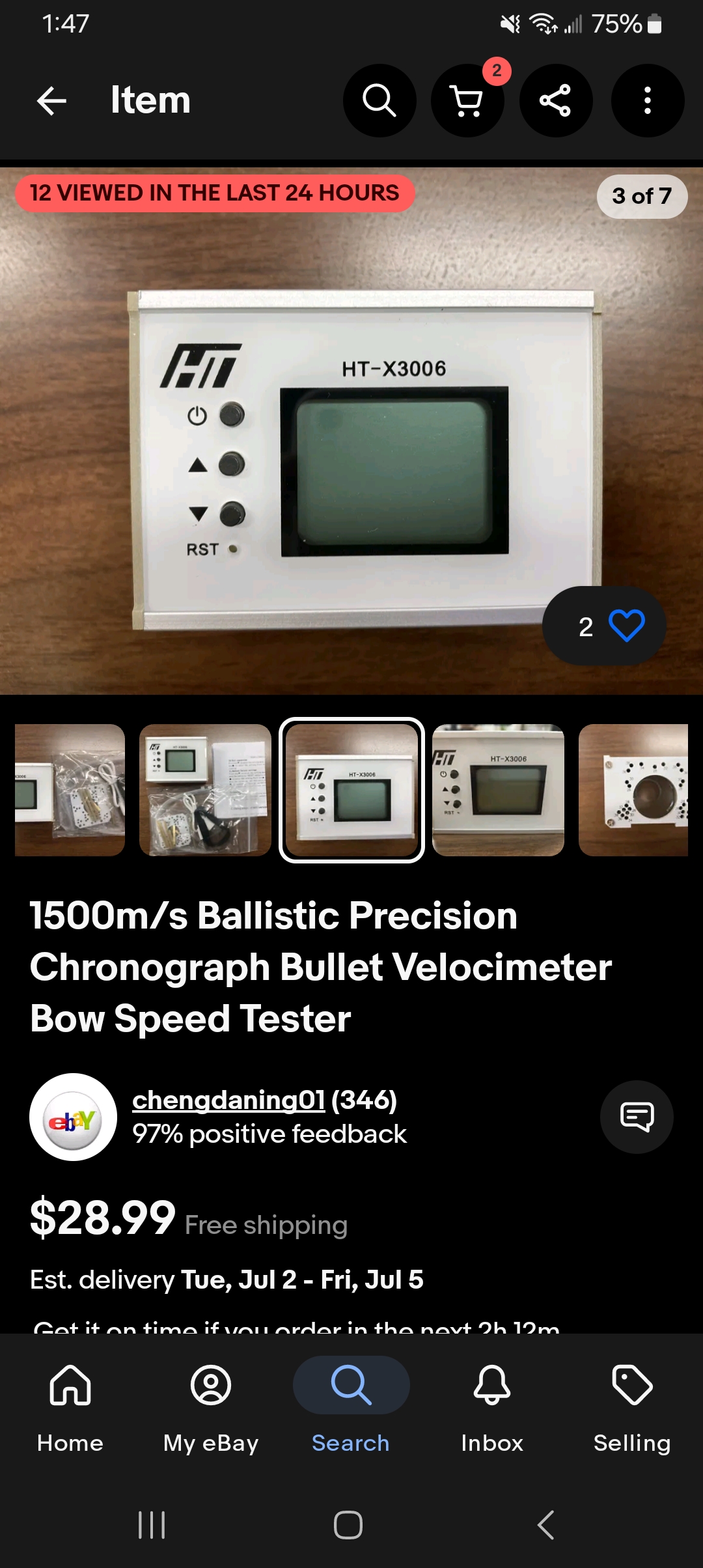

Has anyone used the xt x3006 chronograph and what's everyone's thoughts on it

Air rifle pellets can be a *lot* harder for detection than airsoft, so the reliability of Airsoft kit can be hit & miss.
If you're pushing 22cal+ slowly (500-700fps) - probably okish in a lot of cases
xt-3006 - i've seen reports of issues with detection of .177's (UK forums)
I havent seen inside a 3006, but the typical airsoft ones are built pretty poorly from an accuracy point of view. (the orange shoot through ones i've seen inside of)
The method of assembly & internals mean it just cant be that accurate, expect a variation of at least 10-20fps @ 1,000fps best case.
Are cheap ok?
They definitely can be - depends on what you need it for. If you use them a lot & need a known accurate reading, maybe not.
If they are shown to be consistent with results & the overall number doesnt matter, then it'd be useful - you can shoot & get a number, do tuning & compare the new numbers.
