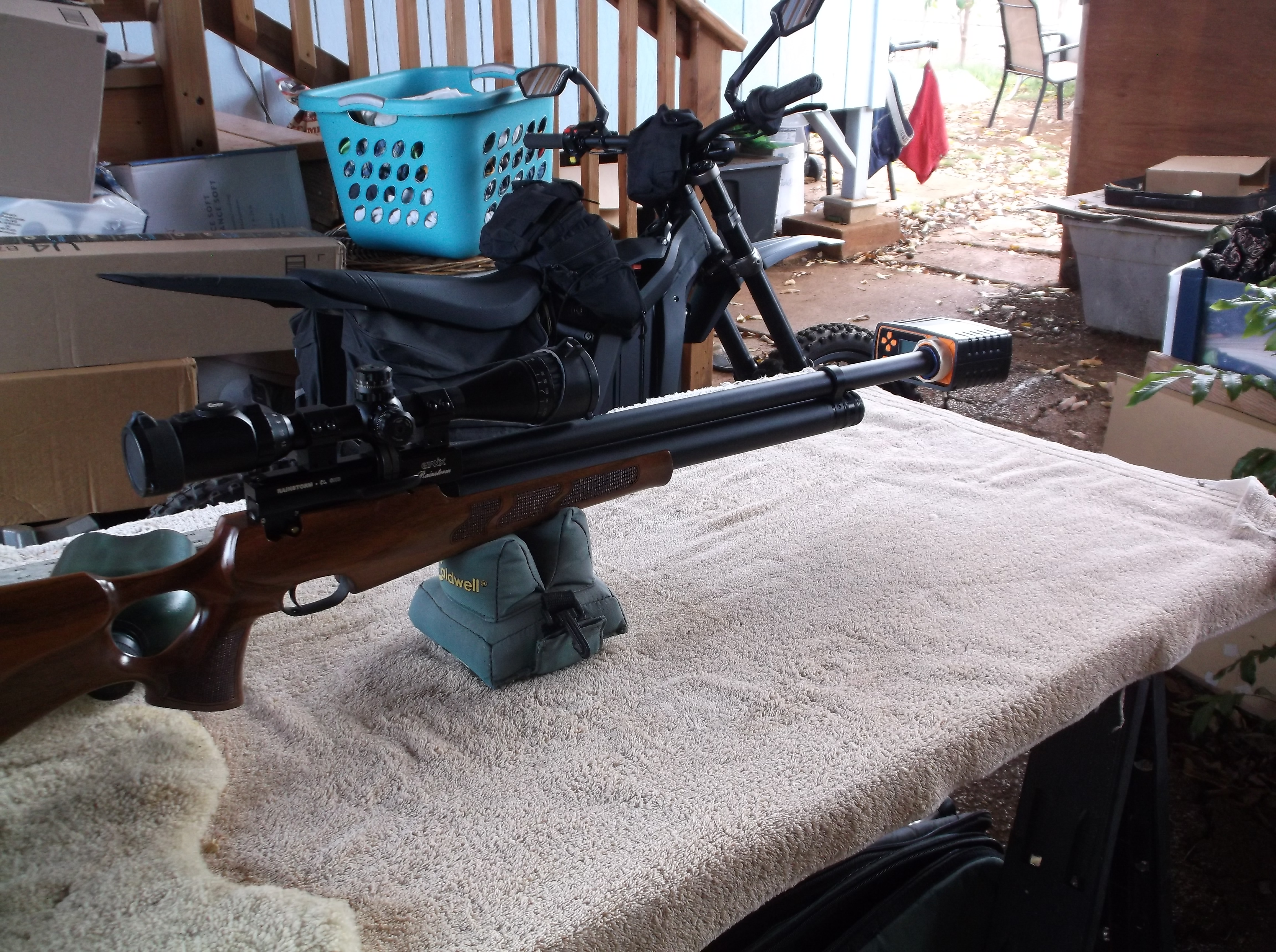

I have the cheap clamp-on chinese chronograph, and a Shooting Chrony Beta, and an FX Radar chronograph. For airguns I absolutely LOVE the low-cost cheap chinese clamp-on chronograph. Simple, never misses a shot. This is definitely my go-to chrony for airguns. I wish I'd have known it existed before I bought an FX Radar $200 time-wasting piece of junk that I simply cannot trust. The Shooting Chrony was OK years ago and requires specific lighting conditions -- so kind of a pain, but I would still use it IF I was chronying powder burners. For airguns I say get the chinese clampon for about $35. Forget the FX radar. The FX radar chrony is the only chrony I have ever used that I actually WANT to shoot.

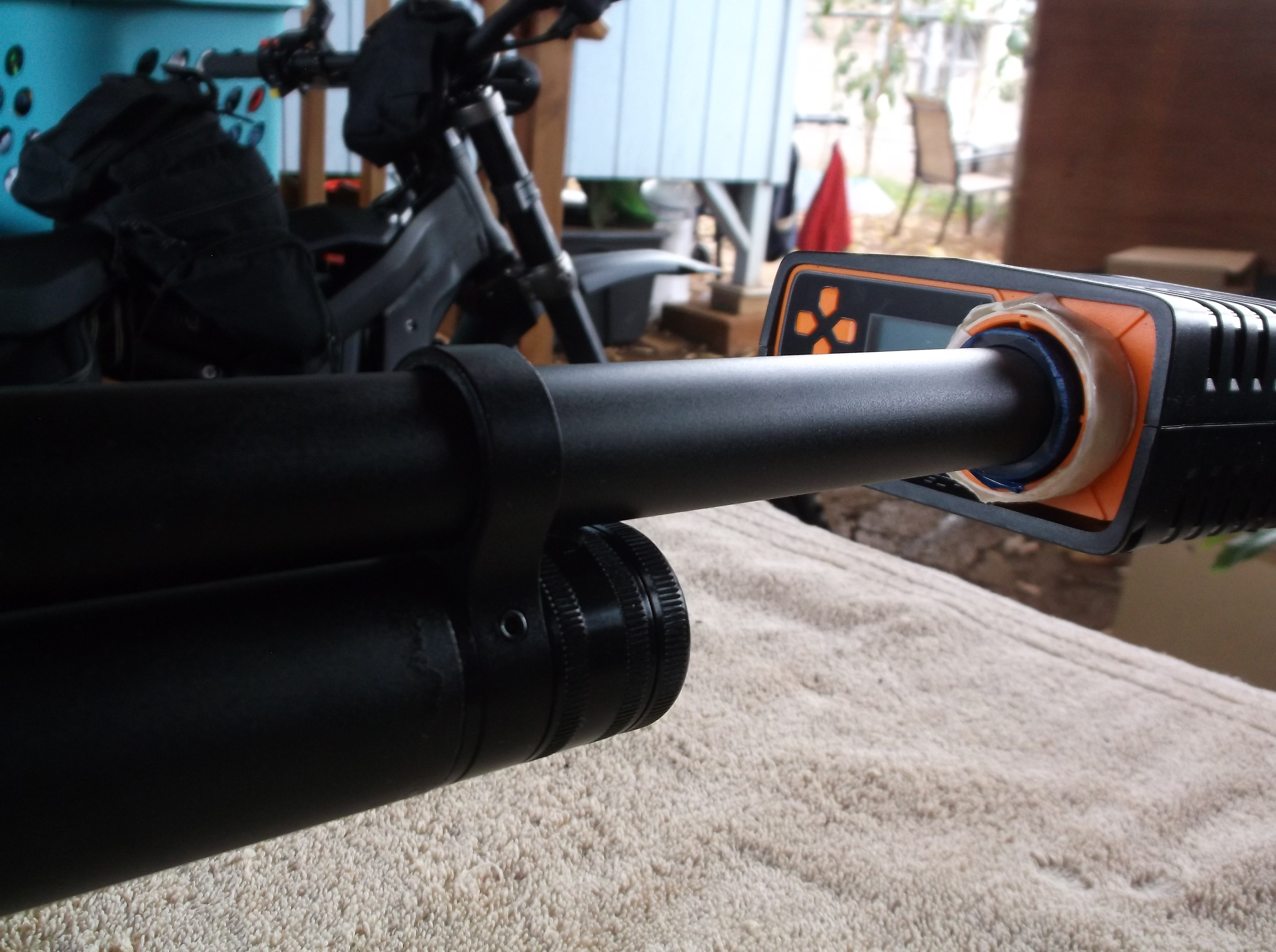

So you are saying..that you can mount this on your air rifle barrel and shoot with it attached and have NO POI changes....lets say at 50 yards -100 yards? I know a couple guys that have the FX and when you mount it to their barrels..there is a notable POI change.
Ok full disclosure,...I only have rifles with a solid barrel band ( don't even consider rifles without one ) ...and yeah in my rifles yes, but I suppose rifles with flimsy barrels and no barrel bands would be an other story entirely

This Chrono weights 9 oz, all my rifles have a rock solid barrel band and I've never seen a change in POI even at 35 yards ( I hardly ever shoot further then that )
