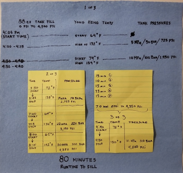

Now - Putting my Y.H. comp to the real test.. [And it worked absolutely flawlessly]
I finally got my new 88 cubic inch carbon fiber tanks all assembled, and needed to completely fill it from scratch..
From 0psi to 4,700psi took a total of 80 minutes of combined run time.
Obviously, taking cool down and drying breaks in between run times..
My setup wasn't special at all.. Royal Purple 100 compressor lube, 5 gal bucket 3/4 filled with cold tap water,
and then I have two 2ltr soda bottles that are frozen, which are dropped into the bucket to add more cooling..
The moisture/oil filtration was done only using the small OEM trap that comes with the unit..
[I'm still waiting for pieces and parts to do a hybrid oil/water separator]
Sam -
PS: Here are the numbers I came up with as for compressor Start/Stop times, Temps, and Pressures:
Sam,
That is great data, thanks for sharing. I am thinking of filling a scba tank from 0-4500 psi with the YH compressor and this gives me confidence to try it as well. How saturated with water/oil was the filter in the OEM moisture trap? Compressor is in my “man cave” and I keep humidity controlled to 40% and I can bring it doen a little lower to help with moisture.
