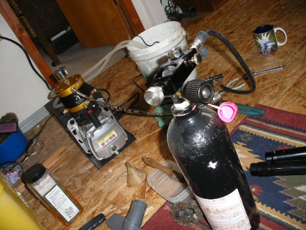

How long are you running the Hen?i never run mine more then a 20 min. at a time.I fill a pony tank.When ya put it up disconnect
the pump line and blow through it that should drain everything out of the head.
