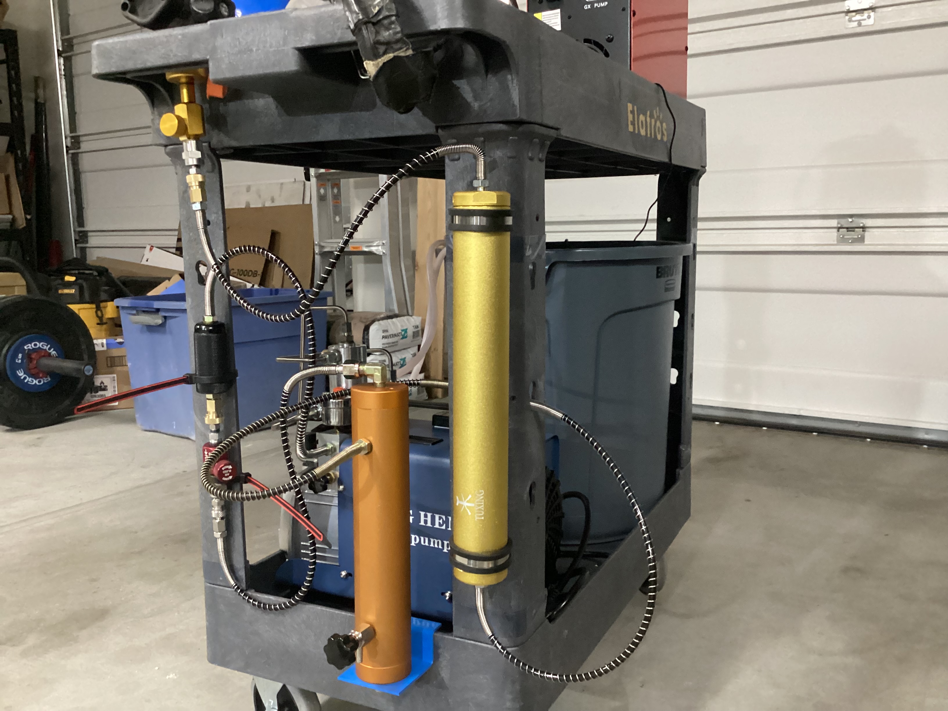

I got my set up on a cart:

The water flows from the bucket to the YH and then through the radiators and back into the bucket.
